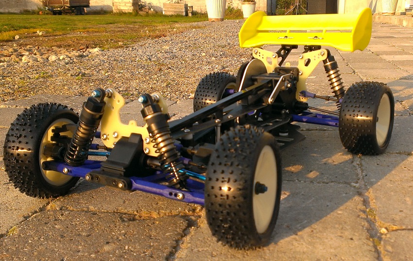

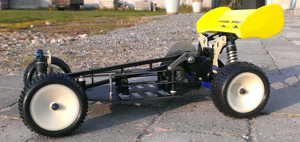

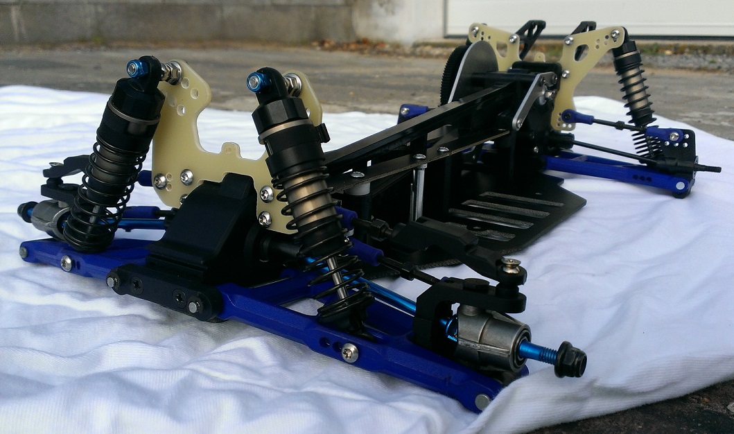

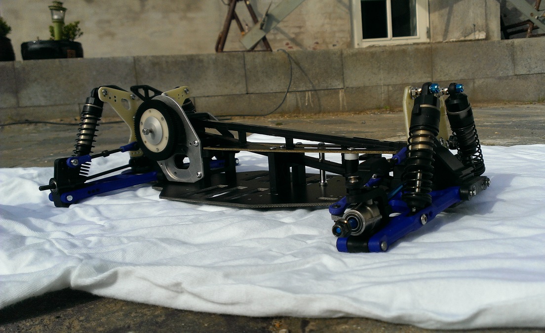

Finally got around to putting the blue Lazer arms to use.
It´s one big mash-up of parts from the Lazer line.
GS rod ends in blue and a pair of blue alloy porn uj´s
Ball raced steering, geared rear diff - ball diff at front, one way pulley on the front belt.
Can´t name the spurgear, but it´s got a POM middle section wich doubles as friction slipper pads.
Thanks to gomachv for the G10 shock stays 8)

I like the front CVD's...what kind are those, and how long are the 'bones?

Coelacanth wrote:I like the front CVD's...what kind are those, and how long are the 'bones?
I have no clue on the brand, but they are std. lazer/optima length. Let me know if You still need a measurement.

how come you are using optima mid hingepins with e clips ? and did you make that front arm brace yourself.

alcyon wrote:how come you are using optima mid hingepins with e clips ? and did you make that front arm brace yourself.
All the used front arm braces I have, seems to have had the pins torn out of them, even an Option House alloy brace.
So when building this one, I drilled a new set of braces - should it ever fall of the shelf :lol:
