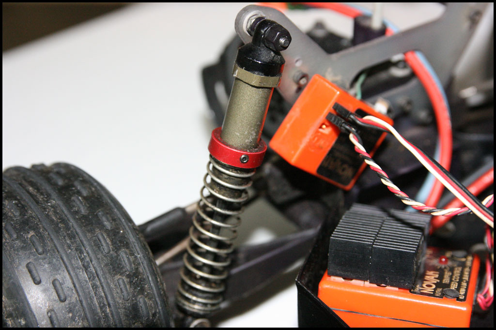

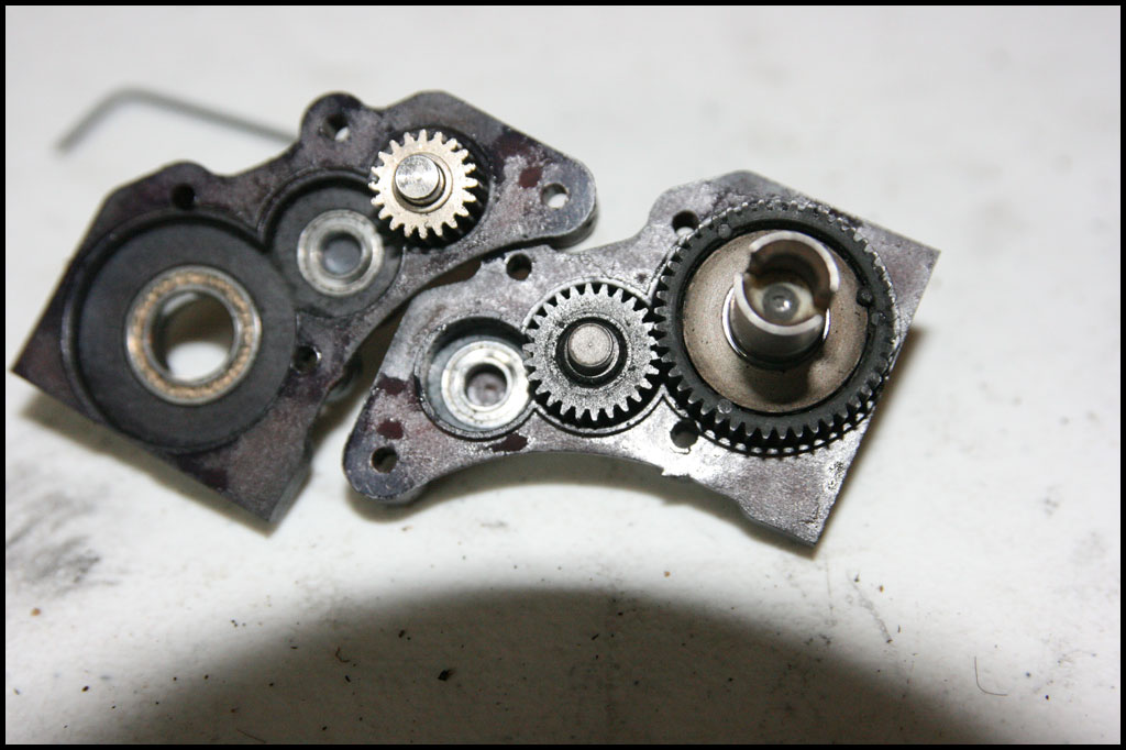

It's been 20+ years since it's seen the light of day! - I got some new batteries and a charger and everything still works as it should! Pretty cool. With that being said on to the pics. No mods for now other than rebuilding the ball diff and adding B4 slipper components!
She's grimy for sure!

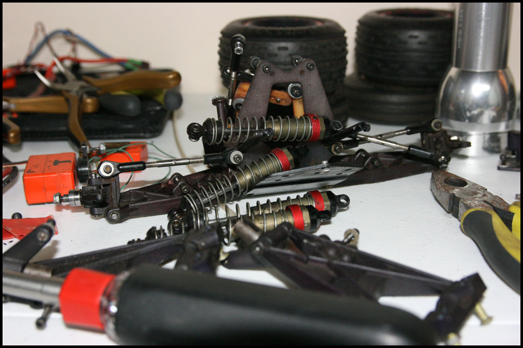

LOTTA PARTS!

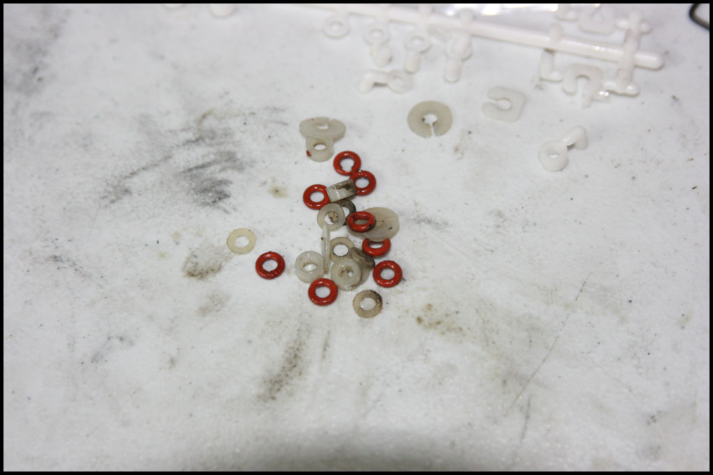

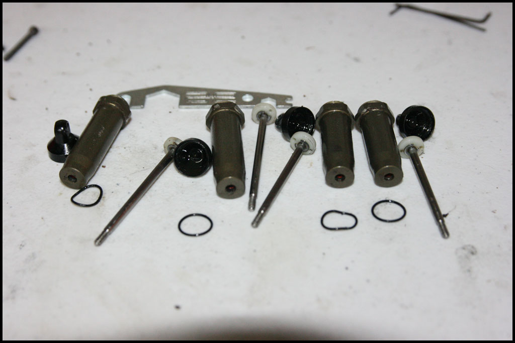

Shocks apart!
Got the rebuild kit but ended up having to use the stock round clip thingy as the new one wouldn't "click" into place...

The new shock rebuild kit will clip in! You just have to make sure you remove all the mold tab burrs. It is better to even cut off a small bit of the part along with the burr. There are two burrs on each part! :wink: The new rebuild kit uses Teflon and is much better than the old plastic.

Thanks. Yeah I did that per the instructions...trust me they were smooth! No dice but I will try again...

one problem i had rebuilding shocks lately ws that i had an extra thin washer in there and when i snaped it in .. took alot to snap .. and when i instaled the shafts they didnt want to slide freely

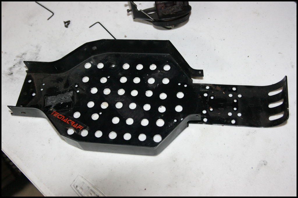

Love the vintage pics! Can we see a pic of the underside of your chassis.

Yeah I was having issues too...had to unload and reload a couple times...ended up just using the old clips...
They turned out awesome. The Hot Trick Stuff collars! Love it!

marlo wrote:Love the vintage pics! Can we see a pic of the underside of your chassis.
Already started re-assembling...will get one of the bottom next round...

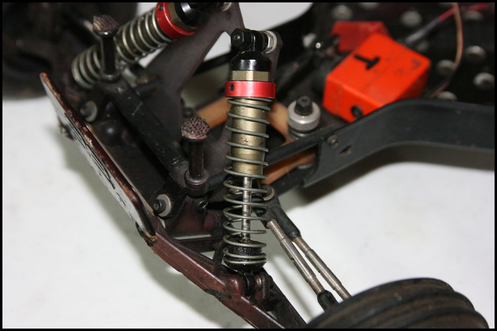

She's all done...Some update pics below...
Stealth all nice and clean. Assembled it's smoooooth!!!
Cleaned and ready assembly.
Probably should have re-dyed but didn't feel like it.
Had a bear of a time getting 2 of the screws out...had to get a new pack.
Rearend together
Front
Money shot!
And as requested...(yup - once a runner - always a runner! lol
Overall I'm super happy. She runs real good. Rebuilt the motor, new connectors, dialed in the esc's and she's good to go. No more cut out's - rebuilt shocks made a hug difference. For now this body will do - Will mostly likely do up a box art body when I get done my Kyosho projects.
