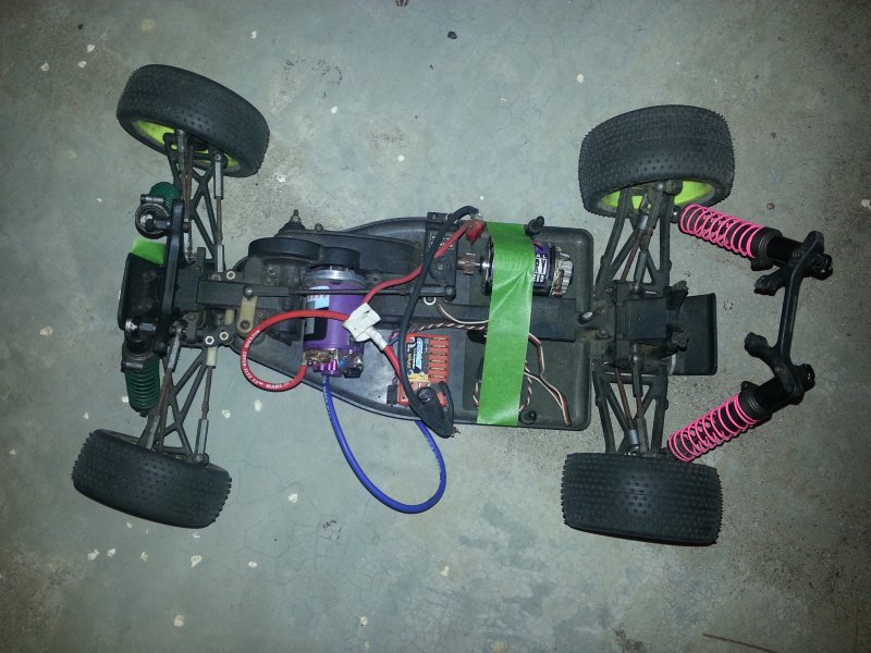

Well, it came today. Took a quick pic for y'all. It's missing several parts along with broken front and rear shock towers. I'm sure more fun awaits once I open up the transmissions. This adventure will have to wait until the Christmas craziness slows down for a full tear down.

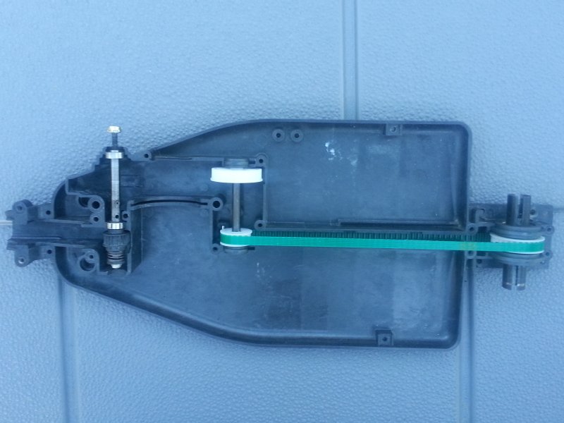

I did some disassembly this morning. I removed the electrics and got it down to the bare chassis. I didn't even touch the transmission parts, shocks or suspension. Those bits are all in a box...dirty.
It always amazes me how much people tend to overtighten. The shocks were bolted on so tight there's no way the suspension moved properly. There is so much flashing left on everything, it's comical.
The good news is that nothing is cracked or broken aside from the shock towers. I did notice that it's missing the wing mount. BTW, what are these belts made out of? I mean they are pretty much dissolved and all that's left are the fibers.
Finally, since I don't know much about these cars, I don't know the version history. Pretty sure this is an original xx-4. I noticed there are several shock tower versions, body types and belts. The chassis, says graphite underneath. Is that original or an option like the way AE does it? Thanks!

I think it's the 1st generation XX-4 Buggy. Why: chassis without slots, black shocks with clamps and non-reinforced shock towers. The right body hast the part number 8044 (NOT HOT WEATHER BODY, PART NUMBER 8045), it's the early version. Repros are still available.
Take a look at my build to compare and you will notice the difference
Nice find by the way
I would rebuild it just the way it is. 1st gen is rare...

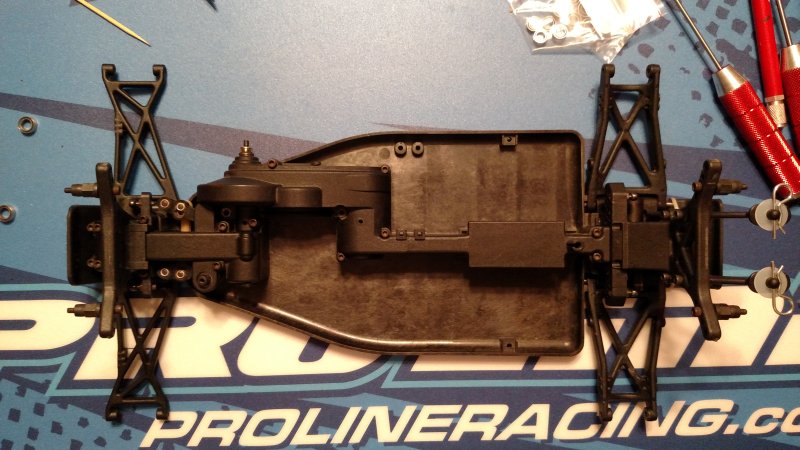

Ok, I ordered some parts today. I disassembled the rear diff to rebuild it. Who ever built it only used one of the proper ball races for the thrust bearing. I thought, ok, I'll just borrow one from the front diff just to get it together properly. I opened up the front diff and it was missing the center bearing. Also, the thrust bearing had disintegrated. LOL.
The pully near the slipper plate has melted. Wtf? And, for the rear diff, the previous owner used A and B bearing carriers instead of all A or all B. I'm taking a break.

Cars like this end up being a fortune to bring back from the dead. Sorry your reluctant entry into the xx-4 world started off like this. OG belts are near impossible to find and if you do find em they dont last long. Ive had good luck with the aftermarket ones on ebay (cant remember name). There are a few good threads for this car on here.

You should still be able to find all the parts you need pretty easily. The pulleys/ gears come as kit. The aftermarket belts should be fine. Oldrc probably has everything you need. Nice early car. I have one in pieces too.
