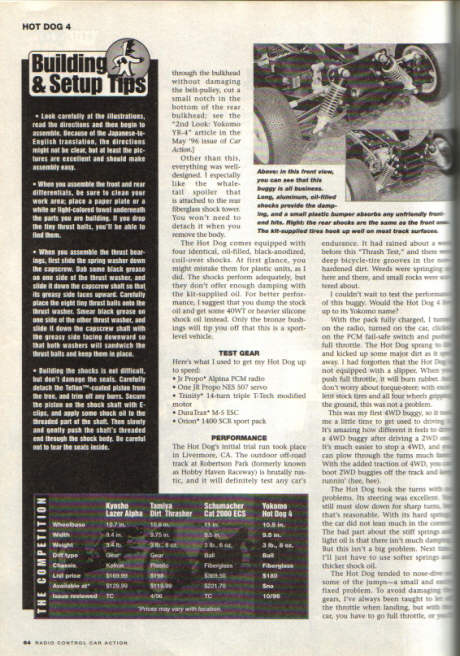

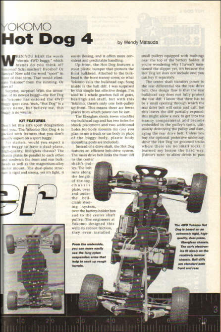

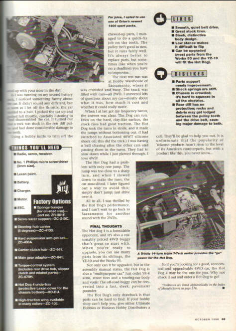

I found my issue of RCCA that had the hotdog. You can save the images on your desktop so you can zoom in. Here's the information...happy reading:

EDIT: just tried reading it , but the resolution is too low. Do you have higher resolution originals?
(Maybe better post them in the scans section)
