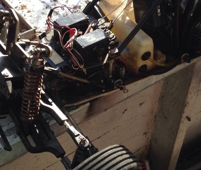

Haven't posted in a while. I traded a worn out Serpent for this worn out Monster Buggy a couple of years ago, been sitting in the closet ever since. No body, busted roll cage and a bag full of transmission parts and a carburetor.

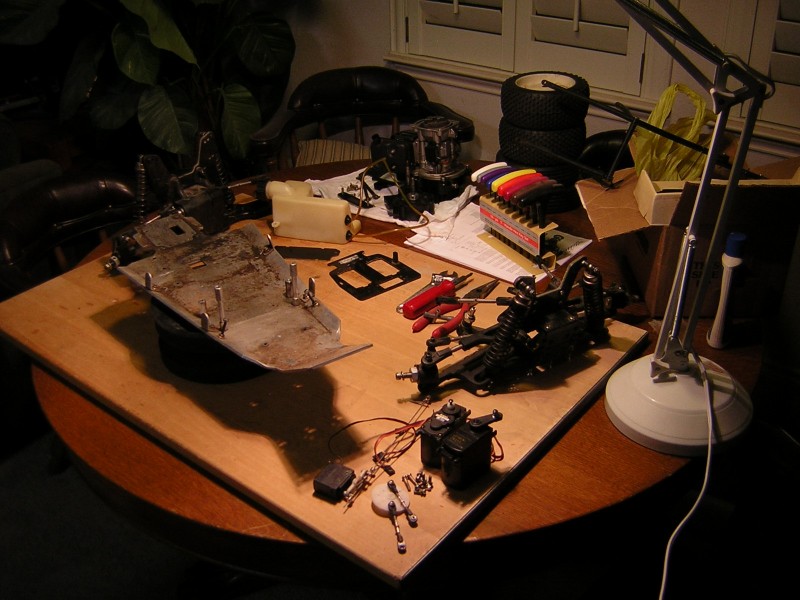

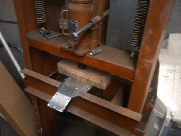

Right off I noticed the chassis was bent, so the tear down began.

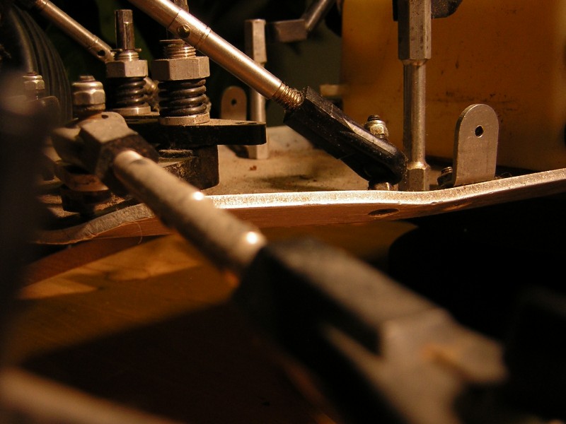

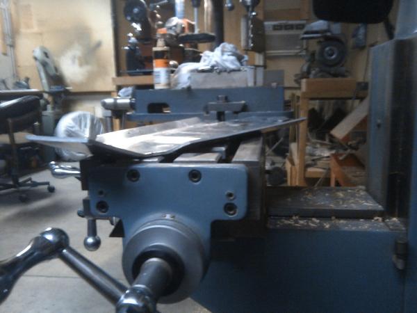

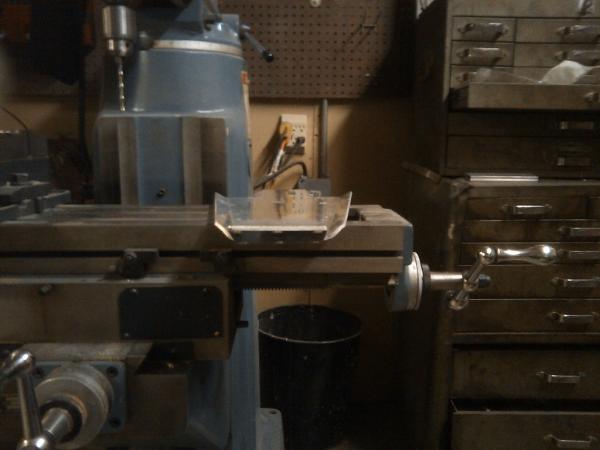

Chassis was twisted, bent and bowed. Pressed and beat on it until it sits flat, best I could.

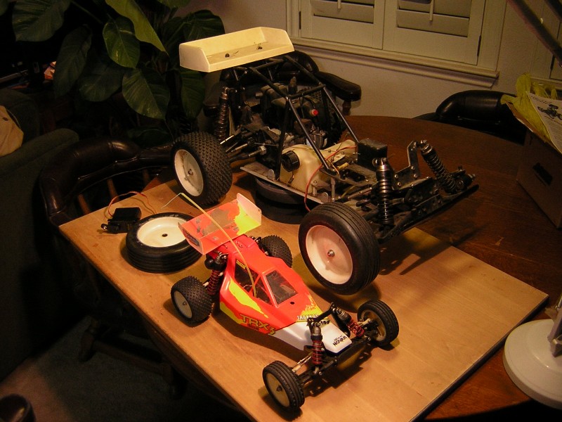

So that's where it sits after a couple of days work. Motor turns and seems to have good compression, I need to sort the bag of trans parts out and compare to the diagram, hope I have everything. One each of the wheels is painted silver, stripped one already.

Wow! That buggy is huge and nice job bending the chassis back where it needs to be. Who makes this? I see you posted it in the Traxxas forum but I never knew they made something that big.
Cool project for sure!
Jeff
Posts: 12335
Been thanked: 3917 times
Re: Working on a Monster Buggy
Original name was Traxxas Monster Buggy, for some reason they renamed it to simply 1/6 gas buggy
These are a blast, not as fast as nimble as the newer stuff but bitd it was killer!

Lookin good on the chassis repair. Must've been one helluva hit to bend that chassis...but then traxxas never really overdid the chassis thicknesses on any of their vehicles. But for as bent as the chassis was I'd expected more carnage.

Yes, it's a Traxxas. I drooled over these years ago and finally made a trade for this project. The chassis is actually a tad over 1/8" thickness aluminum, was not the easiest to put back where it was supposed to be.
