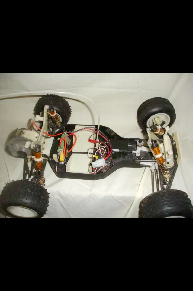

Just bought this truck. I wanted an RC10T back when I was a kid. I ened up getting a JRXT (that I was very happy with) back then. Anyways, I have some Tenergy 6 cell batteries packs and they wont fit. Even when I changed the battery cups to verticle. Any suggestions besides switching to lipo? Thanks< Kennth
integra22t
Posts: 637
Location: Kingston On.Ca
Re: Need Help. Battery wont fit.
Post by integra22t »
is this what you have ?
if so than ya its a hard fit .. you could remove the end caps .. it will help and if you have to put a notch in the battery cup to make room for the wires comming out of the end

Yes it is. Thanks for the help. I guess batteries are larger these days.

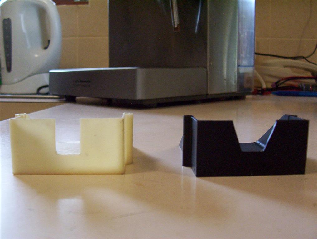

Hi KV78,
I have the same style batteries and they just fit with the end caps on, just do what Gomachv said,
run battery length wise, front to rear.
The new bulkheads have been modified for better battery fit, the floor has been removed and the
roof has been raised.
http://www3.towerhobbies.com/cgi-bin/wti0001p?&I=LXDSWR&P=7
Here's a pic of a couple of modified cups, you can also cut the floor of the cup out for more
clearance.
Dave. :)
