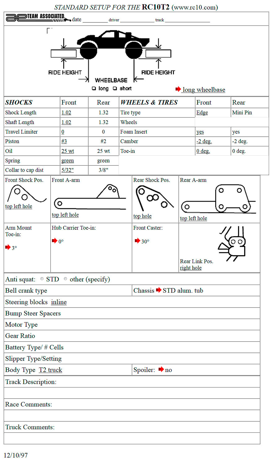

I was asked for the RC10T2 setup sheet, so I am posting it here.
This was originally html with gifs throughout; I did screen grabs of the copy I had and assembled them.
Steve Husting

awesome steve. thank you very much.
