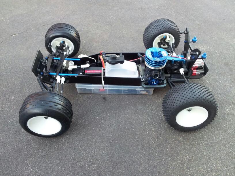

The mail man was nice enough to bring me some stuff today, at least enough to get a good start. It all started with an engine, a spare chassis, and enough parts to built 50% of a truck.
Here's a mock up, most parts are ordered with the only thing I still need is shocks. The tank is badly yellowed from years of running O'donnell fuel, I've got a much nicer tank but not sure if I want to use it. I've also got a new black lid tank (another thing not updated from Tower) but they scream RTR to me, so I don't know what to do.

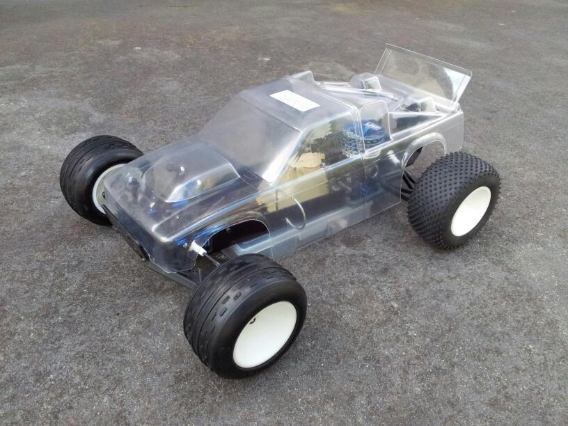

The black lid tank doesn't look too bad in the black tub chassis, so we'll go with that. It's also reverse fill which is better.

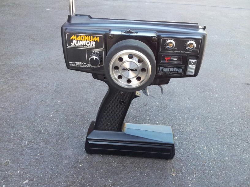

The mail man didn't bring me any goodies today so all I was able to do was mount the throttle servo and set up the radio.
Call me crazy but this is the radio I'm using
Probably not the smartest thing to use but I'd like to keep it somewhat authentic
