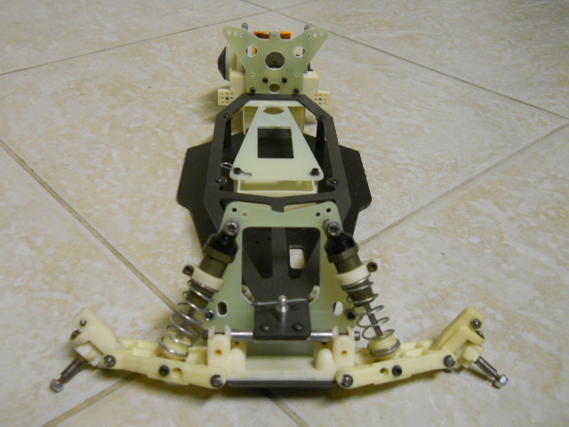

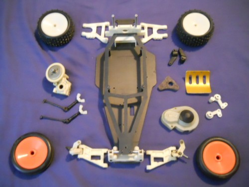

since i have so many used parts iam going to use em on this build PLUS been spending a lot of money lately :( so i know it wont be 100% correct build so no stupid comments please :lol: only new parts will be the rear hub carriers by shapeways, frt/rear shock towers & battery strap by gomachv and the stealth outdrives x2 since i didnt have any extras.

well almost everyone i have seen uses all rpm arms and parts. iam using a rc10t nose with rc10 arms and andys rear arms. had to trim down the bulkhead to make those rc10 arms fit.

Well yeah guys build them with RPM parts because the width changes. What you have will be pretty narrow.

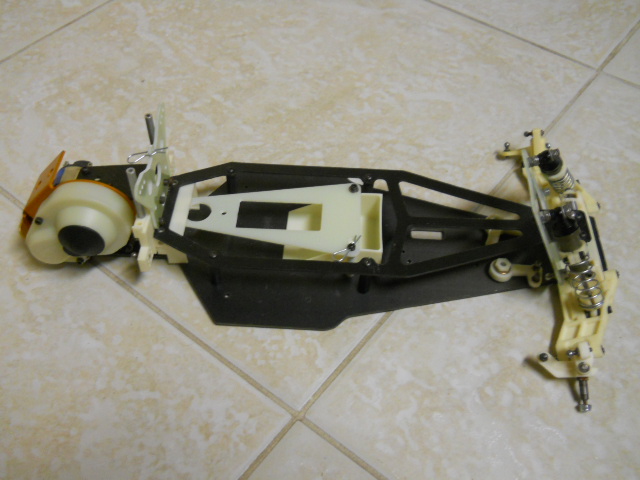

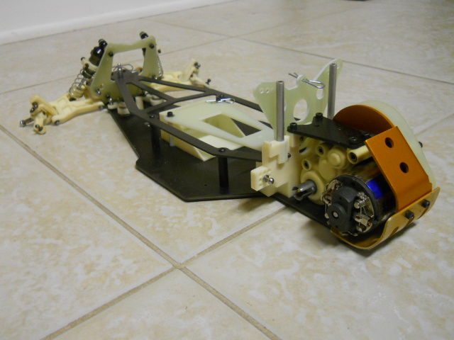

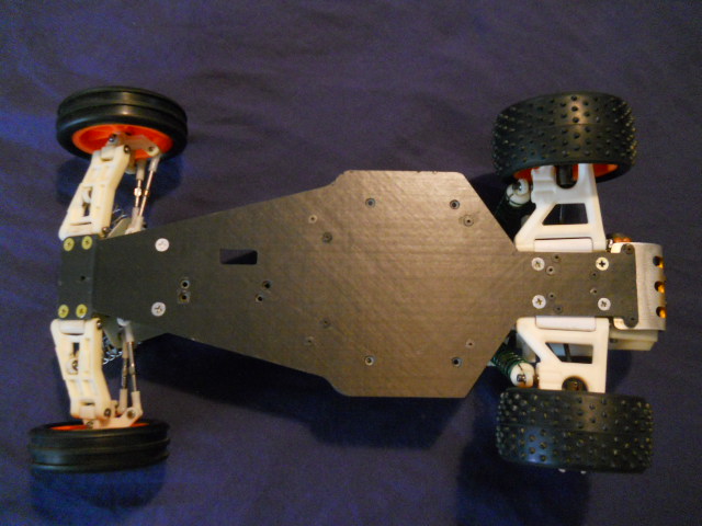

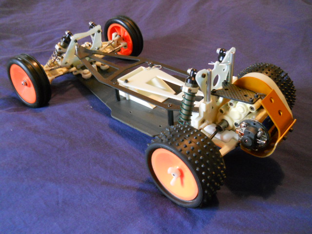

just a small update. the rear motor guard i made from a old chassis just cut the back off.

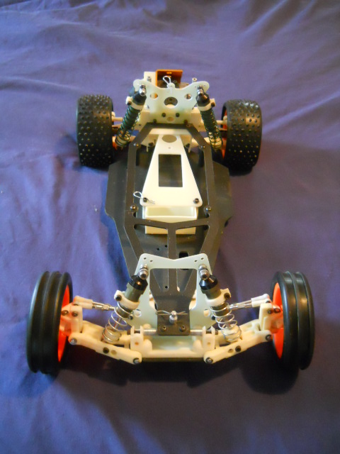

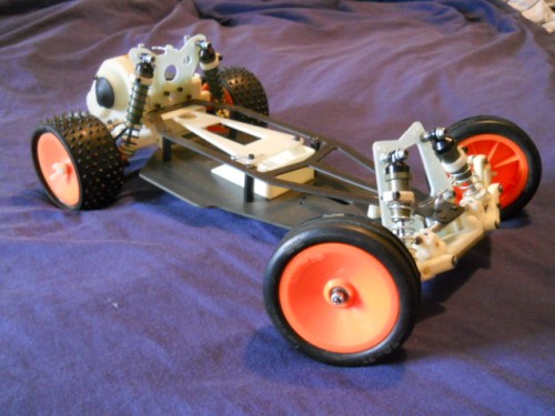

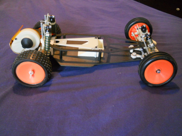

well its done. the back of the car came out a bit narrow, well at least i think, i could be wrong.

no, she will be narrow, without the 'correct' rear arms.

u have any pics (or anyone) of the correct rear rpm arms in white?/or part numbers?

Rpm Rear narrow arms are #8017. Correct rear suspension mounts is #8021.
