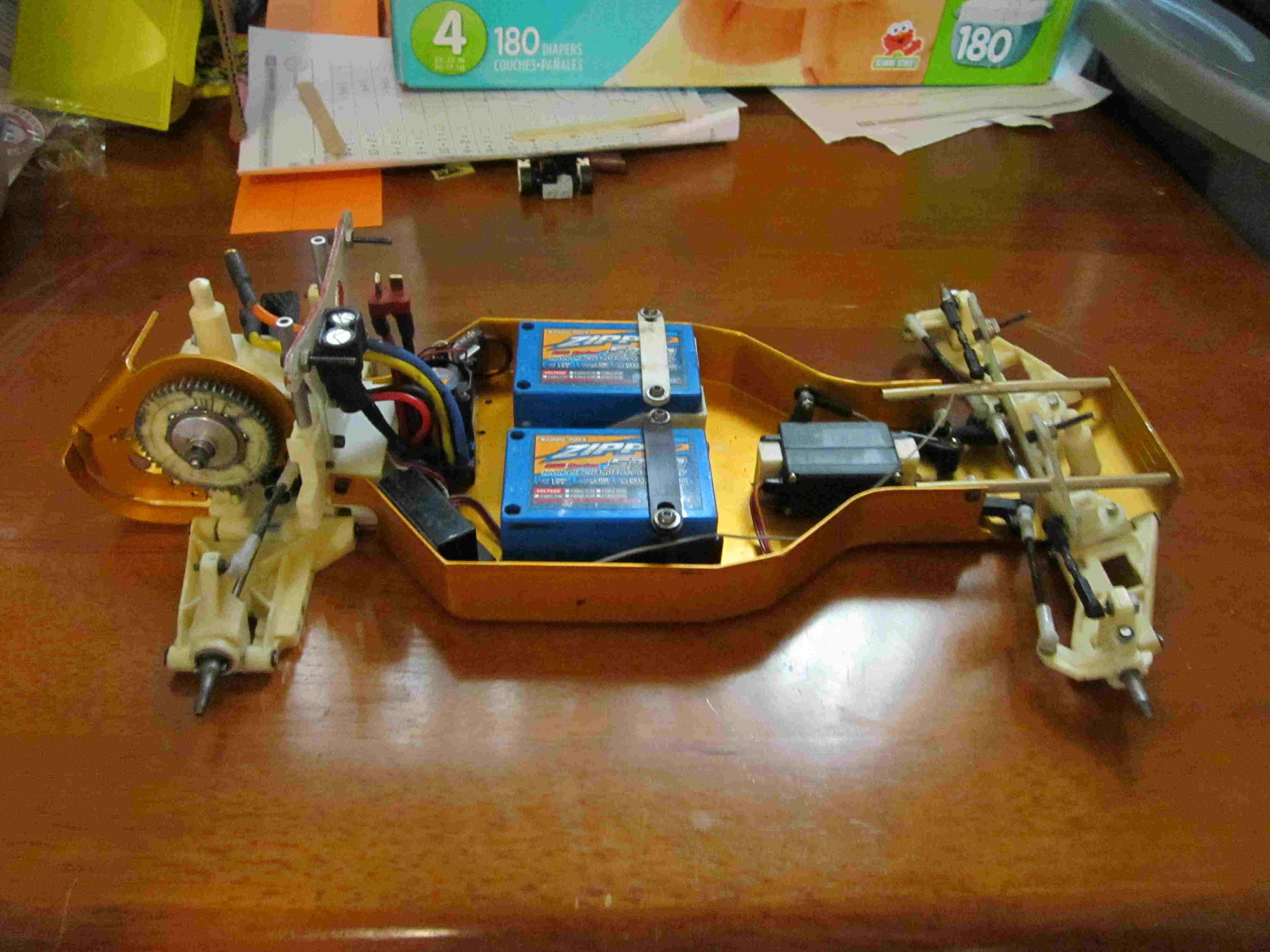

B stamp car. After tear down and reassemble, this car was very very very dirty. I was rebuilding the shocks when I took this pic, so they are not shown.

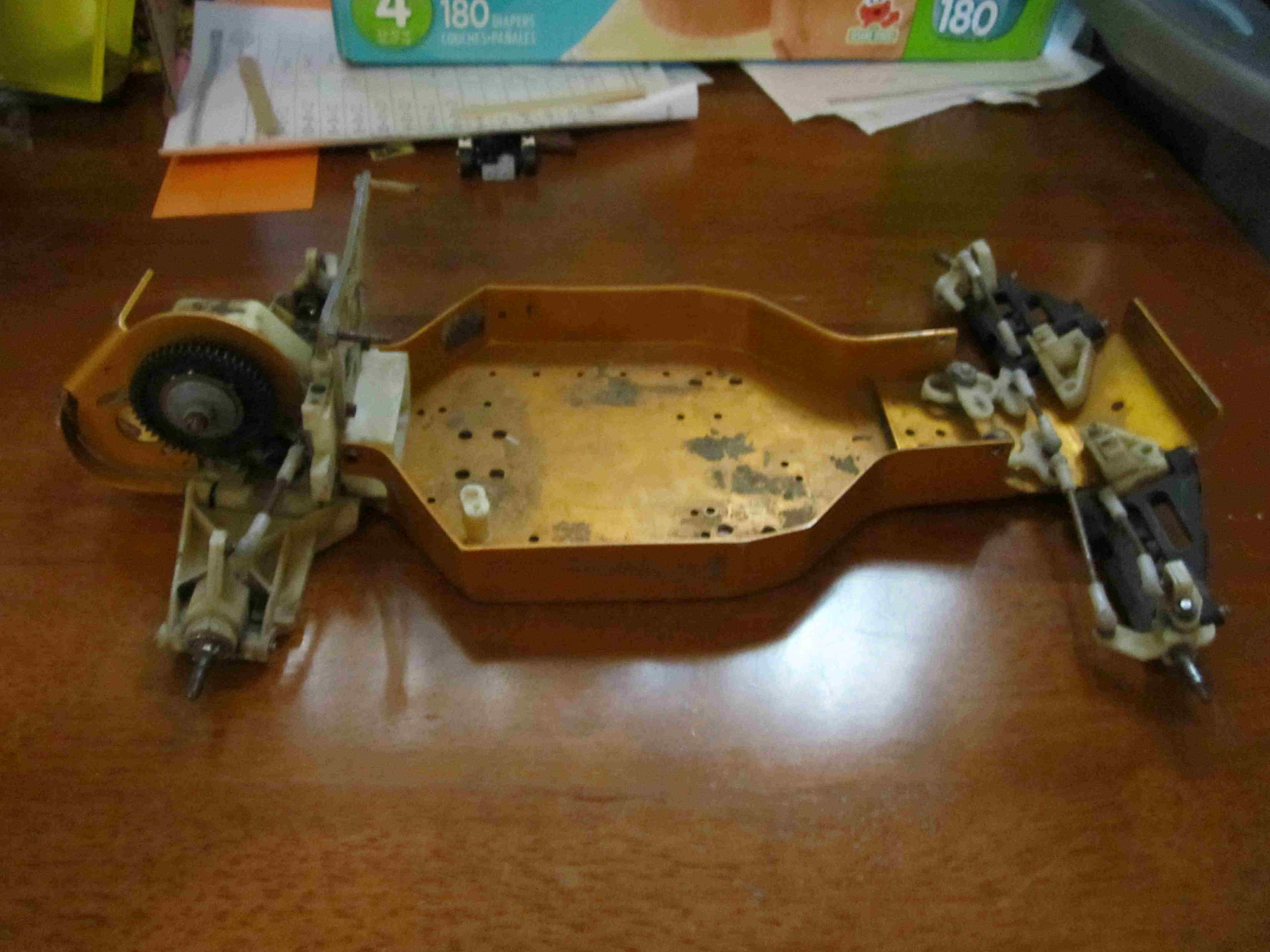

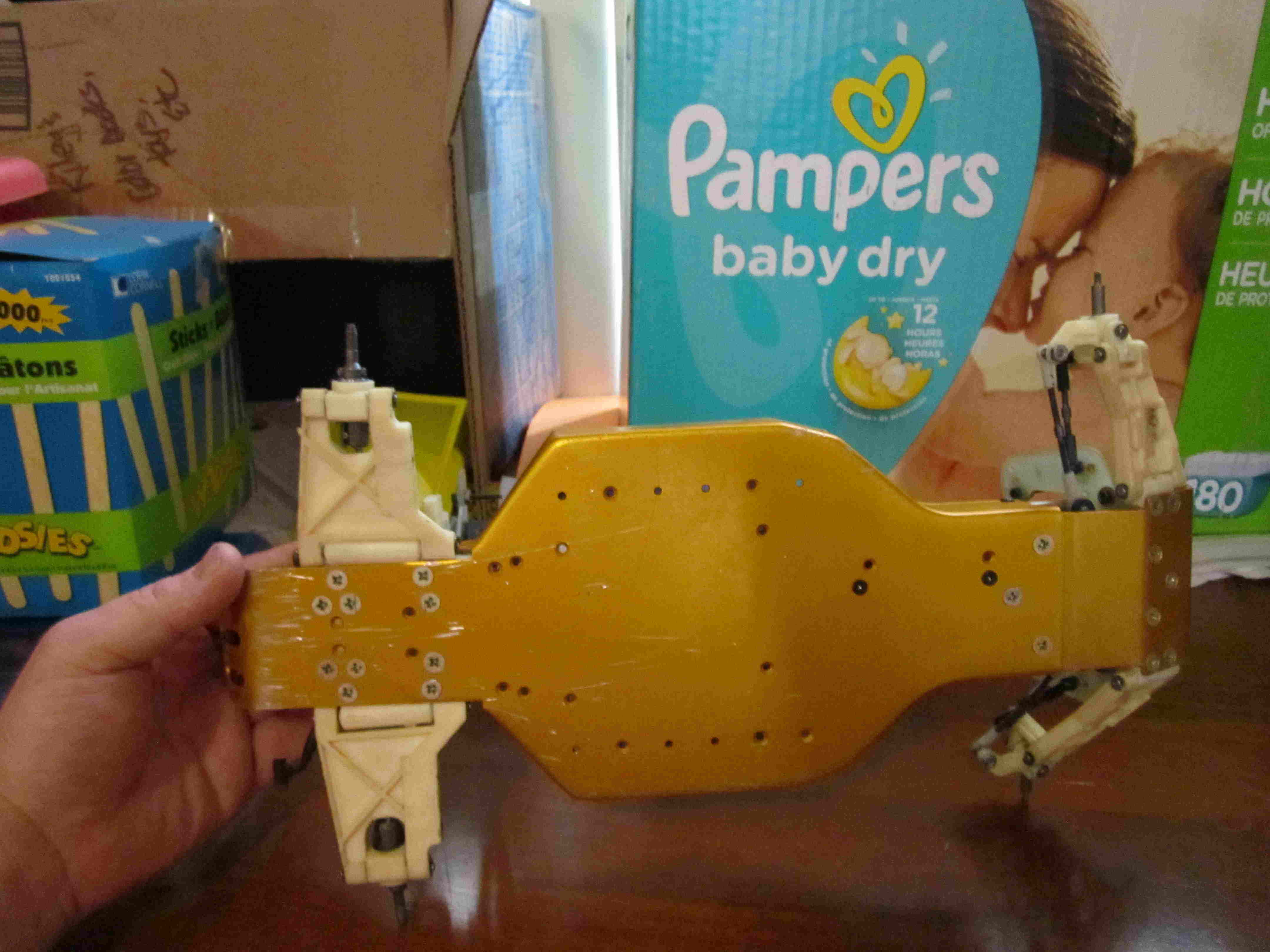

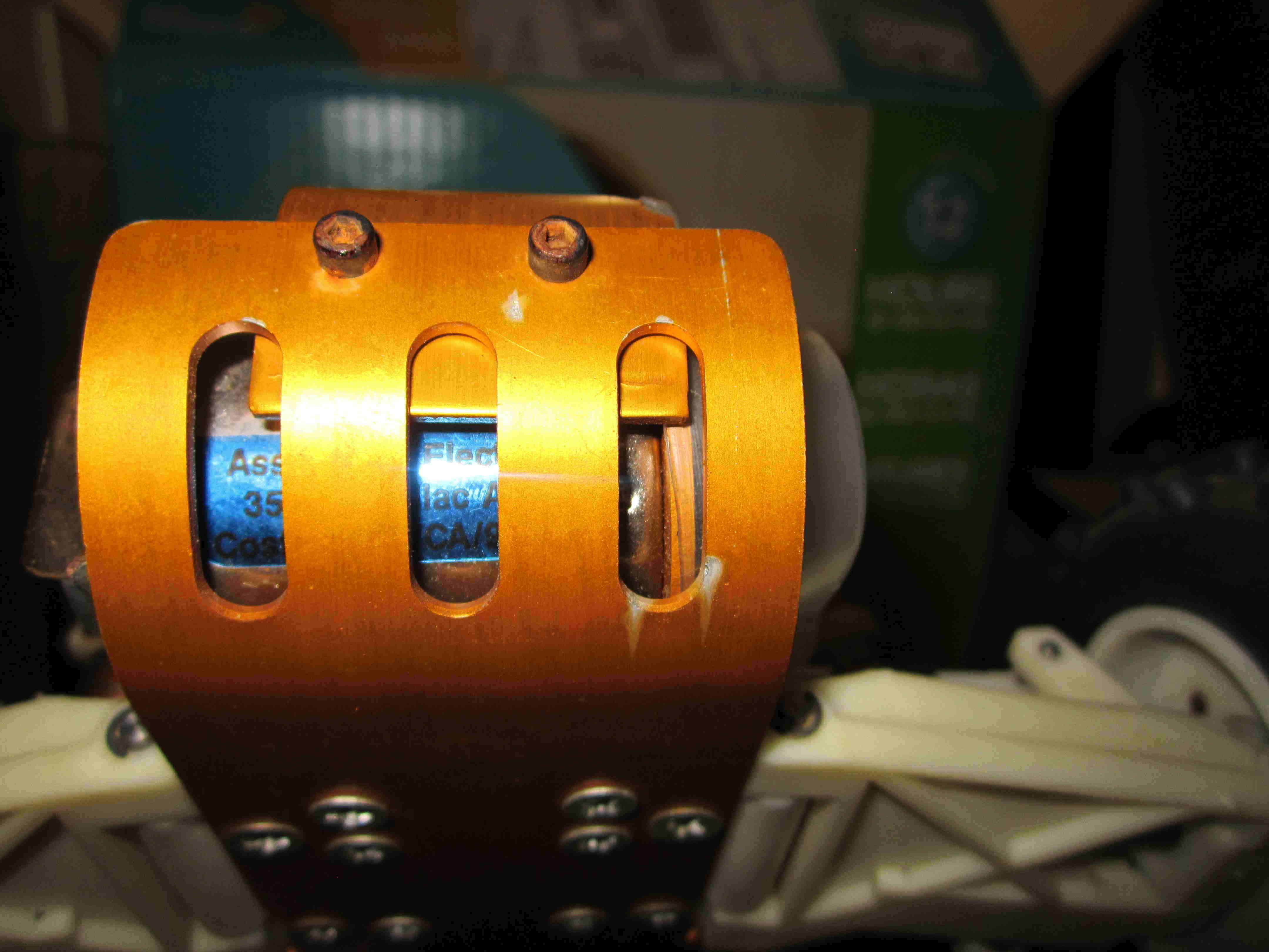

Edinger car, The front plate is a little lighter than the other parts on the car.

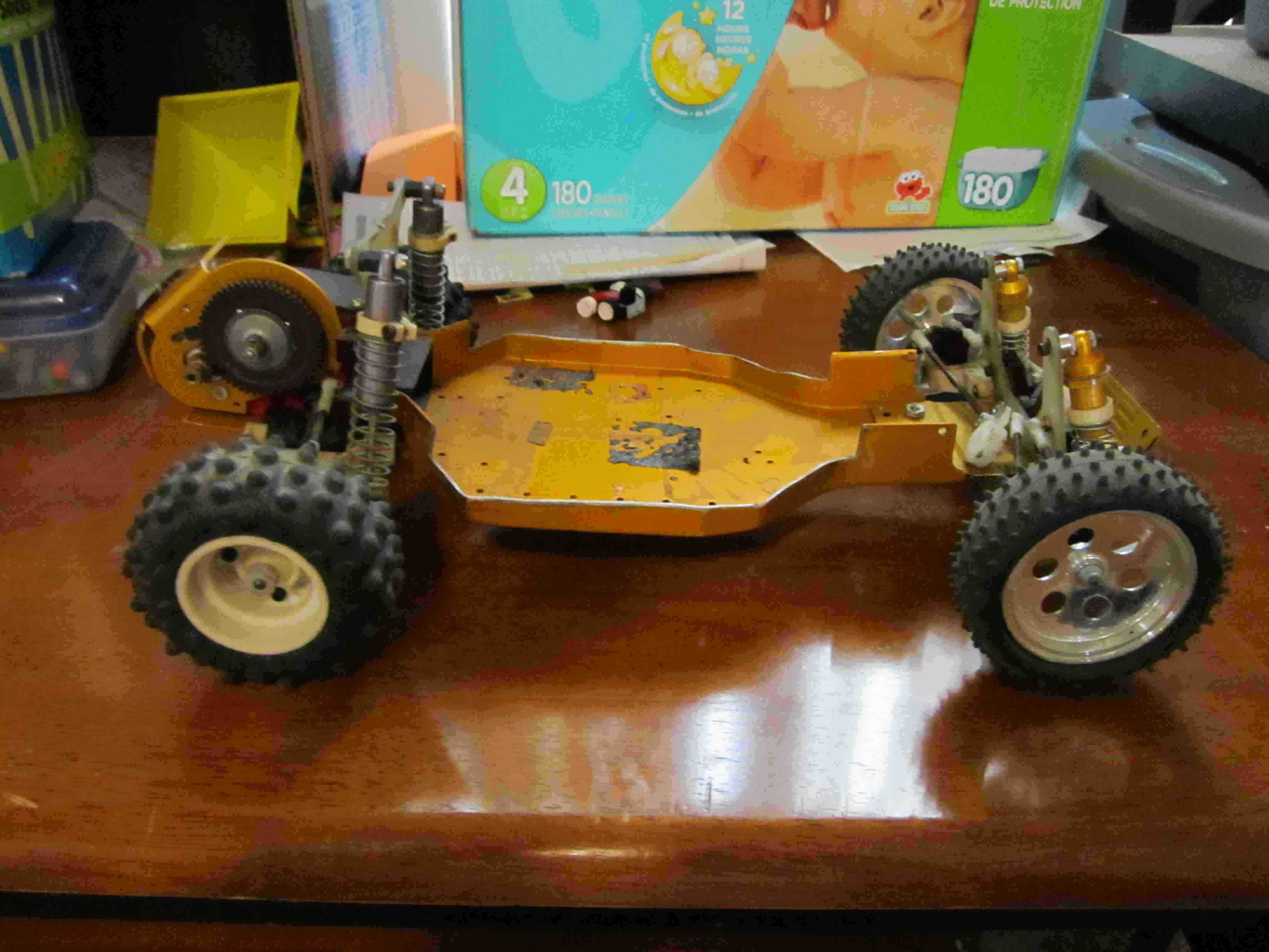

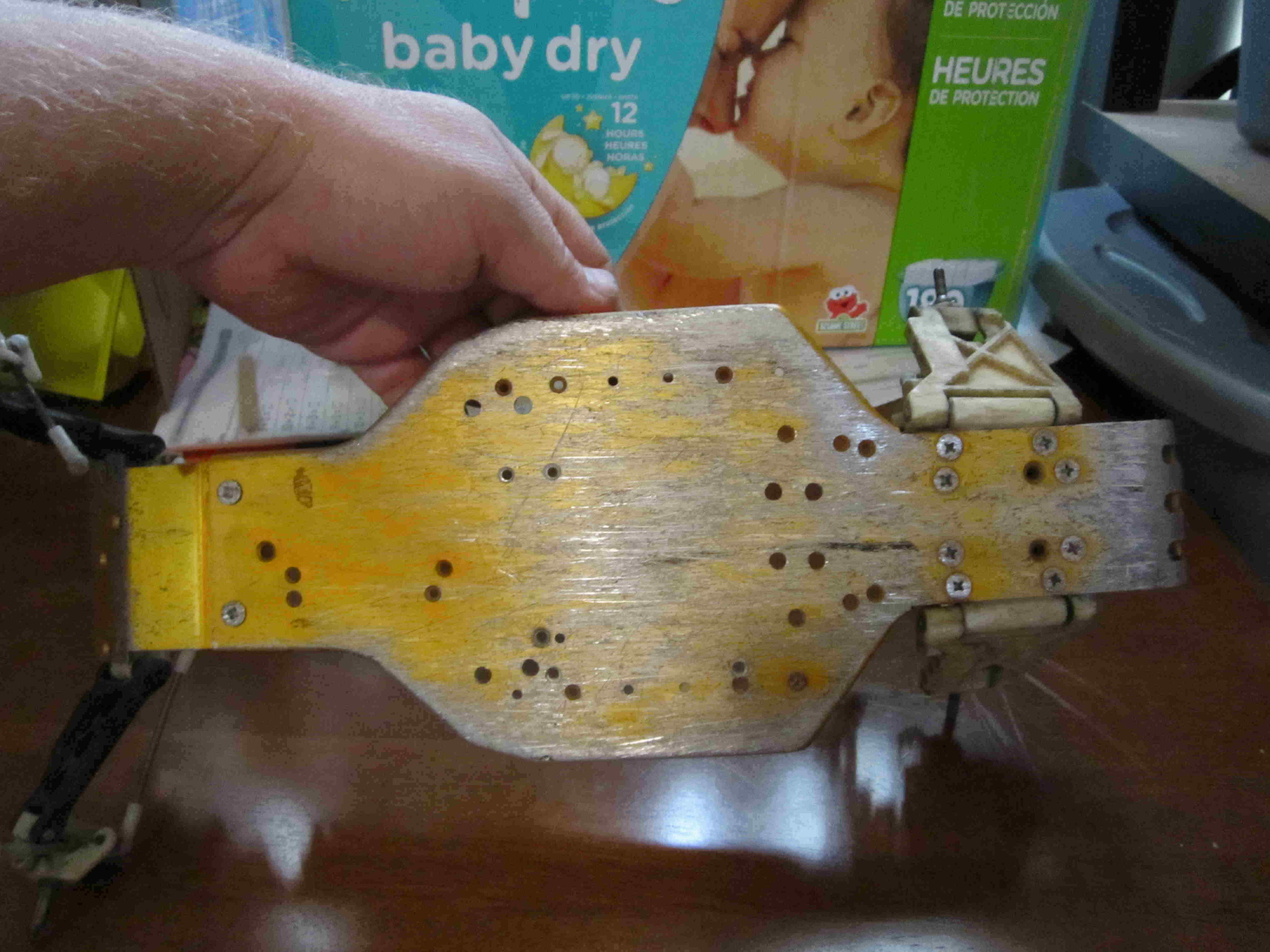

The bashed A stamp. I used the front shock tower off of this one to replace the broken one on the b stamp car. This one also only came with front bottom load shocks on it. No rears. This one also has aftermarket front arms on it. Not sure exactly what brand they are.

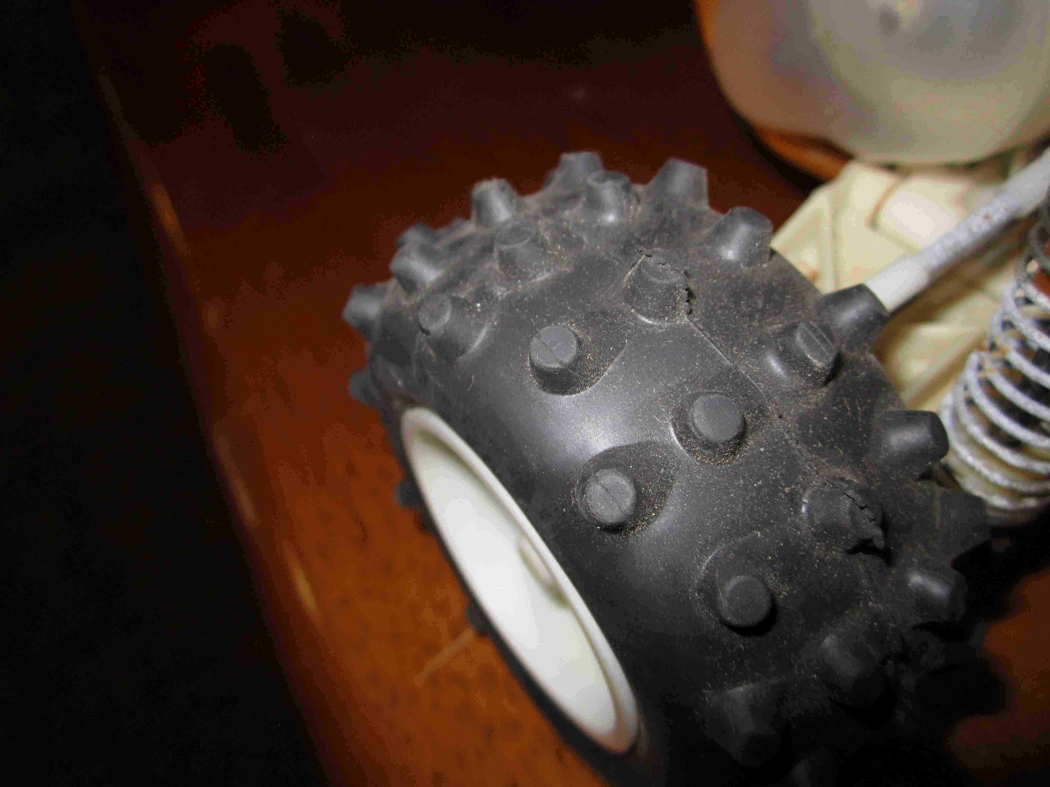

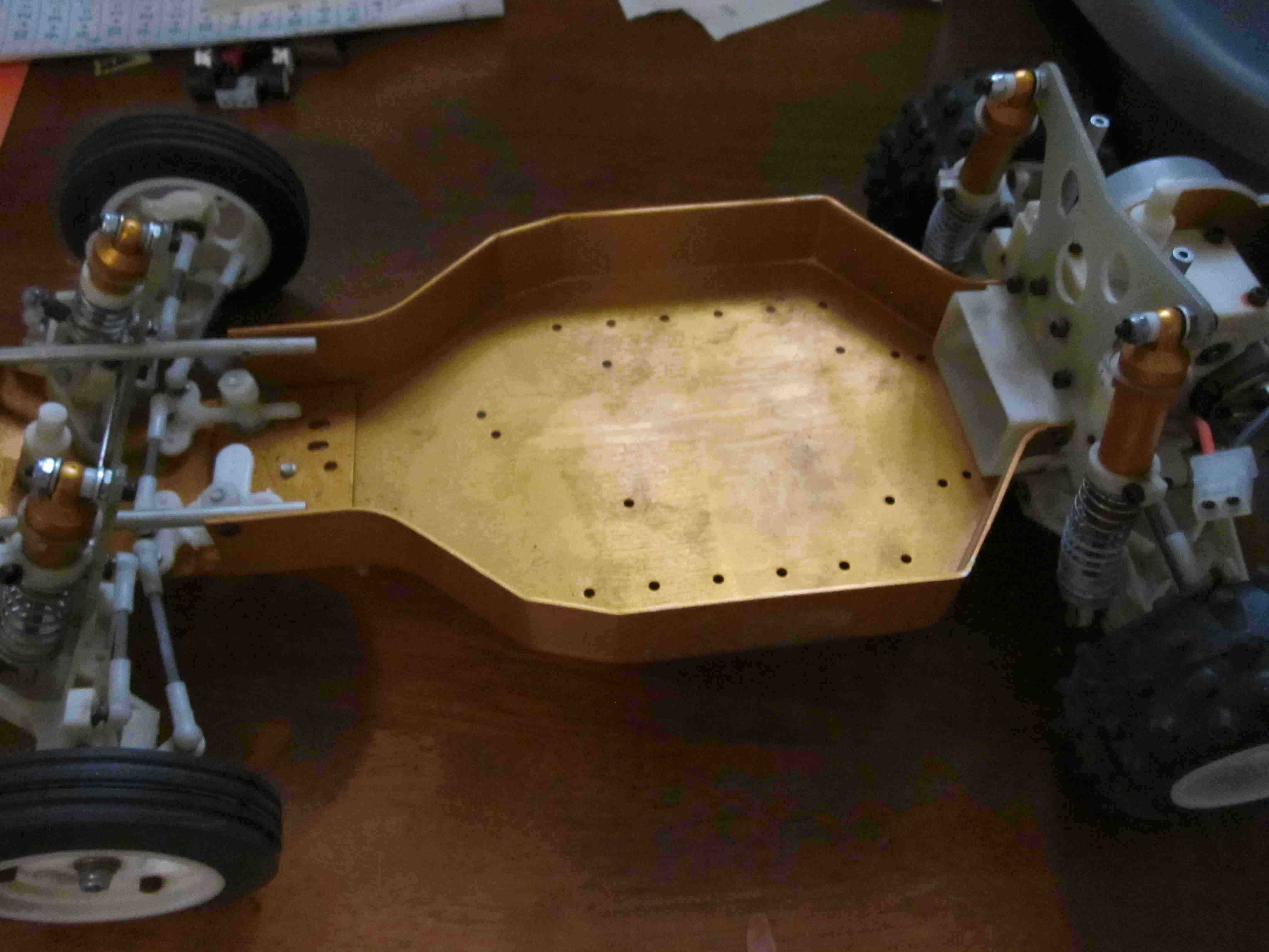

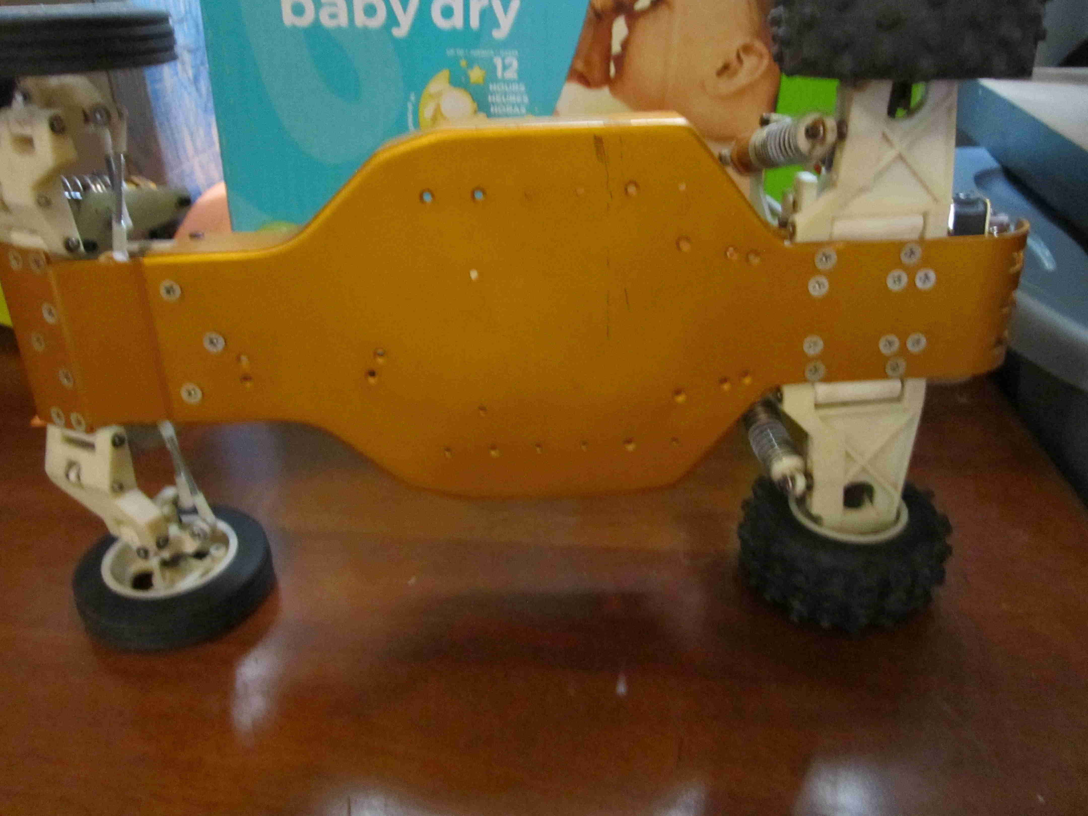

The unused A stamp car. Havent had a chance to clean it up yet.

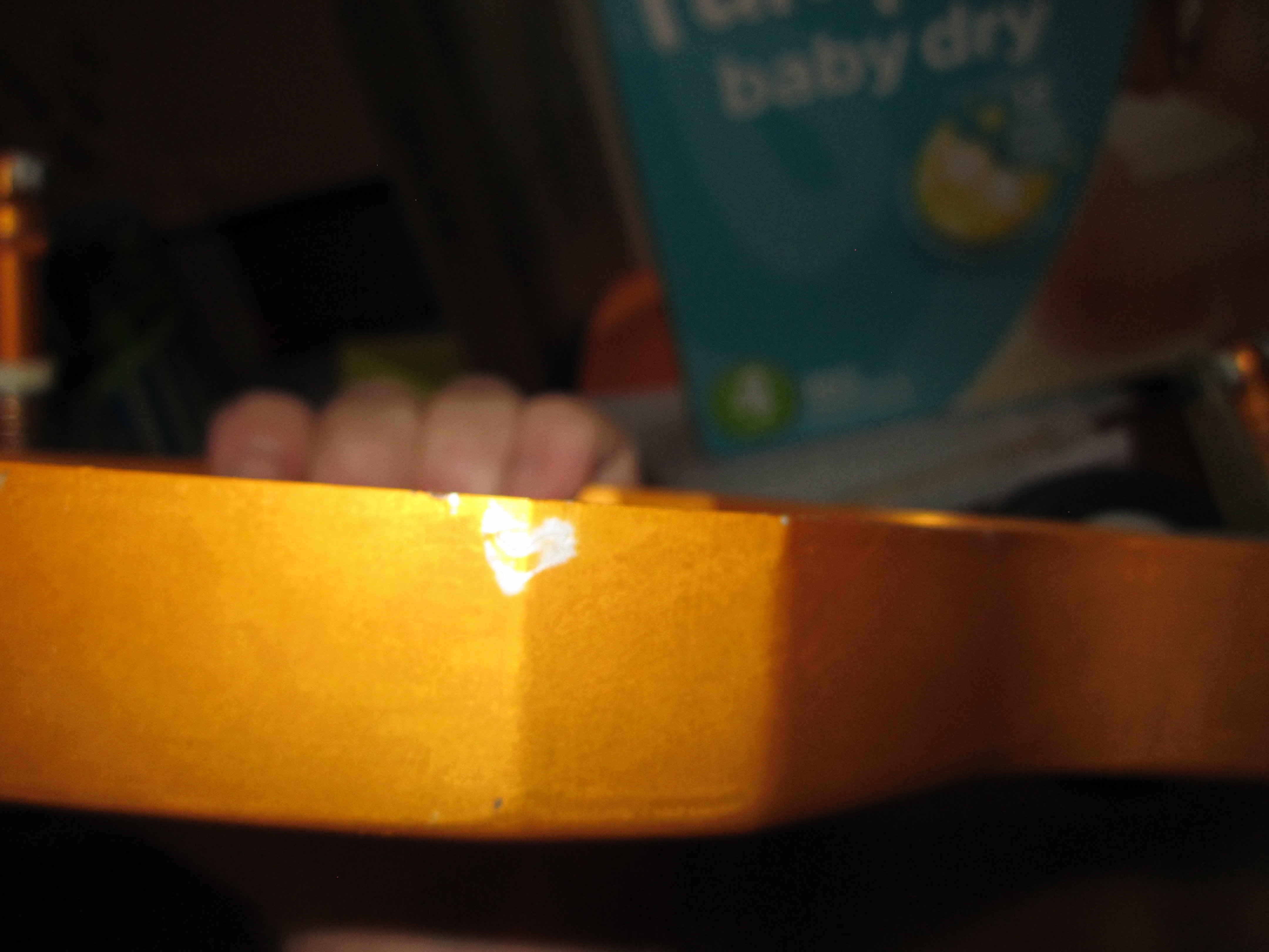

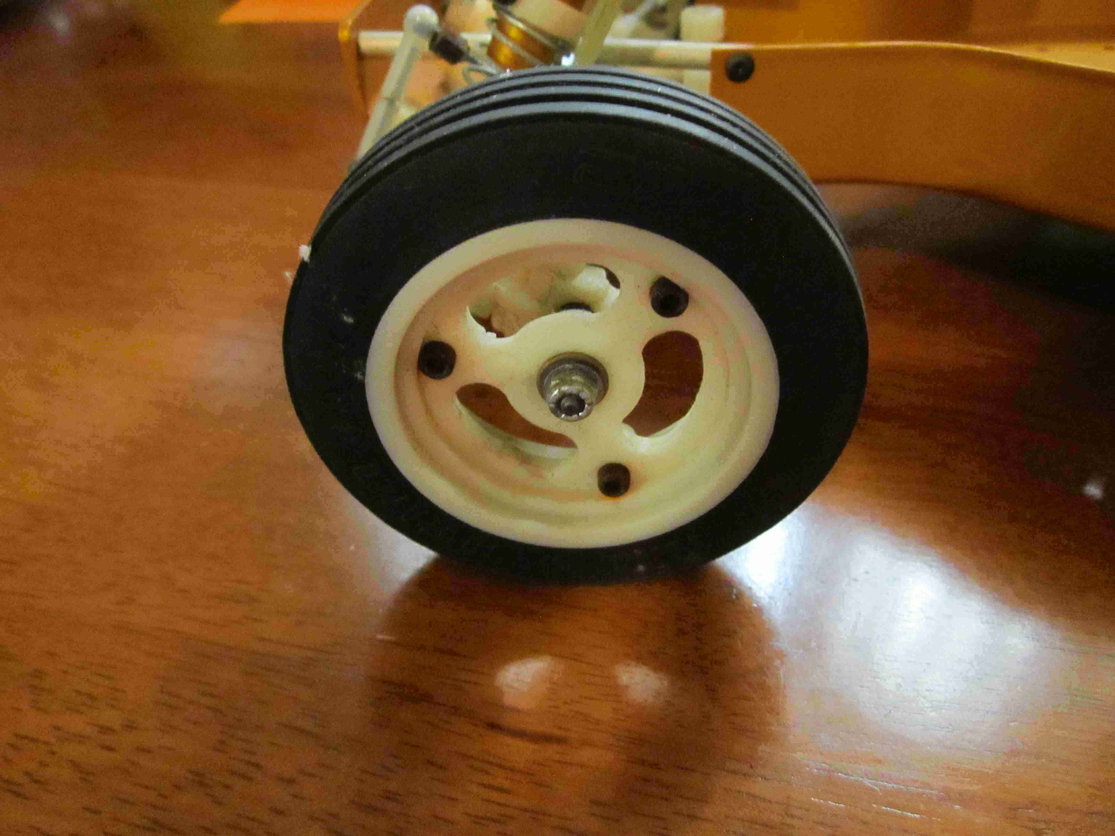

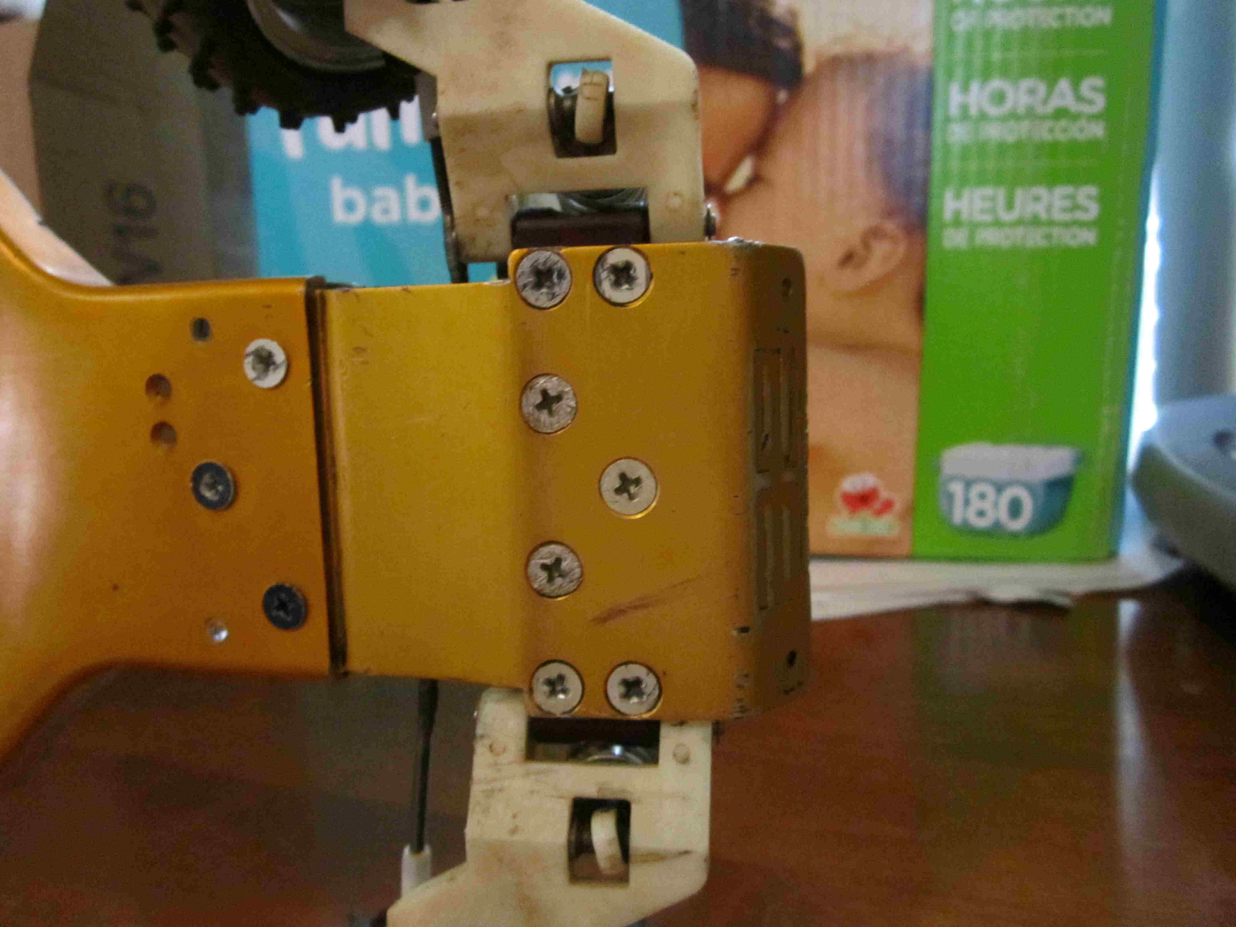

Poor anodizing on the unused car. Those are not scratches or rub marks. The anodizing on this car in general looks different than the others, like it is not as "thick" of a finish as the others. The ae stamp on the front plate is also not as refined as the others. I'm assuming this car was manufactured on a Monday......

The 'aftermarket' arms appear to be stock Kyosho Ultima arms.

If you keep the cut down chassis, radius the areas that were cut. that sharp 90 degree angle will be the spot where the chassis cracks, or bends. Look up other milled and cut down chassis' to see what I mean.

I also looked over the edinger car good last night. I don't think there is much left of the original car anyway. Not really worth salvaging any of it.
