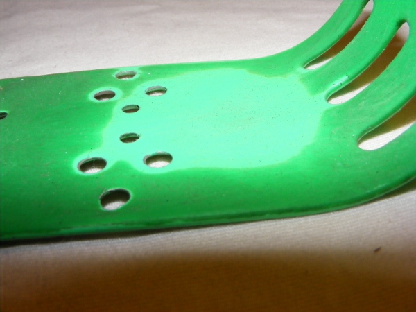

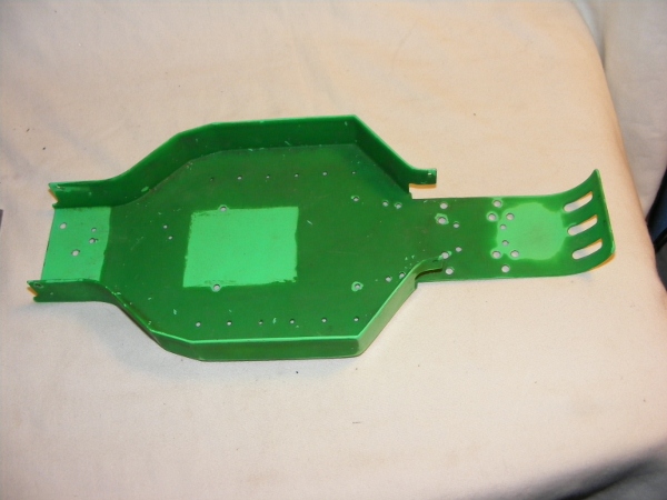

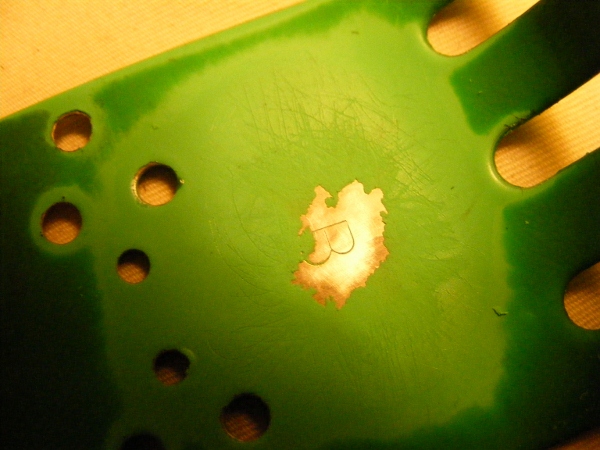

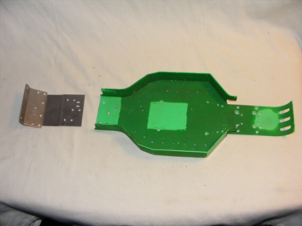

Here's the deal. I got this chassis a couple years back. It had a mint yellow nose and lime green chassis. Well someone must of wanted it all green. They used probably a whole can of Rustolum in probably 2 coats. As soon as I thought about using chemicals the paint started peeling. What a shame. Anyways I rubbed down the paiint by the stamp and don't see one. Guess now I'm gonna rub that paint off like a gennie and a lamp.

Are the forward battery box holes centered?
K-TOWN-KITT
Posts: 199
Joined: Wed Mar 27, 2013 9:26 pm
Location: Buffalo, NY
Re: Do vintage factory painted chassis's have any stamp?
Post by K-TOWN-KITT »
it be a B.

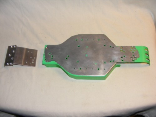

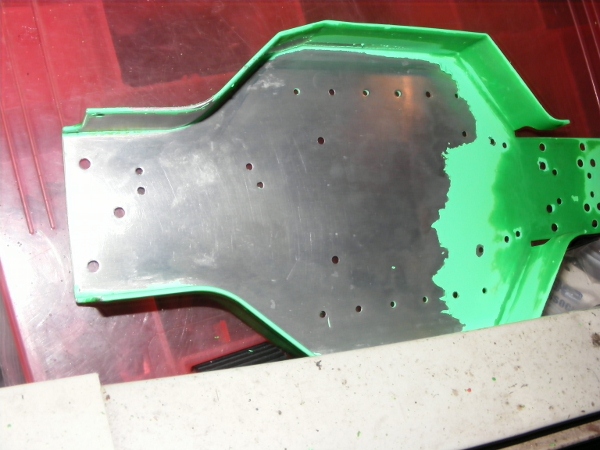

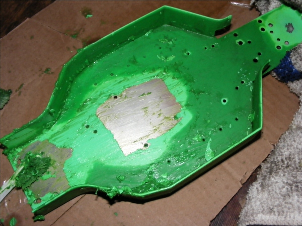

Going a few more rounds. Yuck. There is an unannodized chasis under there somewhere. Been using Goof Off but at this rate it will be several hundred hours to get clean. Any suggestions?
RC10resto
Posts: 3009
Has thanked: 1488 times
Been thanked: 550 times
Post by RC10resto »
Lacquer thinner should cut a lot quicker than Goof Off
jwscab
Posts: 6580
Location: Chalfont, PA
Been thanked: 505 times
Post by jwscab »
Carb cleaner should also remove it

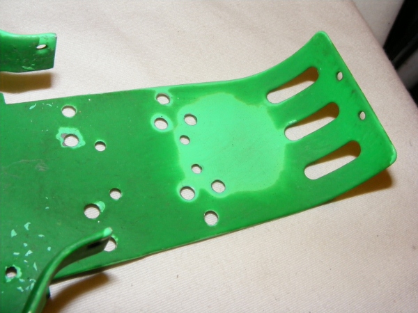

2 hours later. I'm going to try the carb cleaner tomorrow. I have inhailed enough fumes for the evening. After I got that far I wiped the chassis down I rinsed it in warm water. The paint became like a rubber and started peeling off. I only used a soft toothbrush and it left little spider scratches. The anno must work like a surface hardener on the aluminum.
