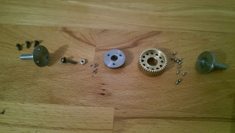

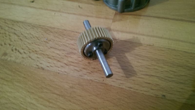

wow exactly a year since i started this thread and finally got round to sort of finishing it mainly due to my other project/thread.bit of a theme developing here still not perfect and needs a bit of refining but functioning tho it seems to have loosend itself off.
not sure if i will have to put a kink in the thro bolt like the thorpe diff and resize a couple of bits but fairly happy with it.its a bit of a hybrid of both types.

thanks dan,very informative post,apart from the aftermarket brass gear i fabricated the whole thing myself but im a very amateur machinist so this was the easiest/least parts design for me to attempt.as im just a very occasional basher and not a serious racer im hoping this will hold up okay for me,i can remake pressure plates as and when i need to.
stupid question time ive read about the bent screw but whereabout do you bend it tip, middle or allen bolt end?

I would machine and tap out the opposite side and use a jam screw ie. grub screw. That will lock perfectly and you don't have to damage the through bolt.
To answer your question, typically it's bent where it is threaded into the diff half.
