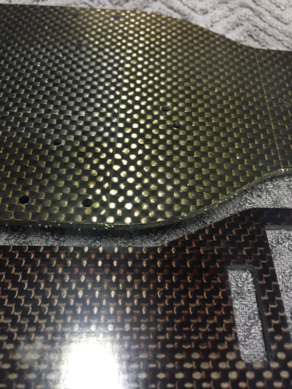

I'm looking to start building my Graphite WOIN and my graphite chassis has a yellowish tint to it I'd like to get rid of. It's tinted or tarnished as if it spent years in a smokers house. My 10L chassis is 16 and has not tarnished at all. Does anybody have any recommendations to remove this?
Here you can see that under the battery cup and steering arm blocks the original color as preserved which makes me think it's cigarette smoke.
You can see the difference in color over my 10L chassis.

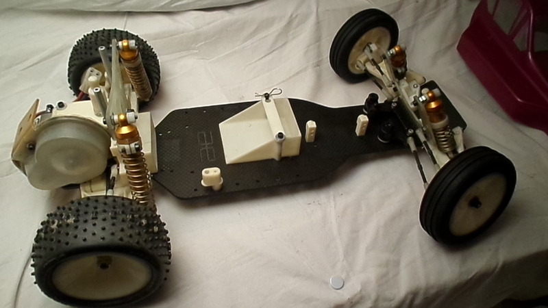

Mine looked exactly like yours mate, I tried wax and grease remover and polish without luck.. The uv staining tends to be more than just on top of the surface it's slightly under it also.. Still takes ages to get out with fine paper and you don't remove much. Mine still has a couple of scratches... We used to get a similar uv damage to some veneers. Will try and find a pic of original chassis condition for you..
bully
Posts: 759
Joined: Mon May 31, 2010 6:08 am
Location: Perth W.A Australia
Been thanked: 6 times
Re: Graphite Chassis Tarnish Removal.
Post by bully »
Hard to see but there is a light section in front of bulkhead, the rest looked exactly like yours...

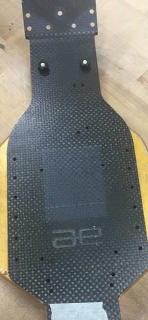

Thanks Bully. I used a little never dull or something like it to polish the chassis. It comes in like wool wads in a can is just slightly abrasive. I polished it by hand and then used my Dremel to buff it off. It made enough of a difference for me to move forward. I was just Leary of sanding it. Thanks again everybody. Once I get a few more parts I may start to build it.
The differences are a lot less noticeable now.
