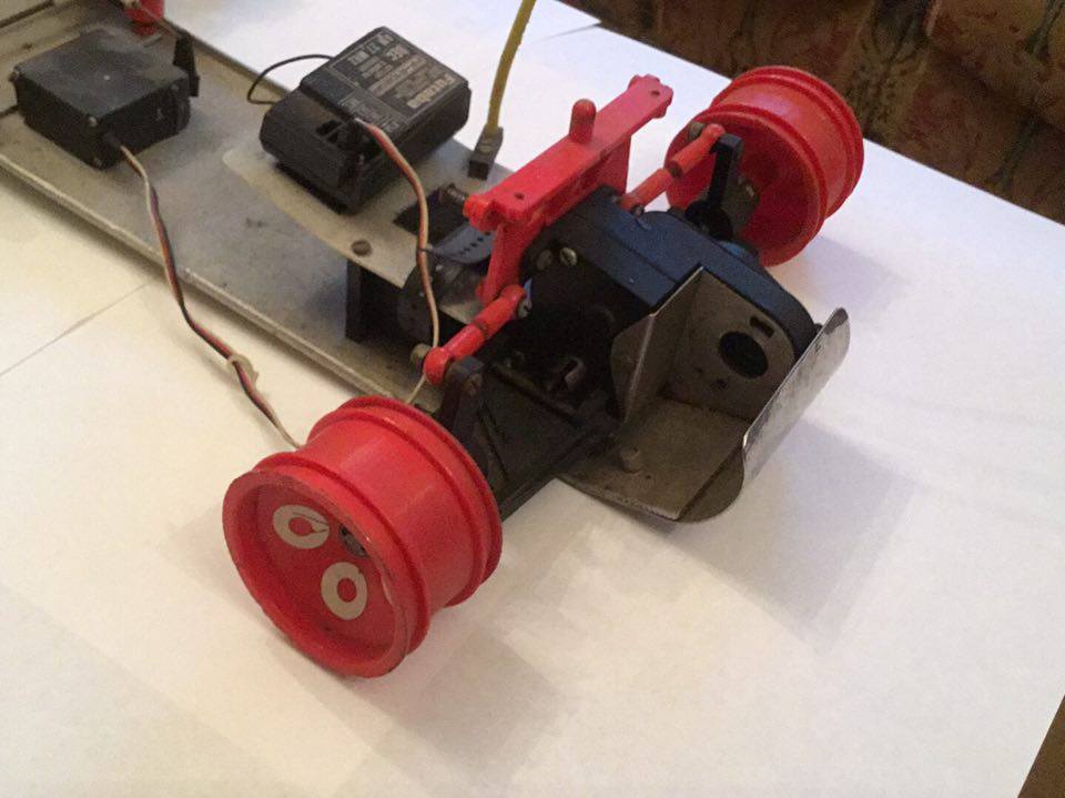

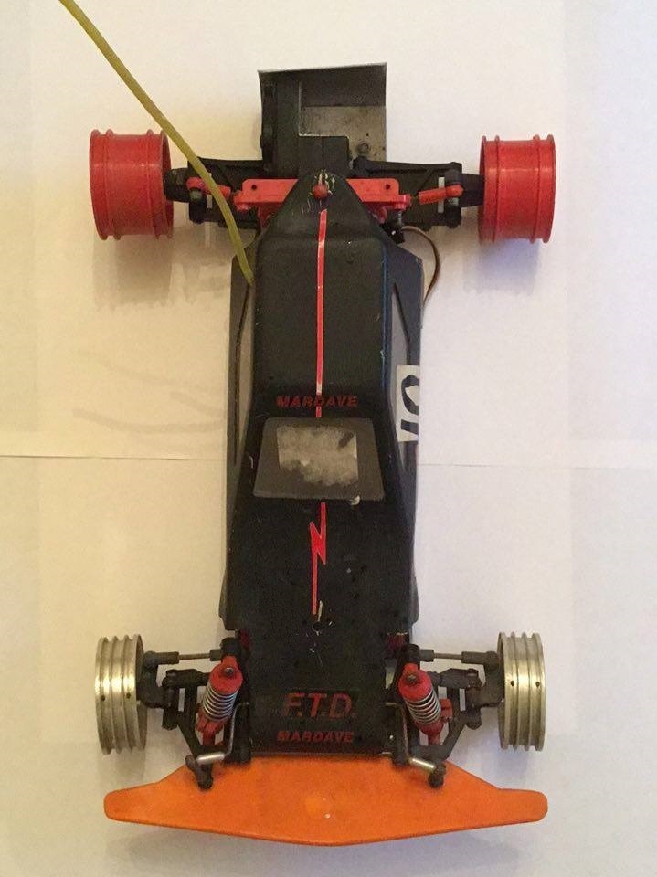

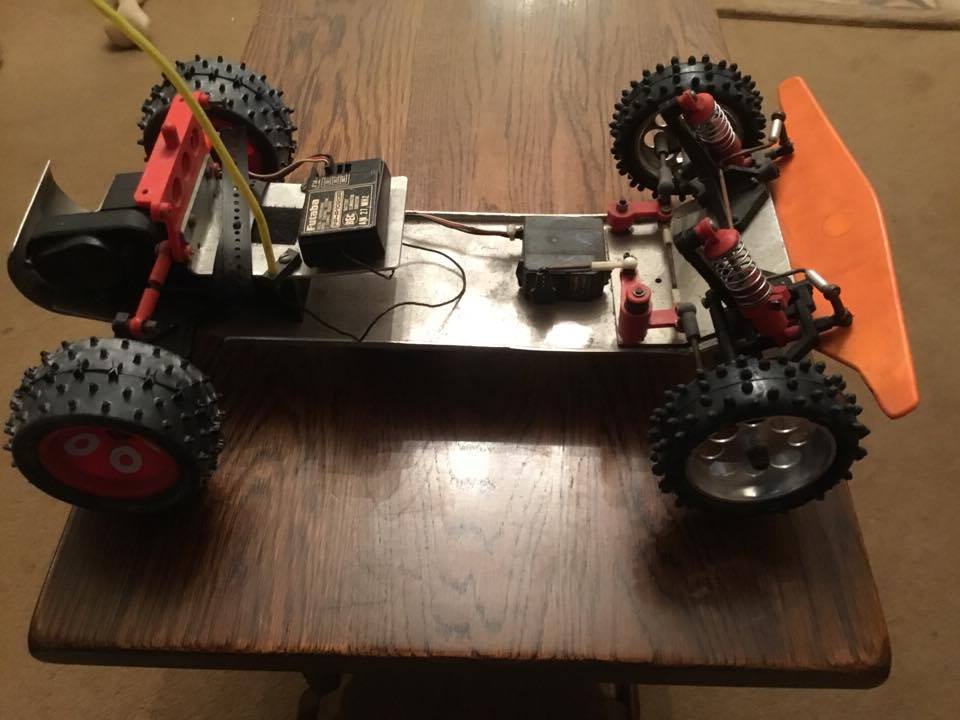

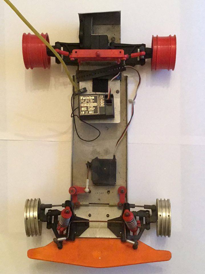

Hmmmm… and here it is as found. The very definition of basic. (It had some crazy stickers on it when it arrived, which I had to remove as the blue and pink colours were messing with my OCD).
I plan to give this a thorough work over purely out of nostalgia really. Some great memories hidden within this car for me, and I am totally chuffed to have it back again. I never even realized that Mardave came out with the longer front wishbone options, so now I will be on a mission to source a pair of those in an attempt to build something decent I can actually race again. Chassis might need a change out too, as I remember bending it repeatedly on some of the tougher tracks we raced bitd. I kind of like that it was sitting at the ‘Greg Halliday Article 1’ stage of tuning, but I am sure we can do more with it knowing what we know now.
What we were aiming for back then:-

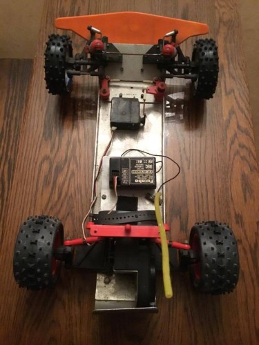

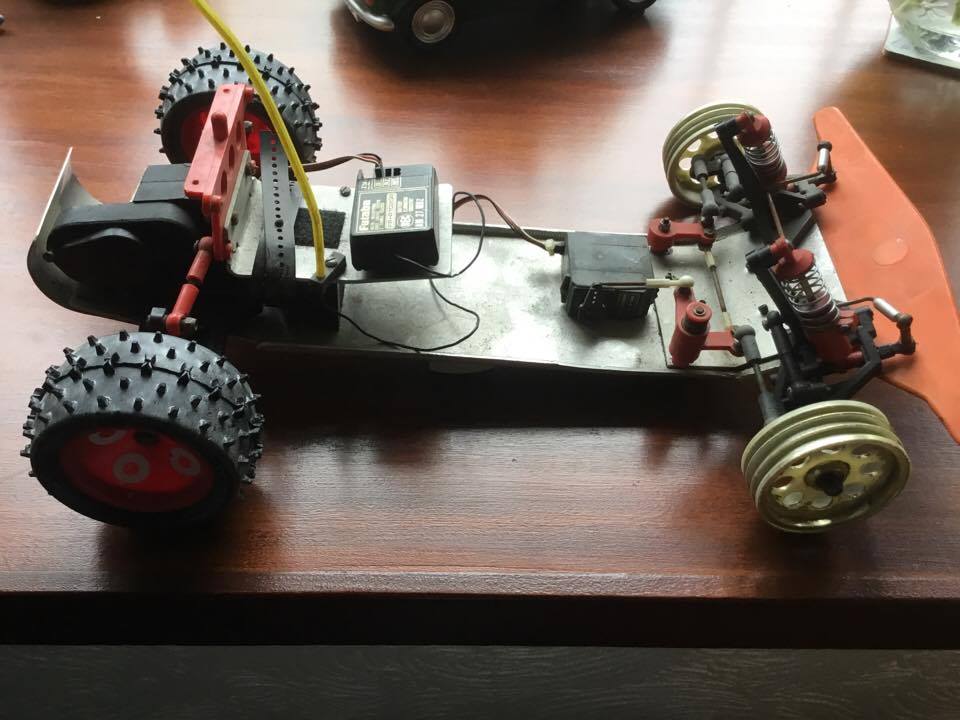

So what we have here is a ‘Dad-Mod’ homemade lwb chassis, complete with side-strengthening ribs, what appears to be additional strengthening at the front fold area (oh Matron) and I am guessing part of the original swb chassis was employed there, RC10 stub axle mod, to allow use of the ballraced Fox wheels, front anti-roll bar, rear chassis brace plate and a well thought out version of the metal motor mount to prevent gearbox flex due to hot running motors. I think the solution my dad came up with here surpasses that of the article in fact.
It has been sat in a garage for nearly 30 years and seems to have survived pretty well.

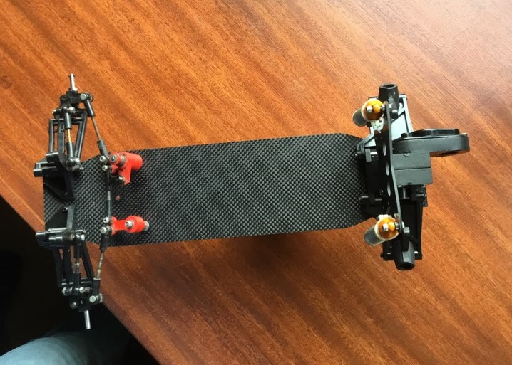

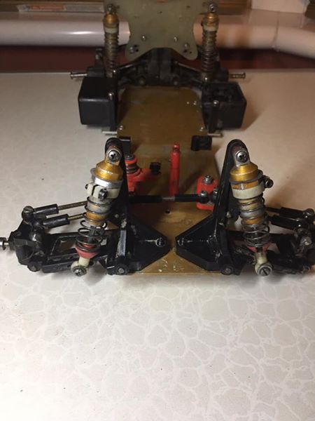

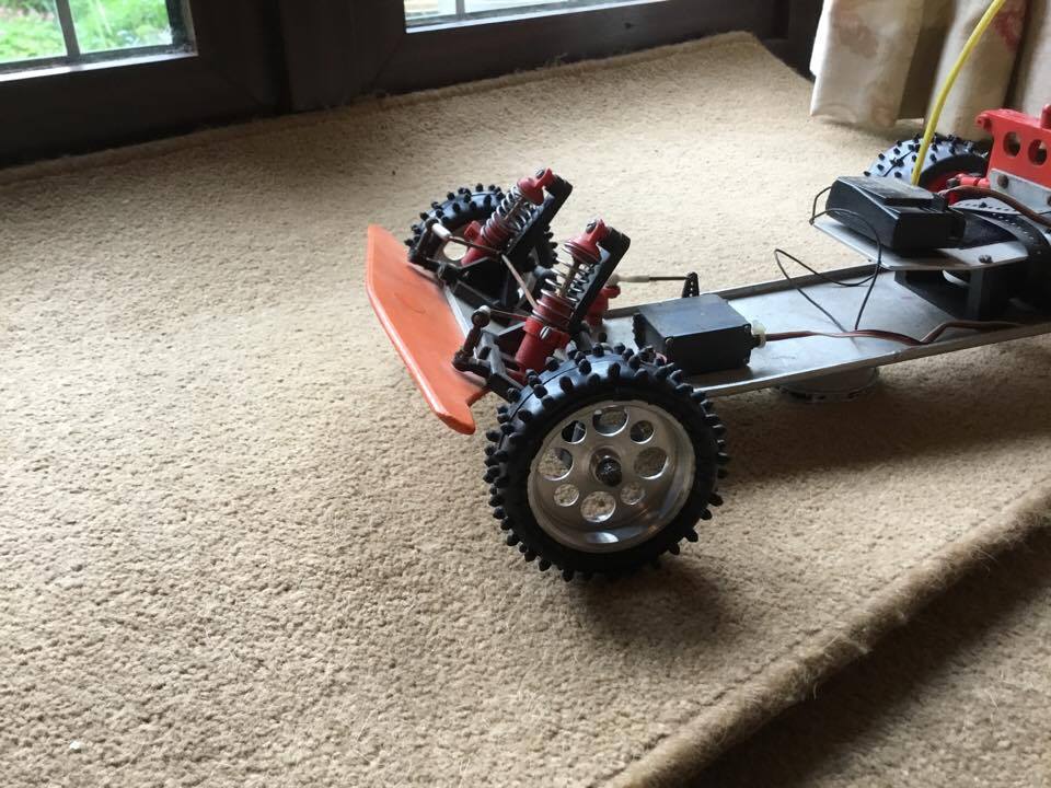

Quick shot of the LWB car i bought today. You can see the gold lwb chassis complete with narrower front end and also see how much closer together the front shock towers are to compensate for the lesser-spotted long front wishbones.

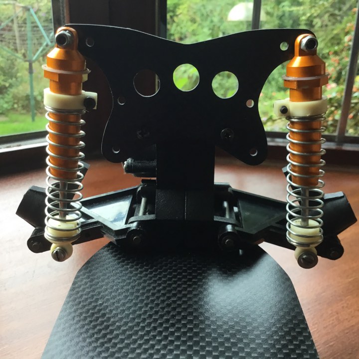

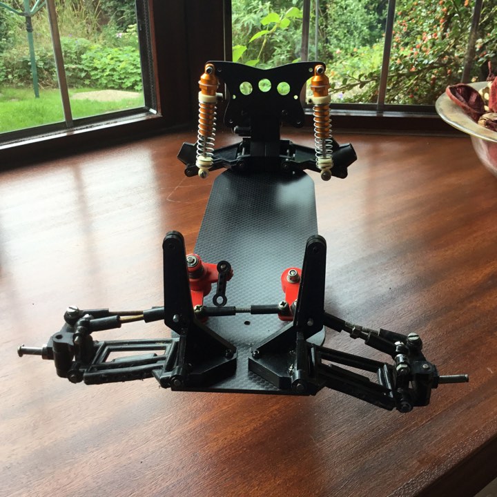

Bit of a transformation. Progress so far....

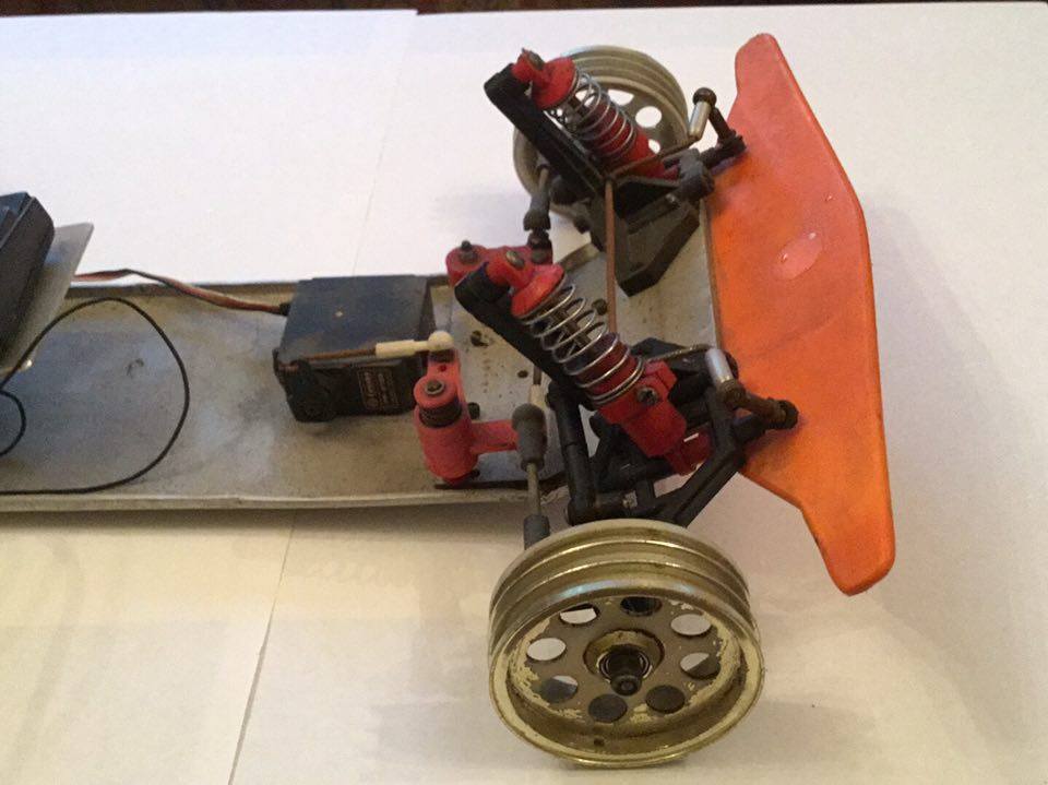

We made our own LWB chassis bitd (as can be seen in the initial pics on this thread), and that had a built-in motor guard which has a few more beans than the original Mardave item. We are coming up with a different solution for the rear end of this new CF chassis however.
