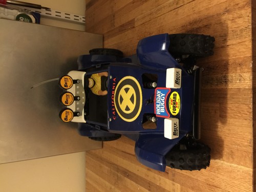

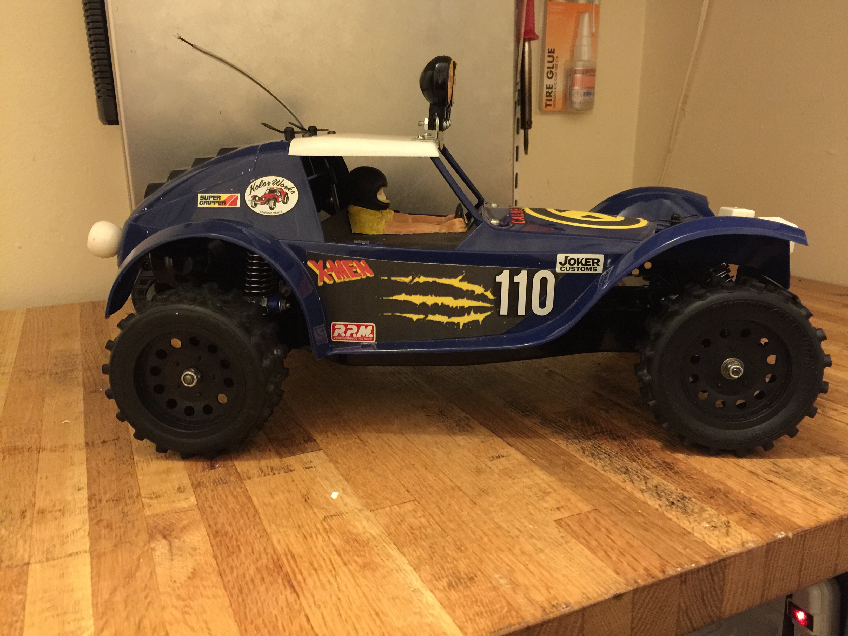

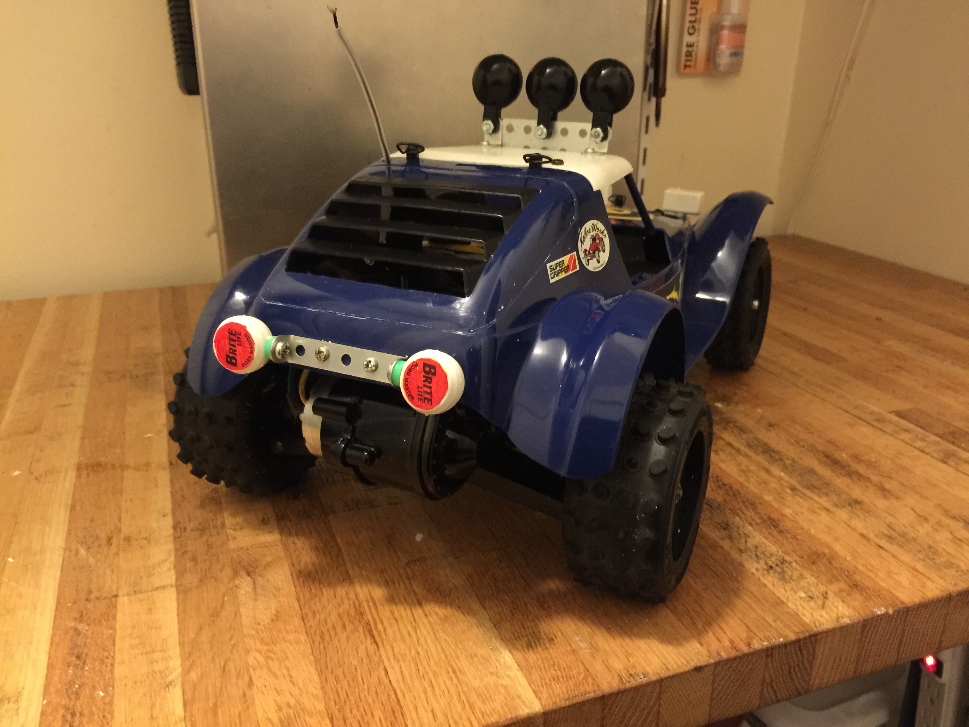

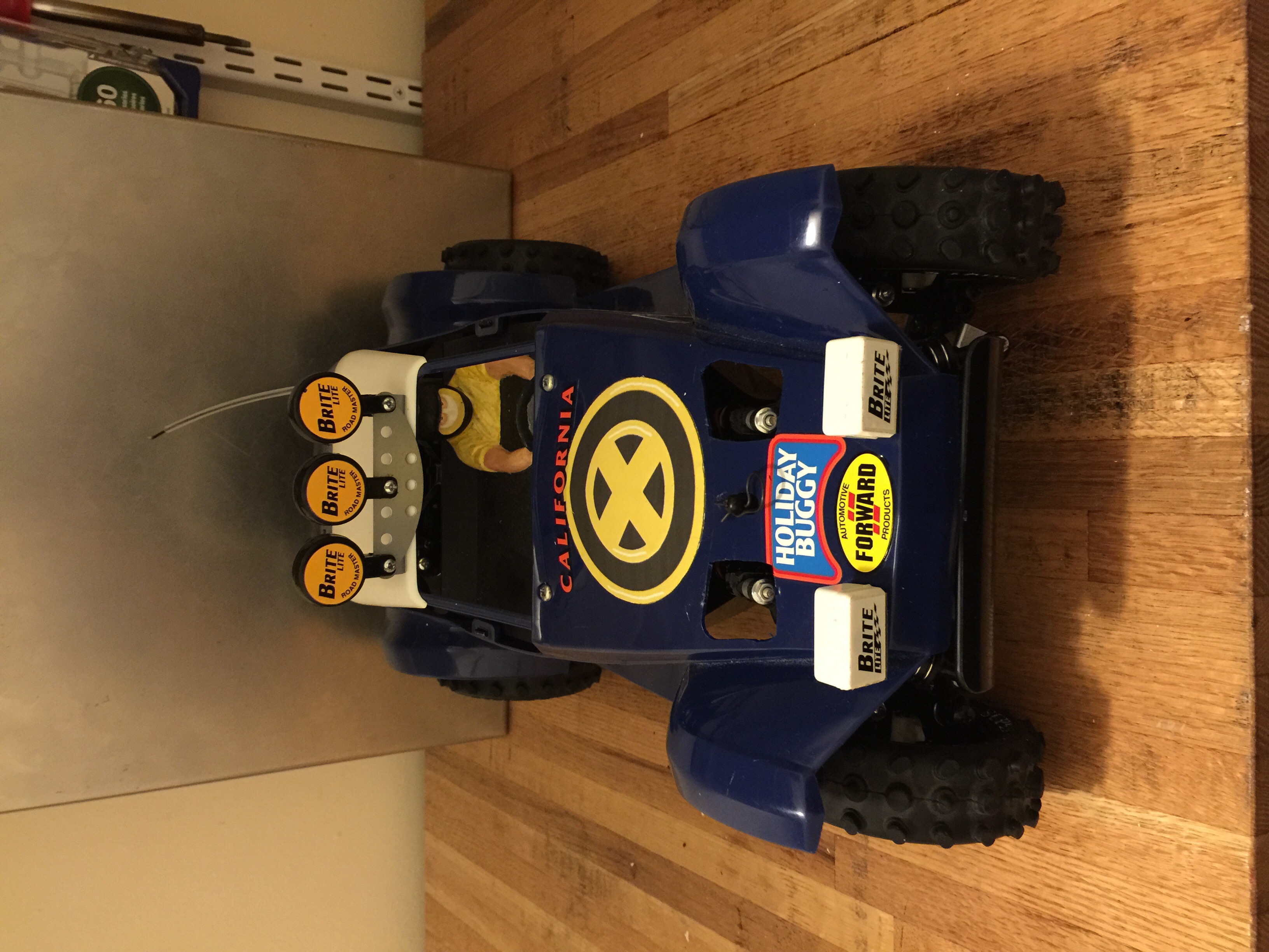

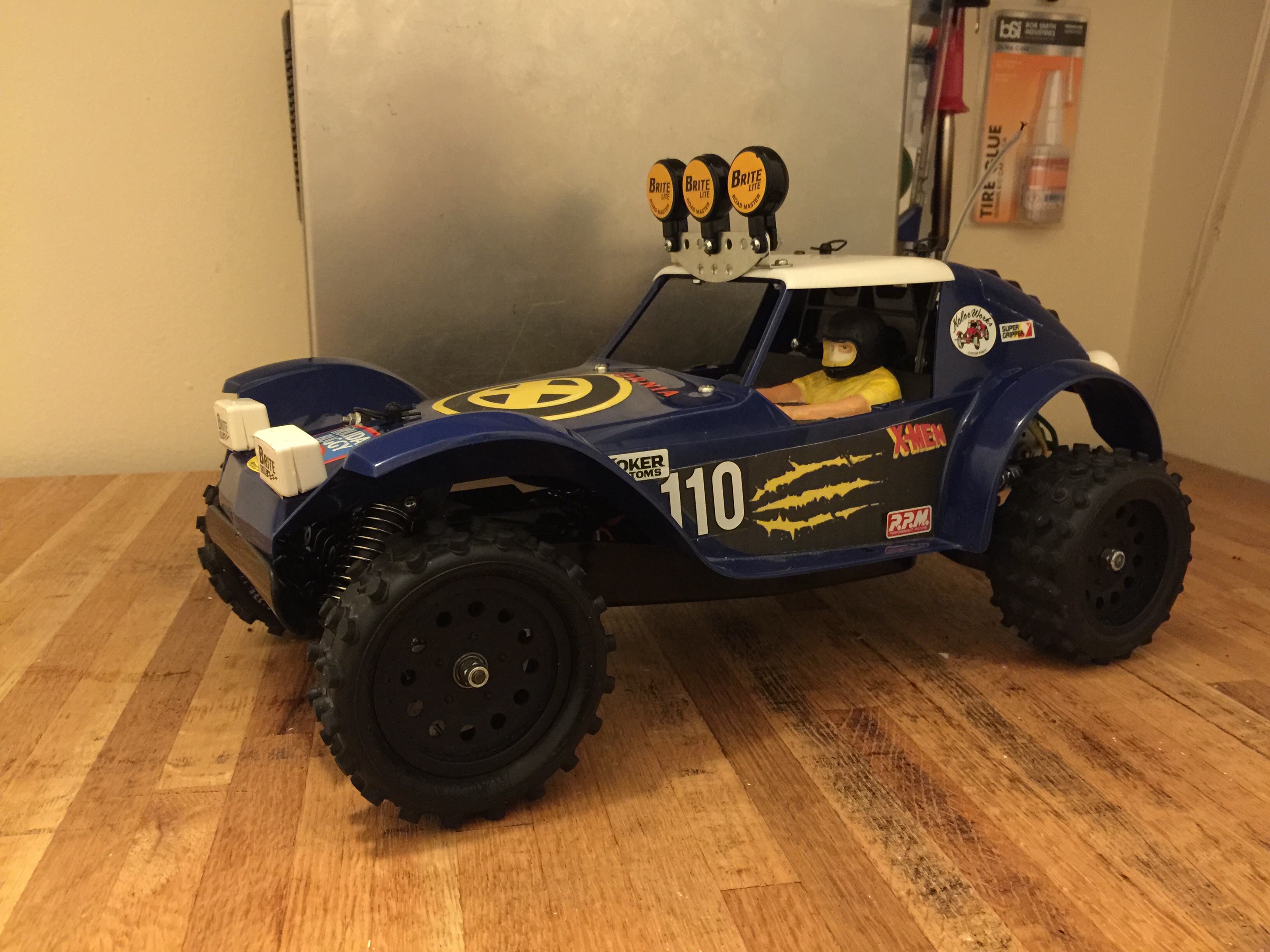

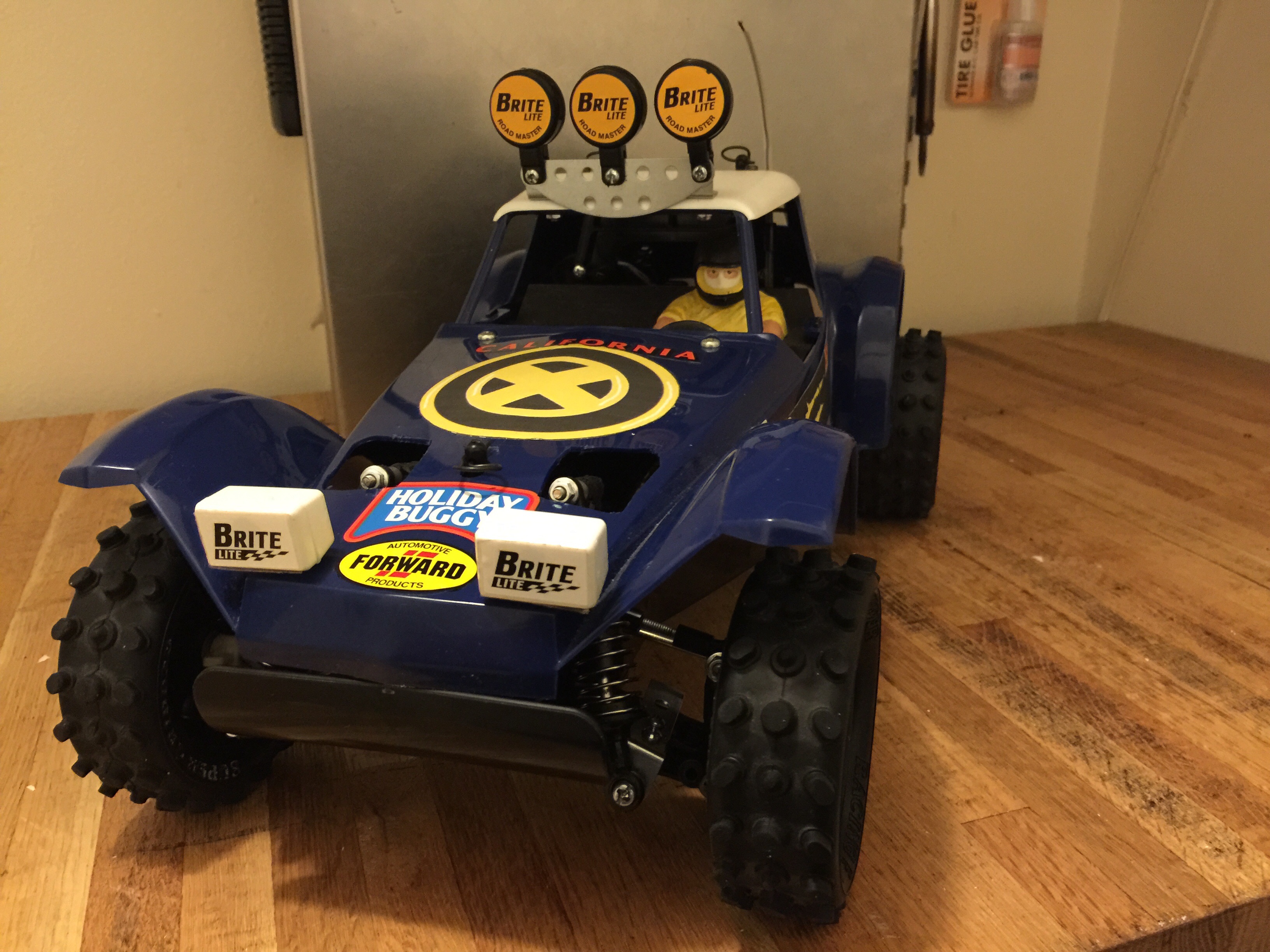

Here's my daughter's 2010 Holiday Buggy,
She's a big fan of the marvel universe, specially Wolverine, hence the motif....I'm a big fan of not leaving rc cars in their stock form, so I took it upon myself to narrow the track...
Rear:
Fox arms, axles, hubs, outdrives and dogbones.
Front:
Cut down stock arms and relocated the shocks.
Traxxas radicator 2.15 wheels and Tamiya Hotshot tires.
Still need to paint the tail lights and tidy up the suspension...
Rear:
Front:

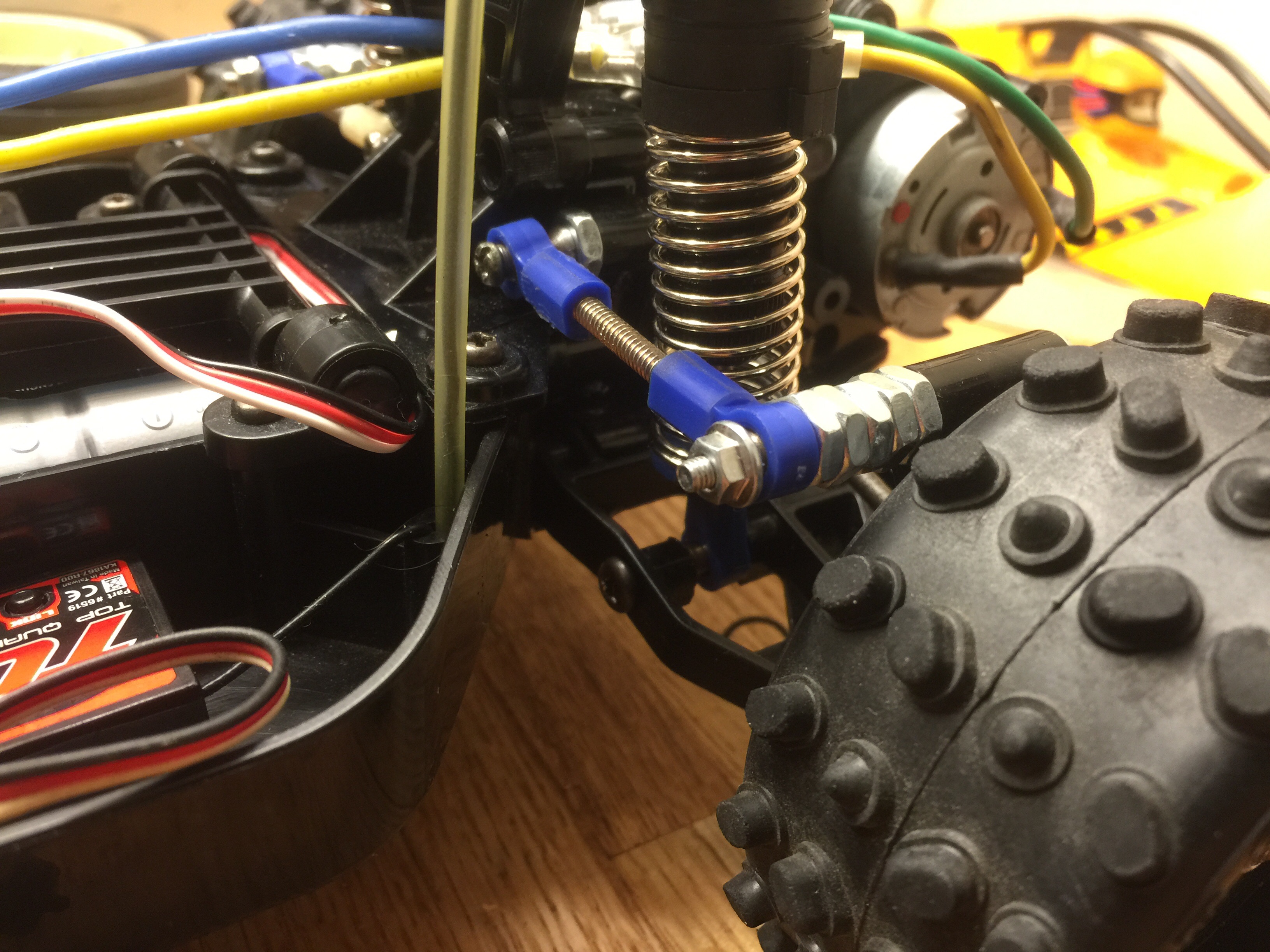

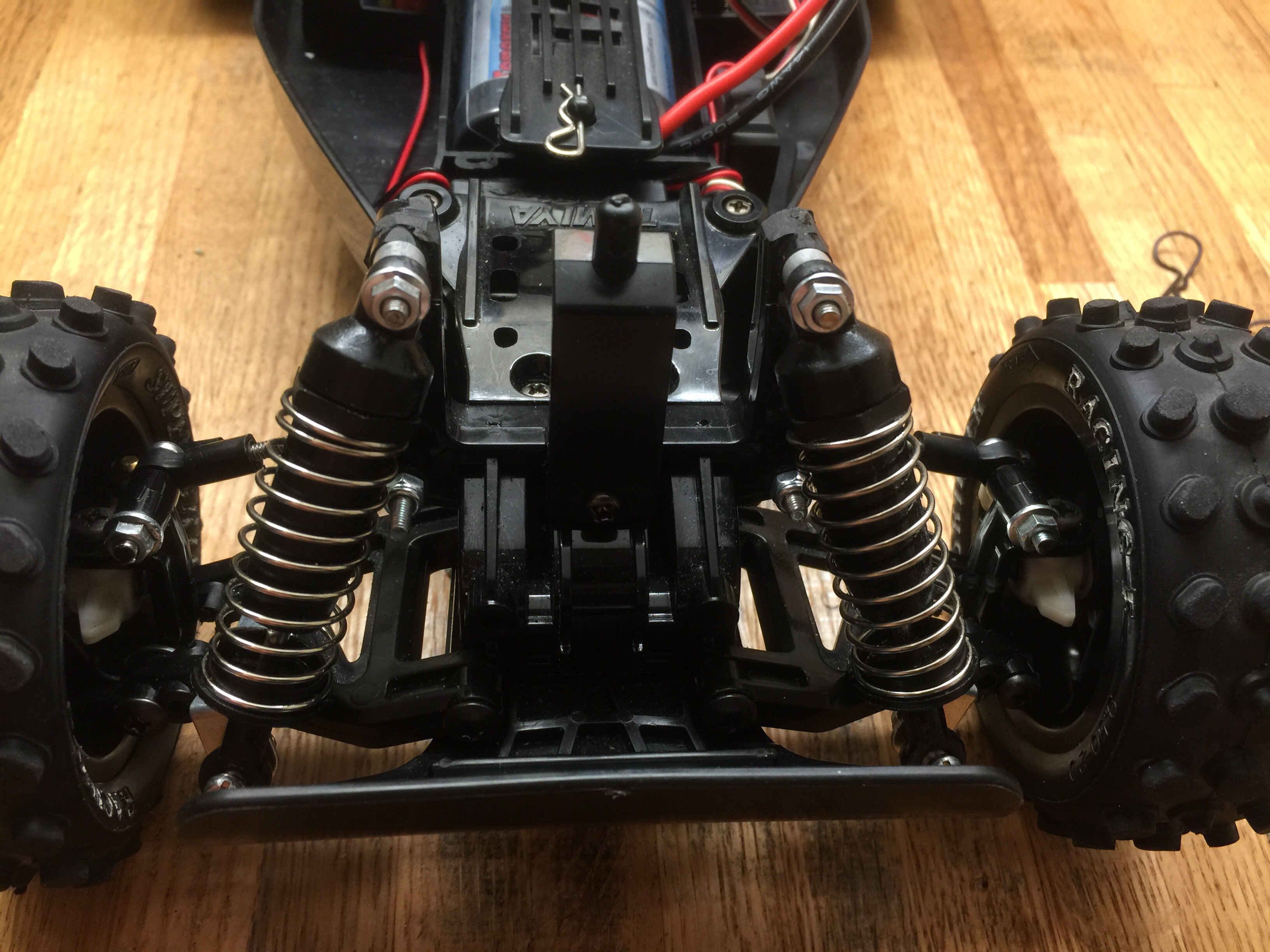

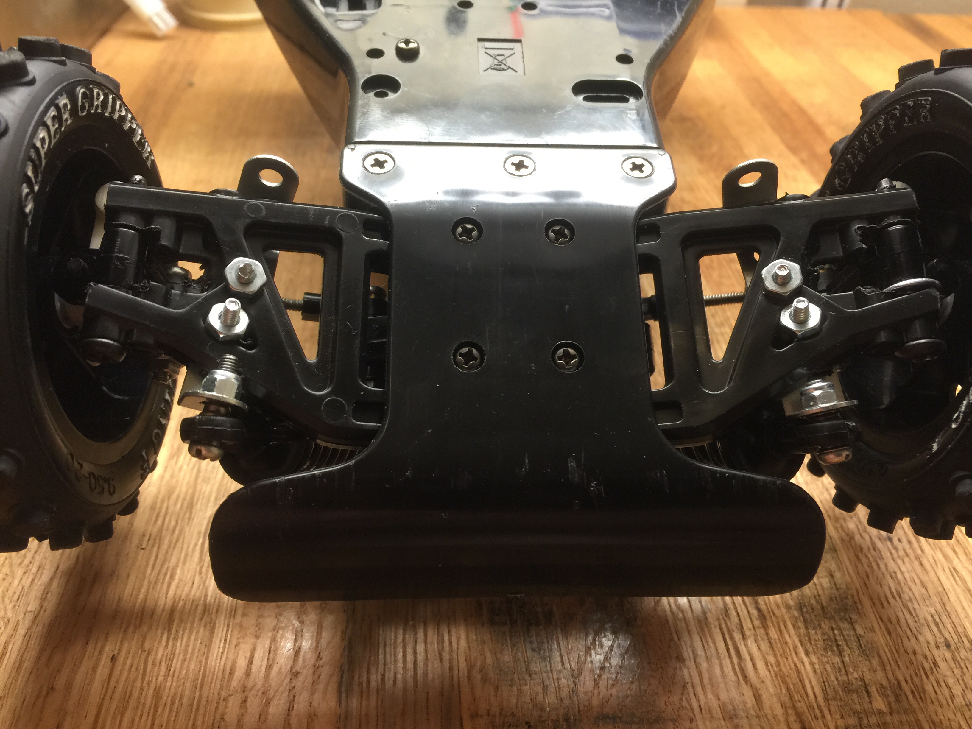

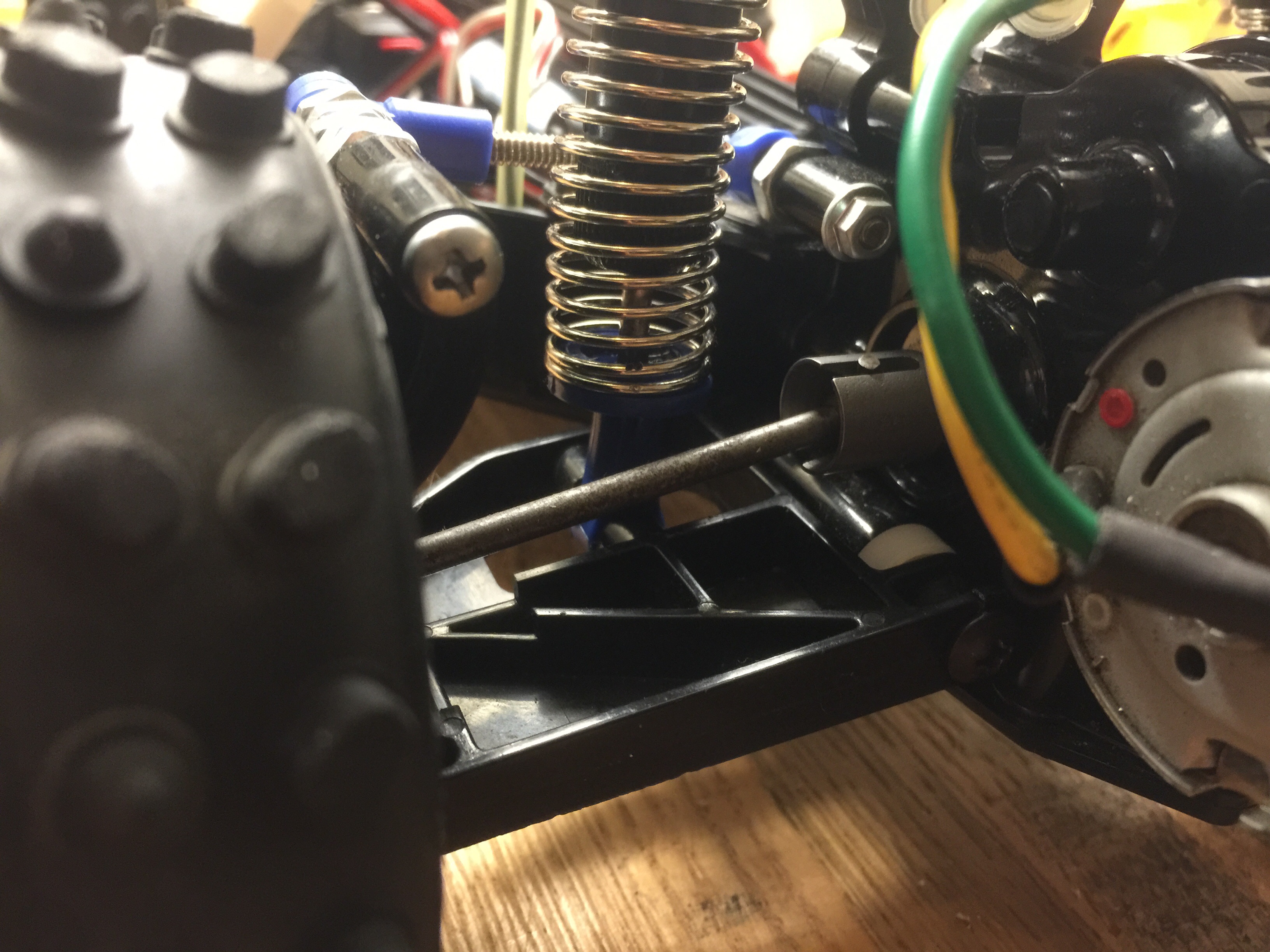

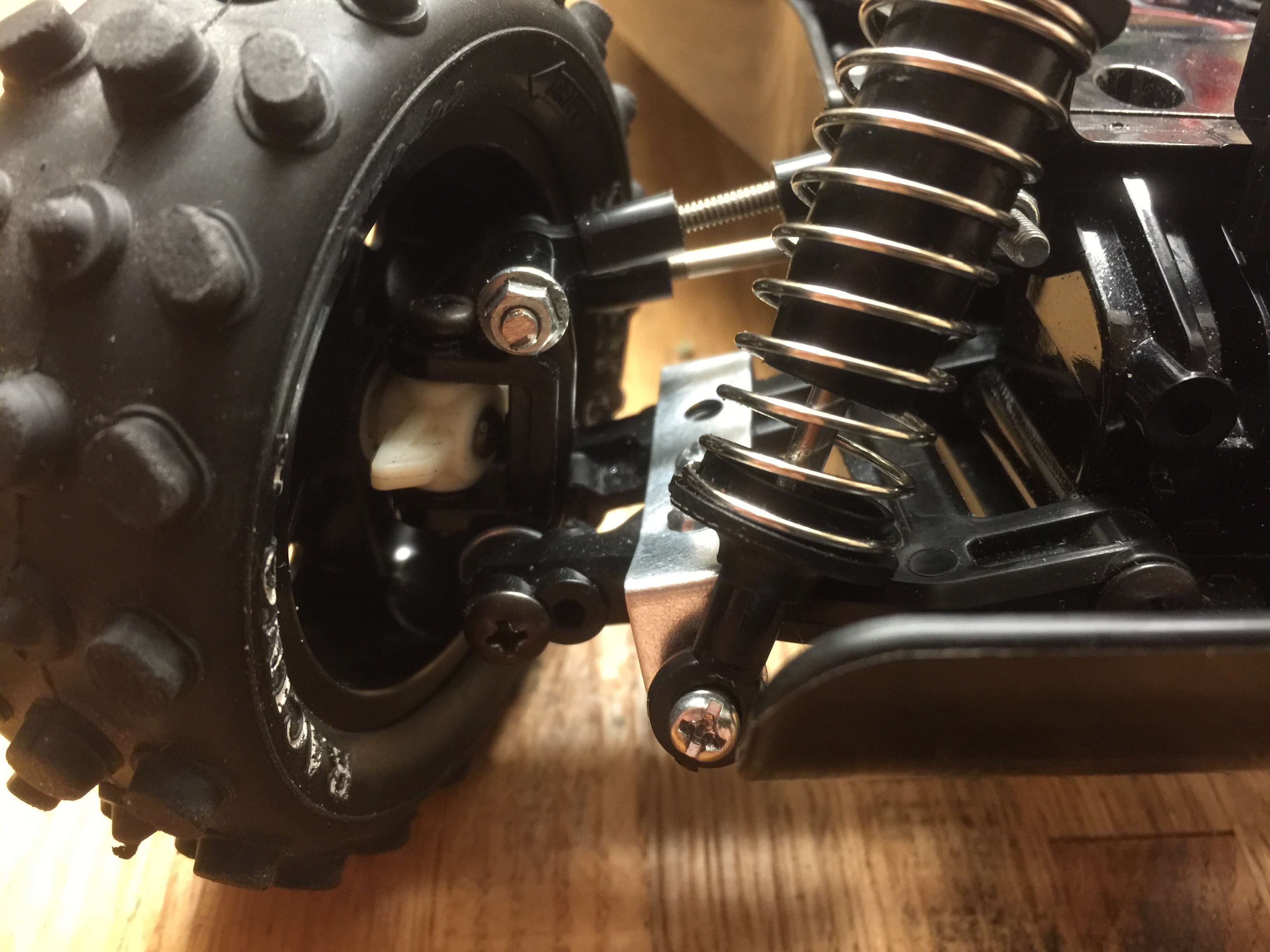

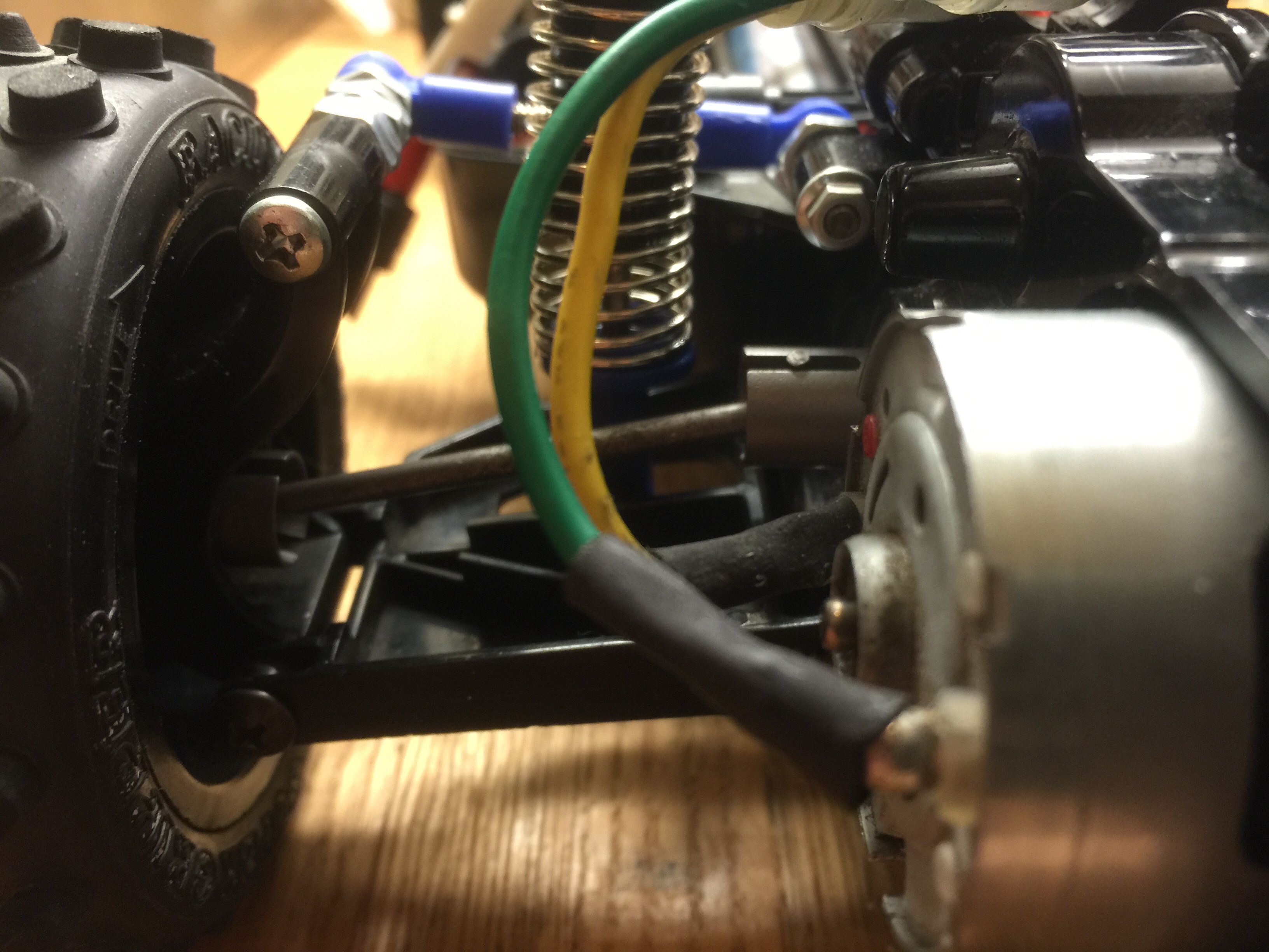

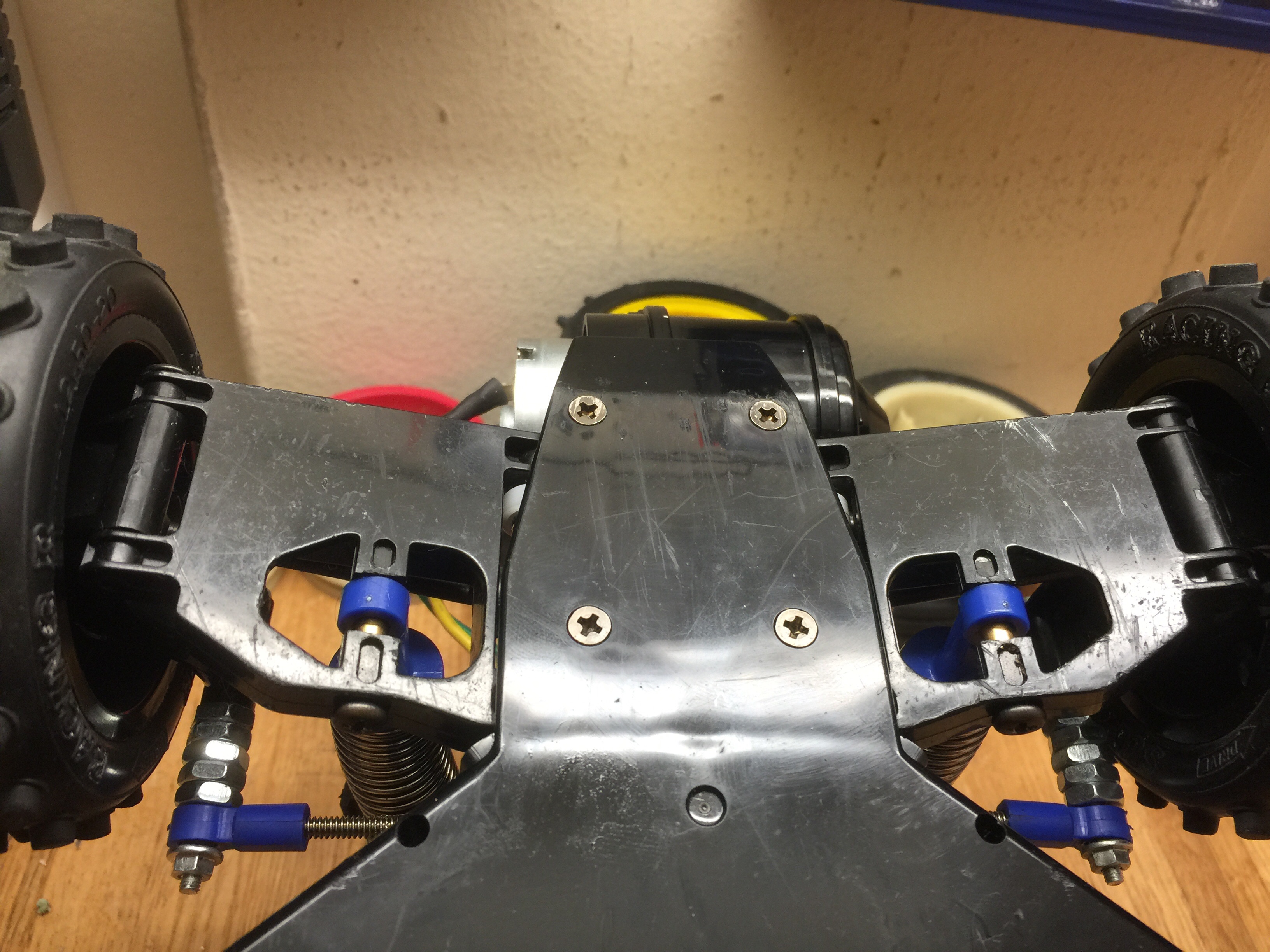

Here are a couple of pictures of the mods

That’s really cool! I have one that I nodded similarly but haven’t finished yet. If I remember correctly, l used the Re-released wild Willy rear arms on mine. I was going to use grasshopper rear wheels.

Re: Tamiya 2010 Holiday Buggy
I have some arms coming in for the front, that will allow me to mount the shock to the actual arm...
As for the rear, I really like how the rear tires stick out of he fenders a bit....
Df-03ra rear arms
