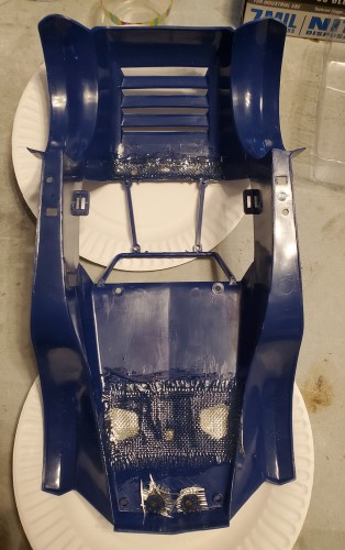

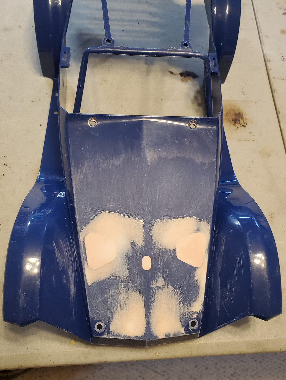

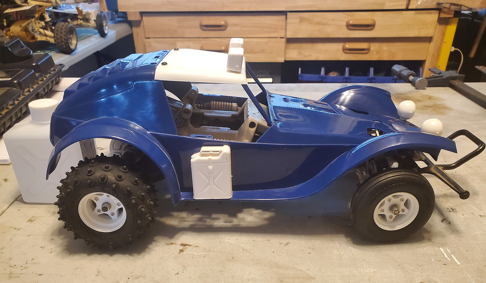

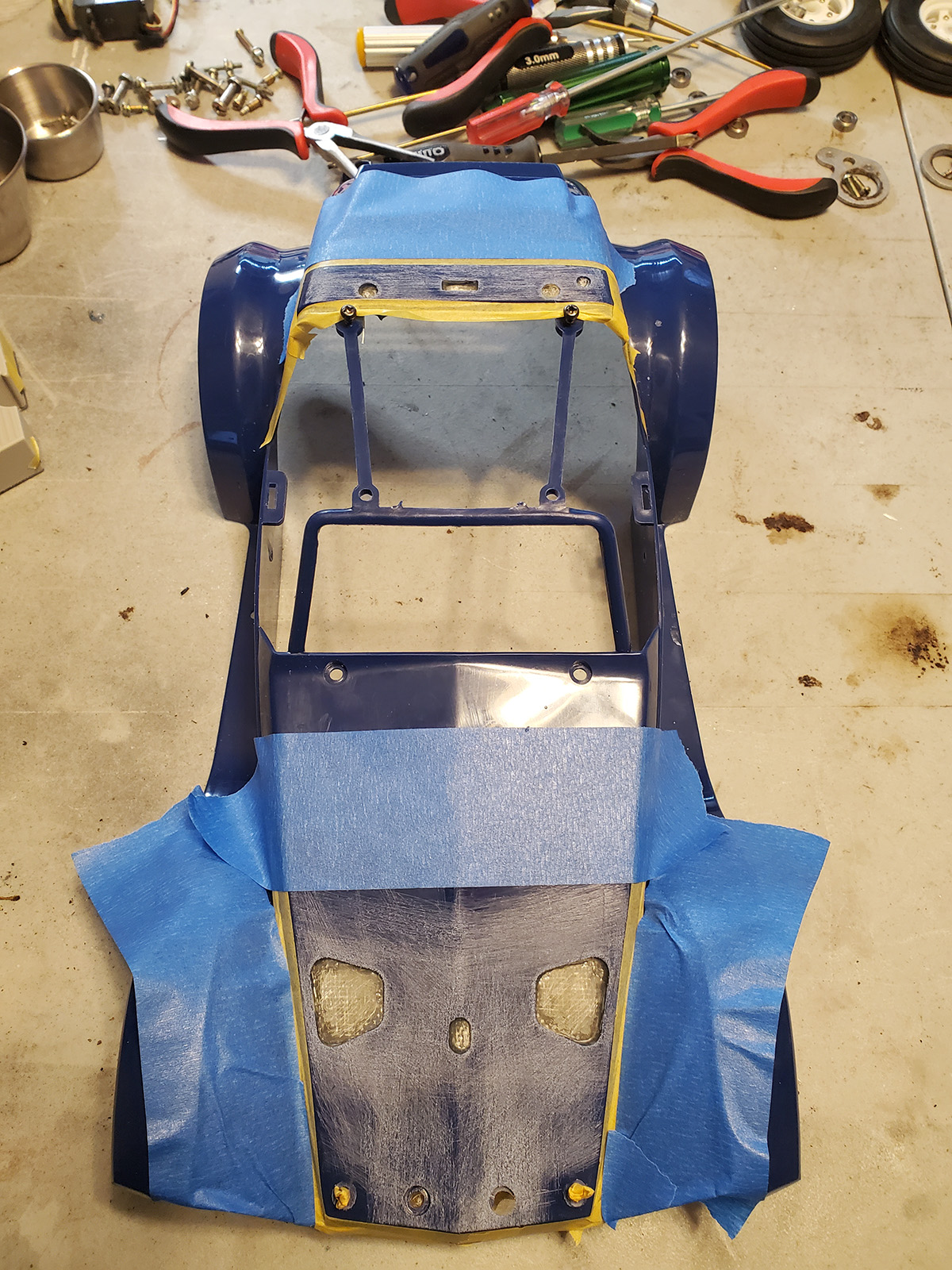

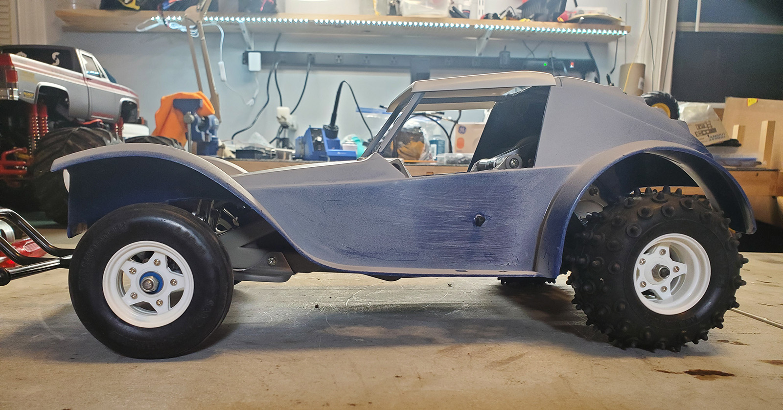

Rainy Saturday meant great day to dive into this. First attack was the body. I am not a modeler, so I don’t know the best method for filling in holes on plastic bodies, but fiberglass backed Bondo glazing putty sounded like an okay idea. Plan was to eliminate the huge triangles, plus the front body post hole, the two worthless holes in the front, and all of the mounting holes on the back. I have no idea how any of this is going to mount at this point, so fill them all. I knew the front body post hole would always be obvious, as there was no way I was going to perfectly sand the Bondo to match the body line of the front hood (or bonnet?). It isn’t done at this point, but done to the point where I am pretty confident it will work and I can start on some of the other parts of the project.

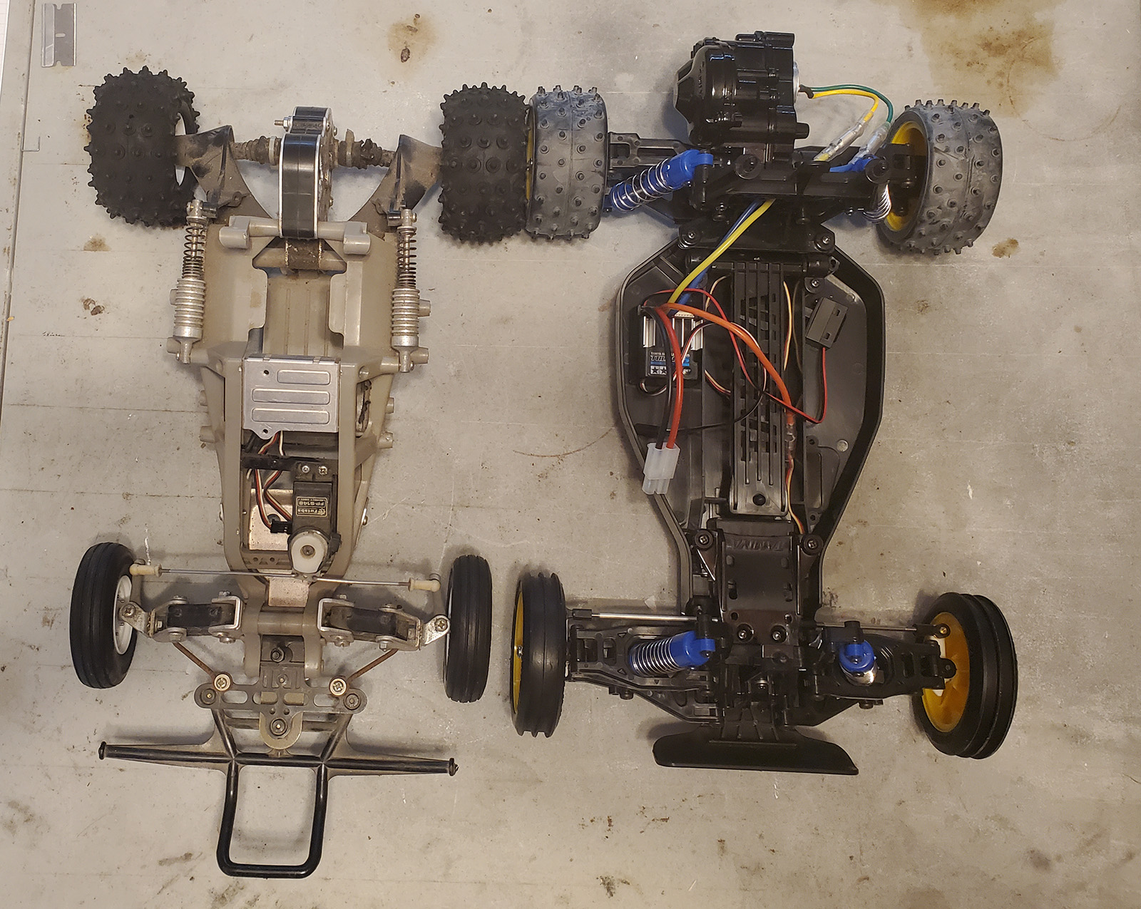

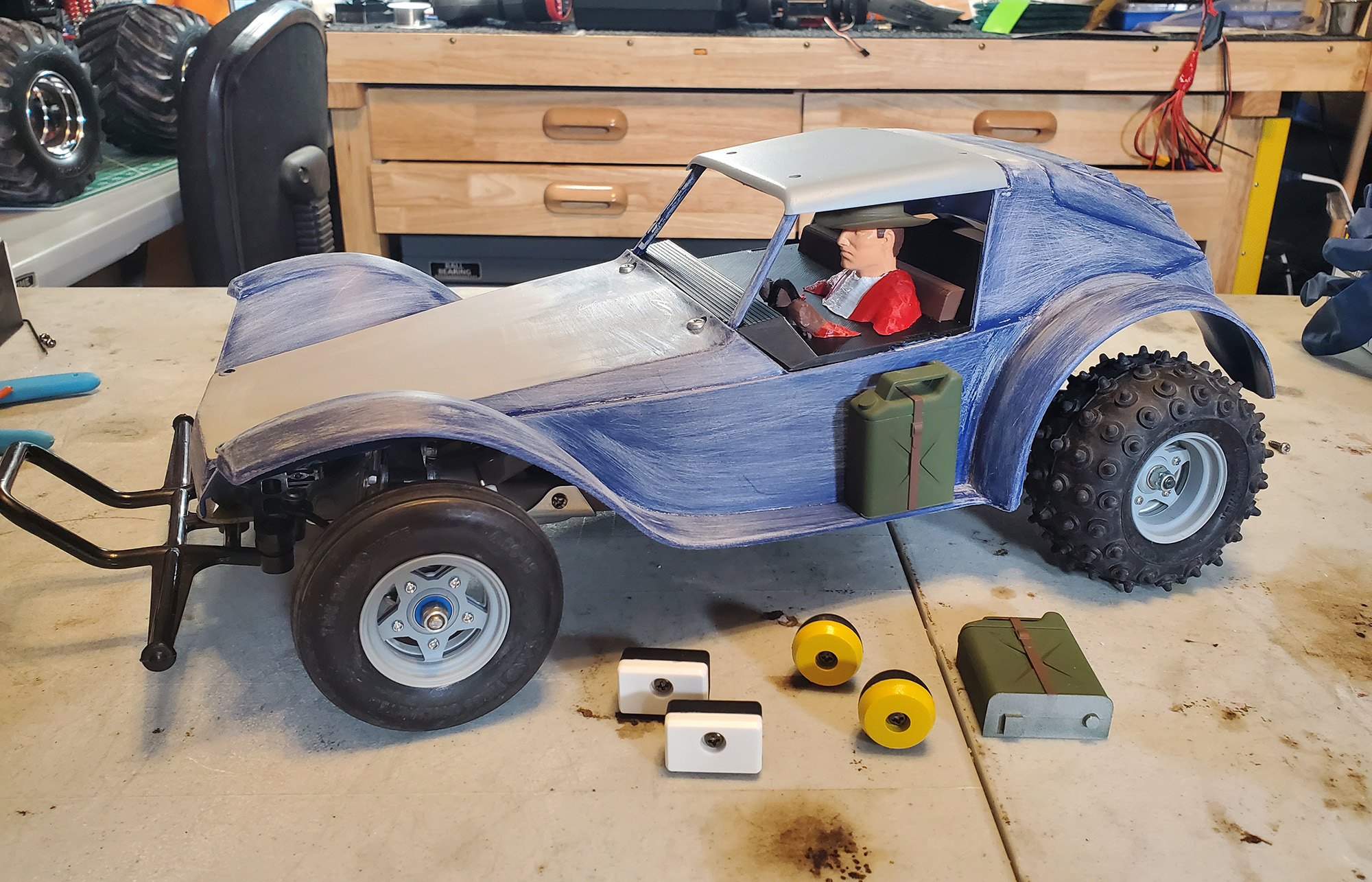

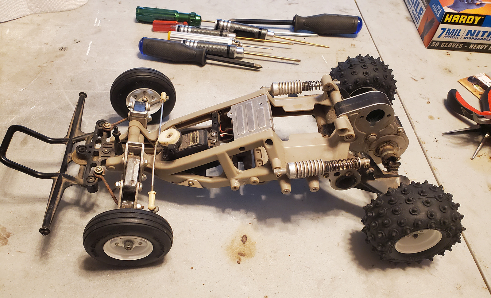

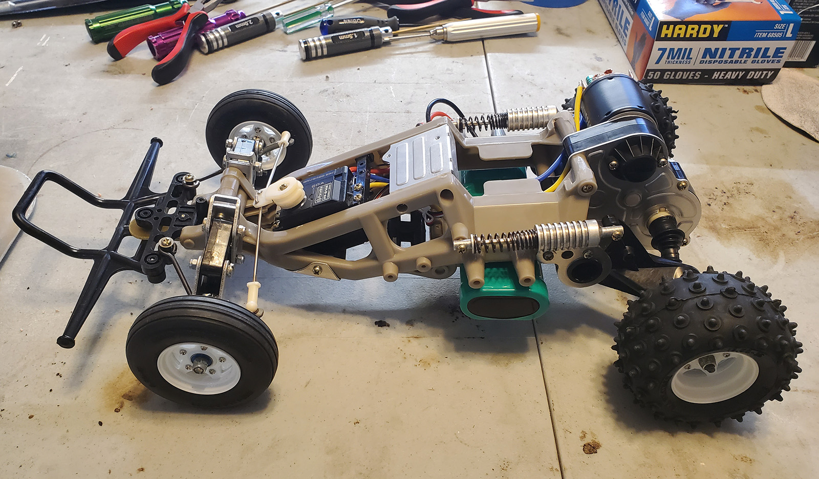

In between waiting for Bondo to dry, and then primer to dry, and then removing primer and re-Bondo’ing, then re-primering, and rinsing and repeating, I did a quick refresh of the Frog. I have never worked on a Frog before so had no idea the difference between the originals and Re-Res. From assembly, I got shocks, MSC mounting plate, and driveshafts. Everything else seems about the same outside of some finishes are different. Nice to be able to order cheap new parts that will work on old cars. Not going old school on the electronics on this one; cheap and modern stuff.

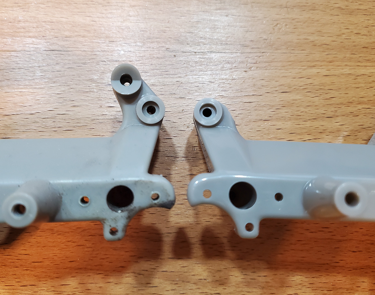

I did modify the chassis plates just a little. The universal ORV rear body post tower mounts were simply too much in the way of the interior, so away they went.

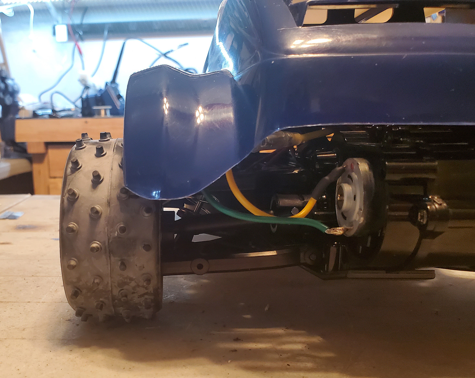

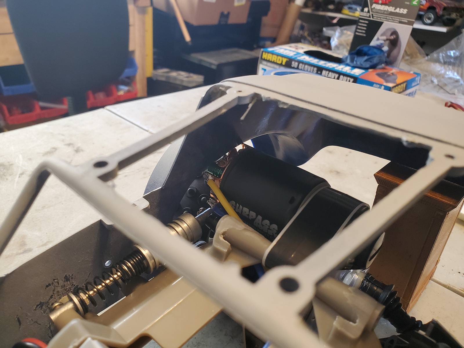

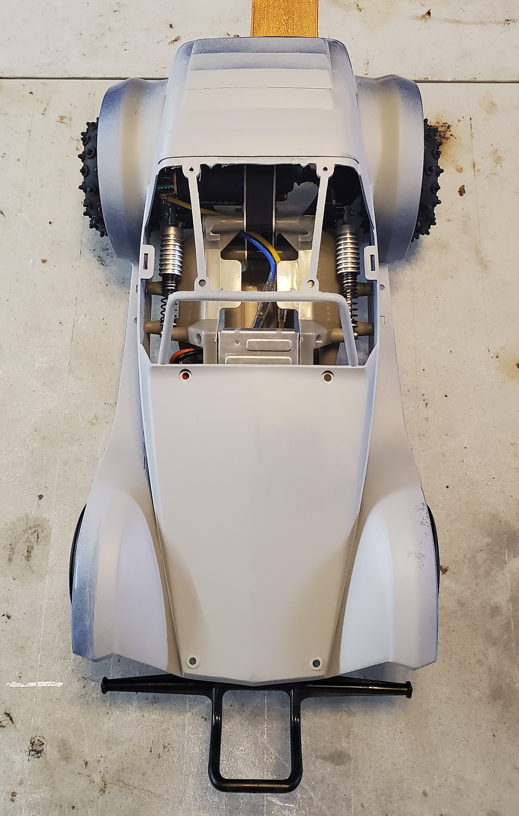

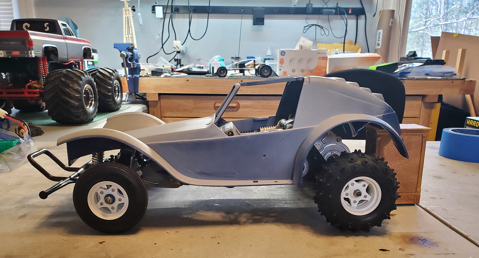

Time for 1st test fitting. Overall happy, but it sits a little too high. The pescky motor is getting in the way, so I have to get super creative or be okay with it being a bit high. I am thinking the latter. This is how she sits today. Now I just need to figure out everything else.

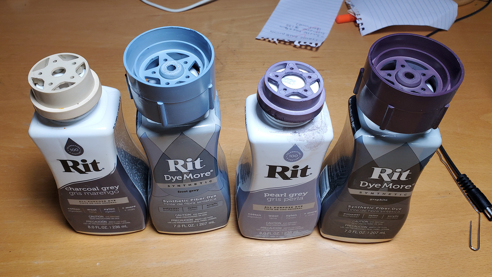

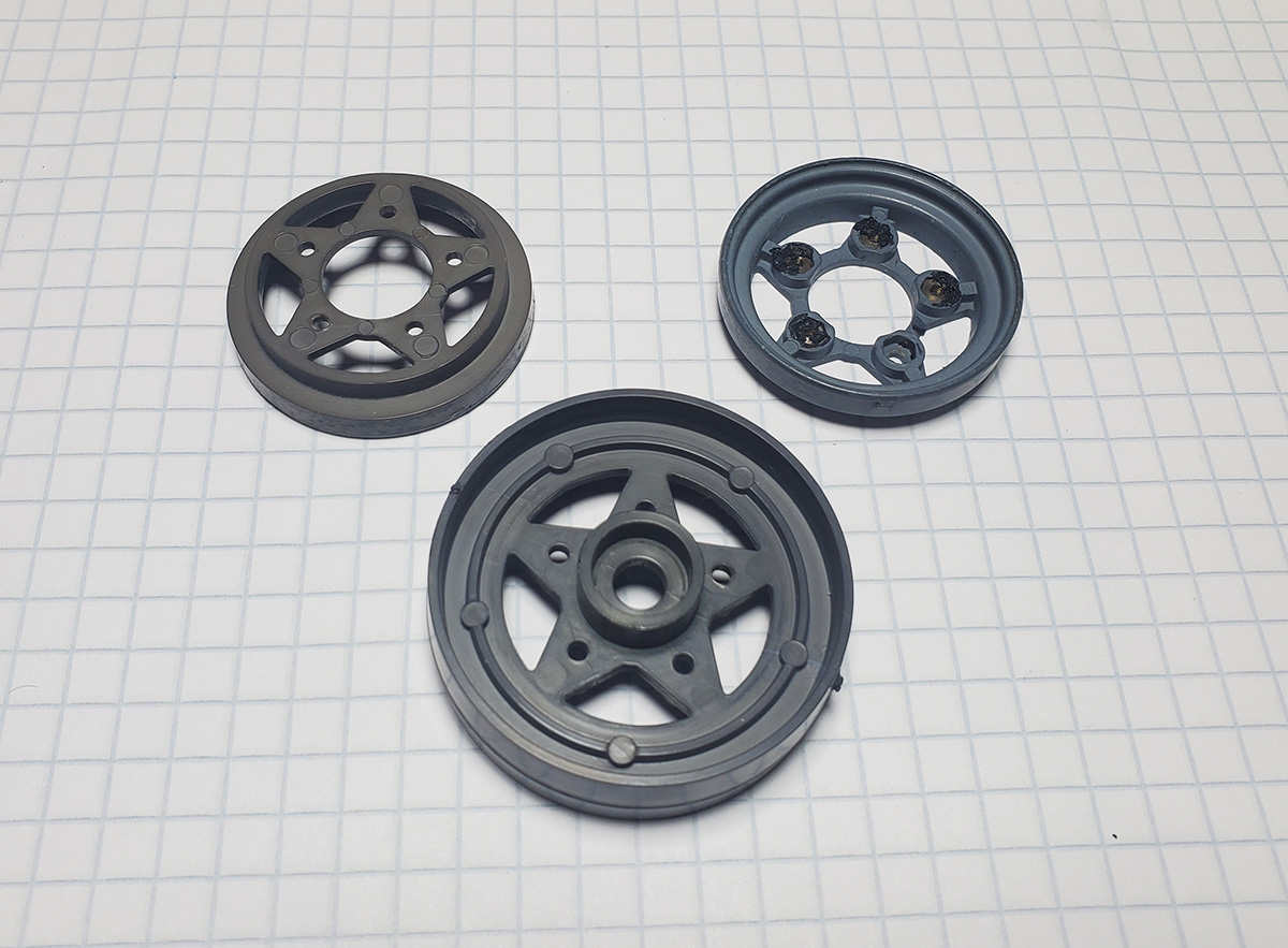

One complete fail of the weekend was trying to get Tamiya white plastic to take dye. Apparently, trying to dye with Water/Acetone mix with various grey dyes produces all kinds of colors, just none grey. I really don't want to end up painting the wheels, so I will keep trying. These are old school wheels, so not sure if they are the same as the new wheels. Don't want to start sacrificing new stuff to find out just yet.

I agree completely, the DT-02 is the wrong chassis for the HB and for all the reasons you've mentioned.
Anyway, that's some excellent body work on the bonnet. I read somewhere that paint won't adhere to the type of plastic Tamiya used to mold the HB body but you've just proven that wrong. Great work!!

I like your idea a lot , have you thought about a smaller can BL motor to help lower the body ? , there are a fair number that can easily out perform an old silver can 540 but are more 380 in size .

To my surprise, I will agree with this statement! I have had good success with Tamiya primer sticking to many unprepped plastic bodies (3-speeds, Blackfoot, Clod), but it peeled right off of sections of this body that I had taped over. I wasn't expecting this so I sprayed primer all over it thinking it wouldn't matter. Good news is that it seems to stick fine to sanded surfaces, so I just have to take the time to sand the whole thing when I get back to bodywork.
Yea, I took a last look at it last night and decided the body had to come down some. TBH, a silver can may be just enough to make it happen. The couple of silvers I have sitting around appear to be a hair shallower at the outer edge than the open endbell that is on there. I have a cheap Tamiya silver can coming in same day so will check it out tonight. I have a feeling that between these two cheap motors and a grinder, I can make something happen.Dadio wrote: have you thought about a smaller can BL motor to help lower the body ?

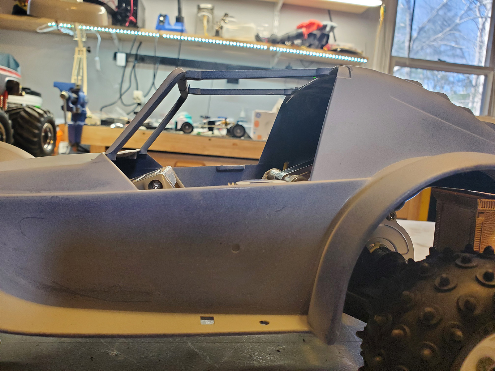

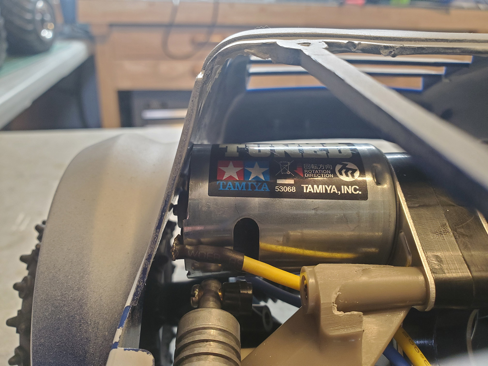

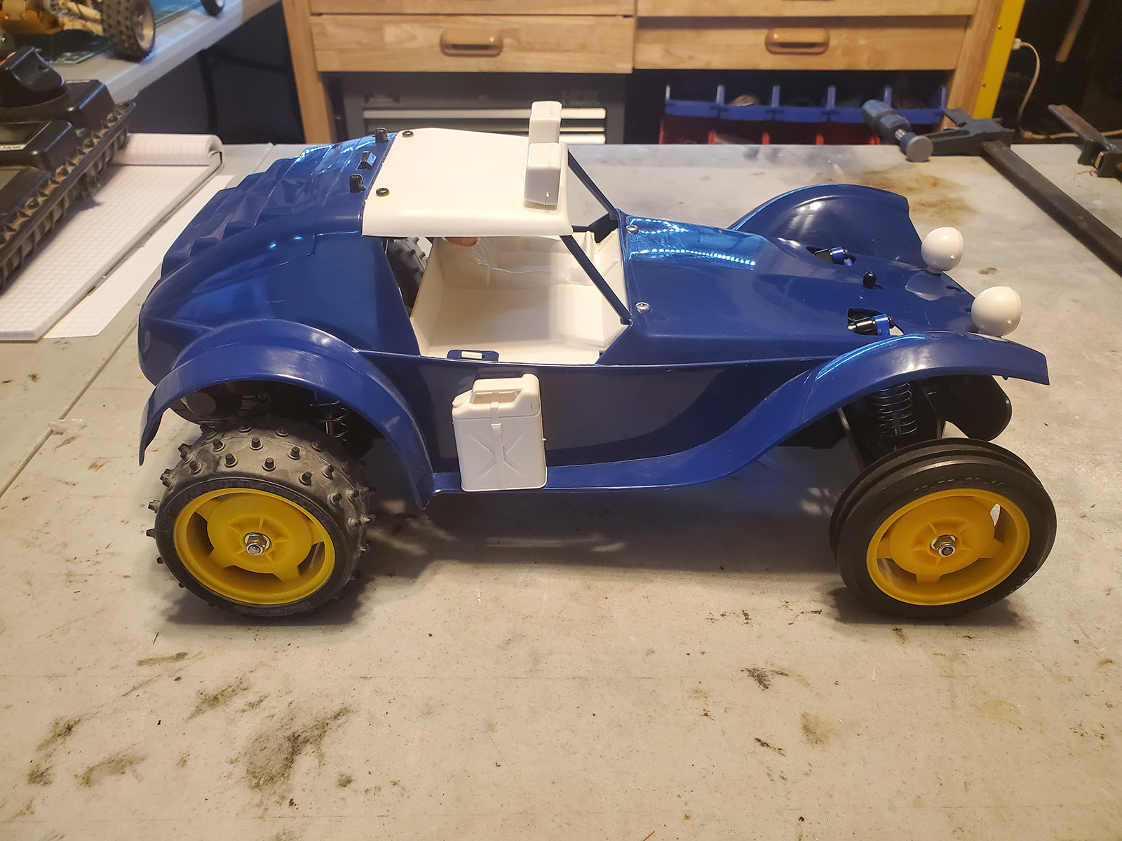

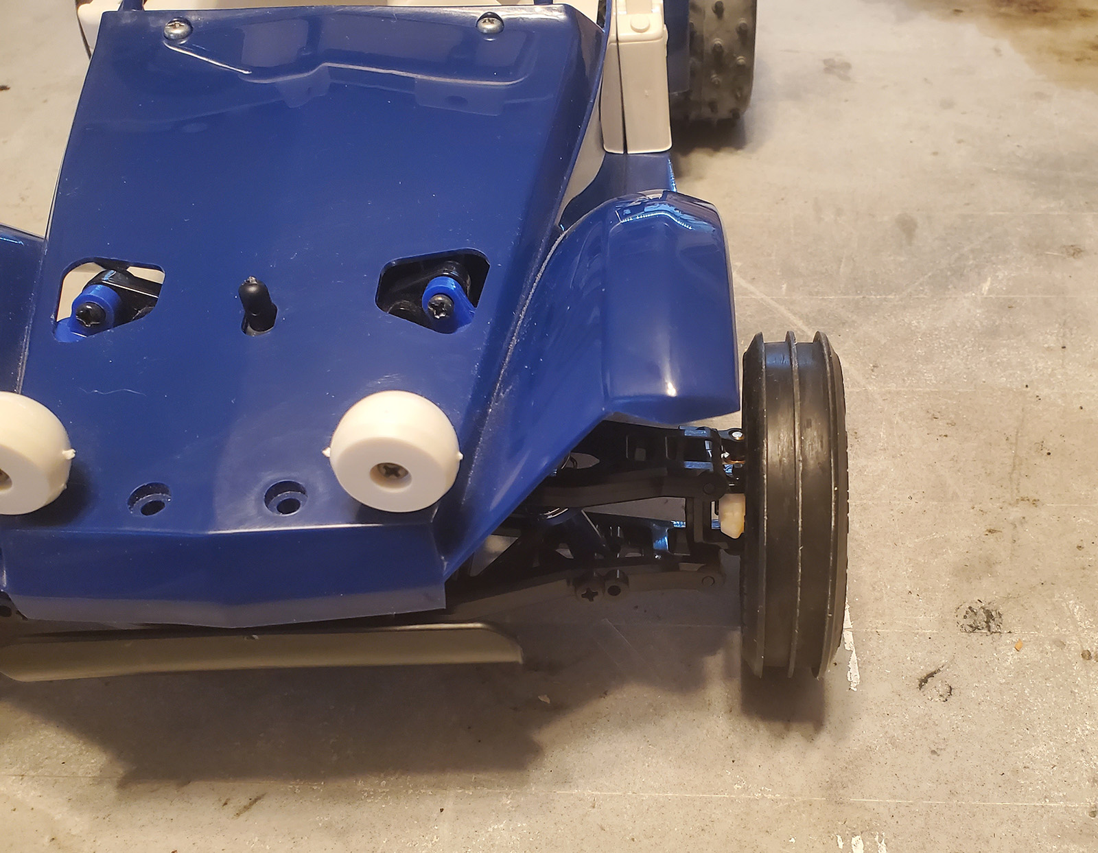

I made the HB faster tonight because now it has a "Sport Tuned" motor. Don't know what this means, but it must mean sportier somehow. The can is ground at the edges, and it is up against the body, but it fits! The body actually centers, although as seen, literally resting on the motor. The motor is steel, the body is plastic, I will let them figure out their own tolerances.
The body sat just about like this with the motor installed, and then I realized that the battery hold down bracket screw holes lined up just about perfectly with the body jerry can screw holes. It was destiny the body should end up here. The rear body mounts will be here and covered up by the jerry cans. In this position, I like the back but think the front is a bit high visually. TBH though, front the susp arms hit the body at about half travel, so the whole front may need to come up another 3/16-1/4". I think it will be okay though. This pic is at full side view so it looks bad, but from a higher perspective, it still all looks great.
And then progress on the wheels. I am figuring out this grey Tamiya plastic dying thing. Still tweaking the formula, but the wheel piece closet to the camera is probably just about what I will end up with. Again, this is on older yellowed plastic. I still have no idea how new white plastic will end up.

I believe the silver can motor is good for around 16 MPH while the Sport Tuned could exceed 16 1/2 MPH. It's meant for experienced RC drivers.
Both motors are much too fast for me so I'm sticking with the kit-supplied 380 motor.

Nice day today, so good day to open a window and get some airbrushing done.
The wheel dying did not work out at all, so they are now painted. Interior plate is complete. Dude man feels the interior is now way too tight at this point, but sometimes you have to sacrifice comfort for performance.
Still have quite a few details to work out, but I can at least now see an end in sight.
