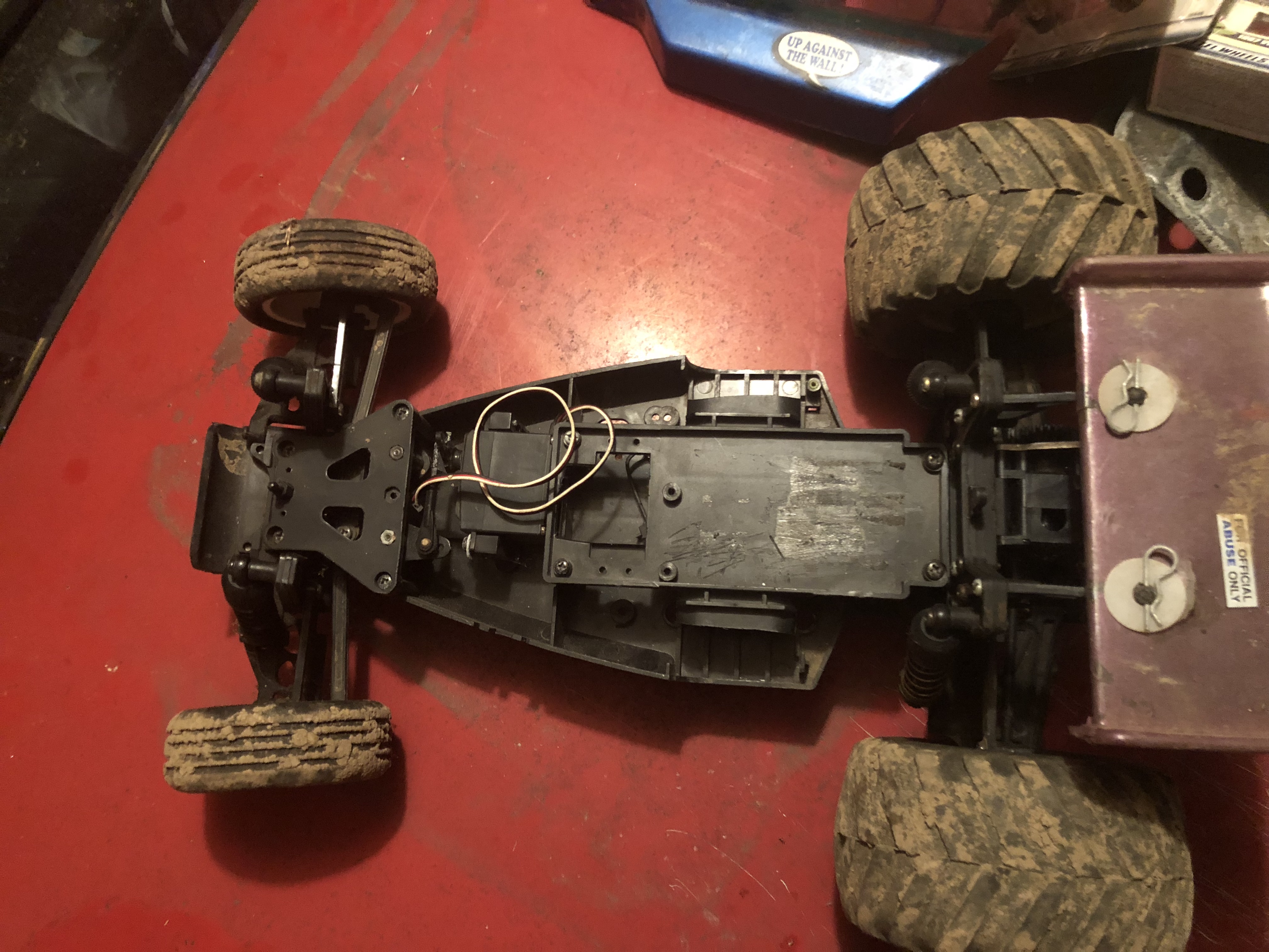

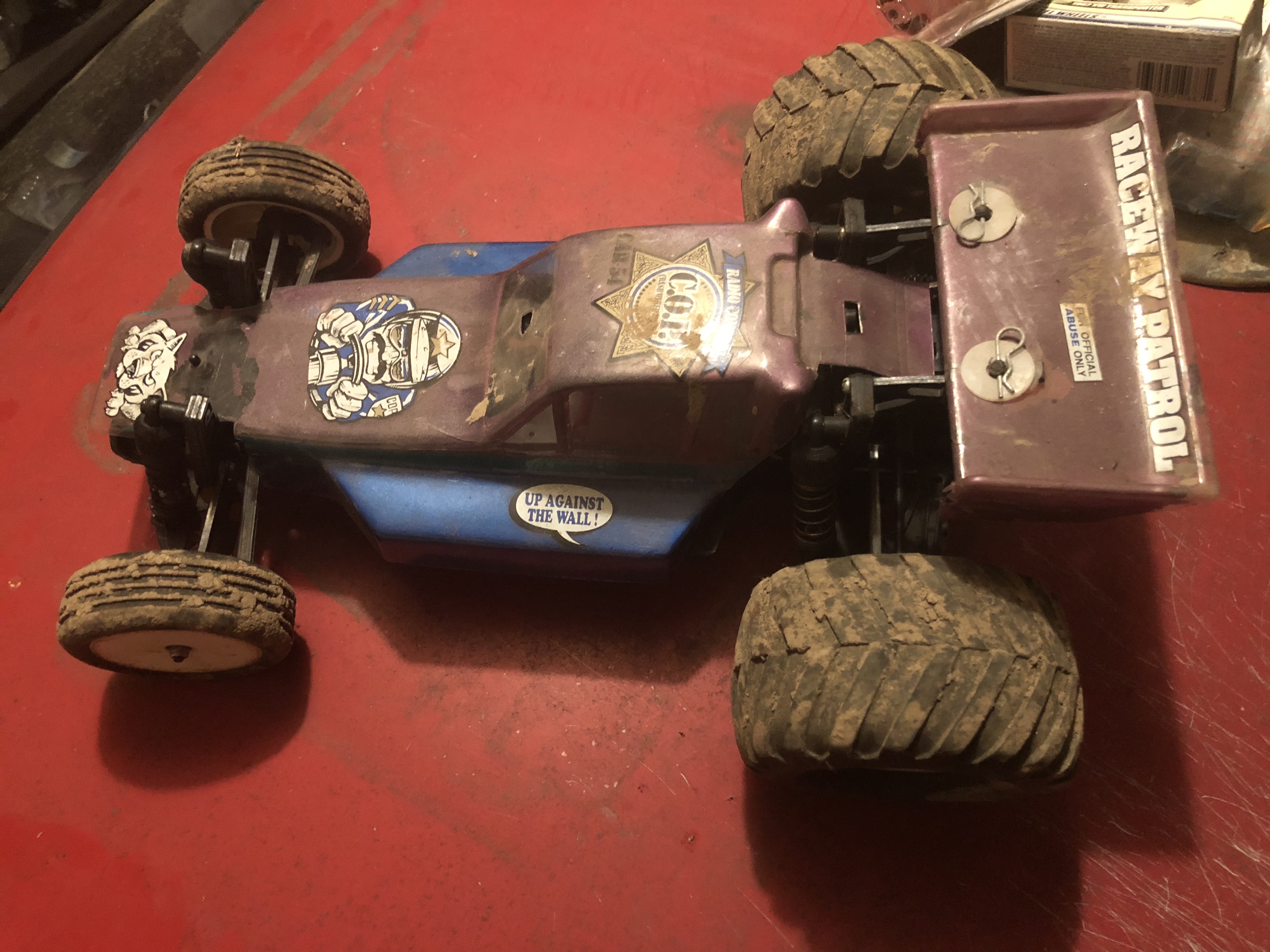

I’m currently rebuilding my daughters outrage in preparation for our new vintage class.
It’ll be running a 60amp esc and a 17.5t motor and a reedy round stick style LiPo. It’s going to run the stock tires and wheels until I get some jconcepts for the rc10 classic.
I’m having a couple issues though. I’d like to run a slipper clutch so she doesn’t strip another center gear. So now I’m going to try and adapt the optima rere slipper clutch. I’m hoping the optima center gear will work as well since I’m having a hard time finding a new one.
I have a few things I will try to stiffen the chassis since there is so much flex and get some ultima shock towers as the outrage ones are softer than jello.
Right now it has 2.2 wheels and tires on the front and traxxas stampede rear wheels. It was what we threw on it to get some traction on the old clay track. Now we have a turf track.
It also has an old rc10 body which will be swapped for an outrage body or old bug body.
If anyone has any input to help me with the gear issues I’m all ears.

Re: Outrage rebuild
I´d set it a side and buy a used RC10 instead.
Before You have upgraded the plastic monster to near usable state, You´d have spent 80 - 120 usd. (Towers, turnbuckles, gears, topdeck)

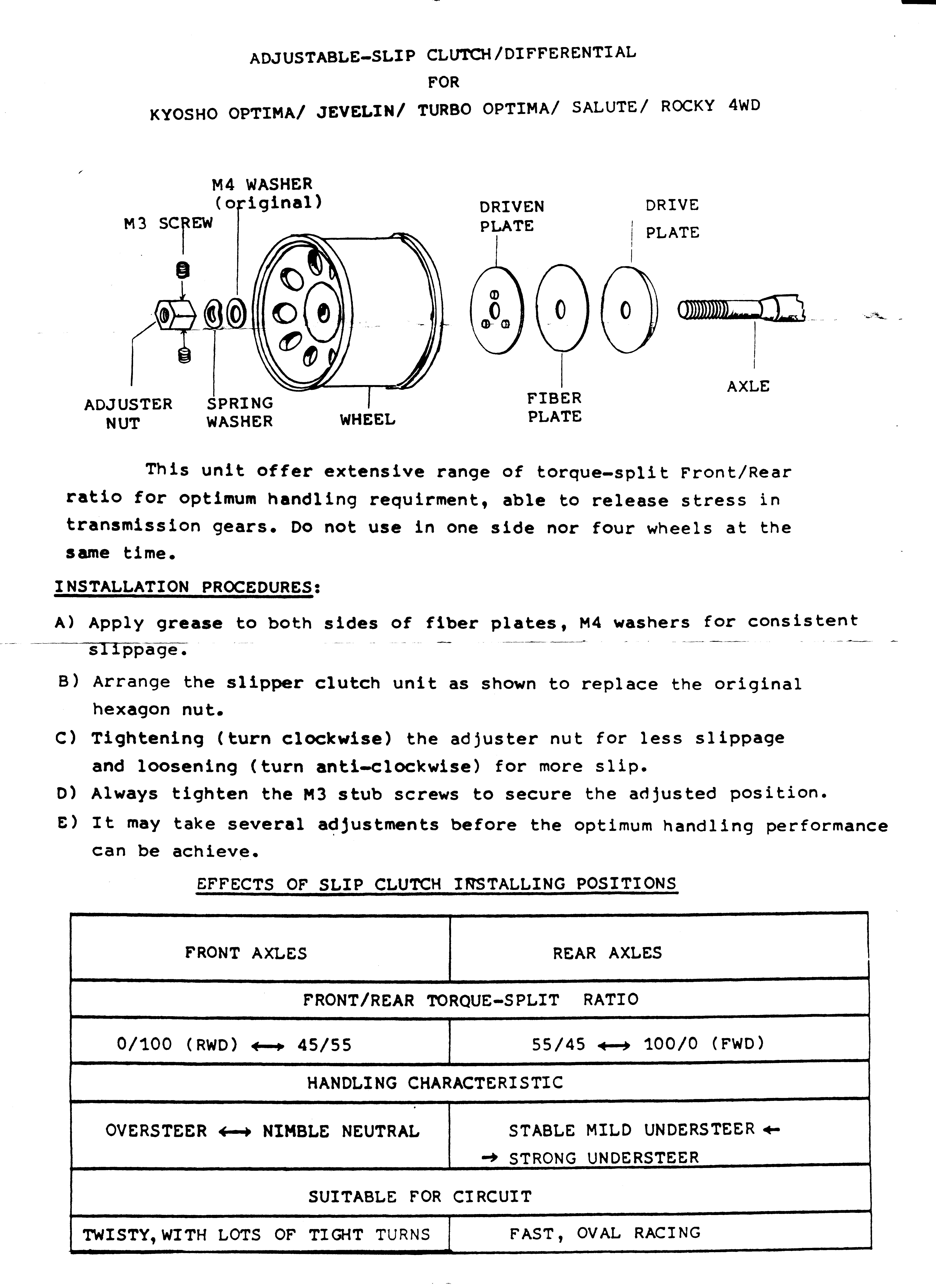

Or use one of the Parma slipper’s
(Check it out over on Toms excellent site:
http://www.dirt-burners.com/rcdox/Manuals/Parma/Parma%20%2312866%20-%20Adj%20Slip%20Clutch%20Diff%20for%20Kyosho%20Optima%20%28EN%29.jpg)
Re: Outrage rebuild
Finding new gears has been the problem. Lol I’ve looked for a couple weeks now and haven’t found anything.
Re: Outrage rebuild
That’s just crazy enough that it could work.GoMachV wrote: ↑Tue Dec 26, 2017 3:49 am Or use one of the Parma slipper’s![]()
