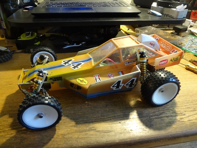

I've got my old beater RC10 set up for the turf track and I'm taking it with me today to the track to put in some laps before the race. Nothing too fancy and definitely nothing too shiny. I've seen quite a few buggys on here that are still raced and being built to race at vintage races, but from what I've seen on youtube videos, the tracks look to be designed "vintage friendly". Not a lot of big air jumps, etc. I did a little work on my faithful basher buggy to see how it will do on a modern turf track. The xl5 esc and motor wire plug are hardly racebred equipment :lol: but I want to see how a brushed motor does before dropping in a brushless combo. The motor is a 14t quad which has good power and the xl5 can easily handle it with the added benefit of having lipo protection so I don't frag my new batteries. The wheels are all modern 12mm hex mount 2.2 with Schumacher turf tires all around. Front end is b4.2 components mounted on RPM arms. The rest is pretty much stock RC10. She's a B chassis with a stealth trans. When I drop a brushless setup in later on, I'll upgrade to a V2 slipper. Shocks are filled with 35w and ride height is set at 22mm in the front and 25mm in the rear. This is high for a turf track, but I want a little more forgiveness on the big jumps to start out. I had most of this stuff laying around except for the tires. I think it will be fun to see how it performs. I'll post later how it did. It's time to finish my breakfast and get my gear together for a day at the track. 8)

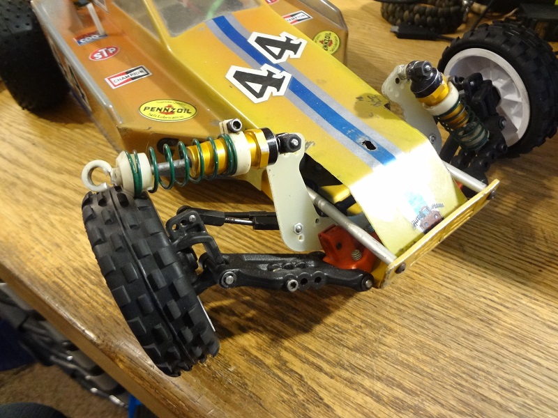

Well, they didn't end up racing today because it was new years eve and not enough drivers showed up. I laid down some practice laps with my race truck and then took the ol' gold pan out for a spin. Picture tells the story. Did I mention these tracks were unforgiving? I didn't get straight enough before launching off one of the bigger jumps and my front shock paid the price. Luckily I have plenty of spare parts. Before I take it out next weekend I'm going to change the shock oil for some thicker stuff and dial in the steering better. I think it would do better with more toe-in on the rear too.

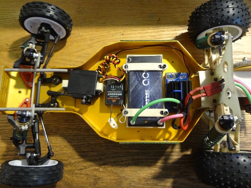

I took my black pan out today and quickly realized I have way too much weight in the back! Every jump I was landing butt first. I think I’m going to be moving the battery as far forward as possible now...

Ucsdmutt wrote: Sun Dec 31, 2017 10:09 pm I took my black pan out today and quickly realized I have way too much weight in the back! Every jump I was landing butt first. I think I’m going to be moving the battery as far forward as possible now...
Try mounting your shorty pack transversly, and put it on the middle set of holes. I ran my TQ10 like that and I was amazed at how level it flew.

I might try moving the battery perpendicular, although I don’t think the non world tub has the holes. In fact there were no holes for the current setup, I used mounting tape! :mrgreen: I didn’t want to drill holes in this vintage tub...

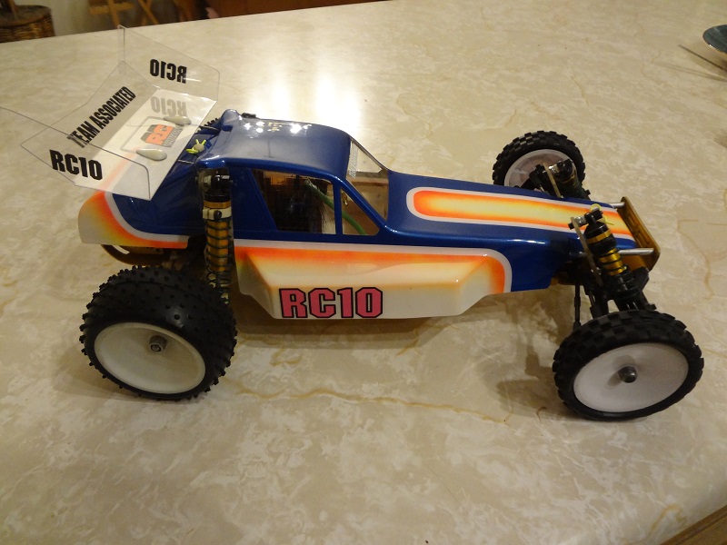

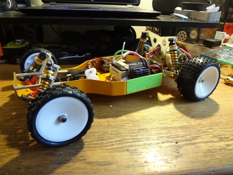

So after moving my battery, the buggy flies way more level. I did notice that off one of the big jumps, the tail end was being kicked up off the lip. I went with some thicker shock oil and decided a body with a wing might help control "in flight" stability. I went ahead and threw some paint at a fresh body in my favorite paint scheme and mounted a BRP high flow wing on the back. I figured I would take a pic of it, because after a day at the track on Sunday, it will never look this good again. :mrgreen:
