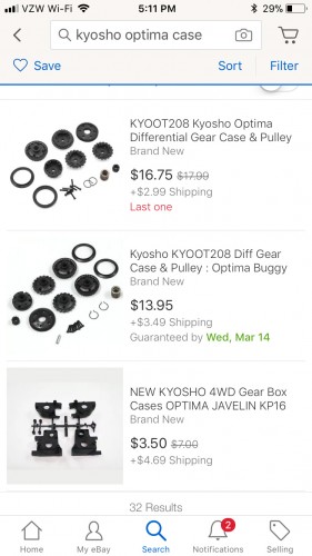

The new trans cases are pretty cheap on eBay and all the gears and bearings you’d need would probably put you into the $50-75 range so you could probably convert yours over for around that price. Don’t quote me exact compatibility though.

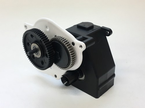

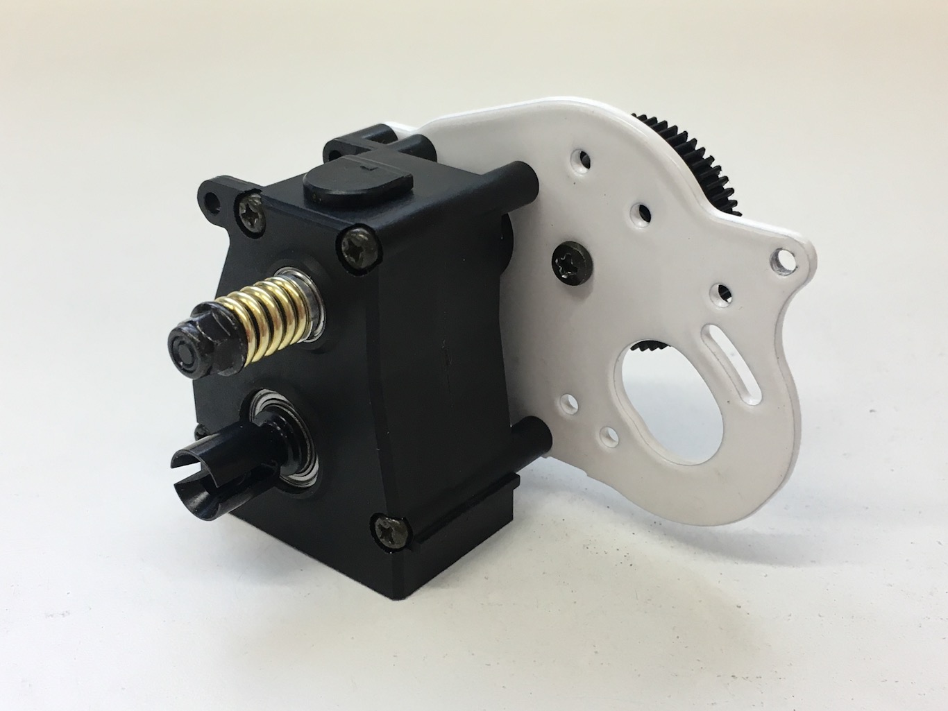

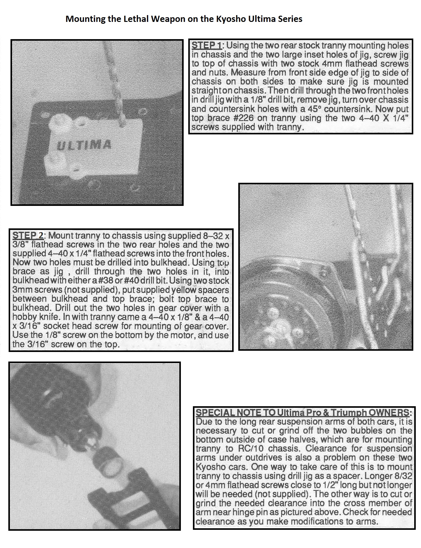

I own Factory Works and Vintage Team A&L, probably my transmission you see on eBay. The Ultima diffs are wider than rc10, so to use the rc10 version you would need longer dogbones. We have one kyosho kit left that has the old wide diff. We hope to have a solution to the diffs for the kyosho and Tamiya rigs at some point but as far as the near future that is it.
Besides the differential, the inside and outside the trans is the same- minus the drill template and trans brace which are car specific. To mount on an Ultima there are two holes that are reused and two that have to be drilled. I do not know how that would work on a Triumph but I suspect it would be the same scenario (edit- I see the Triumph is mentioned so apparently it’s a fit. This was before my time owning the company haha) I’ll attach the mounting instructions so you can get a feel for it.
