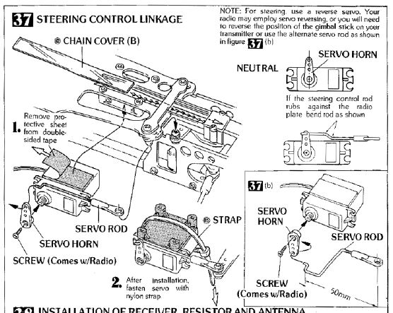

I recently found a vintage optima someone gave me over 20 years ago. It's missing lots of parts, but I have been restoring it over the past couple of weeks.
One thing that seems a bit odd is that the steering servo was only held in place by a plastic tie wrap. It seems like there ought to be a part that could be used to rigidly affix the servo to the frame. I've checked ebay and haven't found one that appears to be designed for the Optima.
Can someone point me to a part for this? What other solutions have people used?

Re: Optima - Servo Mount
Hello and welcome to the forum.
As it happens, I was just doing this last night; mounting the servo in a vintage Optima. So, yeah, It's kinda lame but they're mounted to a plate via servo tape and tie wrap and this assembly hangs from the chassis top plate. Not the best way but times have changed. If you look at the re-released car, Kyosho has created a proper mount that holds the servo with screws alone. I haven't check into it but I'd bet you could modify your vintage top plate to accept this new mount.
The new mount is on tree OT205 and there's one posted on ebay right now:
https://www.ebay.com/itm/New-Kyosho-Optima-Battery-Holder-OT205/323264517965?epid=24010862452&hash=item4b4411174d:g:3FsAAOSwfLxbAQVA:sc:USPSFirstClass!35058!US!-1
Or, you could order if from Kyosho America:
http://www.kyoshoamerica.com/search.asp?keyword=ot205&search.x=0&search.y=0&search=GO
The cool thing is that this tree also includes some other parts that you could probably use. For instance, it includes the flat battery mounts which will be needed if you plan to run your car with lipo batteries and the front bumper plate brace (these typically get bent and broken on well-used vintage cars).

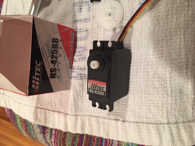

Excellent. This is exactly what I needed to know.XLR8 wrote: ↑Mon May 28, 2018 11:08 am The new mount is on tree OT205 and there's one posted on ebay right now:

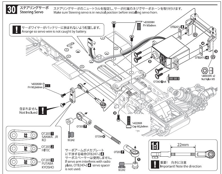

Next time, I'll check the manual for the rerelease and see whether that gives me the info. Based on the rere manual, it looks like the servo mount is shaped like this:
https://www.ebay.com/itm/Jazrider-Aluminum-Servo-Mount-Gun-Metal-Set-For-Kyosho-Optima-2016-RC-Buggy/351813572231?hash=item51e9b91687:g:Dn8AAOSw-itXtYOa
I had seen that one on ebay last night, but it looked too big to fit under the deck. But based on the manual pics you posted, I am guessing it is probably the same shape/size. Since I like the aluminum, I think I'll take a chance on one of these and see how it works.

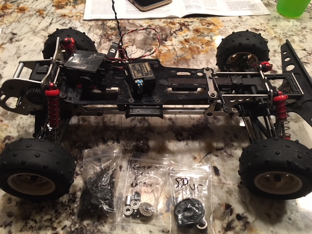

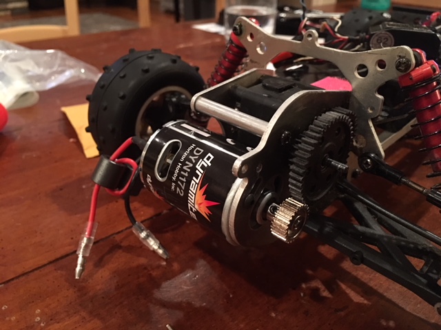

I think I recognize those zip-lock bags with the sharpie pen writing. Did they come from ebay member nitro-master? I needed a few of those same parts to complete a couple Optima builds lately and most of the parts arrived in bags just like yours from nitro-master.
Okay so I see you have some re-release transmission gears. Since your planning to install those in your car, I can help since I just went through this process with a Javelin runner posted elsewhere on this forum. For the re-release, Kyosho not only switched the gears from 32 pitch (.8 Mod) to 48 pitch, they've also changed the top shaft (and slipper assembly) and they've increased the bearing size on the diffs. So, in addition to the parts shown in the first photo, you'll need the counter gear, top shaft and slipper assembly, the rear diff assembly, and the transmission case. I think I got all of these parts from the same ebay seller and the price was reasonable. The new trans case will fit all of your vintage aluminum plates, suspension arm pins, etc. and your chain will continue to work with the new diff sprocket. Oh, and of course you'll need a 48 pitch motor pinion to mesh with that new spur gear. It's a lot of work but I think it's worth it as it provides a transmission that is much improved over the vintage one.
Also, you may want to keep that bent swing shaft (or dog bone) for a spare as it can be easily straightened.

Thanks for all the info. Those parts are from nitro-master and I was contemplating upgrading to the slipper clutch, but I did not realize all that it entails.
After I took that picture, I found the original spur gear. So all I need to restore it to the original configuration, I think, is the pinion gear.
What are the benefits of the slipper clutch? Are the replacement gears likely to last longer? Can/should I use a brushless motor with it?
Also, I need to buy a speed controller. Any recommendation here? Thanks.

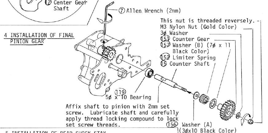

If you're planning to run a mild modern brushless system, without trying to hybridize old parts with new re-re Optima parts, you should look for some parts to essentially turn your Optima into a Turbo Optima.

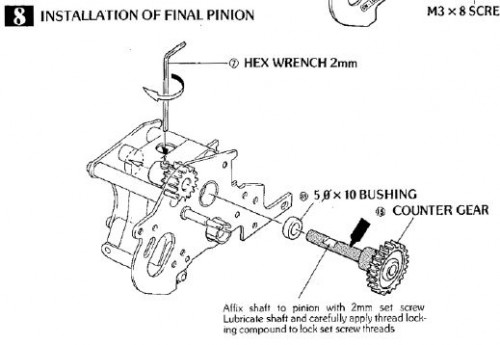

You'll want to replace the stock solid counter gear with an OT-74 Limiter Gear. There were 2 variations, one with a thick spring (that's the kind I use on my Optimas) and one with 3 or more thin spring washers; I've heard the latter isn't the best.
https://www.ebay.com/itm/OT-74-Limiter-Gear-Set-Kyosho-Turbo-Optima-Salute-Optima-Javelin/401544881202
This gear isn't a true slipper assembly, but it does protect the gears somewhat when landing jumps.
Try to find a hard final pinion gear, OT-76; Thorp also makes a steel upgrade gear...the stock raw aluminum final pinion gear wears out way too easily.
If you have the money, convert to belt drive and you shouldn't need to frequently be adjusting your chain tension anymore, or remove links when the chain stretches.
Use the "Punch" setting in any modern ESC and motor combo to limit the torque hitting your drivetrain; this will act as a sort of slipper gear when your car doesn't really have one.
For a pinion gear, Kyosho offered 8T to 12T hardened pinions, but that was I think partly to protect the gears from the torque of the LeMans 240S and 240SB motors on 8.4V 7-cell power, which was pretty powerful for the time. I run a 12T with my Barney car as it has tire diameter slightly oversized when compared to stock, and I'm using a 16T with my CYANide on-road Optima conversion, which has somewhat undersized tire diameter due to the HPI VTA wheels & tires. I made a gear ratio calculator that factors in transmission ratio and final drive ratio to get an estimated optimal rollout ratio, and the hypothetical optimal pinion gear for the stock Optima with stock Turbo Optima 2.0" wheels and knobby tires would be 12T, but you could gear up or down a tooth if you were looking for better top speed or better acceleration. If you're using modern 2.2" wheels & tires, you could probably go down to an 11T pinion. This assumes you're using the original 41T spur gear and not some aftermarket overdrive or underdrive gear set.
I did all of those mods to bulletproof my 2 resto-modded Optimas, CYANide and Barney. The latter car runs a Tacon 11T motor with belt drive. You should have no issues with a motor/ESC combo in the 13T - 13.5T range.
Wow, I wasn't aware that the limiter gear was a Turbo Optima feature. I'd just assumed that it was included with all Optimas. That's cool!
And I totally agree with you about switching to a belt. My Javelin runner will be switched over as soon as the parts arrive. I'm not terribly interested in nostalgia, I want low maintenance and the belt should be virtually maintenance free.

So here's my q (for either of you): Does the slipper clutch of the re re do a good job protecting the gears?
The reason I ask is that I asked the guy at my local RC shop if I should do the upgrade and get a modern brushless motor and esc and he said it doesn't always work and it would probably result in less durability rather than more. Opinions on whether he's right or wrong?
TIA
TIA
