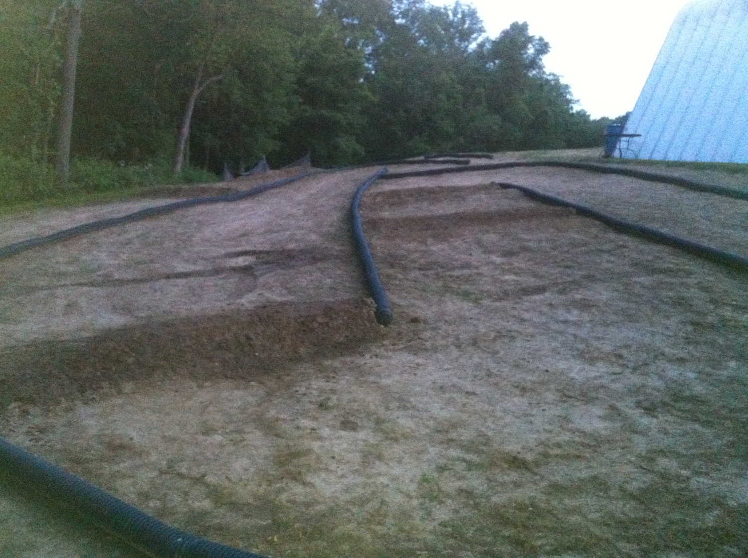

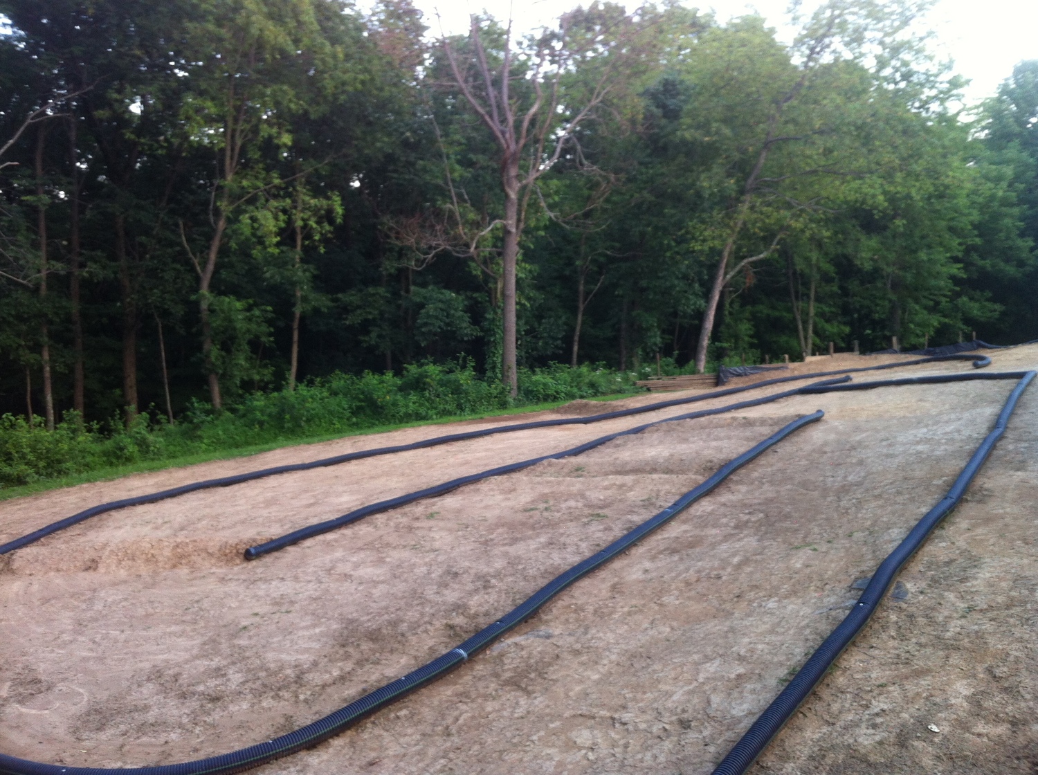

- Posts: 16810
- Has thanked: 36 times
- Been thanked: 1318 times
Re: building a track in the back yard
This is a track I had been messing around with in my backyard. I never got around to renting a sod cutter and adding jumps to make it more permanent.

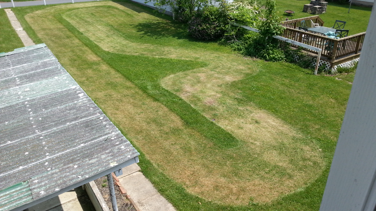

- matt1ptkn
- Posts: 910
- Location: Moundsville, WV
- Has thanked: 80 times
- Been thanked: 133 times
As mentioned already: drainage. I built a pretty nice track in my yard a couple years ago and every time it rained, the track would get washed out with some hellacious ruts. It was a lot of work to smooth it all out with having the dirt jumps to maneuver around. I eventually leveled out the entire space and built wooden jumps that were easy to move/remove for different layouts and maintenance. For me, weed growth was difficult to keep up with. In the height of my track's popularity, it wasn't too bad, but if I didn't use it for a month, the yard would make a serious effort in reclaiming it. I, too, used a section of chain link fence, but I mounted it under a wooden pallet and then I placed concrete blocks on the pallet. It worked very well for smoothing/leveling and light to moderate vegetation.
So in closing, I would say that drainage is numero uno, and routine up keep/maintenance is a close second. Some of my best RC memories are on backyard tracks. Have fun with it!!
Here's a couple photos of my track.
Matt
