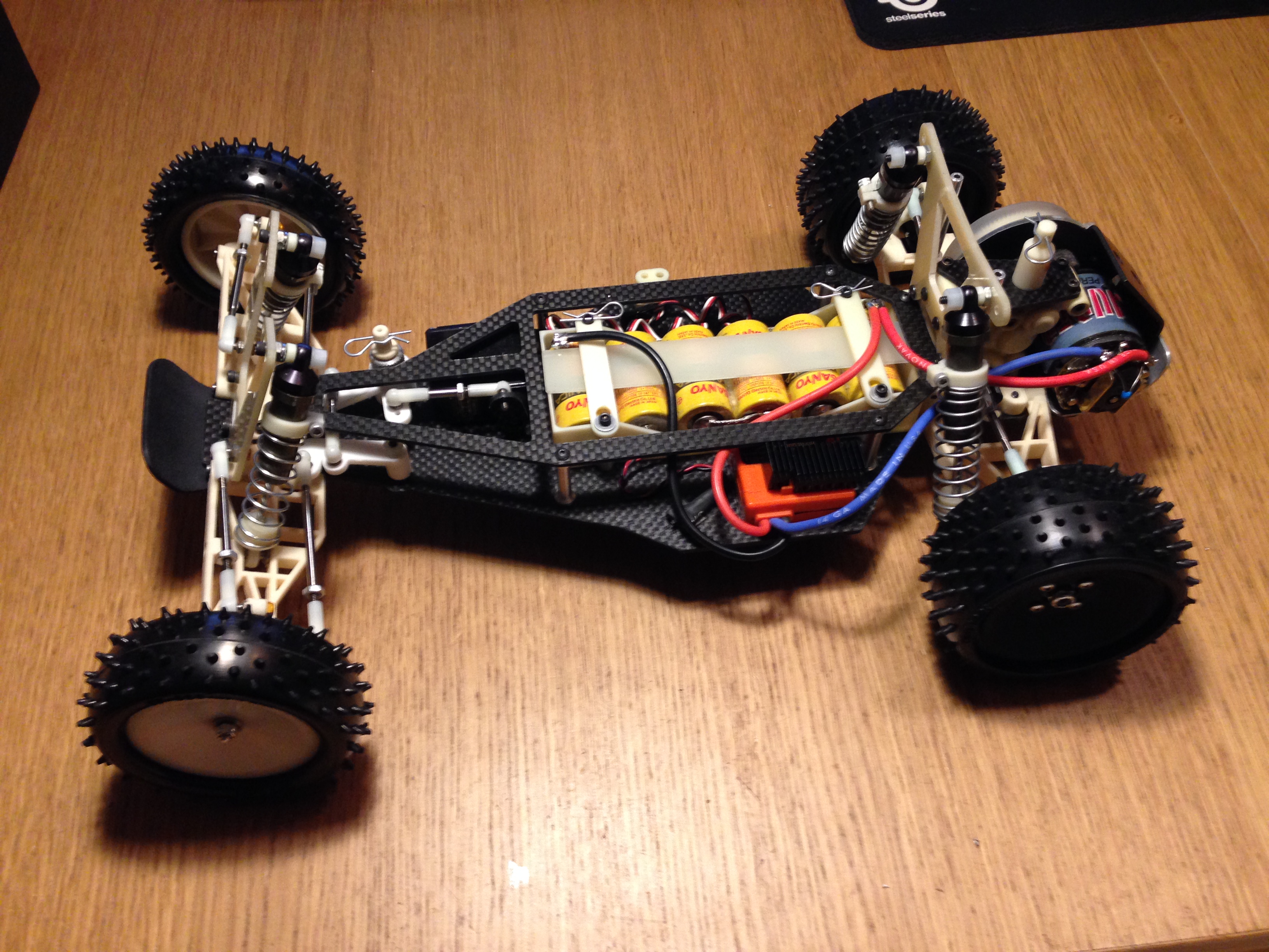

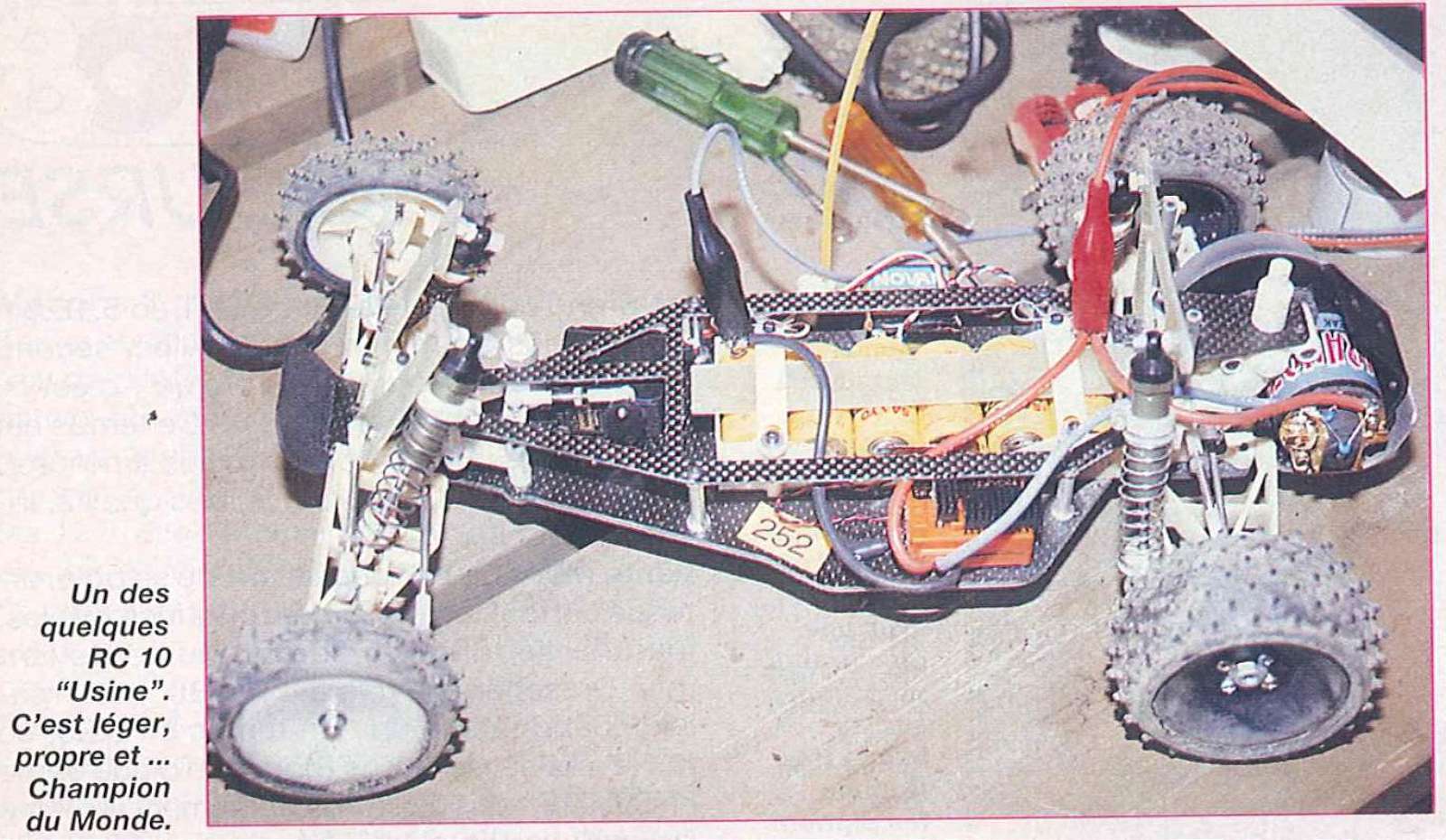

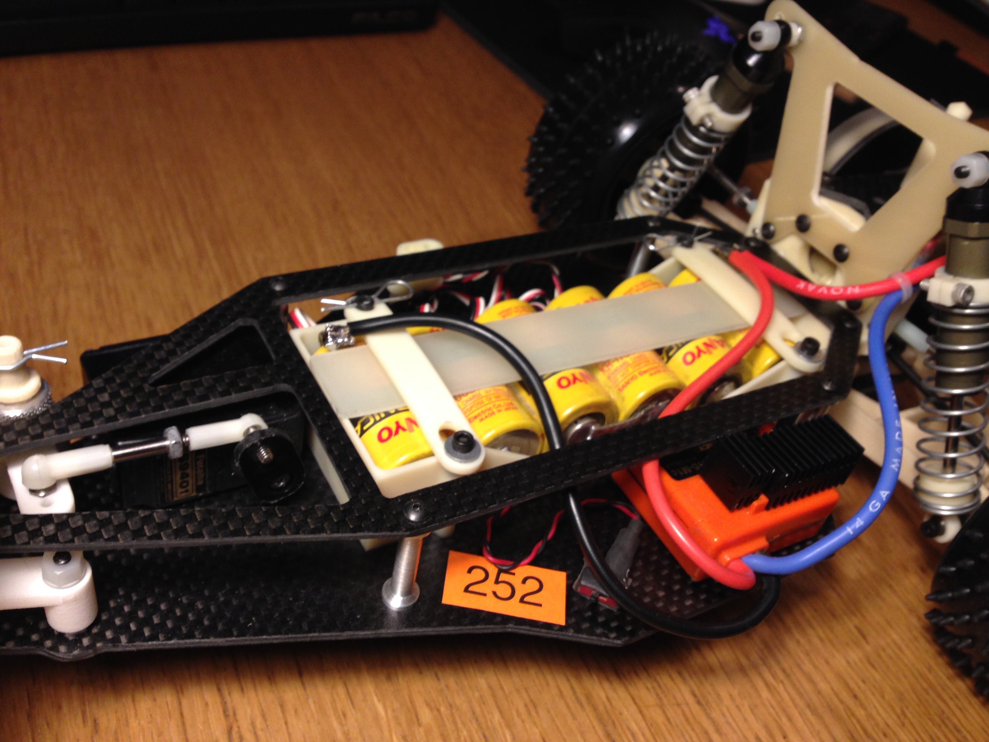

Hello, I've been working on this for a few months now and I wanted to do something a little different. There was a thread here which talked about how many stealth cars where fielded at the 1991 Detroit Worlds. I believe the number was 15 or 16. Anyhow photos have only surfaced for maybe 5 or 6 six of these.
I started with the Images I found on here of Rick Hohwarts car,
naked
Stealth 91 Hohward.jpg (68.3 KiB) Viewed 6898 times
dressed.
This is where I am at right now.
I machined my own chassis spacers and made my own bumper, battery clamp. As far as I can tell the electronics should be ok: Futaba S9401 servo (re-badged S131sh); Novak M1C (late pop fuse type); Peak Performance Marauder 12 single; Sanyo SCE 1700 cells.
The front springs are Associated truck silver fronts. The rears are Yokomo silver.
I'm still pending getting some spring spacers for the rear Yokomo springs, I might change the rear bulkhead and obvious the body/wing needs to be obtained I'm looking for now at the turbo mirage no scoop at Sabulatech.
The tires have me completely stumped so for now the matching TR32 and TF320 are on there as place holders. ;)
The receiver is also a bit of a sticking point since it cannot be seen very well. It would most likely be a Novak NER-3FM since by 1991 running an AM system would have been asking for trouble. Anyhow the receiver seems to be black with a Novak sticker so it could even be a Futaba.
I would really be great full for any insights. Thank you :D

That looks really good. Did you dye all the printed parts or are you leaving them as is to naturally yellow?

The wiring.....nailed it!!!
And the 3 color paint scheme is solid AND appealing.
Great variety among these different interpretations of the '91 car.
Great choice.

mikea96 wrote: Sun Mar 17, 2019 10:58 am That looks really good. Did you dye all the printed parts or are you leaving them as is to naturally yellow?
I apologize, I really need to learn how to take photos, most of you here are real pros.
The parts have been dyed with Nescafe, It took a while and many scrap pieces to test on before I figured out a shade I liked.
TRX-1-3 wrote:And the 3 color paint scheme is solid AND appealing.
Appealing in the sense its easy to paint and its easy on the eyes. I really hate body shells and sticker so we will see how that plays out... :D

Looks like an exceptionally nice clone -- well done sir! In fact, if it wasn't so clean, you might believe that it's Rick's actual car. Very cool!! 8)
What were the two extra holes in the front shock tower used for?

XLR8 wrote: Sun Mar 17, 2019 4:13 pm Looks like an exceptionally nice clone -- well done sir! In fact, if it wasn't so clean, you might believe that it's Rick's actual car. Very cool!! 8)
Thank you.
I think the holes are in the right place for 0.71" shock bodies just in case anybody wanted to use them I guess.
Just added chassis registration sticker : D

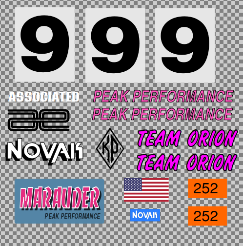

bluewormx
Posts: 343
Joined: Wed Jun 08, 2016 4:56 am
Location: Spain
Has thanked: 41 times
Been thanked: 90 times
Re: Nix91 - Rick Hohwart replica
Post by bluewormx »
XLR8 wrote: Wed Mar 20, 2019 8:26 pm So you are making the stickers yourself? Can you please give us a brief how-to?

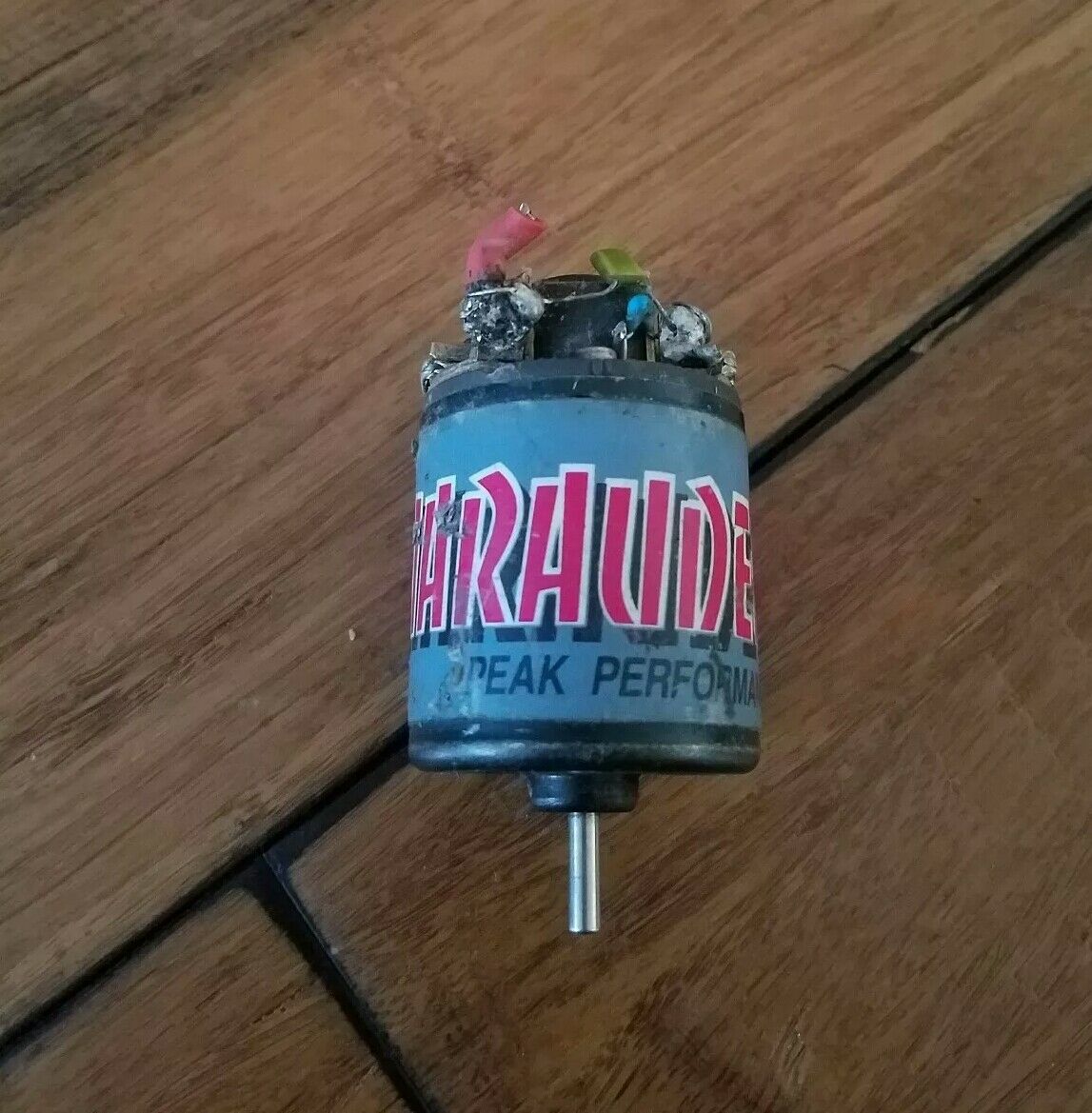

The basic steps are covered Here https://mciracing.ca/p/design-your-own-decals
A quick example:

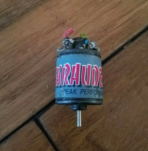

The peak performance marauder motor label, I have an original but I used it as a learning exercise.
first you need a picture:
This was from the ebay auction.

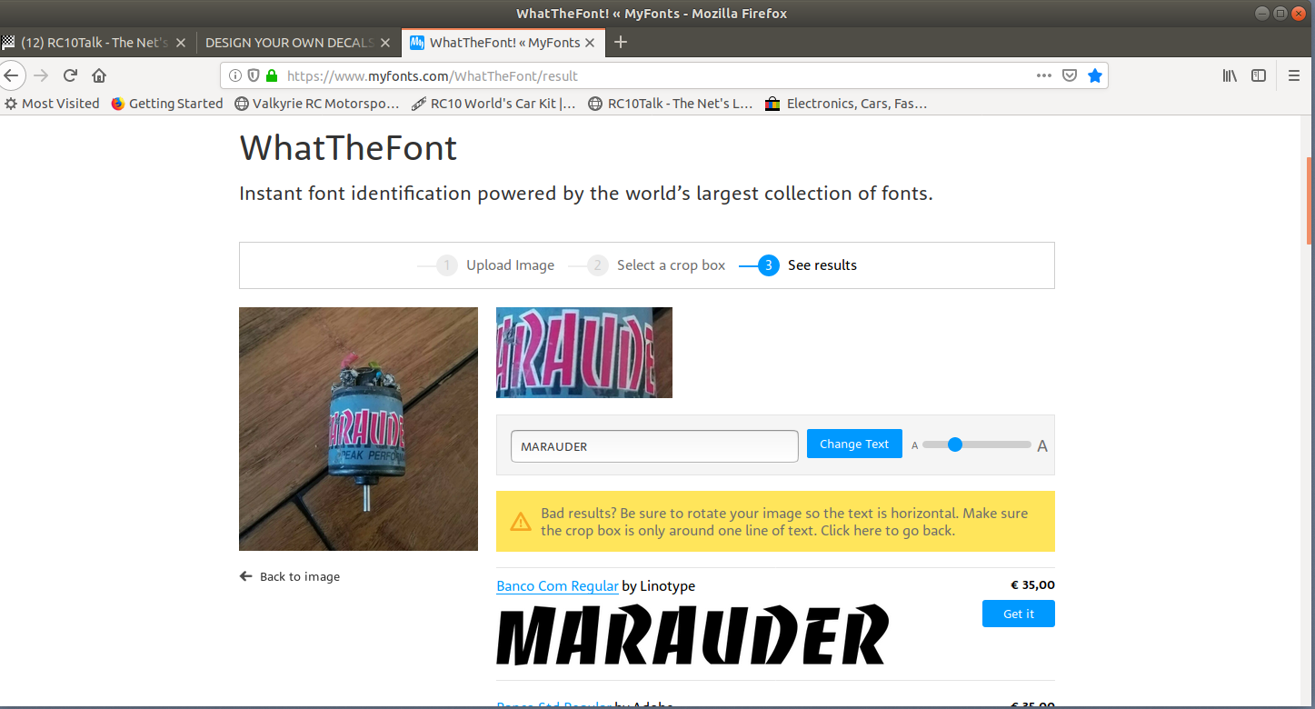

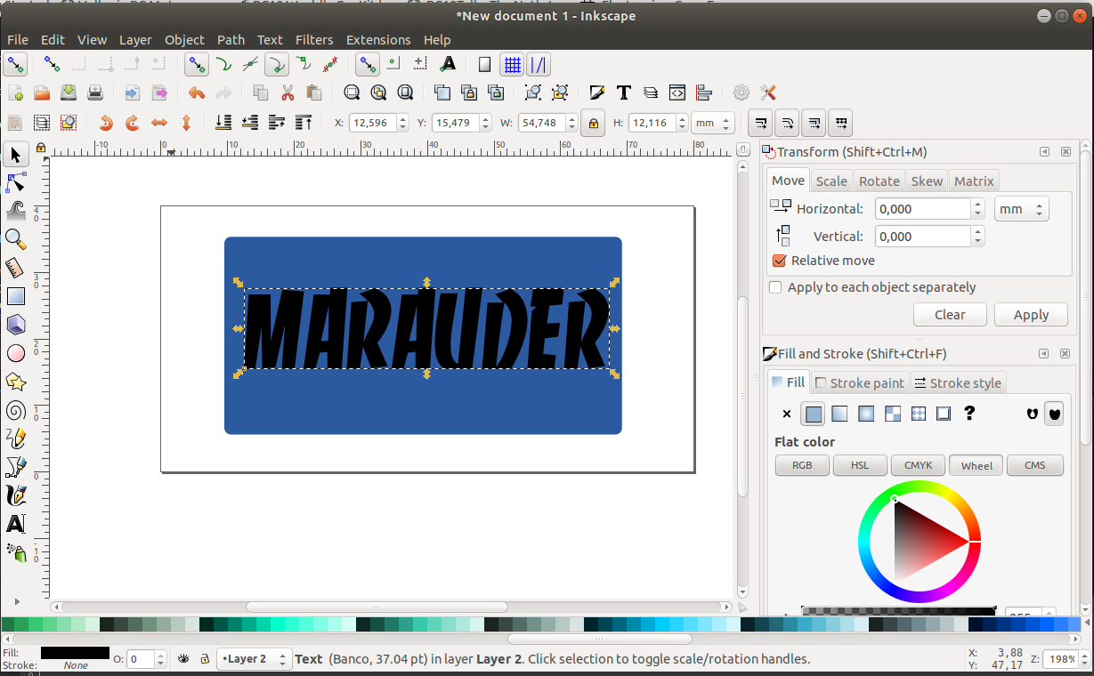

Now you need to find the correct font. This web page helps. https://www.myfonts.com/WhatTheFont
Results
The font you need is "banco" Now you need to find it and not pay $35 ;)
A quick google will solve that issue.

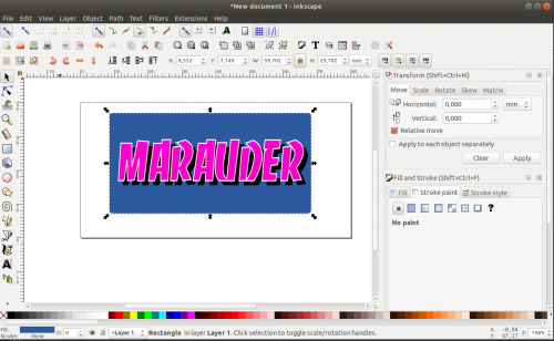

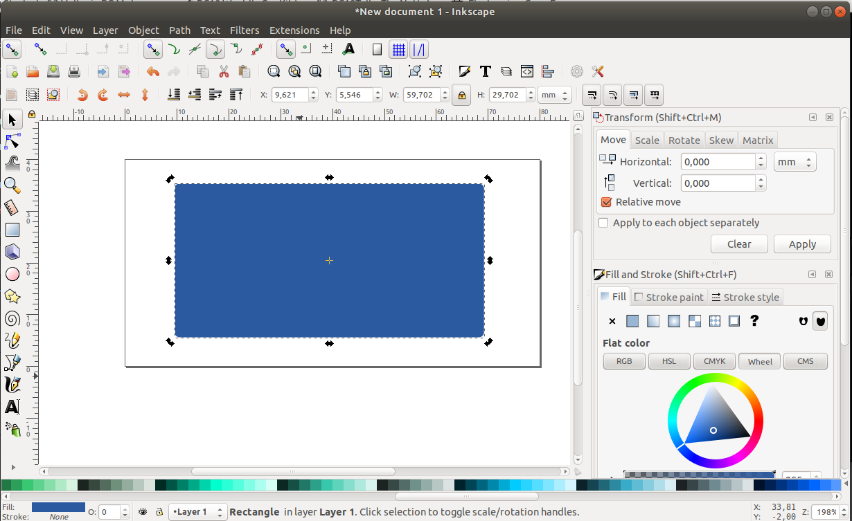

Now install the font and start Inkscape
Make your label background the right size and round the corners.
Add some color.
Make a new layer and add the text. Size and shape as necessary.

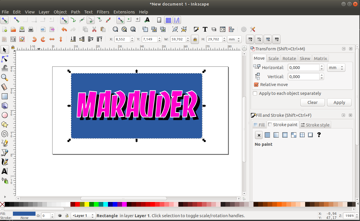

That layer will become the shadow. Make a duplicate layer for the main text. and change fill and stroke (outline) colors as necessary.
I'm sure you get the idea by now :D
Some of the other stickers will require drawing which can be more work some less, for example I just downloaded the US flag the.
Like everything it takes time. The results...
I've ordered some, lets see what we get...
