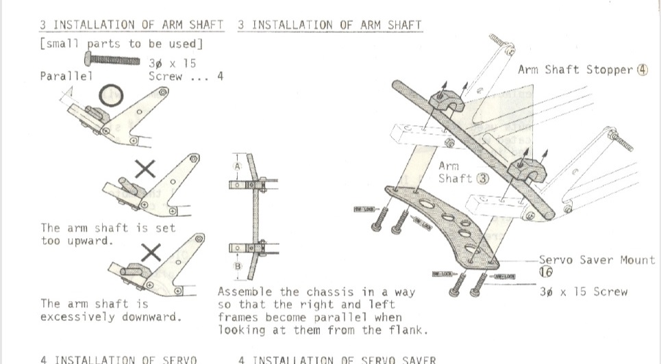

Mine was hideous looking until i dug up the old original manual that showed the proper setup.
The bar is to lay flat in line with the upward bend in the front of the main rails.
The marks on the new re re line up no where within the guidelines of the new manual.
