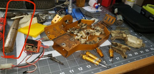

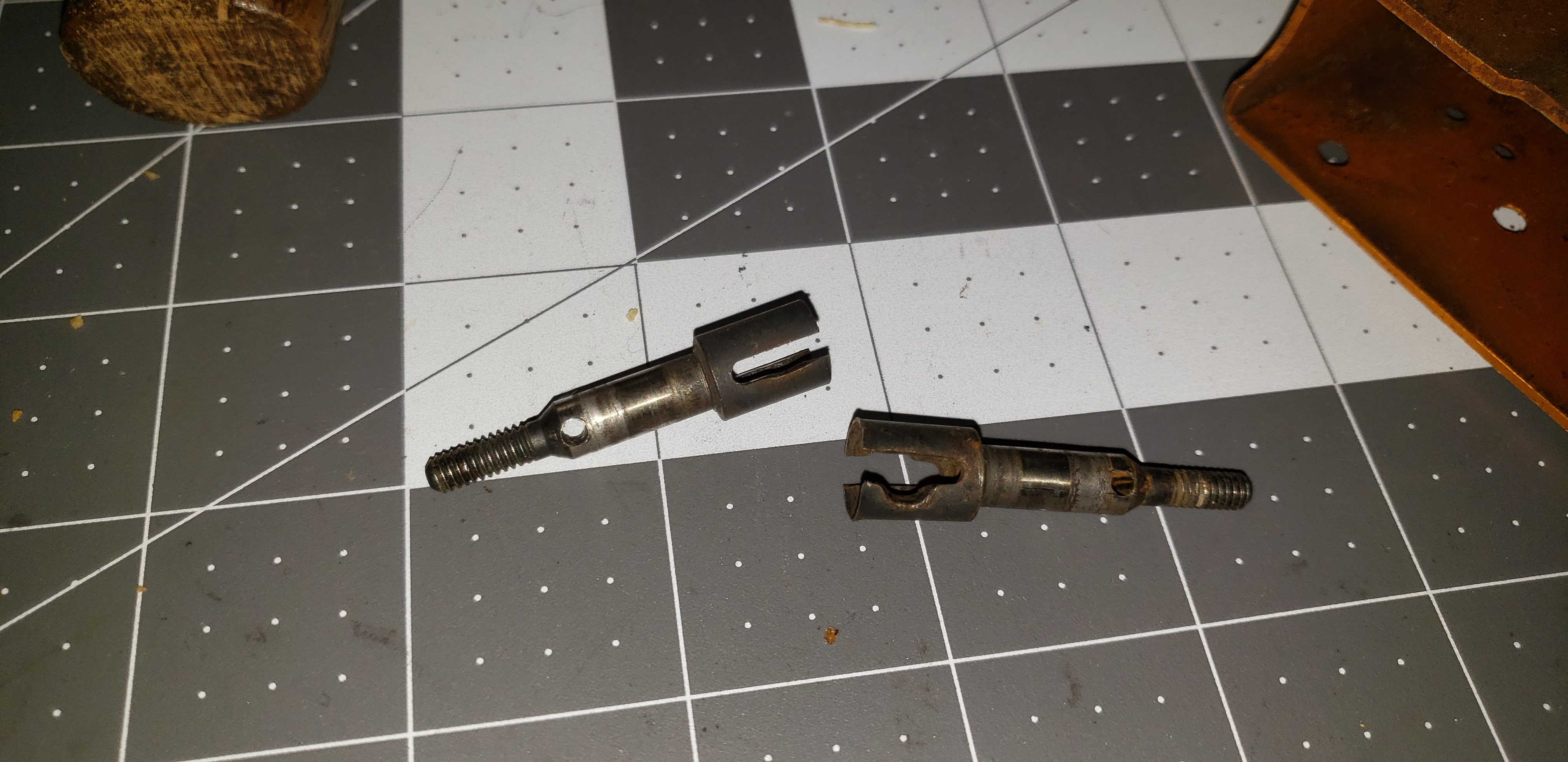

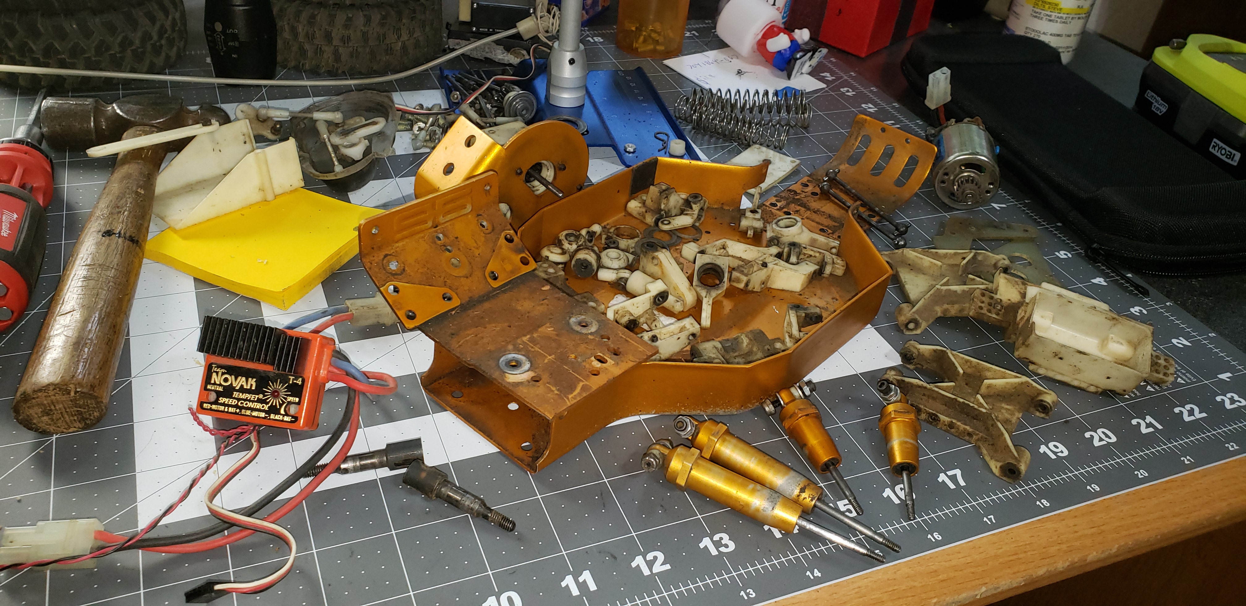

I included a couple pics this time, i have it all stripped down to clean and try the re-hydration tip you suggested. Also i was wondering if anyone knows where i could get some rear axles that will work. Mine are a bit worn. anyways, thanks, and any tips or suggestions are welcomed.
- Regular Member
- Posts: 14
- Joined: Mon Jun 03, 2019 8:24 pm
Re: RC10 Classic re vive
I found the rear axles on the Associated web site, i fell like such a dope. hahaha
