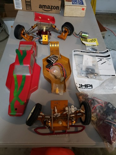

I just recently dug my 1988ish RC10 out to get back into RC. I have been having trouble finding rear axle parts. I wanted to install a CVA but the ones I found on Ebay are really expensive at $89 and $109. Is there an upgrade? Do people swap out the rear end for a wider one? The bag of parts must have had moisture because the dog bones and some of the screws have light rust and I think I am missing the little spring for one side of the rear axle.

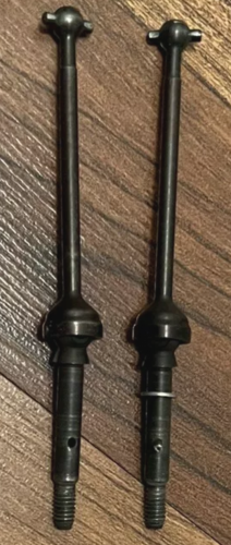

The description is incorrect, what is in the picture are 3/16" axles. You would also need (4) flanged 3/8"x 3/16" bearings, but then you get more rear wheel options with the 3/16" wheels.

The 3/16" axles would require new wheels. Not many 2.2 setups look right on a short arm car. Maybe JC Racing wheels with a narrow front.

I wanted to swap out the dog bones for CVA but it sounds like that may be more trouble than it is worth having an early version of the RC10. I am going to put it back together and see how it goes.
I think I am missing 1 of the springs for the dog bones.
I have the original rear wheels and tires but not the fronts. I wanted to swap them out for taller wheels and tires.
I found an A stamp on the gold pan. Does that give an idea of the age?
