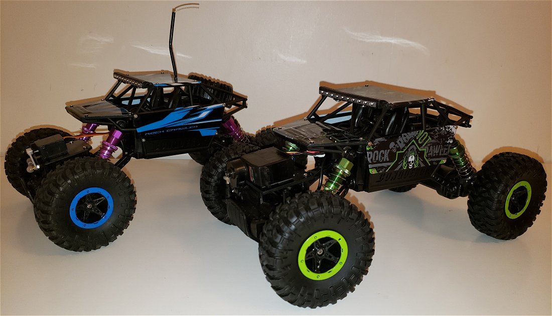

I recently picked up one of these 1/18-scale RC crawlers for my daughter. I'm not sure if she'll be into RC so I wanted to start off with something inexpensive, mod it as much as I could, and see how it ends up. These crawlers are all over eBay and Amazon, AliExpress and wherever, under a hundred different names...but I found out about it after buying a similar crawler, it turning out to be a flaming pile of poo, and researching the best 1/18 crawlers. It came up as a "CrossRace 1/18 4WD Crawler", it comes in red, green & blue, but one thing they all seem to have in common is the name "Conqueror" molded into the sides of the plastic chassis tub.
Before I get down to business, I want to first warn everyone to NOT buy this particular model; it's a very similar-appearing item but very inferior quality:
https://www.amazon.ca/gp/product/B07K7BZRJG
I originally chose this one because I liked the aluminum body sides, it looked like it might be built better...but the shocks were atrocious, even for a toy-grade RC. The shock shafts all would bend & bind, especially the left rear one, and not compress properly. I bought two and both had this problem, so it appears to be a design flaw. This metal crawler was also only 2WD. One of them had something rattling around inside the transmitter and the car wouldn't even power up. Lastly, the turning radius was very wide, and steering didn't work properly with one of the two. It would steer somewhat okay to the left, but hardly steer at all to the right. After researching the crawlers and discovering the Conqueror models above, that were the exact same $48 price (under $30 on American Amazon), I decided not to bother with the metal ones, returned both and bought the 4WD Conqueror. This model has excellent reviews and more importantly (for me), it looked like a good candidate for modding.
After I received it, the first impression was MUCH better. It came boxed up nicely with transmitter, 2 x 700 mAh batteries (instead of 1), a wall charger (instead of cheap USB charger), and everything separated into 3 separate inside boxes, instead of everything slapped into 2 halves of a clear plastic clam-shell. The car itself was secured to the main inside box with 4 zip-ties around the axles. As an RC, this crawler has some limitations, but those can be addressed with the modding.
-Throttle and steering are not proportional; they're full-on or off.
-The 700 mAh batteries are AA-size NiCad packs.
-The plastic spring-only shocks are much better than the ones on the other crawler, but still toy-grade.
-Some of the lower shock mounting posts were already cracked, new, right out-of-the-box.
I've seen a lot of people modding these 1/18 crawlers, you'll find some YouTube vids of people replacing the electronics with a decent transmitter/receiver combo (i.e. FlySky), that at least gives you proportional throttle and brake, and I saw a few vids of people hot-gluing a full-size metal servo onto the fronts of their models, and that takes care of the proportional steering...but looks like a real ghetto kludge to me. (I don't know what it is about Russians and hot glue guns...) :lol: I also saw some mods for 2S LiPo, but I think that's ridiculous as there's no way these gearboxes can handle nearly twice the 4.8V voltage...not that they're even meant to in the first place, it's supposed to be a crawler, after all. But one thing I noticed from all the YouTube mod vids is nobody addressed the piss-poor suspension. Why go to all the trouble of soldering in new electronics but totally ignore the craptastic shocks??
So here's the crawler itself; let the modding begin!

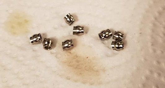

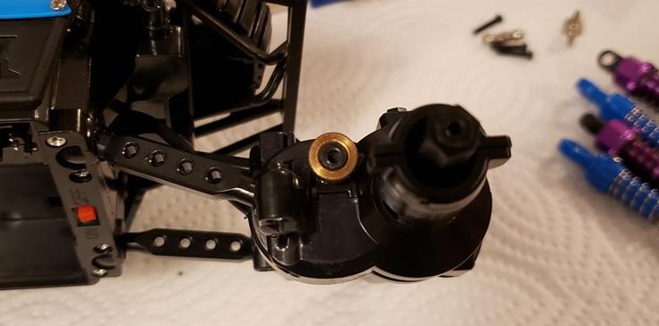

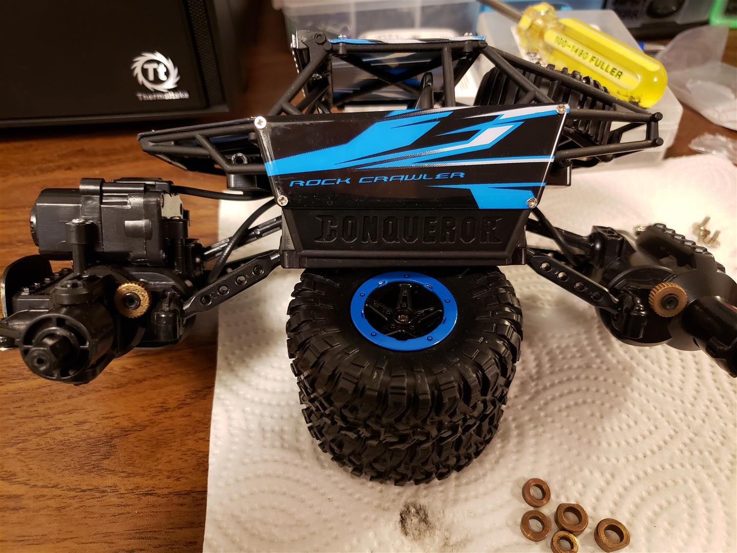

Upon removing the blue plastic shocks, I was disappointed to see some of the shock mounting posts were pre-cracked:
I decided to reinforce the posts with some spare bushings I had lying around; the posts are about 5mm O.D. so any spacer, plastic or metal with a 5mm I.D. should work:
I reinforced all 8 mount points the same way:

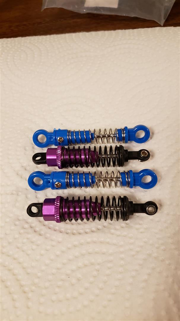

The 736092 shocks come with only a few drops of oil inside, I suspect it's only for lubrication of the seals. You need to fill them yourself. I went with the lightest weight of shock oil I had on hand, Tamiya "Soft", but I have no idea what the weight actually is. Does anyone know? Even with this oil, the shock damping will be a bit too firm. I'd recommend a lighter weight, but since I don't know the weight of Tamiya "Soft" shock oil, I don't know what to suggest.

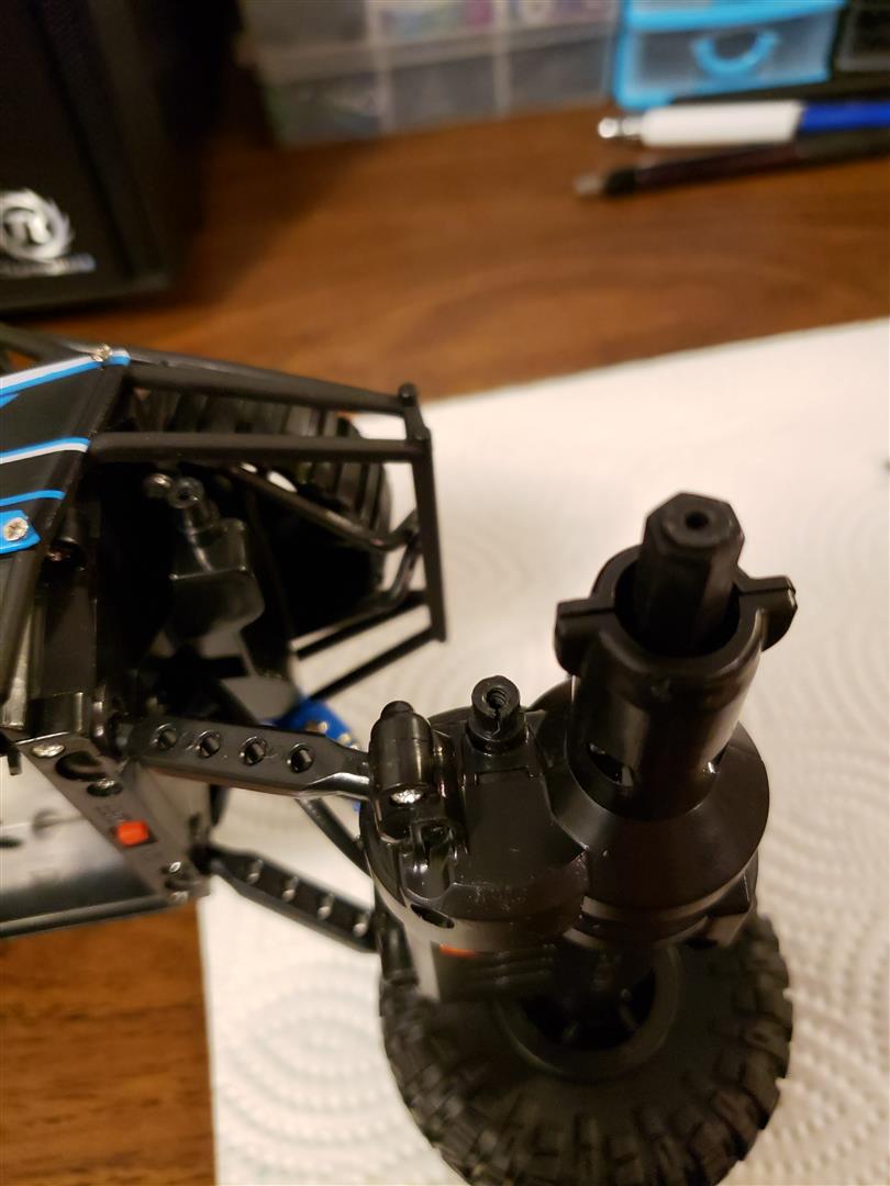

I encountered the next obstacle when trying to test-fit the new shocks; even though the shocks, side-by-side with the stock shocks when removed from the crawler are the exact same length compressed & uncompressed, I found the new shocks were about 1 cm too long when trying to reinstall them. Clearly the stock plastic shocks are already significantly compressed when installed. That might not matter much for cheap spring shocks, but it made the oil-filled shocks even a bit more firm. I relieved some of the pressure by hack-sawing off half of each shock shaft's threaded end, and cut off a similar amount from each of the plastic shock ball-ends. This shortens the shocks by 6 or 7mm. I want to try a lighter oil before modding the shock piston rings with a tiny hole, and a softer spring might also be needed, but the shocks definitely work much more smoothly compared to the stock plastic ones.
The next obstacle involved how to mount the shocks. The stock shocks have these huge ball-ends that fit over the 5mm O.D. mounting posts. I ended up using all the mounting hardware included with the shocks, plus a bunch of spacers I had lying around, to install the new shocks. One thing I had to do was cut down a few millimeters of each shock end pivot ball, as leaving them the way they were would push the shocks out too far, which would obstruct with the body when re-mounting the body. I just Dremeled them all down and filed the cut ends smooth, popped them back in the shock ends, and used washers on either end, reinstalling the new shocks with the included black mounting screws, which fit nicely right into the original mounting post self-tapping screw holes.

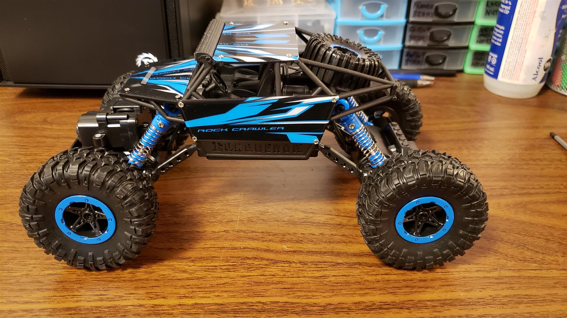

Shock upgrade complete:

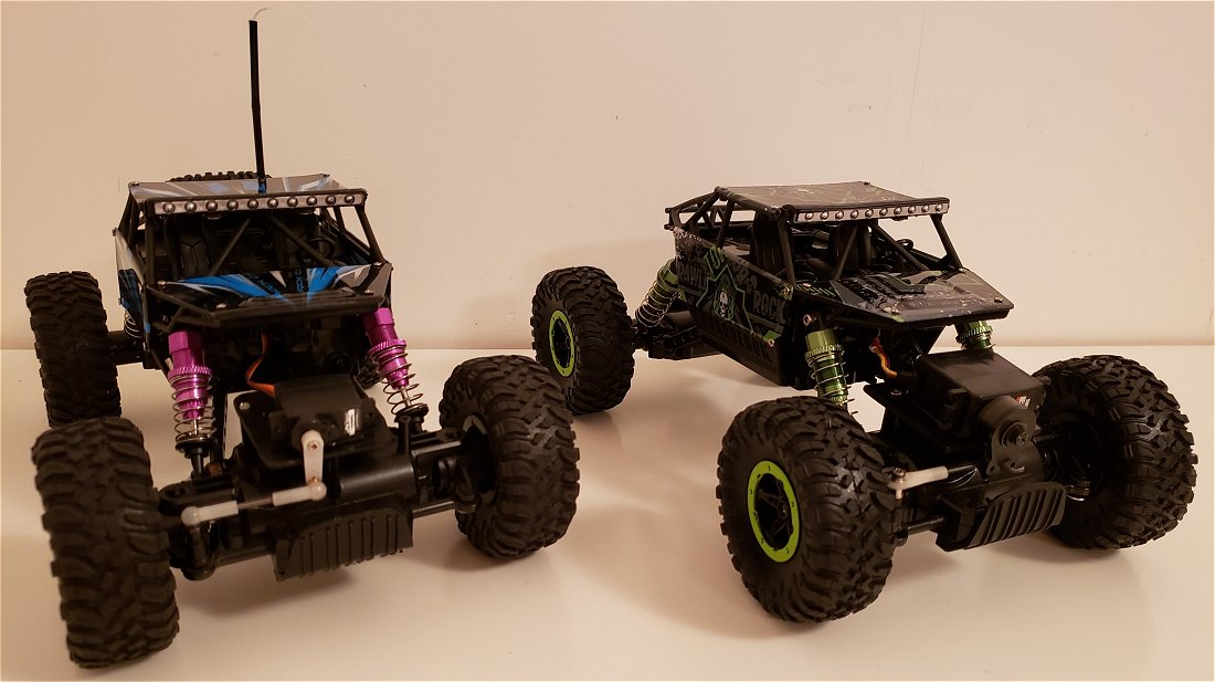

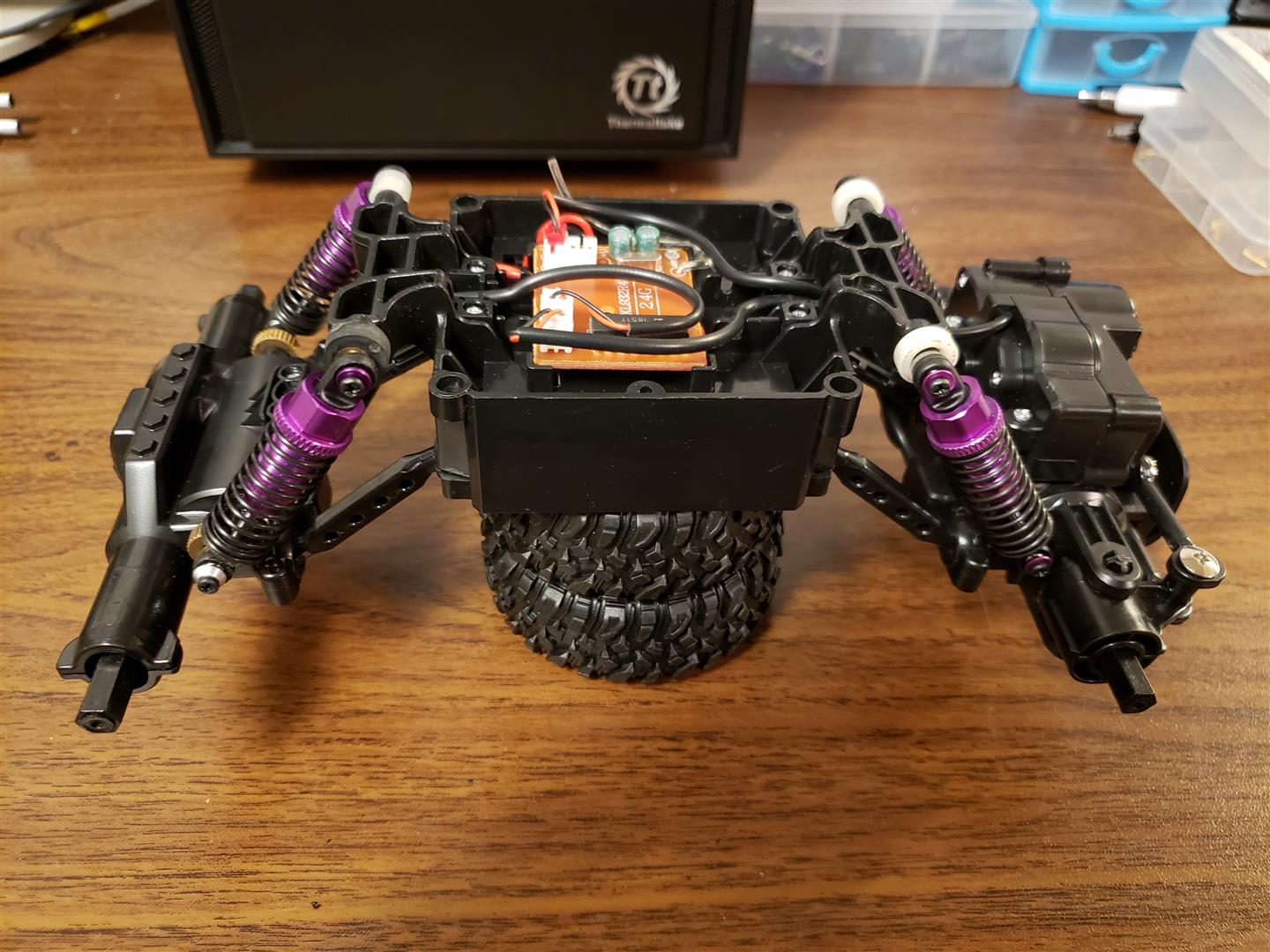

My softer springs arrived from AliExpress and they're perfect. Here's a comparison shot of the black springs that come with these aftermarket shocks, and the ones I picked up (qty 10) for $4.78 with free shipping. The wire for the black springs is 1 mm, the silver springs are 0.8 mm. They compress more easily and don't cause a bounce when the fully-assembled crawler is dropped from about 8 inches. Being oil-filled, aluminum and adjustable makes this probably the biggest upgrade to these cars that nobody else seems to be doing.
EDIT: I should also mention when I replaced the shock springs, I opened up the 2 holes in each shock piston ring a bit, using a 1/16" drill bit and just turned it by hand in the existing holes, which I would guess are 1.5mm, just a bit smaller than 1/16". I used 15WT Losi shock oil.

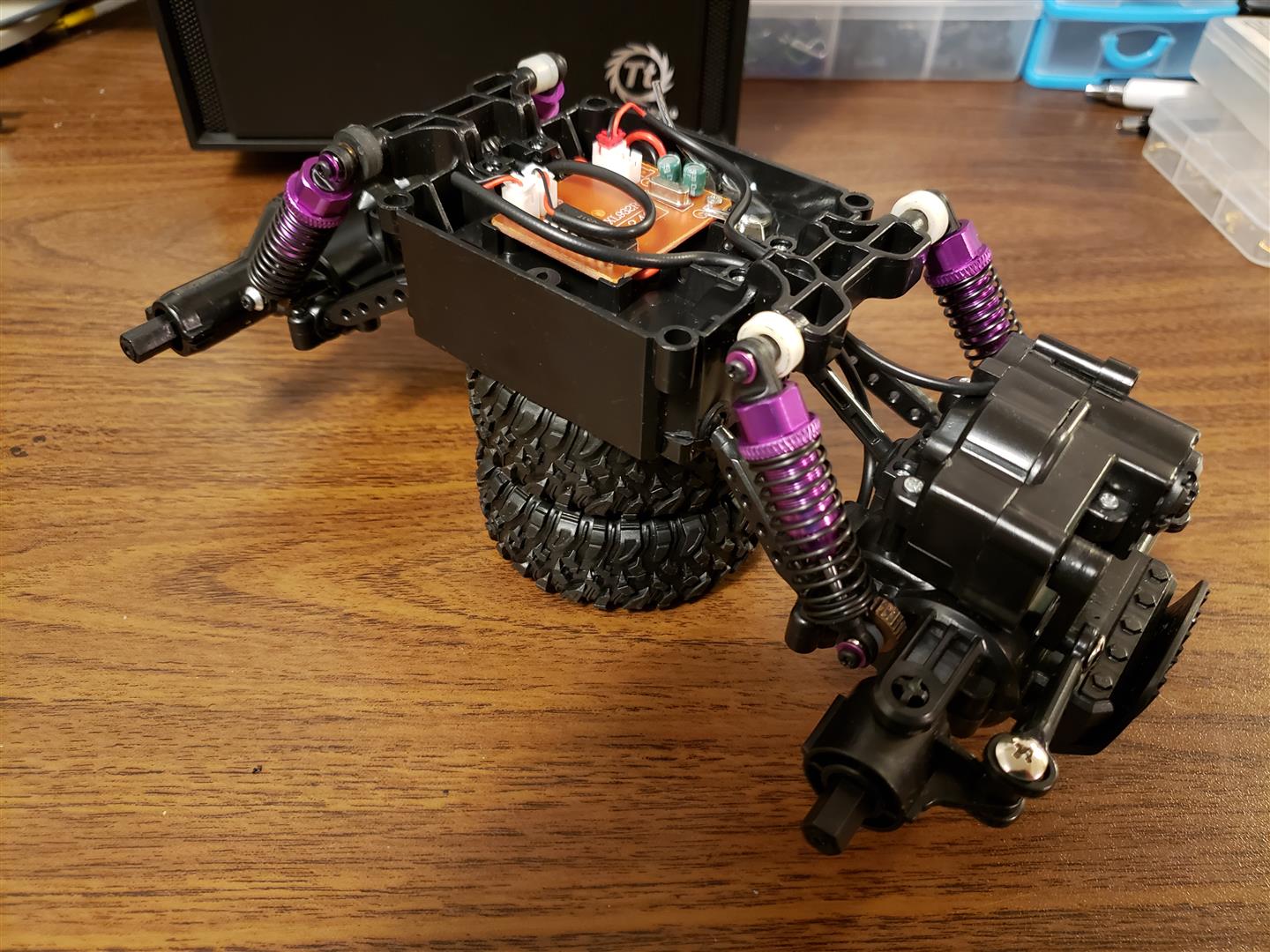

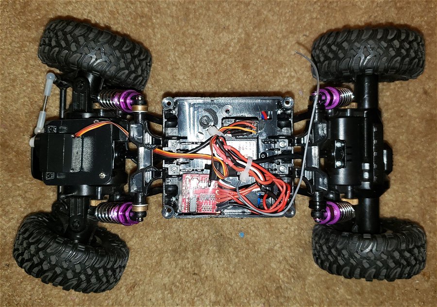

Here's a pic with the upgraded electronics installed. I had to snip off and grind flat 3 of the 4 plastic stand-off posts that the original circuit board is bolted onto, to make it easier to stick in the new electronics with double-sided tape. It took a bit of arranging before the body could be re-fitted onto the tub and bolted on. I'll show a pic of the final arrangement later, I had to move the receiver to be perpendicular to the ESC for the body to fit as opposed to the diagonal position here.

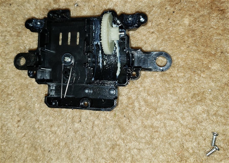

I then reopened the front gearbox and removed and tossed out this metal spring and screw, which serves to center the front wheels and adjust the trim with the original steering motor. This crawler doesn't have a steering servo originally, it has a motor that spins non-stop in either direction when the original transmitter wheel is turned, then when you let the wheel go, the spring makes the steering center link return to the middle. Obviously this is no longer needed with a proper proportional servo and would even resist its operation. On the other videos I saw of guys modding these, none mentioned removing this spring.

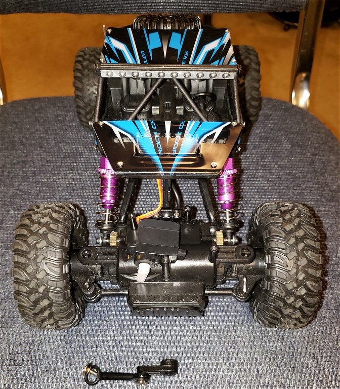

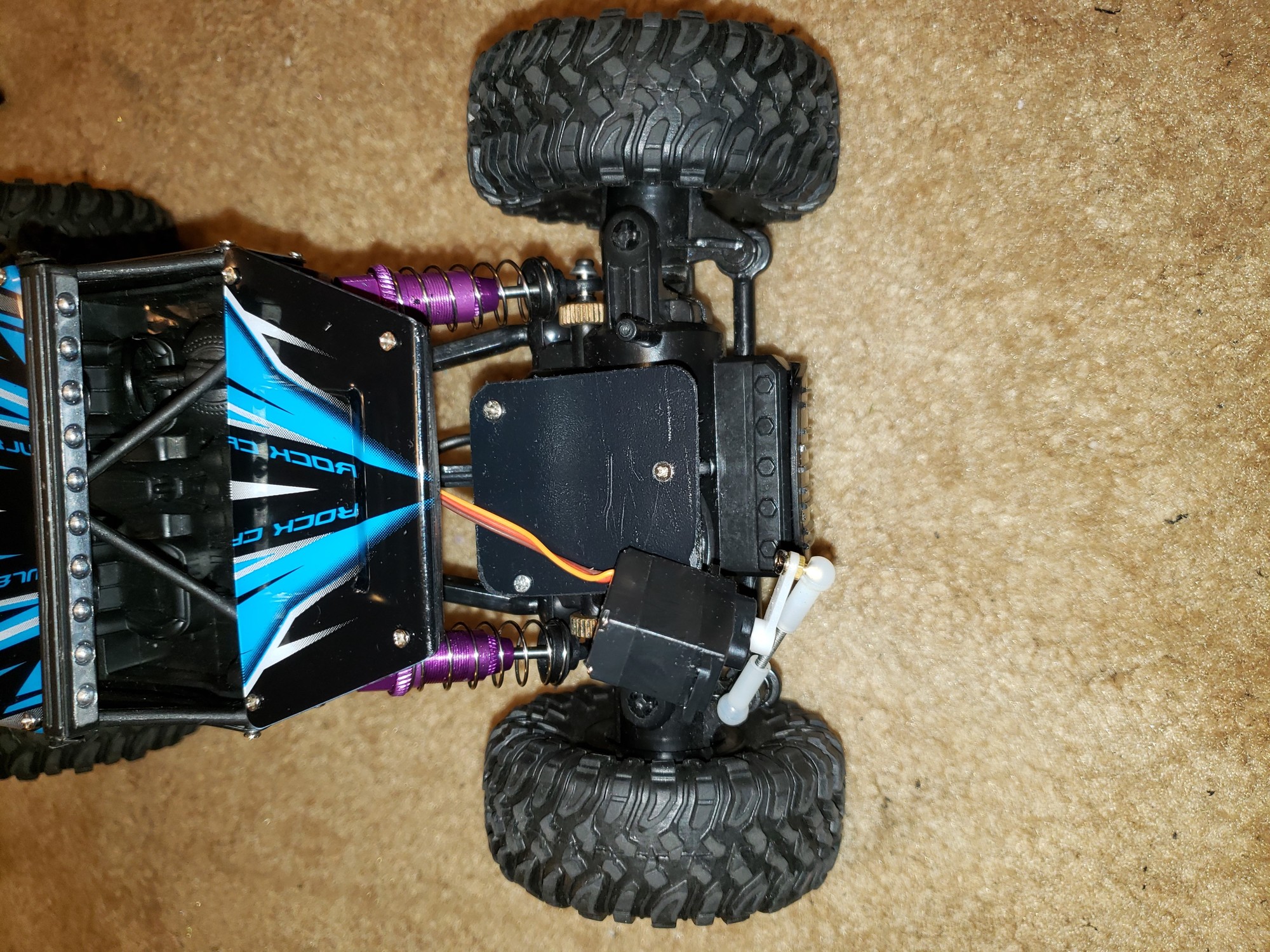

Here's the steering servo I bought to upgrade this crawler; it's under $18 CAD, I could've bought others for half that price, but I wanted this to be a micro servo and metal gear as well.
https://www.amazon.ca/gp/product/B07FPJYM5T
A pic of the front end with the steering motor assembly removed; it's a separate part from the front gearbox and removes easily enough. The pic also shows the original steering link to the right (passenger) side steering knuckle, which will need to be removed and a new steering link fabricated.
Plastic steering link removed:
I used this second video as a reference for this mod, but this guy's idea of modding is to slap hot glue on everything...and I don't like how he simply bends a wire to make the link; it gets the job done, but it's a lazy kludge.
For the servo mount, instead of just globbing hot glue all over, squishing the servo down and calling it done, I figured a small piece of Kydex would work much better, with 3 holes drilled to let it bolt down onto 3 of the existing stand-off posts that the original steering motor assembly bolts onto. I used a counter-sunk screw for the front post so the surface for the servo to attach to would be flat. Fabricating a link was easy. I made it from some 2-56 threaded rod and a few ball studs and cups; much better than the video guy hot-gluing pieces of wire to pieces of plastic.
Using the existing plastic posts to mount the Kydex piece actually puts the servo at almost the ideal height for the servo horn's bottom hole to line up with the ball stud, which I simply screwed into the top of the right side knuckle where the original plastic link was attached. I filed the middle front mounting post down a millimeter or two.

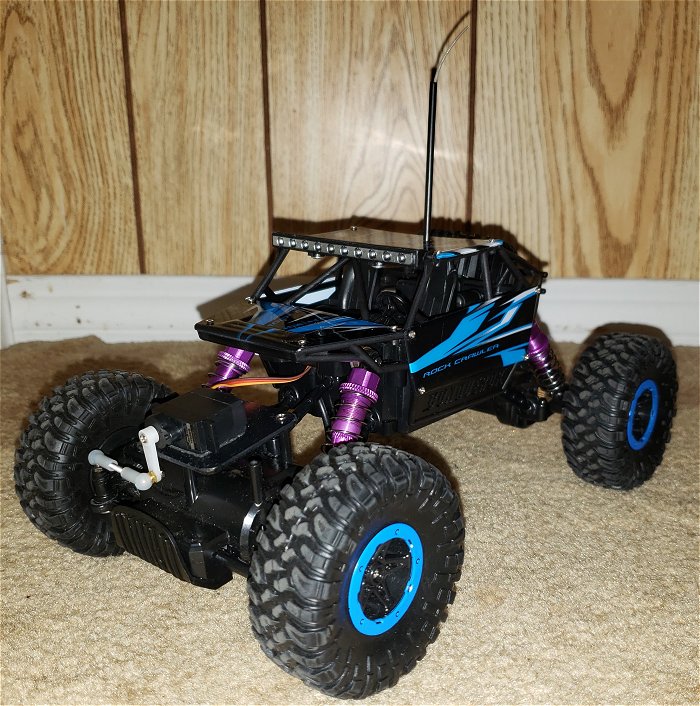

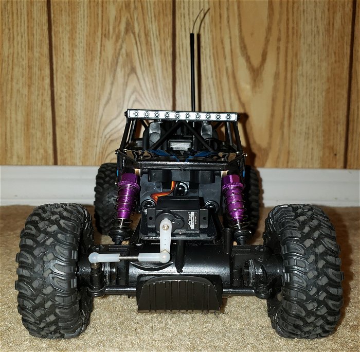

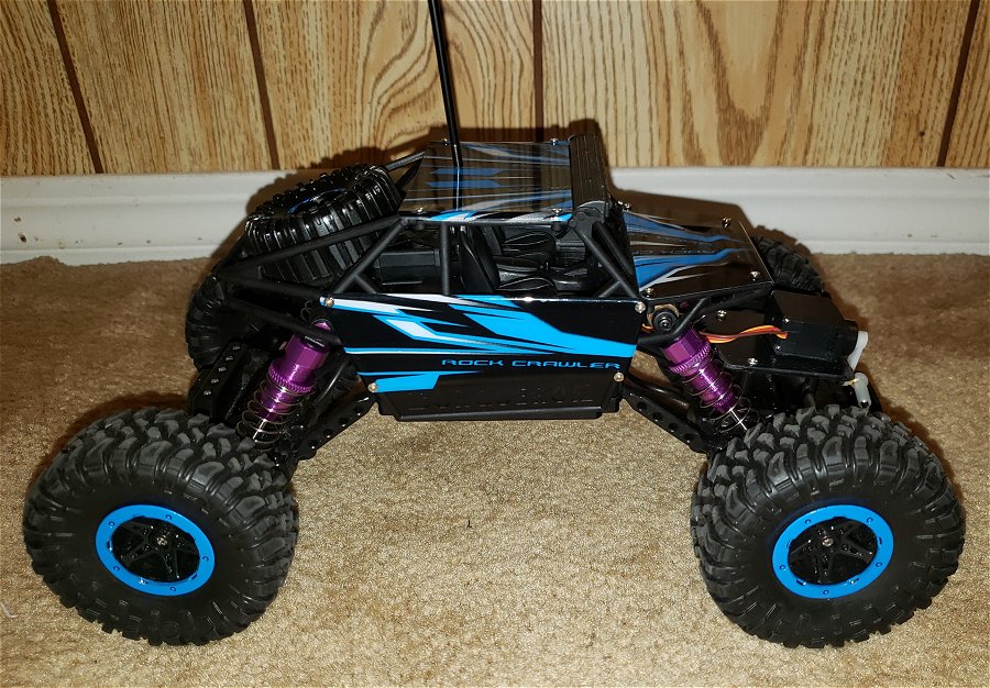

Here's a front-end pic showing the servo and linkage, and the repositioned electronics in the tub for the body to fit:
I drilled a hole through the tub and roof to slip an antenna tube inside, then hot-glued it to the underside of the tub, pretty much right behind the driver's seat. This way, the body can be removed & replaced and receiver antenna wire slid in and out of the fixed position tube.
My daughter finds it much more easy to control now that you can steer and accelerate proportionally. This thing isn't fast but it's not meant for speed. I'll upload some videos comparing the shocks before/after.
