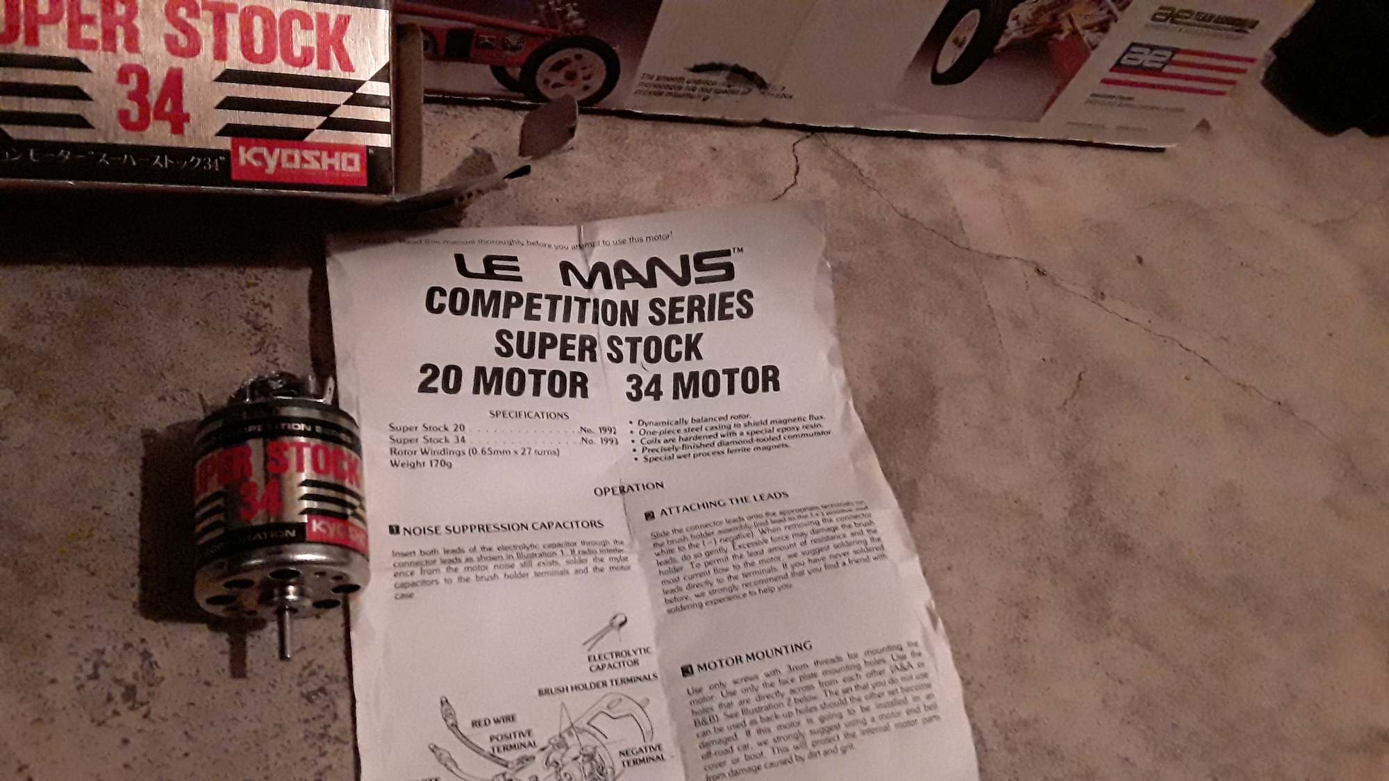

I have this Kyosho Le Mans 34 Super Stock motor that I found in the box of the RC10 I'm working on. I can barely find ANY info on the entire internet, so hopefully this will get me some more info on this thing.
Basically, if you know ANYTHING AT ALL about it, your input would be greatly appreciated! :)
