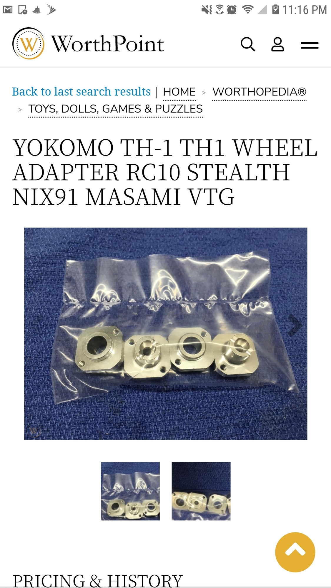

Has anyone made the th-1 wheel adapters fit a worlds car? What has to be done.. Can you drill the hub to 3/16th? Or should I source 1/4 axels? What about the front wheels? Just ordered a set.. Any help is appreciated. Thanks!

They will fit a worlds car but you need 1/4 inch axles as 1/4 inch is already bigger then 3/16 so drilling wont work.

I'd try to source MIP 1/4" cvd's or AE 1/4" universals.

if you've already ordered them, you'll need 1/4" axles of some type. whether dogbone, u-joint or cvd/a. That would be the easiest way to use them. You will also need the right yokomo wheels, the ones that are for 870c/yz10, and not the later wheels with the deeper offset, such as the JCracing sets, (until they release the right ones, they are working on them).

If there was enough demand I would have some made for 3/16 axles.

I have also had a couple of my customers that have bought mine just add a sleeve on there 3/16 axle to use my adpaters.
