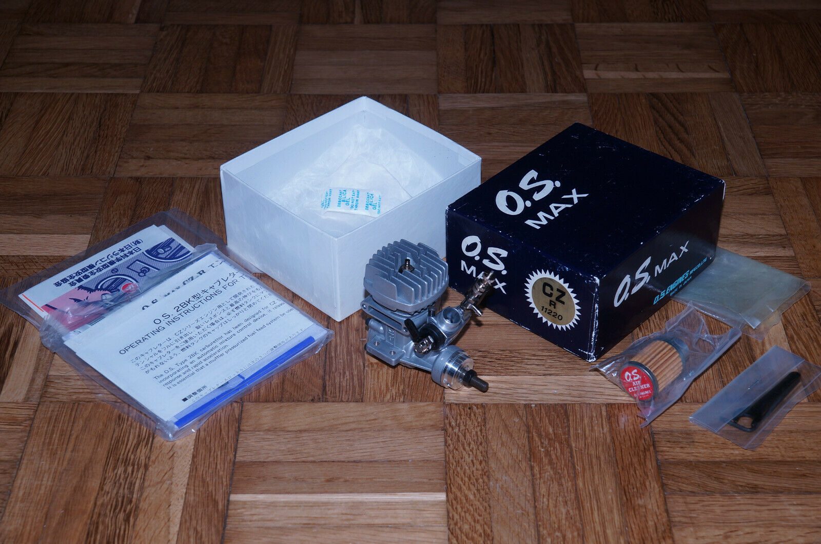

I am looking at buying this engine and trying to put the crank from my original assault , not sure if it would work so before I make the purchase I am hoping for input

CZ-1, 2 and CZ-R use the same crank minus the difference in the starter nub so yes, you can swap it out.

Is their a way I can bolt this directly to my assault instead of trying to remove the crank from the other engine
https://www.ebay.com/itm/OS-Max-12-CZ-R-2-Stroke-RC-Nitro-Engine-Kyosho-RC10-GT-RS4-c-w-Air-Filter-NIB/402246660664?hash=item5da7c4f238:g:70cAAOSwlA9enLr1

Yes. It is an identical footprint and fully compatible. They make quite a bit more power due to the better carb. Just lacking the rear start cone but your zip start should still work just fine.

Good my restart cone is shredded any way. I could probably find a root start for it. The front shaft seems to be shorter, is there an adapter I can put on there?

Front shaft? You mean the front of the crank? The one in the link you provided is full length. Some were cut down for the RC10GT but that one isn’t.

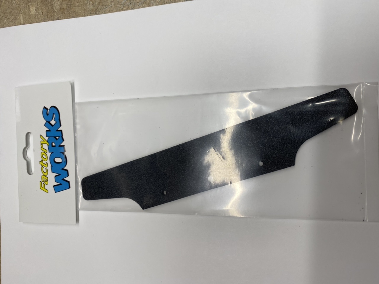

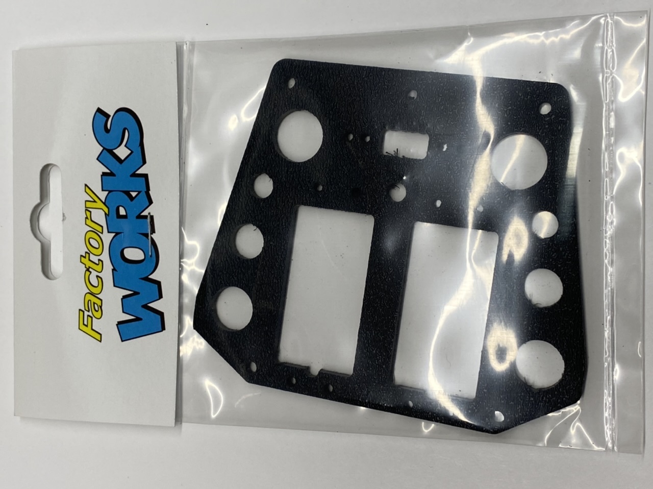

I make reproduction radio plates and bumpers for these. I’ll have them on eBay shortly, I actually forgot to relist them. Not sure about the battery holder. I assume you mean the radio box but I don’t know of any for sale. If you really mean the actual battery holder- those should be easy to find. Just need to know the connector it has on it. Red two pin is the most common.

Thank you, let me know the link for the servo tray and bumper so I can purchase them. I am also looking for the radio box that holds the receiver and receiver pack. I would like to find the rear starter cone assembly also.

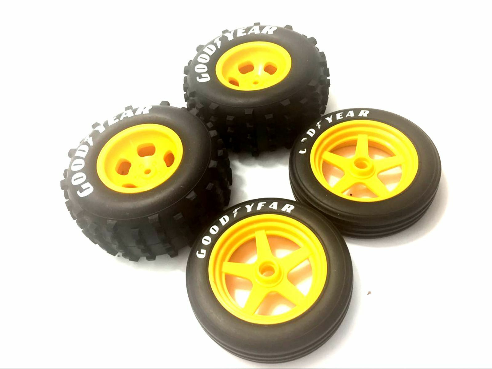

Try looking for Beetle re-release wheels, they're identical to Assault wheels apart from the rears being one piece. Part numbers are SCH004Y for the rears and the fronts are SCH003Y. Marwan does repro front and rear tyres or just get the Beetle, Scorpion, Tomahawk tyres.
