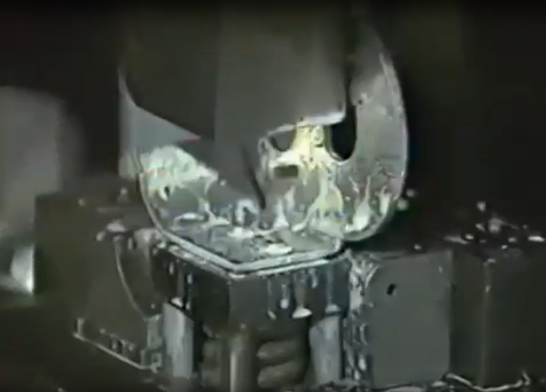

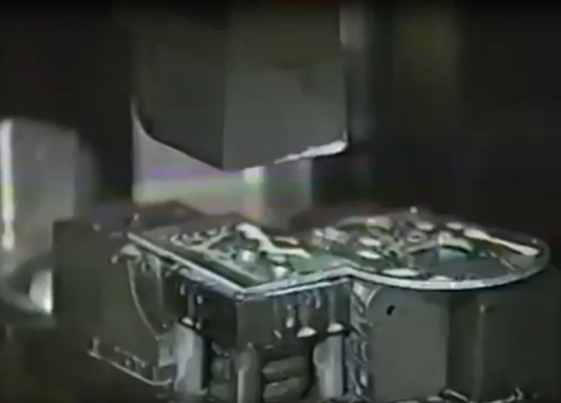

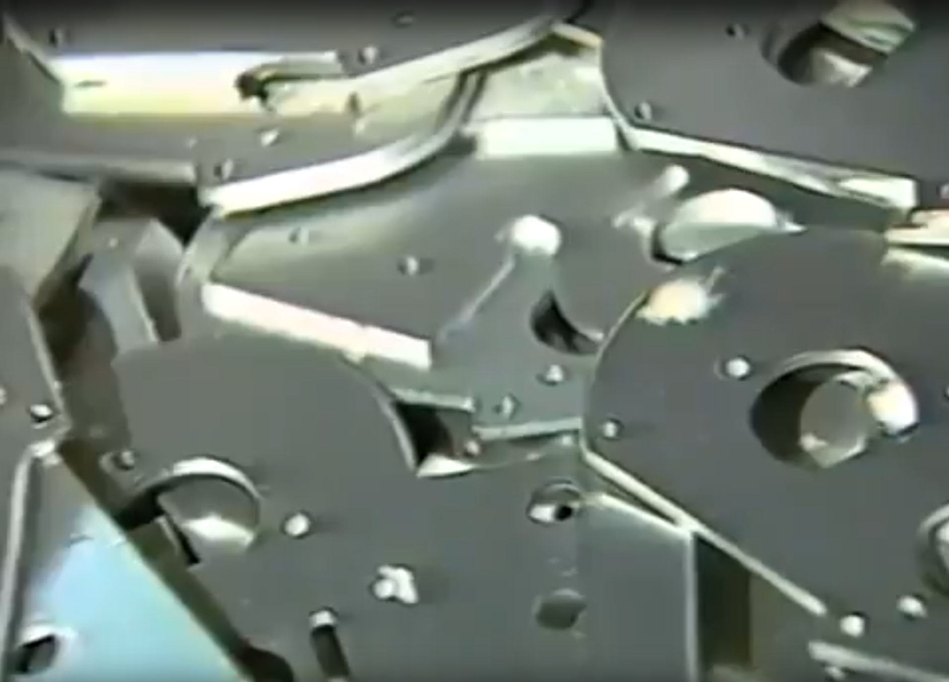

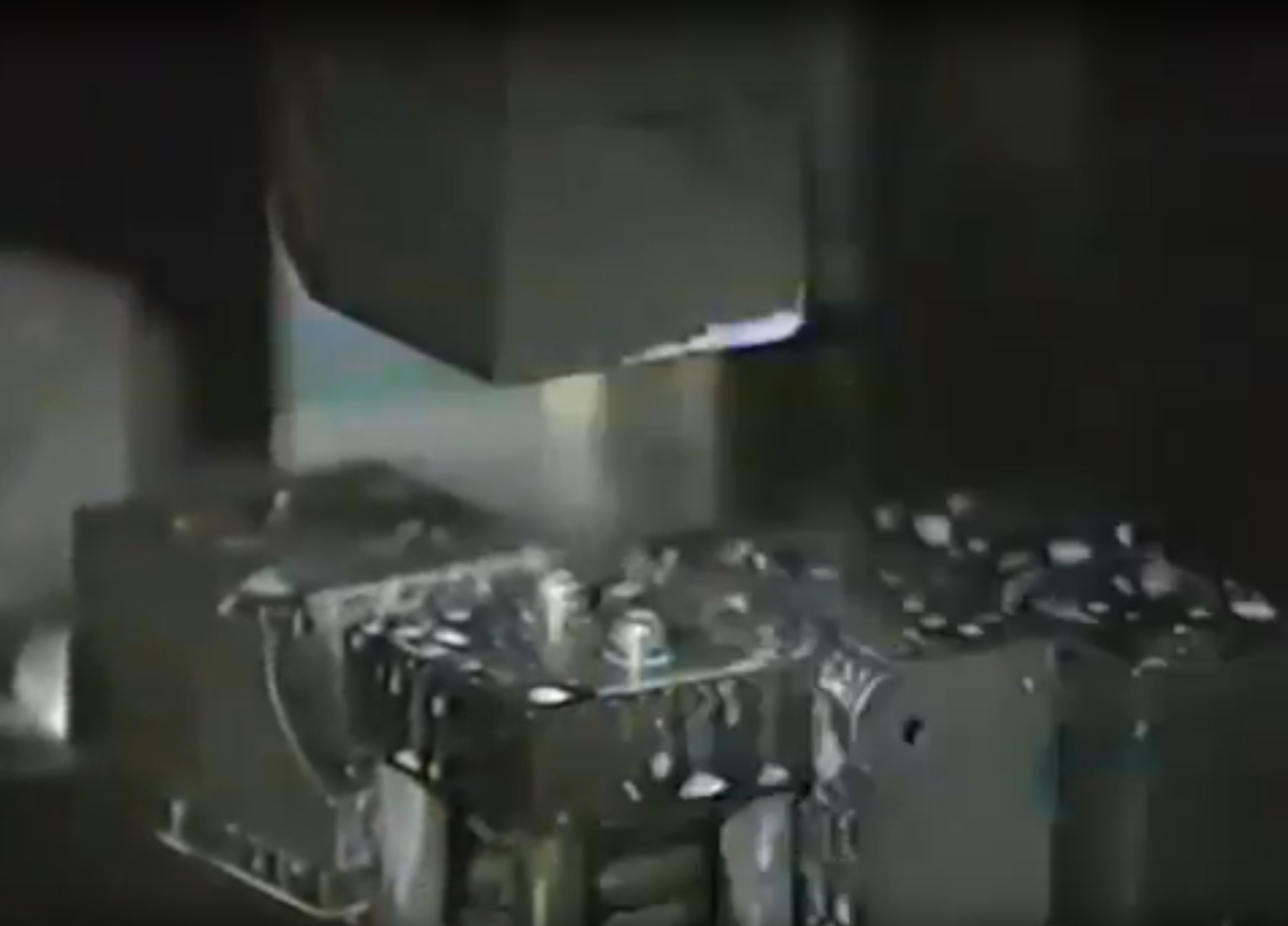

I do believe the reason for the two holes in the motor plates backside is for tooling, to hold it in the jig while the press comes down to create the two bends.
Basically the two holes were for dowels to hold the plate firmly while the press comes down and bends the motor plate at 90 degrees and also forms the back curved surface, all in one motion. I think you can see a quick short clip of this in the "RC10 The Winning Edge with " Jammin ' " Jay Halsey " video...check youtube.

Ruffy wrote: Sun Oct 25, 2020 10:03 pm I do believe the reason for the two holes in the motor plates backside is for tooling, to hold it in the jig while the press comes down to create the two bends.
You nailed it Ruffy, good eye! 8) I watched the whole video last night and took some screenshots of the process, those holes most definitely were used to hold the flat motor plate blank.

Awesome stuff, thanks guys!!
I've always assumed that the part was fixed by the motor plate and the top and back were pushed and formed over it. Seeing the images from the video it's obvious they've chosen a simpler and much more efficient method.

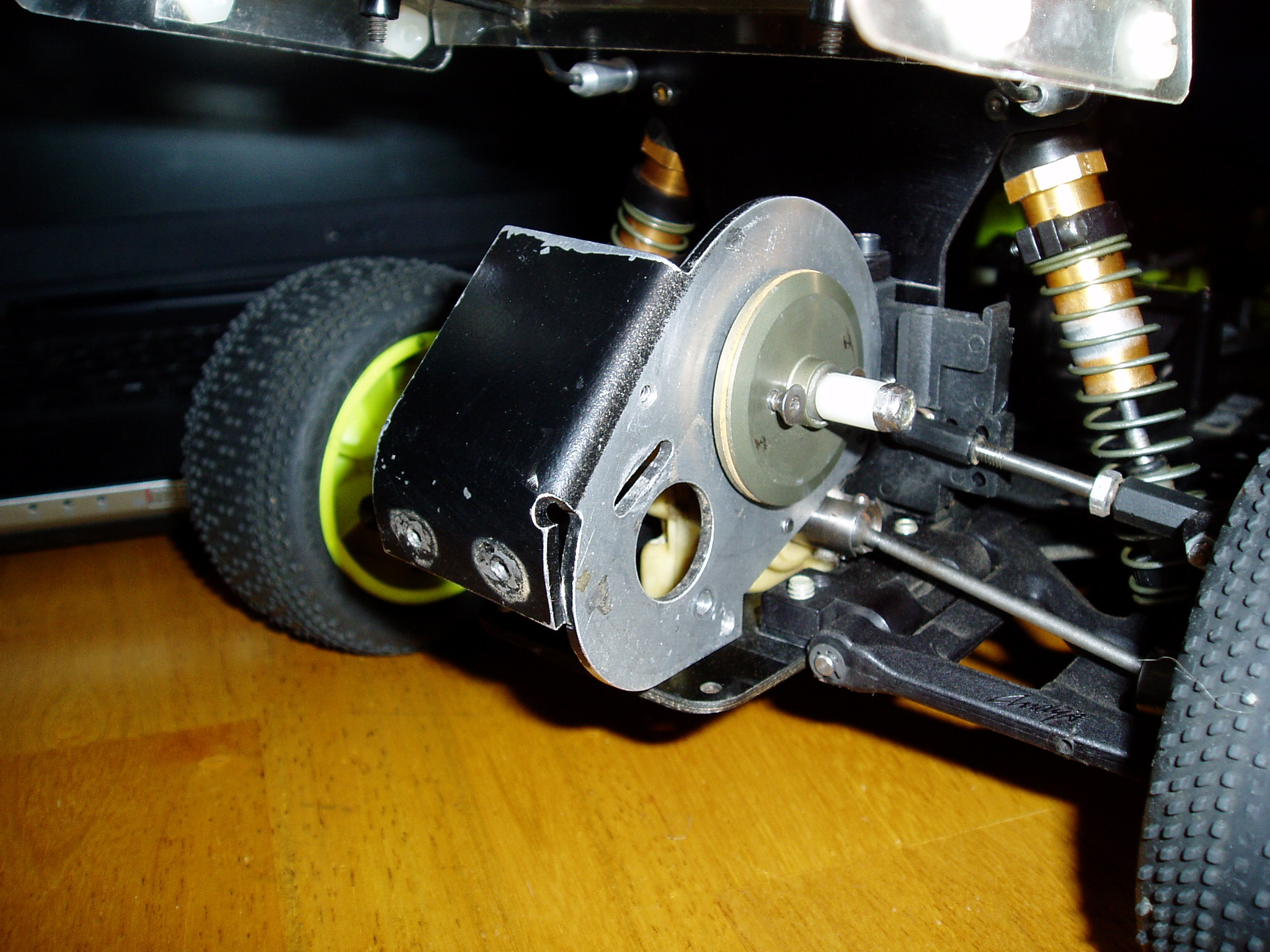

For what it's worth, I have made a motor plate for one of the runner cars -- no access to special tools or a press. I just traced the part, cut a blank then clamped and formed it around a block, doing my best to emulate with crude hand tools the process I thought AE had used. Clearly, I was wrong. Thanks for setting me straight on this.

XLR8 wrote: Wed Oct 28, 2020 9:51 am For what it's worth, I have made a motor plate for one of the runner cars -- no access to special tools or a press. I just traced the part, cut a blank then clamped and formed it around a block, doing my best to emulate with crude hand tools the process I thought AE had used. Clearly, I was wrong. Thanks for setting me straight on this.
You did an awesome job on that plate Doug, looks great! Reminds me of the plate on the RC10 Prototype car, just need to light gold anodize it :mrgreen:

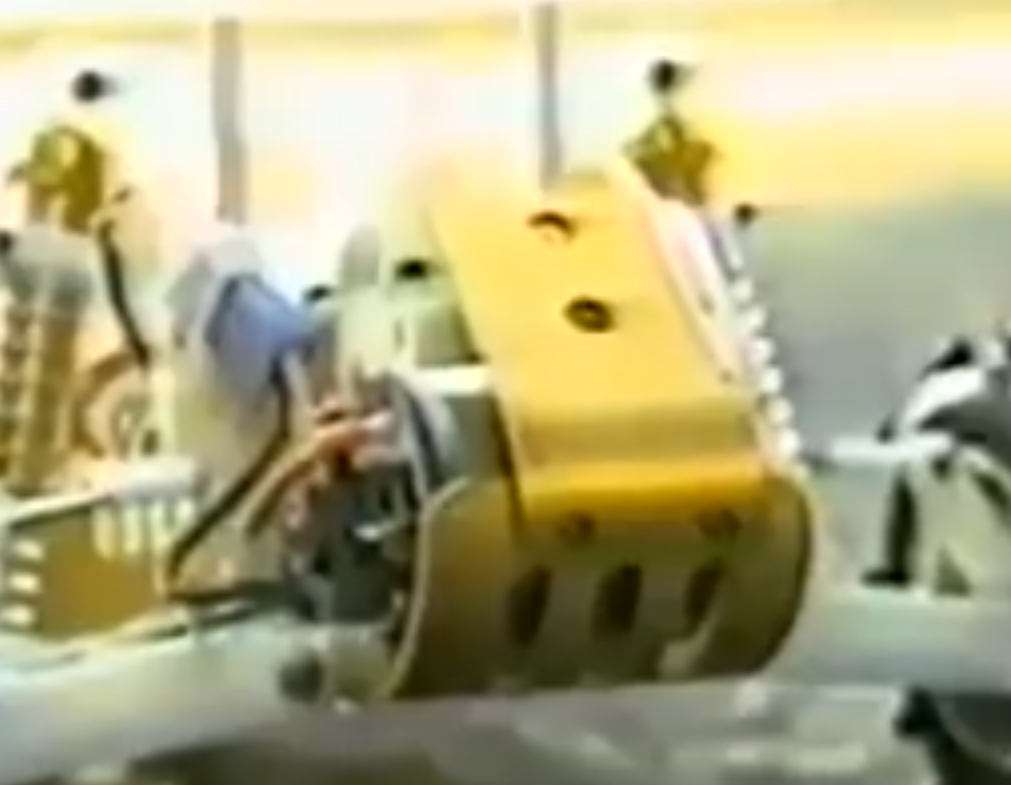

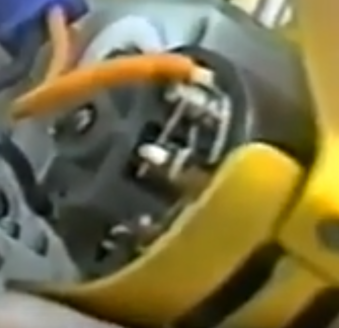

While we are talking about motor plates and The Winning Edge video, I found this interesting too:
Notice the motor plate on the outside of the chassis versus the inside...
->Mark
XLR8
Posts: 3318
Has thanked: 1684 times
Been thanked: 1180 times
Re: Have you noticed...
Post by XLR8 »
Thanks Mark. It's not pretty but it does the job.
I noticed the odd motor plate mounting as well and was about to post a still image but you beat me to it.
I've never seen a motor plate installed that way before. Roger Curtis refers to the car as a "final product" and the video is dated 1986 (roughly 2 years after the car was released) so it seems odd to see the motor plated assembled inconsistent with the manual on one of AE's own cars.

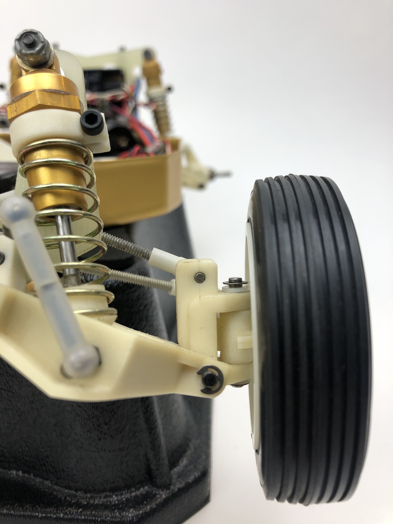

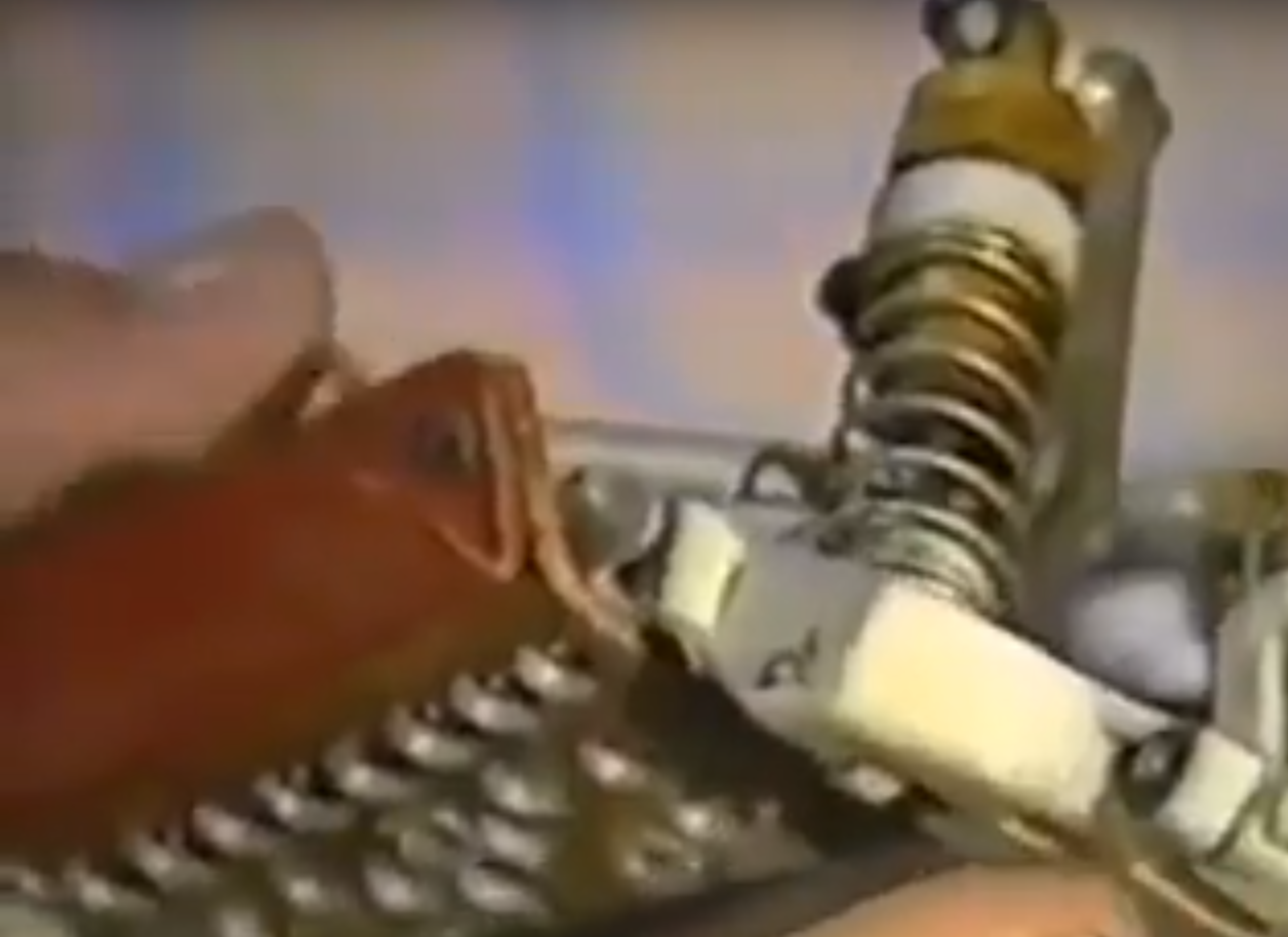

Well... now that we are in the rabbit hole... Here is another interesting observation:
Notice the upper ball stud location on the front block carrier, the hole appears to be offset from center to the outside of the carrier. If you look closely it looks as if the left and right block carrier is reversed on this car, either that or the early design had relief on the front edge versus the rear edge of where the steering block fits.
Compare with the hole on the 'production' block carriers as seen on this mid-Edinger, we see the ball stud is centered in the block carrier.
What is real interesting is I never noticed that for whatever reason the ball stud went back to offset for the re-release car.
XLR8
Posts: 3318
Post by XLR8 »
That's curious. The car Roger is holding appears to have very little castor angle (less than 30 degrees) so the castor blocks can't be reversed. Since the car has 30 degree kick angle, fitting a castor block backwards that was made to yield less than 30 degrees total will always yield greater than 30 degrees castor angle. If, for instance, a 20 degree block is reversed, it will yield 40 degrees total castor angle. I don't believe AE ever made a block with castor angle greater than 30 degrees total (30 degrees = hinge pin perpendicular to king pin) so it's impossible to reverse them and achieve less than 30 degrees. Anyway, I've gone around and looked at every block I have and all of them have steering stops so the block in the video is a mystery.
As for the ball stud location, looking at the blocks I have, it's really a mixed bag. For two of the cars that I've owned since new (mid to late Edinger) plus one Cadillac RC10 that I know is original, the blocks have centered studs. But many other cars in the collection have blocks with offset studs. I have a NIP set of 30 degree Cadillac blocks that are offset stud. Most of my 20 degree blocks are center but not all.
We may never solve the castor block mystery but it's interesting to consider how the car has changed over time.

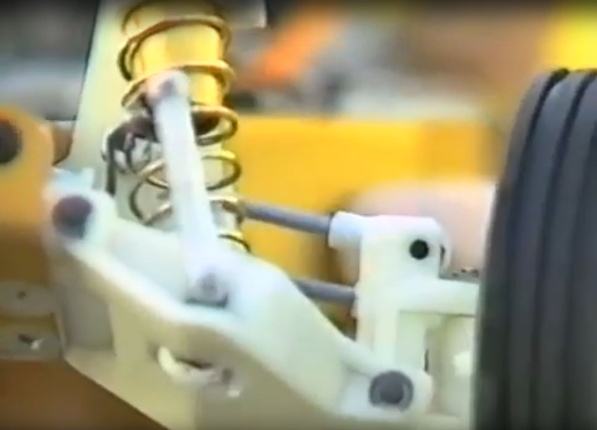

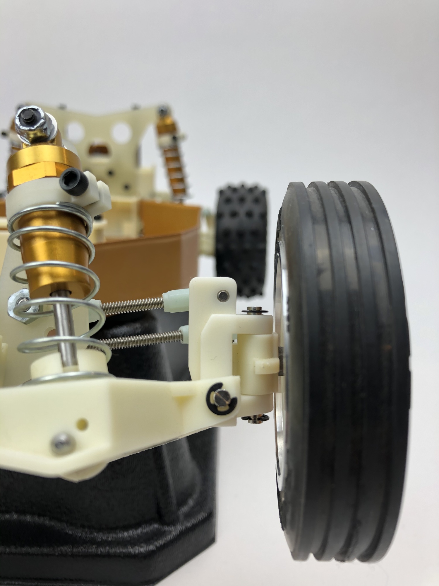

New one for today... :lol:
What is the consensus on what appears to be an aluminum bracket capturing the inner hinge pin on Jay's front a-arm?
Also, holy heck that is a lot of lightening holes...
