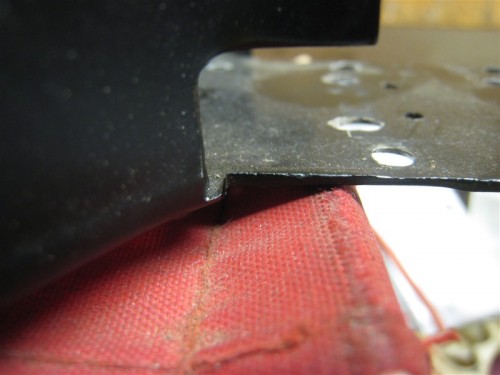

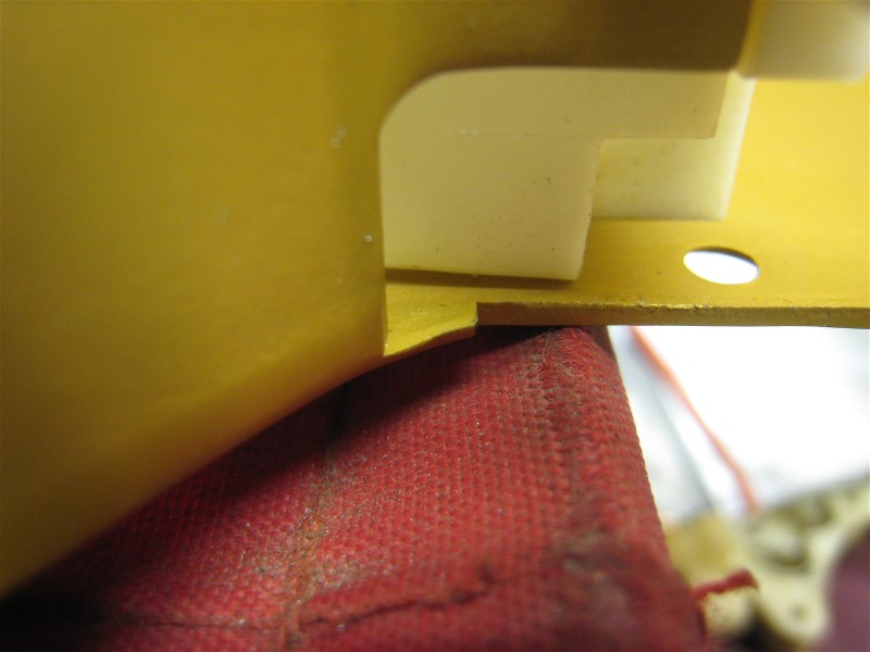

it's hard to believe i just noticed this now. maybe i did know and just forgot, or it's just matter of finding it because of using certain parts.........
A stamp
B stamp
see the difference? i'll have to be careful with the dremel on the new ano. :lol:

Looking at the two I'm wondering if this was just a simple difference in the manufacturing or a conscious change? My guess would be the small change would help the flex in the chassis at that point

I just checked several A stamp chassis against my two B stamp chassis and they all seem to validate the difference.

without the relief on the B stamp, when using the second version rear bulkhead that allows you to slide the arm mounts ahead to the short wheeelbase setting, the old style arm (for long inner hinge pin) hits the chassis. once that area is removed it clears.
i wonder if that is actually what an AB stamped tub is......... a 6 gear only tub but notched for the needed arm clearance.

I didn't know that the B stamp chassis were like that but I remember having to remove that bit of extra aluminum from my A stamp when I wanted to mount my rear suspension blocks in the shorter position and use RPM team arms. The aluminum interfered with the arms.

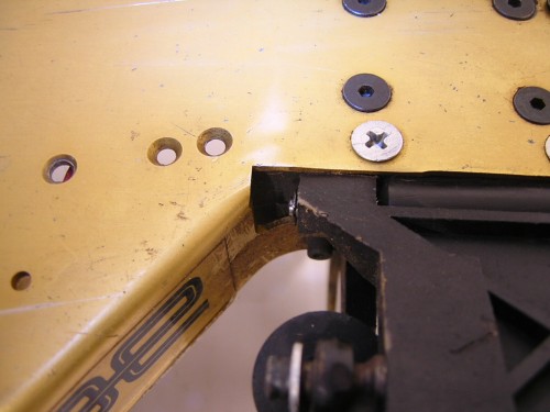

No Stamp is a little different :wink:

Yeah. That's what mine looks like too.

that's a stress fracture waiting to happen....
