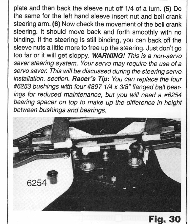

Ok, another question since my RC10 classic is my first 6 gear. Can anyone tell me how to properly install the bell crank steering? What do I do with the little plastic washers on the parts tree? I'm guessing the nylon screw is installed upside-down (in comparing with the A&L unit) in order to hold everything together? Why is there another middle link? Should it be the same length as the stock one? Once I am inside the castle, how do I find Count Rugen?

The other link it comes with is to replace the "z" link for the steering servo
They don't show the thin washers used in the manual but I'm pretty sure I remember using the on the chassis side and carefully installing the nut down over them
