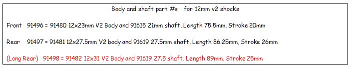

A while ago when looking at RC10 shock alternatives I took a few measurements.
I saved this chart for future reference. Measurements were for the Associated big bore V2 12mm shocks.
Eyelet to eyelet with short lower eyelets, long lower eyelets add about 2 additional mms.
I only wish I had bought several sets early on as an Ebay "chop shop" sold me the first 2 complete sets ( fronts and rears with springs, eyelets, multiple spring cups, etc.) for $38 a set.
Chuck
