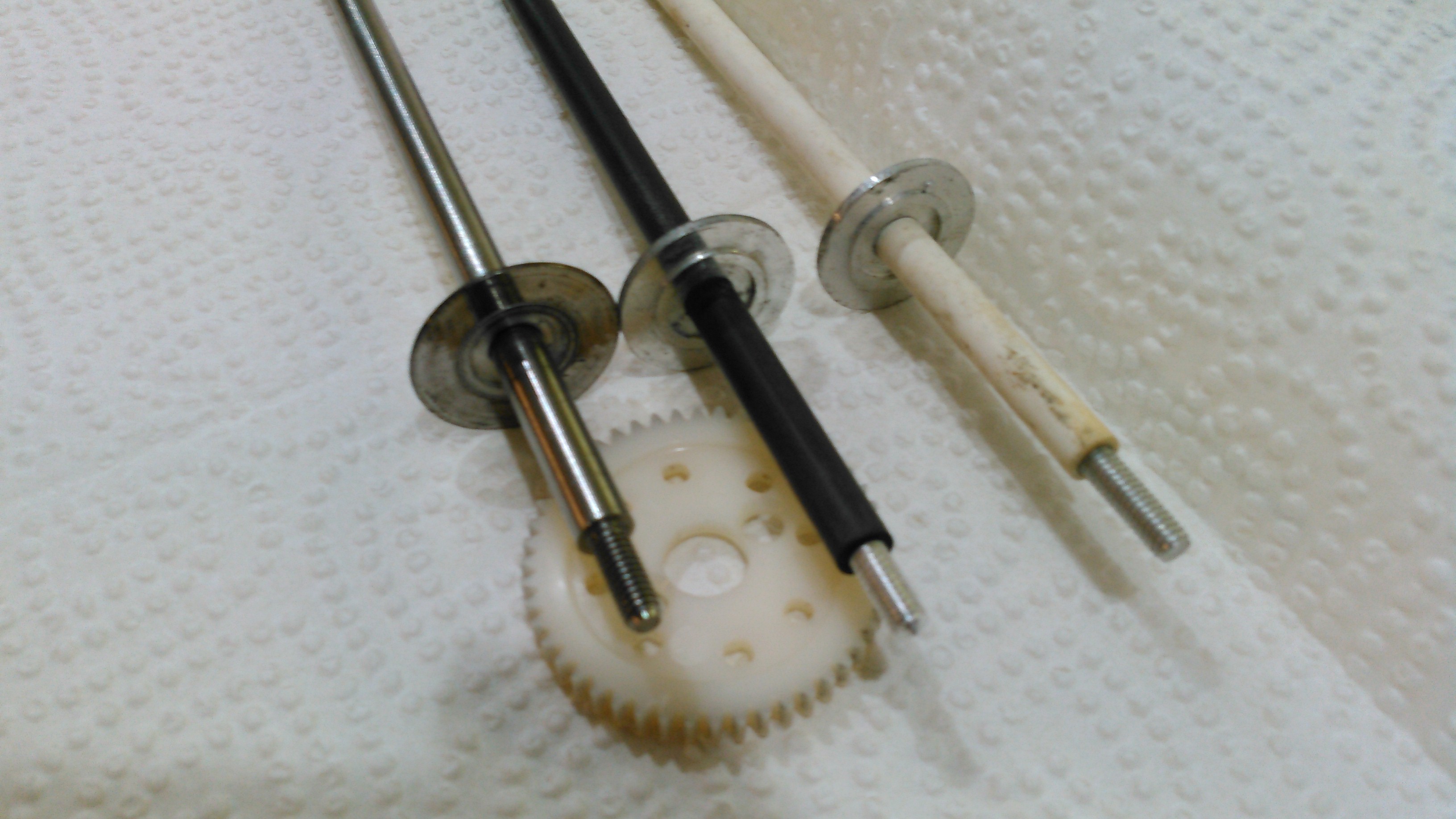

Greetings,
I have a few aftermarket pan axles that do not have the "seat" for the spur gear. Is there some kind of spacer that should be used to center it on the axle? The OEM ones have the area where the spur seats in the center. All these axles use standard diff rings, but do not have the spur seat.
Thanks!

I think these axles were meant to be used with a 1/4 x 3/8 bearing for the spur.

Just to confirm, this is an 1/4 x 3/8 x 1/8 (R168ZZ) non-flanged bearing?
Thanks!

80sRunner wrote: Sat Jan 16, 2021 12:53 pm Just to confirm, this is an 1/4 x 3/8 x 1/8 (R168ZZ) non-flanged bearing?
Thanks!
Flanged is recommended but i dont think it necessary.

Bearing in the spur is unflanged. The axles bearings are flanged.

GoMachV wrote: Tue Jan 19, 2021 11:20 am Bearing in the spur is unflanged. The axles bearings are flanged.
I meant to type “un” in front of flanged, 😉. God damd spell correct.
