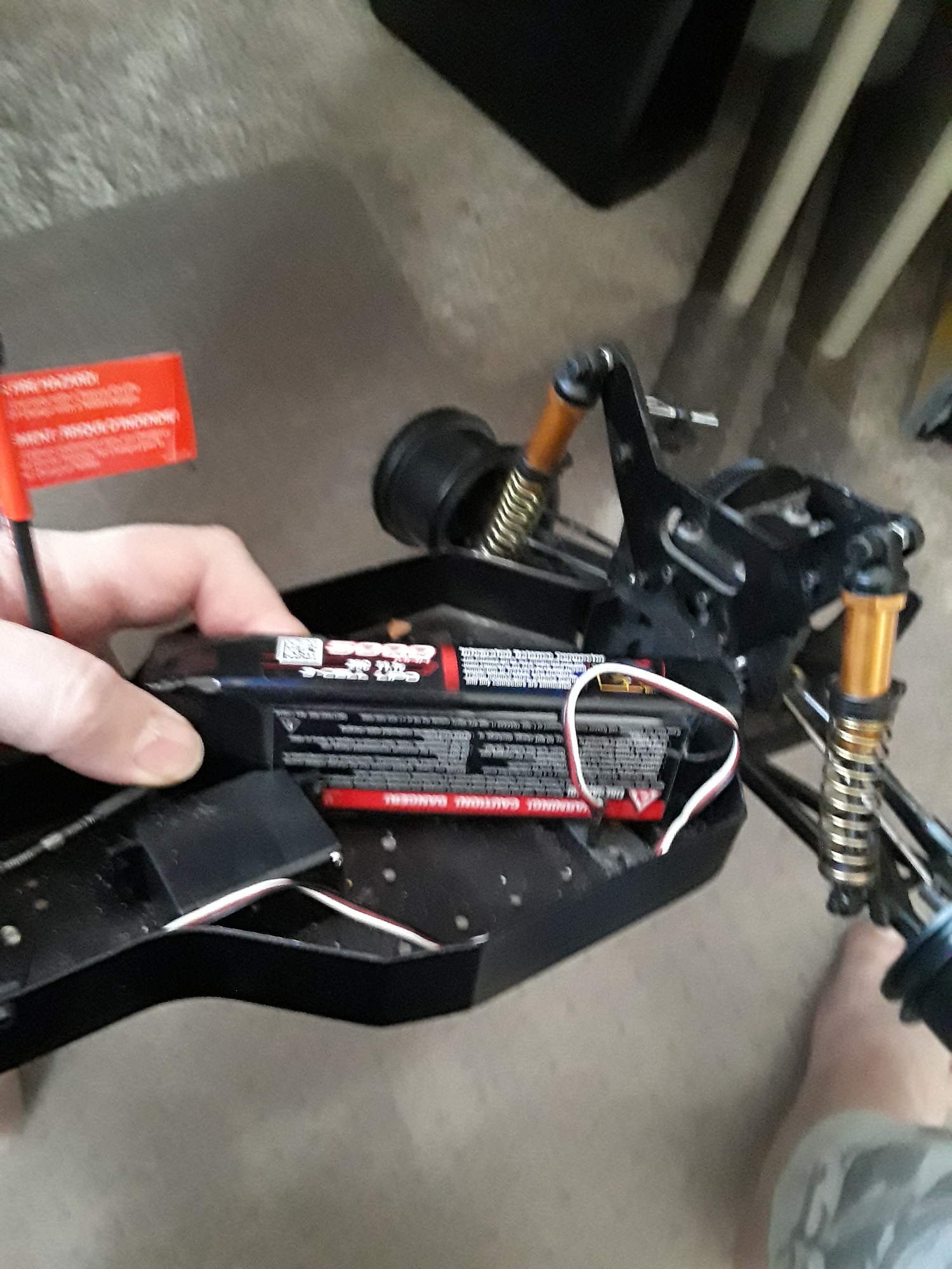

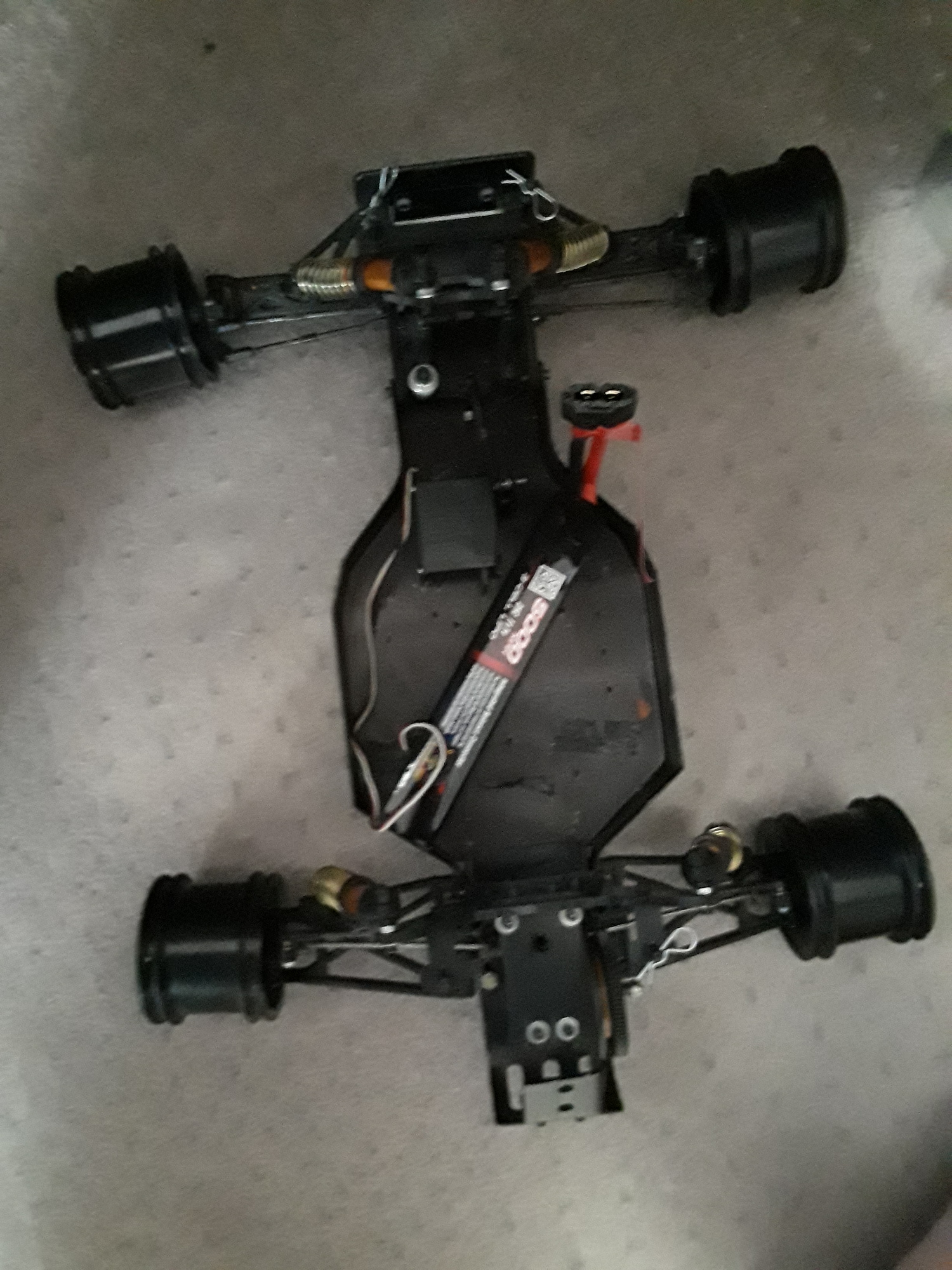

Some of my parts came in today, to include the 3S battery. I have ordered a 2S and it should be here in a couple days with similar dimensions. Using the 3S for layout placement, I was wondering what the best way to fit the battery into the chassis. I knew prior to ordering that it would be too wide so I was thinking of cutting the sides down about 10mm x width of the batter + the insert I was going to print, but then when playing around with it I though maybe that might actually cause it to fall out of the conditions were right.
I notice that I can place the battery diagonally with about 5mm+ left on each end. This would allow me to print up a mount for both ends that I can properly secure to the chassis and lock the battery in. The connector wire is above the frame so no rubbing issue. But to achieve this it would have to sit on it's side. I believe it should be fine. I figured I'd ask what other people have done in these types of upgrades.
