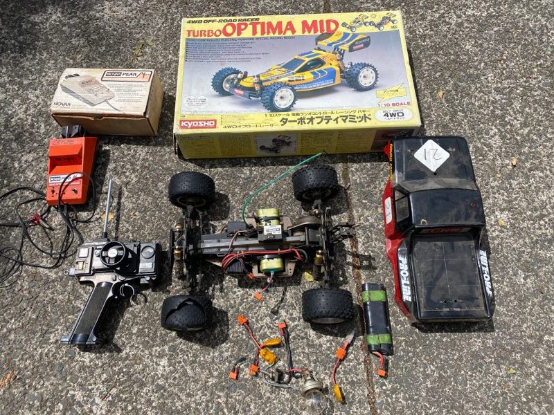

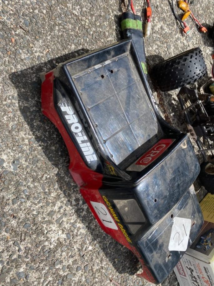

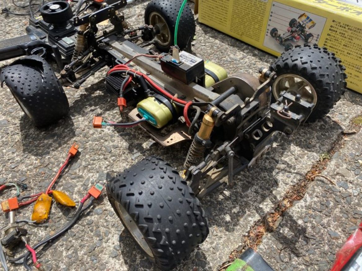

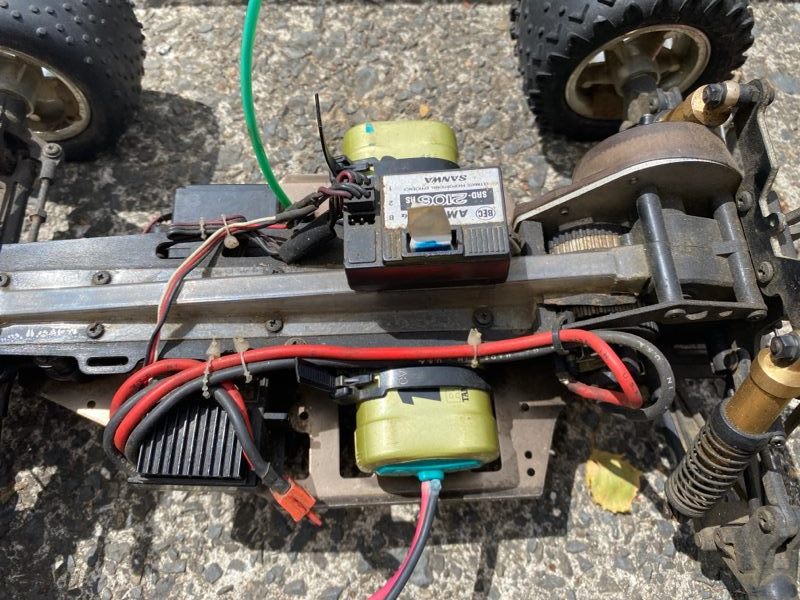

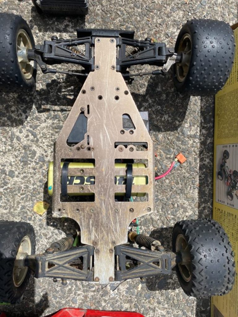

I just picked this lot up, it cost me a good US$300, but I think it's worth it.
Sold the Dynatech to a mate, so that took the cost down.
Looks like a Proline or JG truck conversion and a Sassy chassis-might put some tires on it and run it for giggles!
I have some new front shocks, here, does anyone have a new SWB chassis?
I can't believe how good the box is!

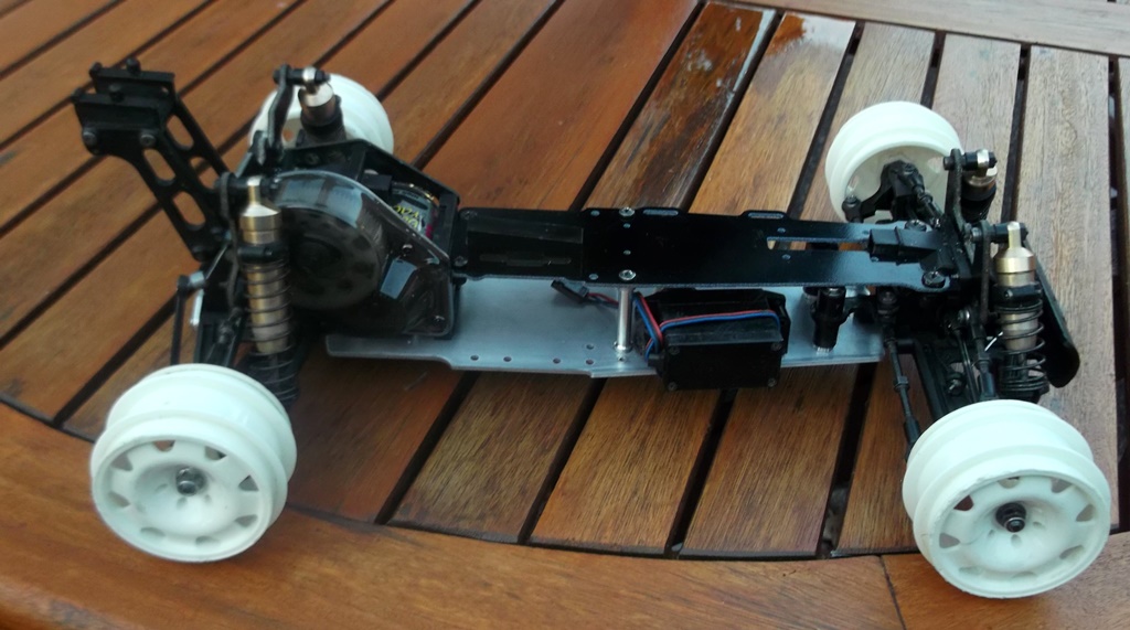

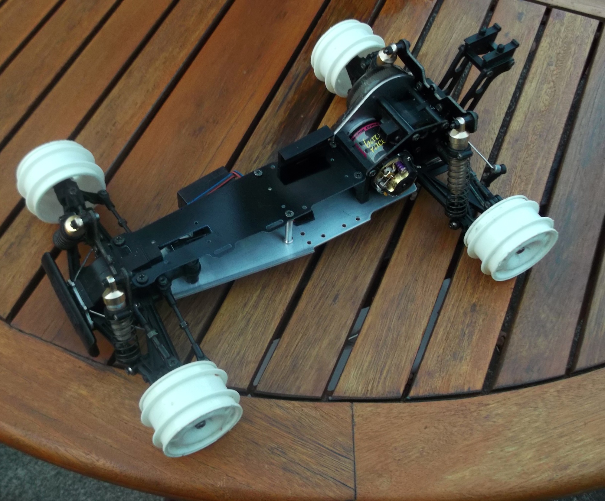

I picked up a regular Optima Mid chassis, so I could mock everything up, especially the body, before a NIP chassis I've secured arrives. Guy even traded me a set of Mid rims for some Triumph battery trays.

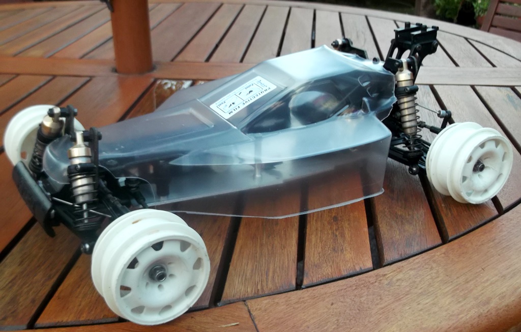

The Penguin body, spur cover, wing and undertray arrived today, along with a NIP upper chassis and it's MUCH nicer than the last few Bluegroove bodies I've used.
No thin spots, good, visible cut lines.
Sadly no dimples on the wing to guide where to drill, but no biggie.

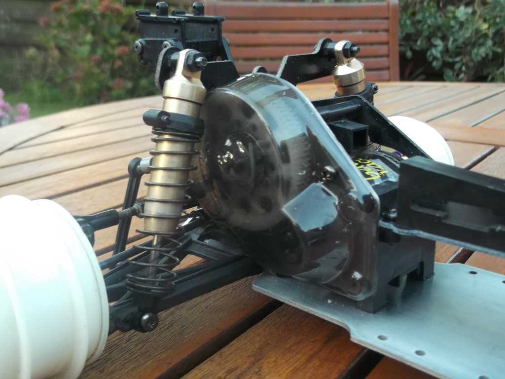

I used some Tamiya PS31 Smoke to tint the spur gear cover and I think it came out good, certainly better than a clear one.
Rebuilt the best set of Gold shocks I have with new AE 'O' rings and man are they smooth!
I've got quite a few sets of Gold shocks and I might just get them all re-anodized.
A set of Marwan's tires will be gracing this Mid.
Money's pretty tight, at the moment, so this restoration will take a month, or two, unless someone buys my RC10 Graphite.
The body needs more clean up work with sandpaper and a hobby knife, but here it is, so far, mocked up.

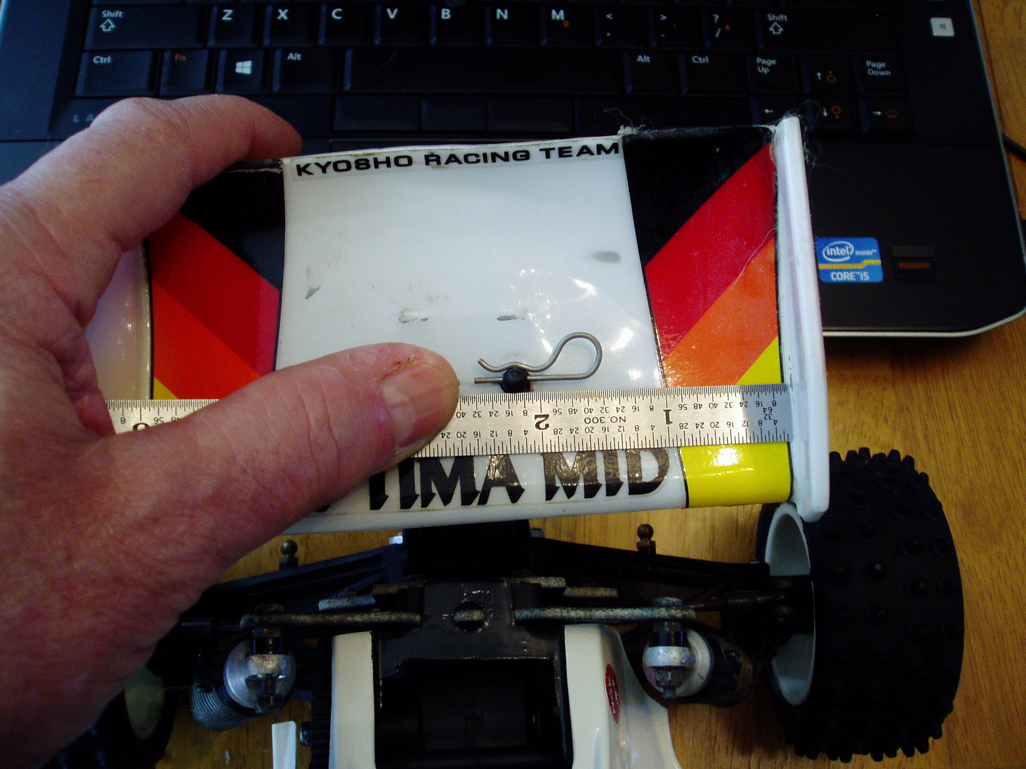

Is there anyone out there who can measure where the wing holes go on an Optima Mid?
The reproduction wing I have is really nice, but there are no dimples, or guides where to drill the holes, and I want it right.
Can anyone take a tape measure to an original Kyosho Mid wing and let me know where to drill? In mm?

We're very much hoping that you're okay after the earthquake.
99% certain this is an original wing. Holes appear to be about 27mm back.
Please chime in when you can and let us know how you are doing, okay?

Could I be a complete PITA and ask you to measure how far in the centre of each hole is from the inside of the wing sides?

Mine measures about 55.5mm.
However, if you're using a reproduction wing, yours might be a little different. What's most important is the center spacing for the wing holes. If you're using the stock wing mount, the holes should be spaced 20mm on center. So, measure the total distance between your wing sides, subtract 20mm and divide by two and that's your distance from side to center of hole. Then, as a final check, verify that the marks you've made for the holes are 20mm apart so that you'll be assured that the wing will drop onto your wing mount. The center distance is most important.

It'll take a while for all the parts I've ordered to arrive, but I set the car up on a plain Mid chassis to mock up the body, wing and a few other things.
