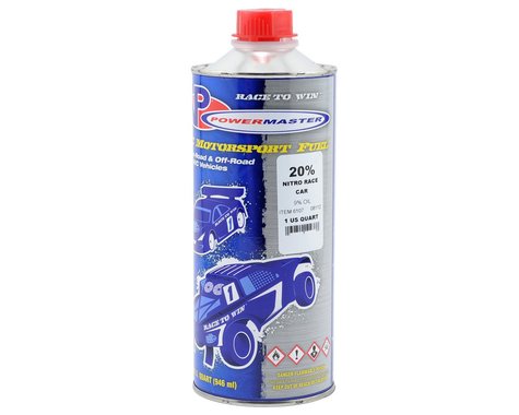

I'm soon going to be attempting stripping a couple old bodies myself. Unfortunately the bodies I'm working on cannot be replaced, so I bought a bunch of lexan sheets and am in the middle of building a vacuum table to recreate the body myself.
Anyhow, homeboy at the local hobby shop told me the only thing he's had good results numerous times stripping lexan bodies is with r/c nitro fuel. The stuff pictured below. But it's quite tedious so patience is required. Last time I was there, dude grabbed a random used body off the shelf behind the counter and a quart of that nitro fuel. Soaked a rag with some fuel and began rubbing a small section of the old paint, within a few minutes of attention on that small spot, paint was gone and the body looked quite clear. He said it usually doesn't leave much haze if any, but depends on type of paint being removed. Now you can't go full gorilla with the fuel and soak a body in it, as it will ruin the body if it takes a bath for an extended period of time. So there's no quick process with it, you have to get a handful of rags dipped in the fuel and massage your big ol' heart out. Oh, and I recommend rubber gloves. But if replacement bodies are available, I'd rather go that route.
As far as the Tamiya Paint Remover (not the Tamiya polycarbonate body cleaner), I've seen a few youtube videos of people using it.

Re: Removing paint from a body
I've tried nitro fuel too. If DOT3 brake fluid won't remove it, nitro fuel won't even touch it.
