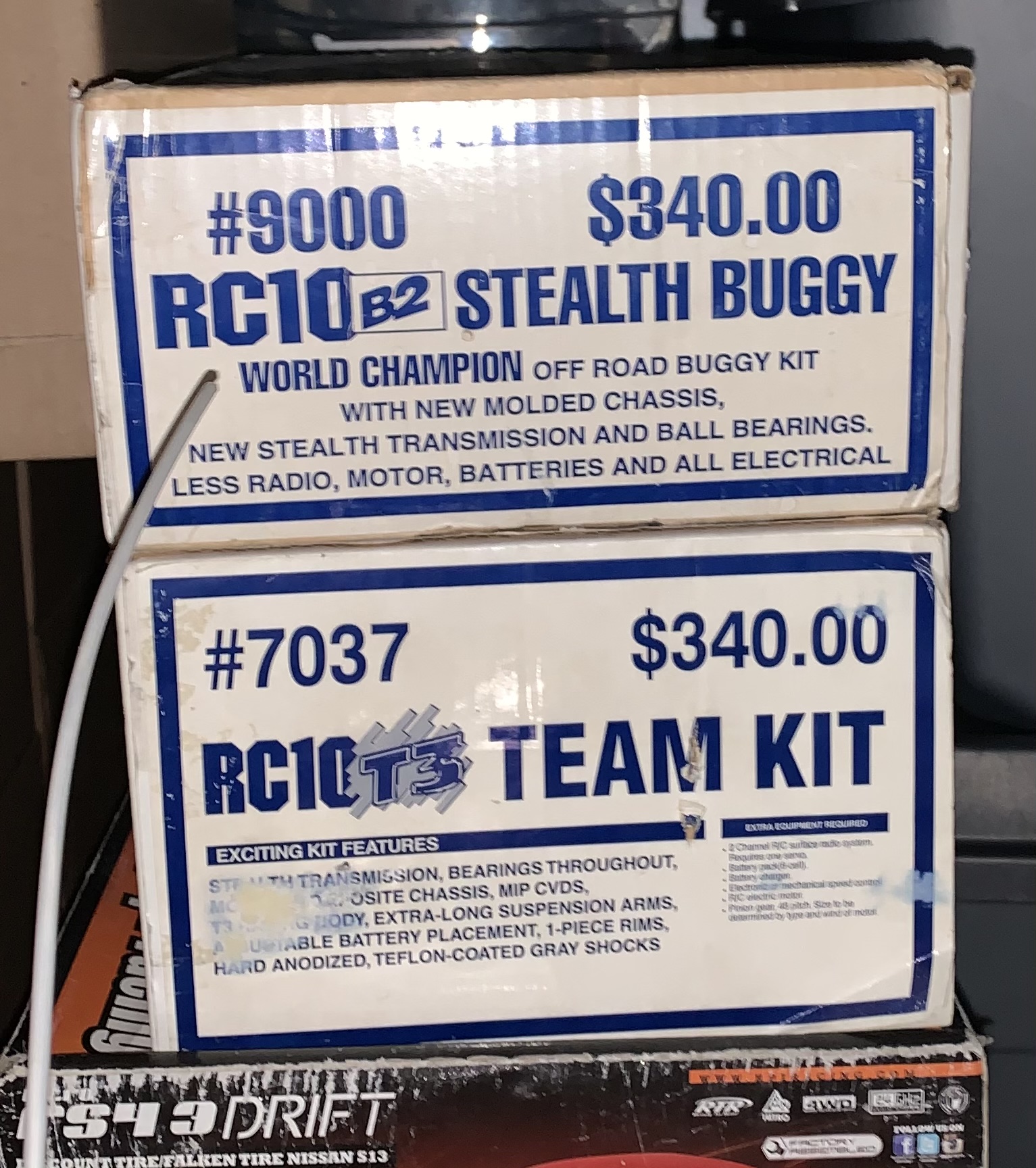

Re: Help With Rear Axles Pre B2
So is a B2 like the one I have what would be considered a Team car even though it doesn’t say it on the box like my T3 kit....
Because it doesn’t say sport. Or are there 3 versions ?
I mean yes of course I know because of what parts it comes with as well ....

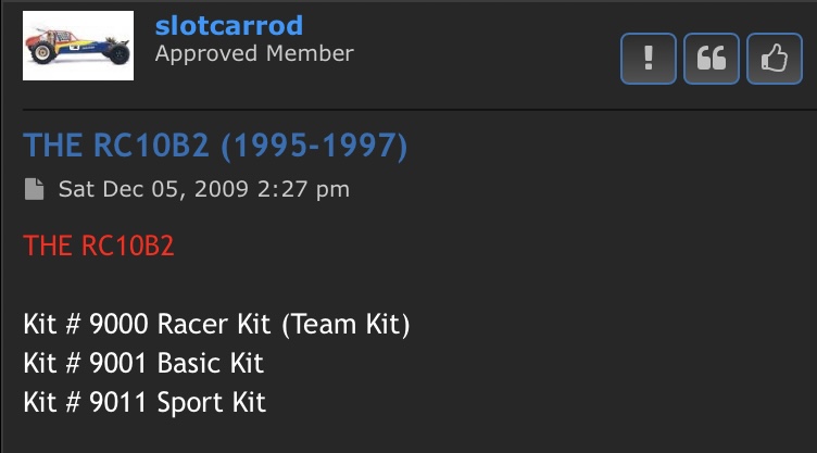

the 25 yr thread shows three kits for b2
https://www.rc10talk.com/viewtopic.php?f=35&t=13059
if you have 1/4" axles, it 'should' have been a sport kit
So then yes, even though it’s considered a Team it doesn’t actually say it on the box.
