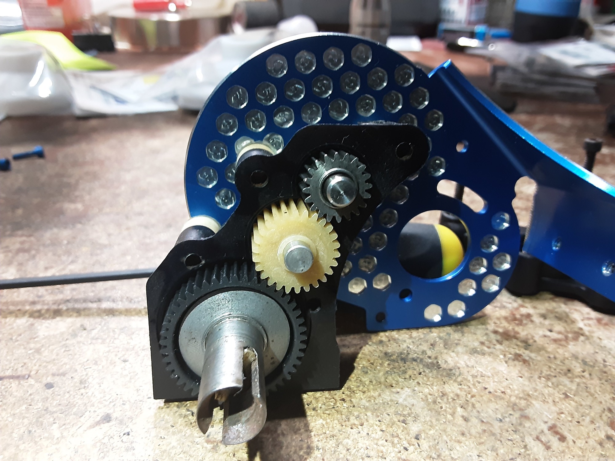

I am also a bit concerned about the idler gear as the one re-re is not compatible with my version of stealth.

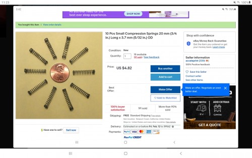

Work in my kit, though I need dogbone springs and the nylon spacers

I prefer nylon gears, as the potential for damage is less. If you run the diff too loose, it can slip and get hot. Slippage and heat have the potential to cause damage.
I've got a idle gear from Dynotech to try but haven't gotten around to it. I'll let you know.

Springs this size fit perfect. And a small o ring will work in place of the spacer.

The Dynotech #9038 "GT Idler Gear" is a perfect fit on non-Worlds Stealth transmissions.
I believe that you can also use the Words idle gear assembly (gear, axle, and bearings) in non-Worlds cases as well. You'd just have an extra set of bearings.

Thank you for the idler gear information. I may pick one up just in case I ever need it.juicedcoupe wrote: ↑Thu Apr 15, 2021 1:48 pm Quick follow up.
I'd want to experiment with the worlds gears. The stealth housing on the re-release does not properly fit the gears from the v1 stealth I have. I'll have to check exactly why, but I believe the ideler gear is the difference between the 2. I'll have to disassemble my transmission, but I think one had the bearings in the case with a fixed axle and the other had the axle fixed to the case and the bearings in the idler.

The Stealth housing on the re-re Worlds car was known to have fitment issues, even with the gears that came with it.JosephS wrote: ↑Fri Apr 16, 2021 2:44 pm

But you are correct about the idle gear. The Worlds car had the bearings in the gear, with a separate axle. Non-Worlds cars and 10T trucks had a one piece gear with bearings in the housing.

The world's re-re had the bearings in the idler gear but original worlds had the idler gear with shaft and bearings mounted in the case.juicedcoupe wrote: ↑Fri Apr 16, 2021 4:44 pm But you are correct about the idle gear. The Worlds car had the bearings in the gear, with a separate axle. Non-Worlds cars and 10T trucks had a one piece gear with bearings in the housing.
