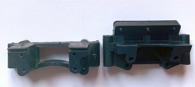

So I checked both Traxxas parts the Bandit 2530 Bulkhead compared to the 1630 Bullet / Radicator Bulkhead.
The simple solution is to cut the Bandit Bulkhead flush with the shock tower surface. Then you need to drill new mounting hoes in the chassis. Since you sait it is beat anyway, that would be the way to go.
I'll try to add a picture later. If you do not want to drill the chassis it can still be made to work, but the cutting of the bulkhead will be tricky-er.

Re: TRX-10 Bullet Kick-Up Angle
I hear you.
Here is a side by side of the 2 bulkheads:
BTW the upper shock tower holes are a direct match, so just 2 more needed at the bottom
Chewbacca - Thanks for the picture. This does make it clear that it would be as simple as cutting flush with the shock tower mounting surface. And, good to hear that the upper shock tower mounting points are the same. This may give me a relatively inexpensive solution and be stronger than my 3d printed part. Ideally I can find an original replacement but they seem to be very rare through my internet searches.
