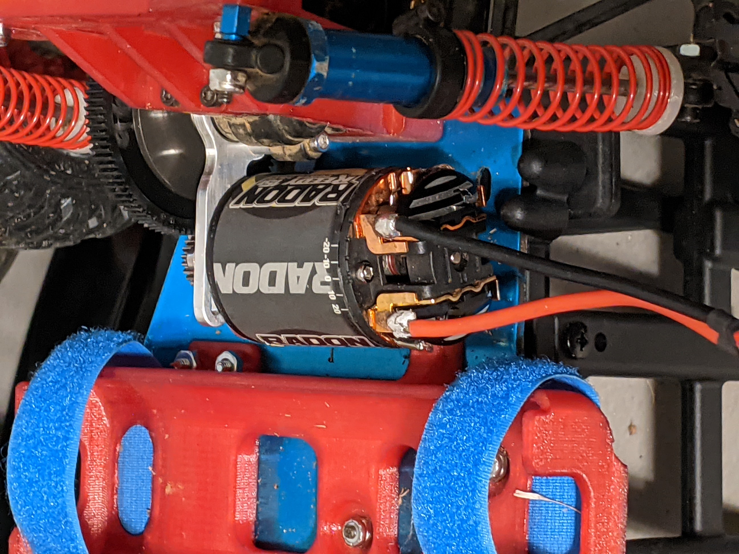

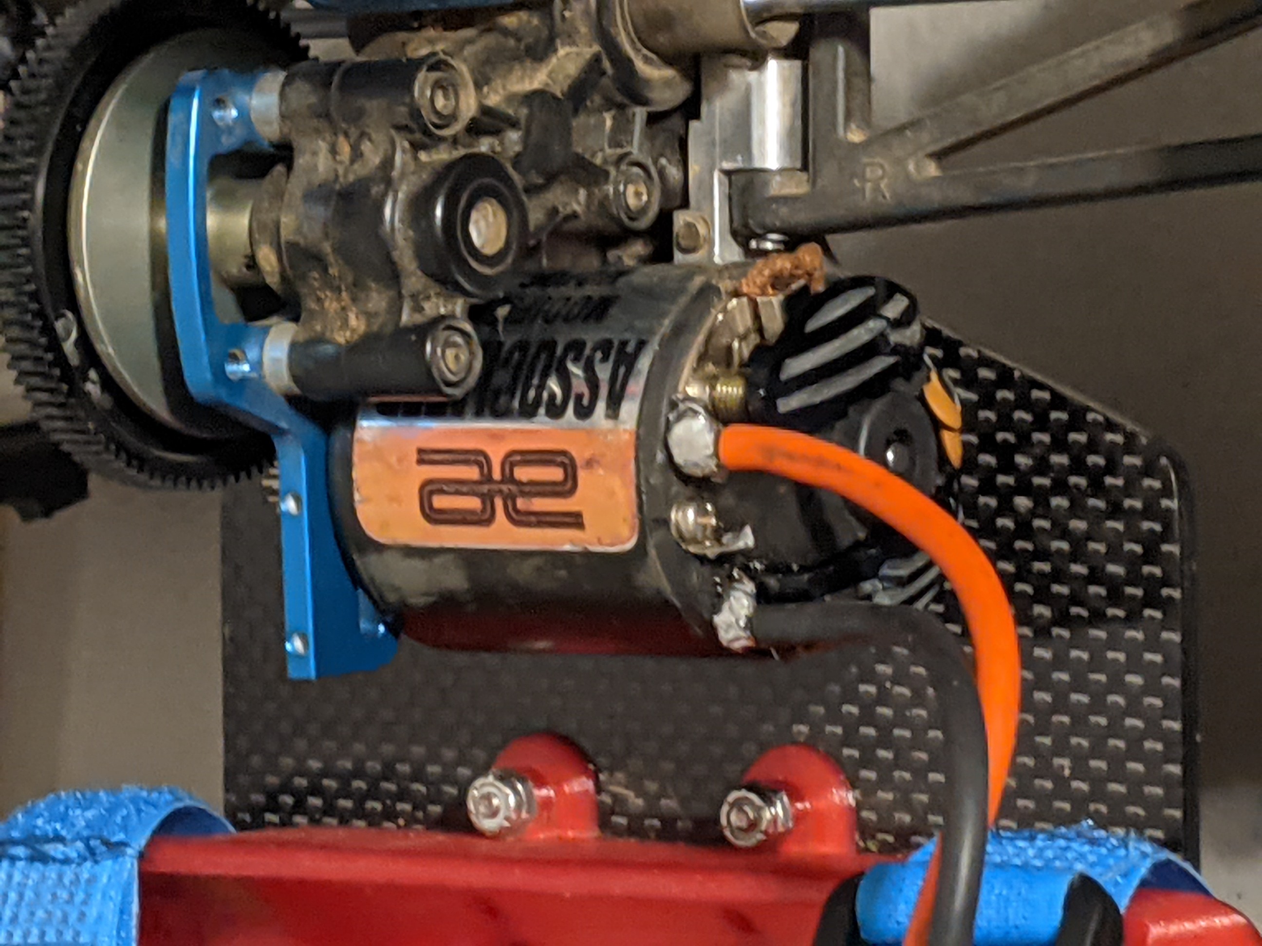

I think the Radon 2 motors are good, capable, and inexpensive motors. And amazingly they are in production. I used to pay more for stock motors than these cost. Plus, I like to run some of my vintage motors a bit just to see what they can do. I don't think I push stuff all that hard, but I like the older stuff better than the new. Maybe I'll need to find a good deal on a Rustler for a comparison (this almost like an addiction...).
I've got a few sets of endbell heatsinks I'm going to be trying, plus I think they look awesome.

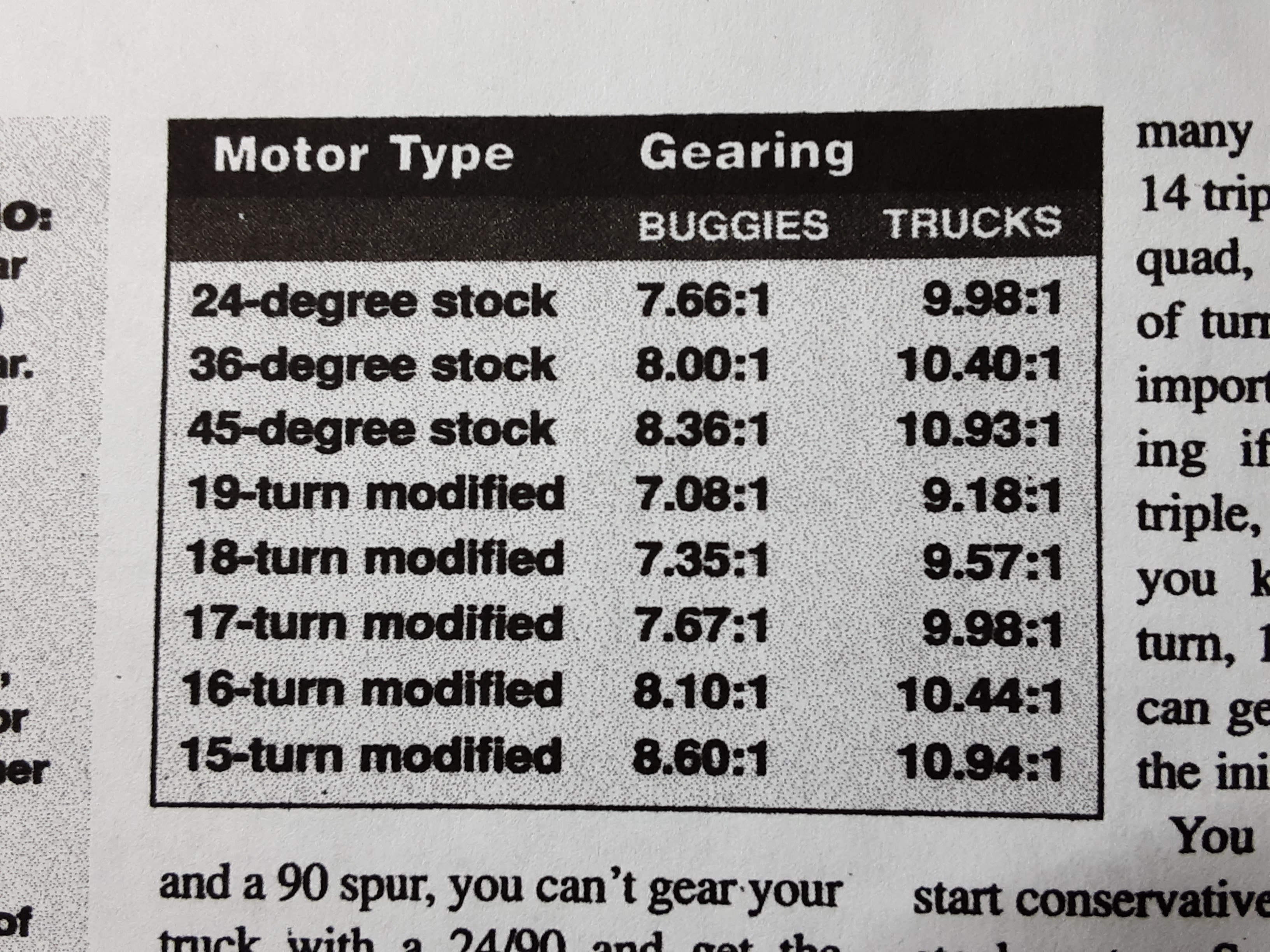

I normally use this as a starting guide for gearing brushed motors. Keep in mind that its from the 90's, so larger mah batteries and extended run times will require lower (higher numeric) gearing.

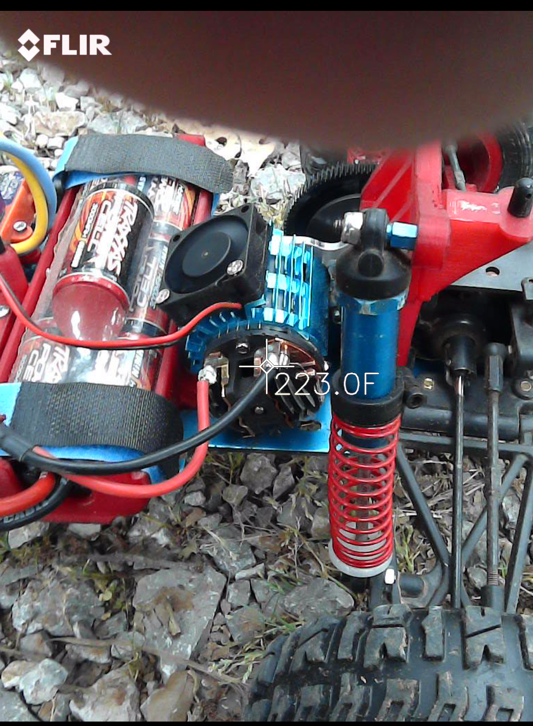

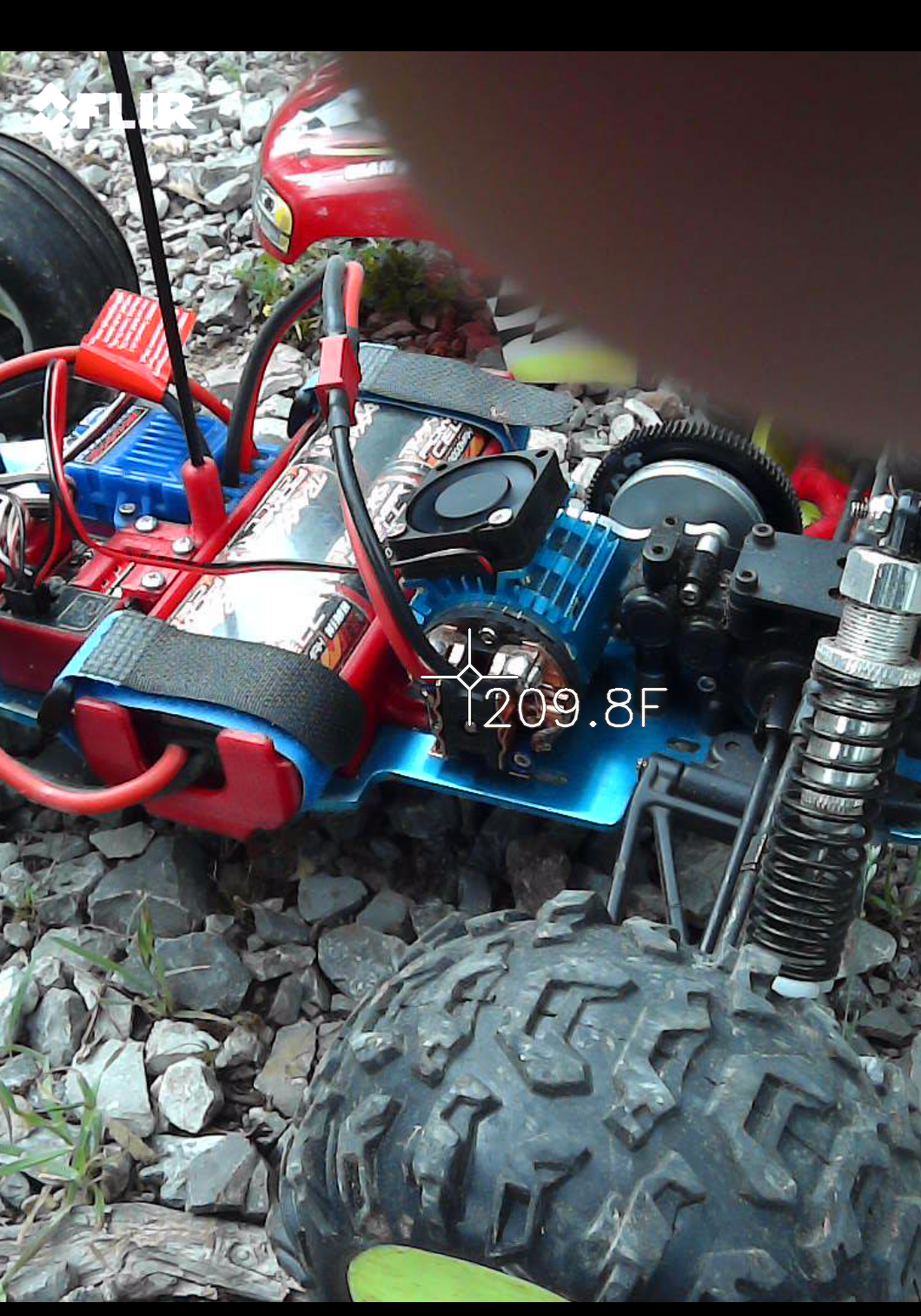

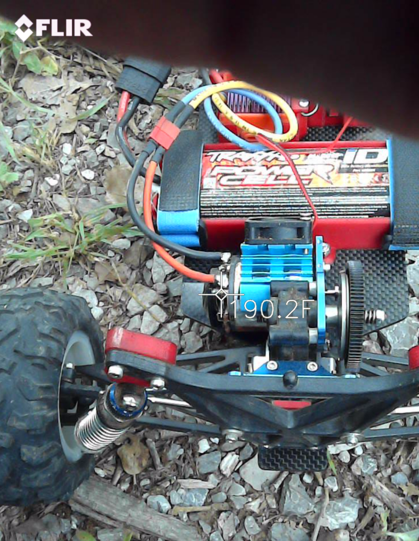

Without going through a full battery, I did a spot check of the temperatures. My son running the 7 cell was hottest at 223 F. Father in law was 209 F. Mine was 190 F. Hmm, BITD with NiCd I would bring a crew packs with me to do back to back runs. Of course I didn't think about temperatures, other than not burning my hands.
