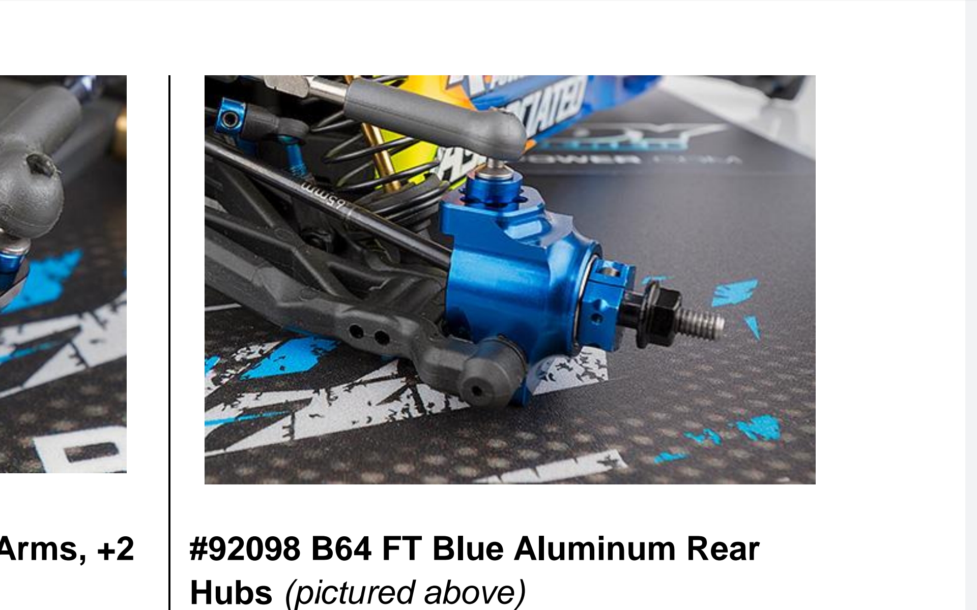

Hey there folks. I am so totally confused over the B6.4 rear aluminum hubs:
(https://www.associatedelectrics.com/factoryteam/parts/details/92099-ASC92099-b64_ft_aluminum_rear_hubs_black/)
I don’t understand why, in the package, there are two hubs that are exactly the same side. It is as if there are either 2x left or right hubs in the packaging. Now this is for my T6.1 mind you.
Now I noticed that AE said they are both “symmetrical” and maybe that has something to do with why I see the same sided hubs in the package? I almost thought AE messed up by putting in 2 hubs that face the same direction. I mean how am I supposed to connect the inserts, etc? The inserts are facing opposite ends now, tabbed end faces rear and the other would face the front. I could elaborate more if anyone reading this is confused but I sure am at the moment.
Please and thanks for any help and explanation on the matter.

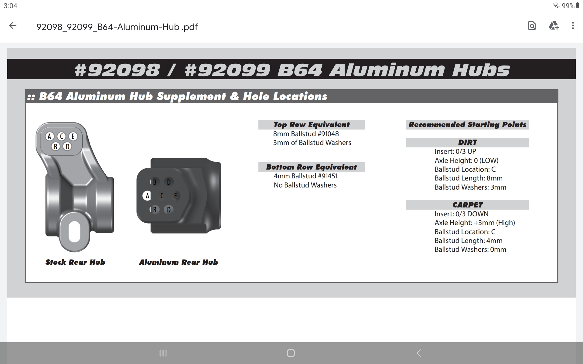

As I understand it, the bottom inserts only effect height. So right or left shouldn't matter.
From these, they look symmetrical.
