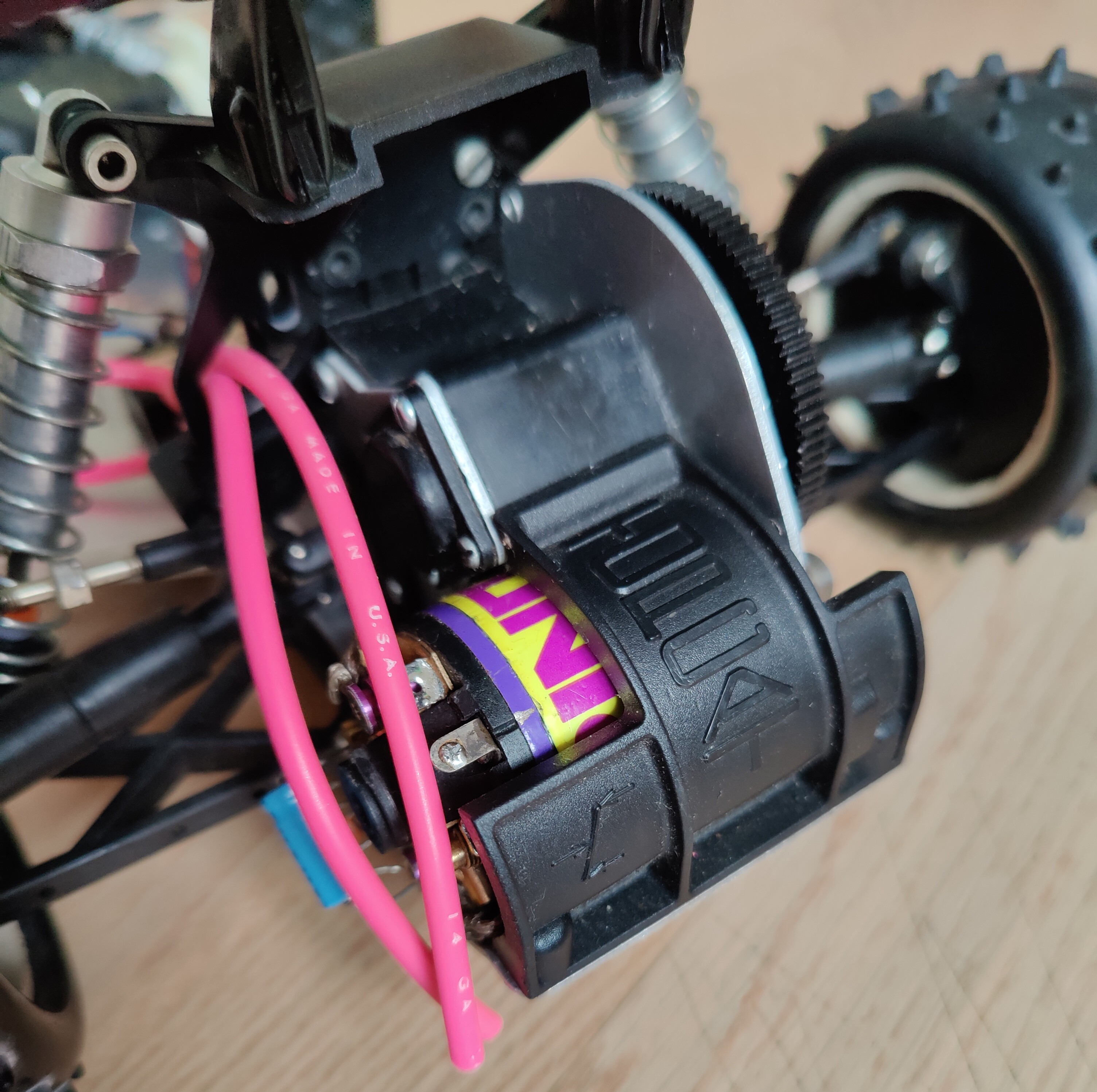

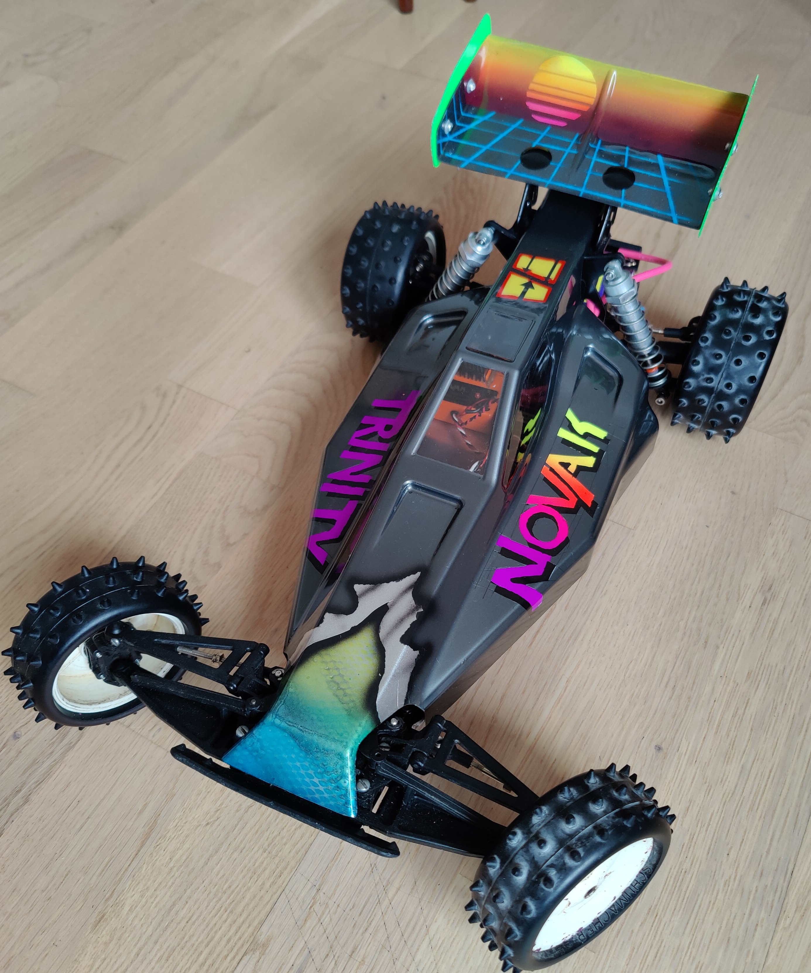

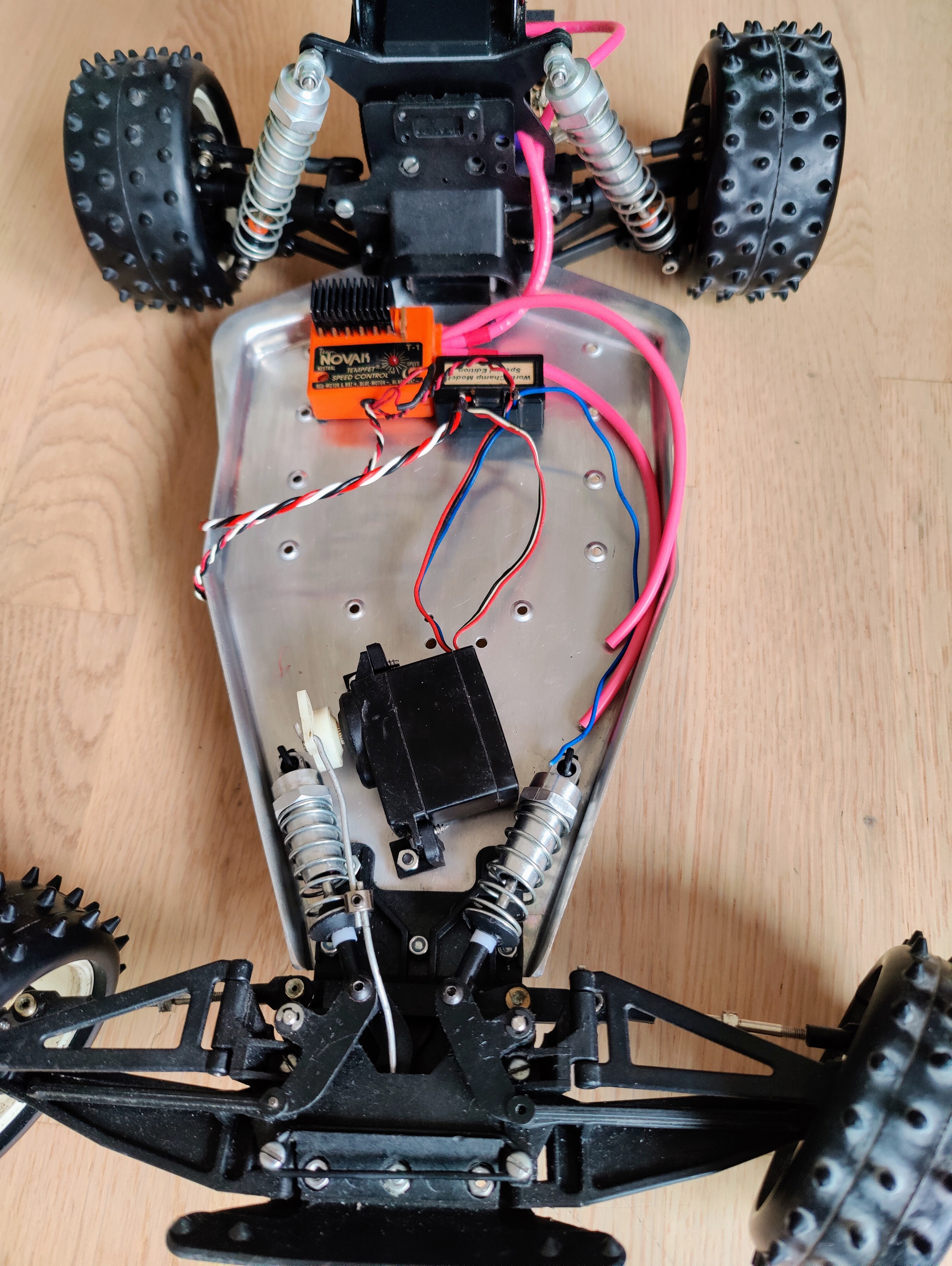

The Top cat is ready.
- ESC:. Novak T-1
- Servo: kopro ps-87 limited edition fet world champ model specialedition
- Motor Brushed: Trinity #1783 THE CLASSIC 15T Quint Modified
- Reciever: on order, 2.4ghz Sanwa
- Body: New body
- rest of the car is as on the late 80's, except for the carbon reinforcement of the rear shock tower.
Body pretty cut up, first time experience with liquid mask, not pretty up close.
- ESC:. Novak T-1
- Body: New body

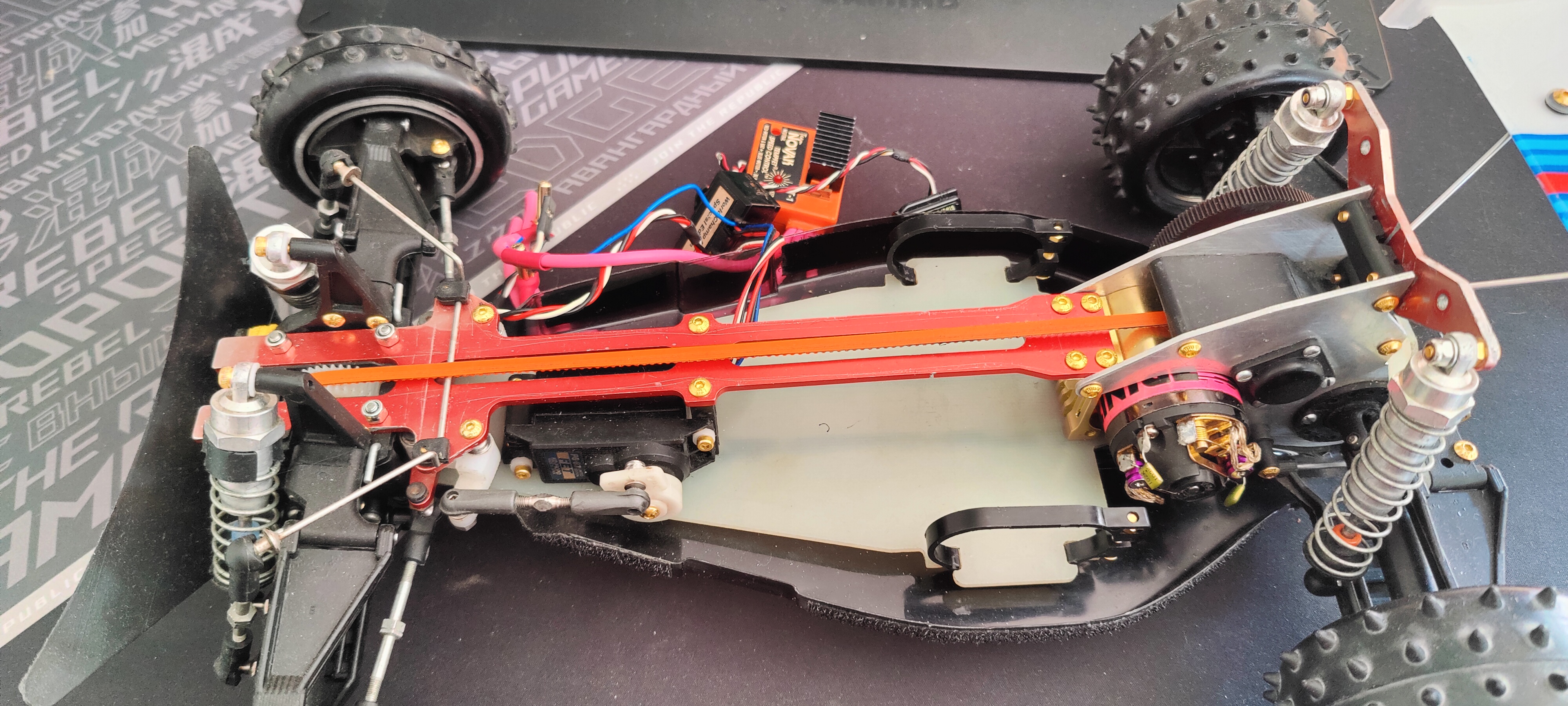

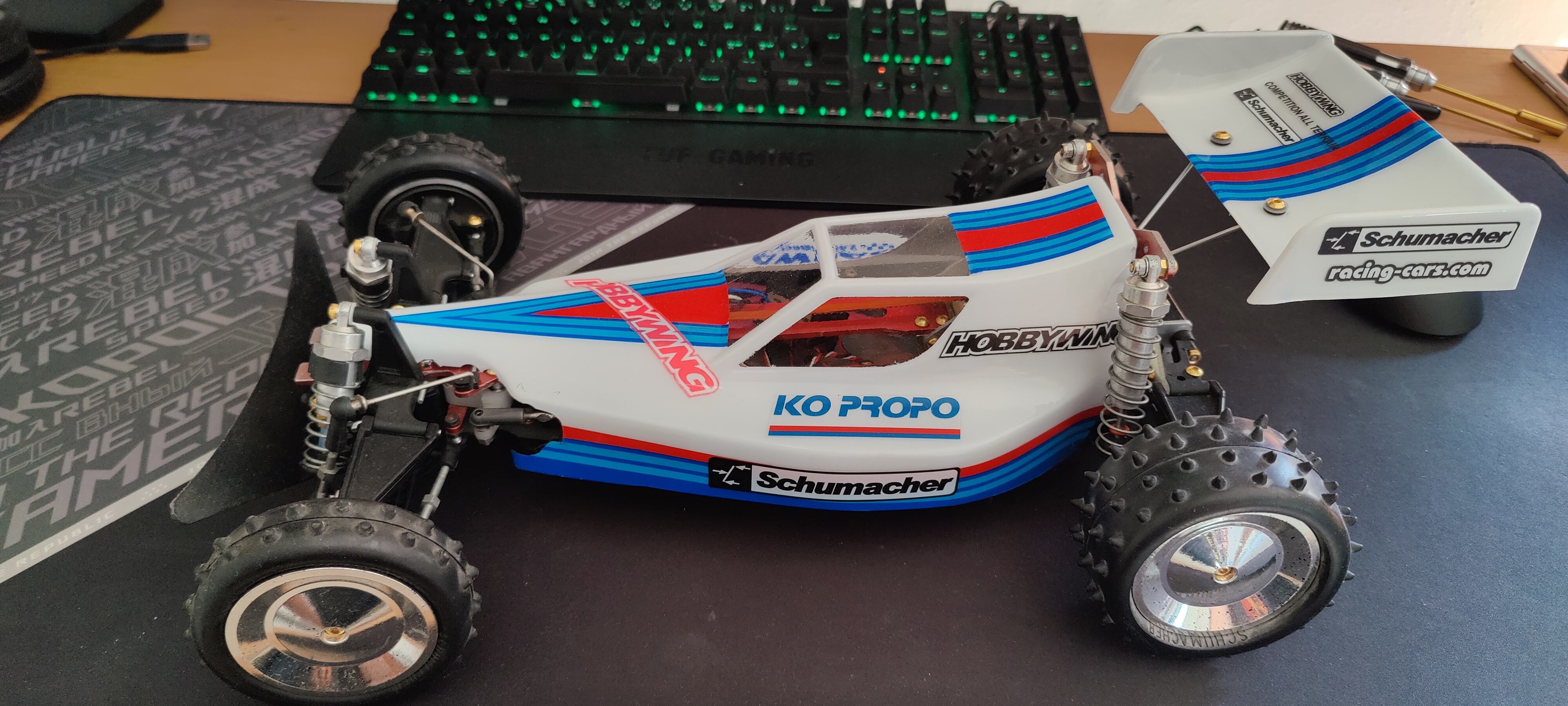

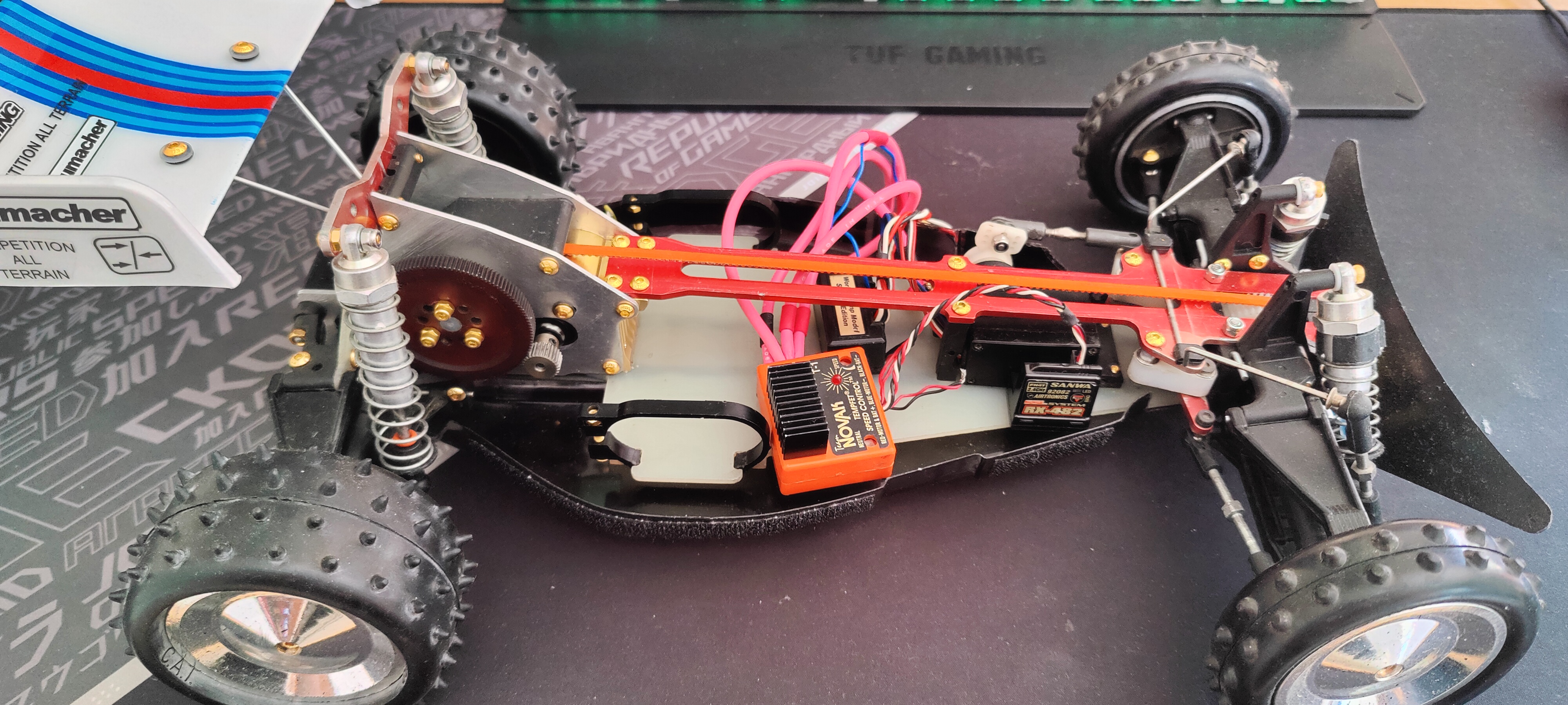

A little update, The Cat XL is race ready as i stood in 87-89, reciever however upgradet to 2.4.
MMS transmission, tuffnol Spurgear, Novak T1 esc, Ko Propo 87 world championship edition and the pink Trinity, mms ball bearing steering, the orange front belt and brown short belts (can´t remember who made them)
- Posts: 622
- Joined: Sat Apr 04, 2015 6:10 am
- Location: Auckland New Zealand
- Has thanked: 665 times
- Been thanked: 473 times
Re: original Top Cat & Cougar Mrk. 1 restoring/restomodding
Nice xls
. Belts were by wasp top plate and rear tower and steering link look to be tanaplan. Not sure on the Ali rear lower gearbox housing never seen 1 in gold before
- Posts: 1290
- Has thanked: 1782 times
- Been thanked: 859 times
Both cars are awesome. Well done that man!

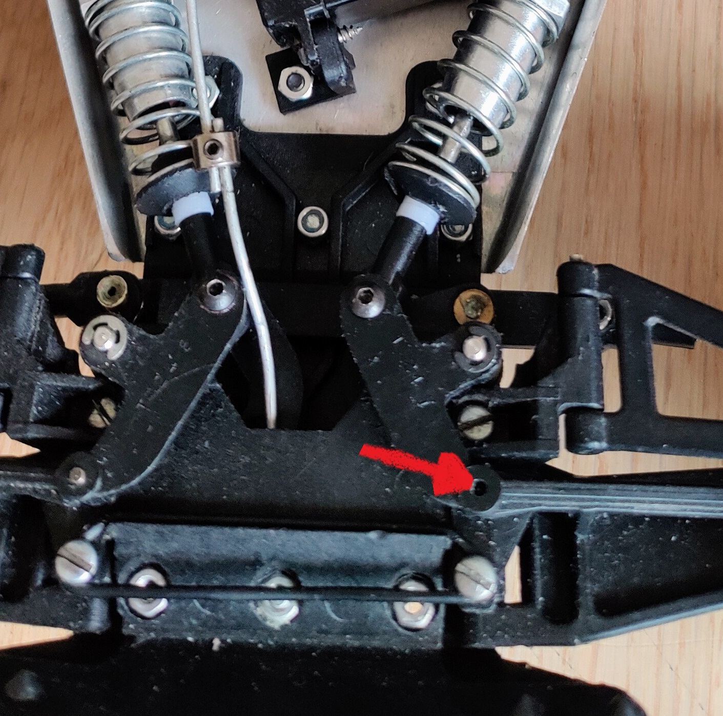

Please don't think I am nit-picking, but I noticed one of the rocker arm pins has gone missing from the TC. Or maybe it is just not centered in the arm. If it is a runner, it is worth fixing. Schumacher still sells them in this set:
