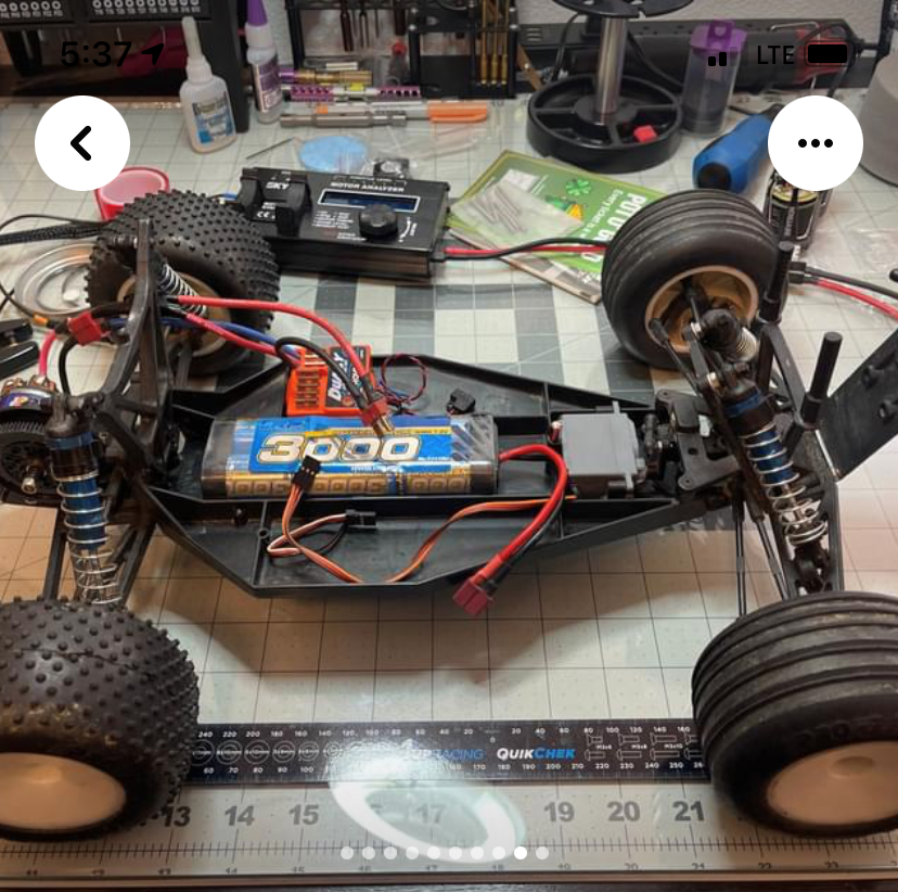

I recently picked this up from a FB post after wanting a 10T since the 90's. Plan is to go through it and get it running on modern electronics.
-Opened the trans, cleaned/re-lubed. There were two bushings in the transmission that I replaced with bearings. There was also a missing diff ball so I replaced all of those.
-Replaced the odd looking front body mount.
-New jconcepts yellow wheels with Proline Trencher tires
-Found a NOS battery bar. Need to replace the screw with pin hole in it. Not sure where the current one is from.
-Need to open the shocks/rebuild them.
I'm looking at the Hobbywing 10.5T setup that a lot of people seem to like. I have an Spektrum remote/receiver combo that I will be using for it with throttle limiter.

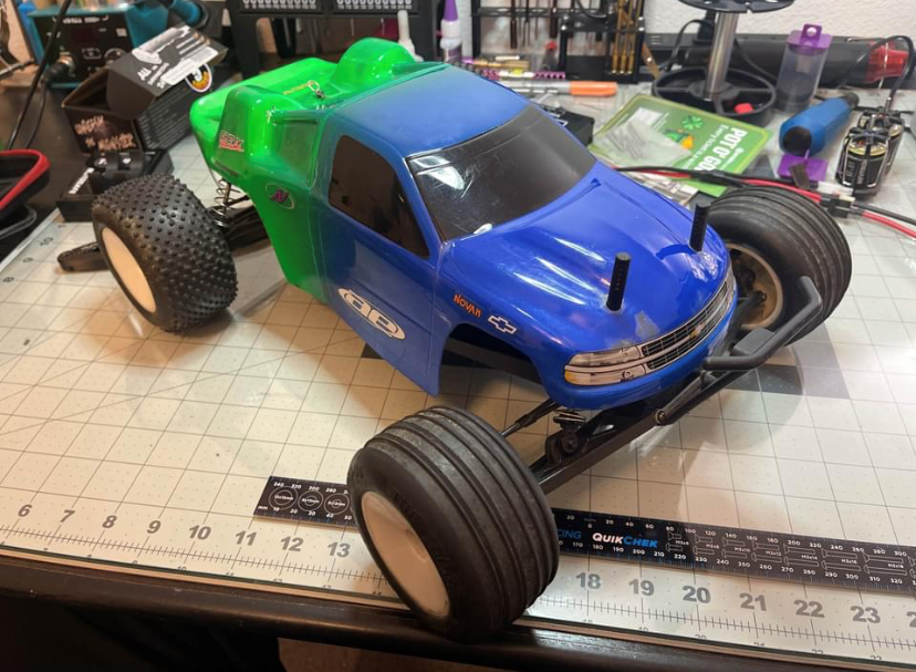

Let me know what I am missing. Anyone know what that front bumper is?
It looks like an RTR to me that someone has been tinkering with. Had been upgraded from bushings to bearings. So far I have:-Opened the trans, cleaned/re-lubed. There were two bushings in the transmission that I replaced with bearings. There was also a missing diff ball so I replaced all of those.

It's been a fun project. Got it all cleaned up and running and have been having a lot of fun with it. I ended up going with a Hobbywing QuicRun QR10BL120 ESC and a Justock 10.5T.

front bumper looks rpm sc10t-ish...or traxxas rpm slash. picture really isn't good enough for me to see it straight on so its guessing.
