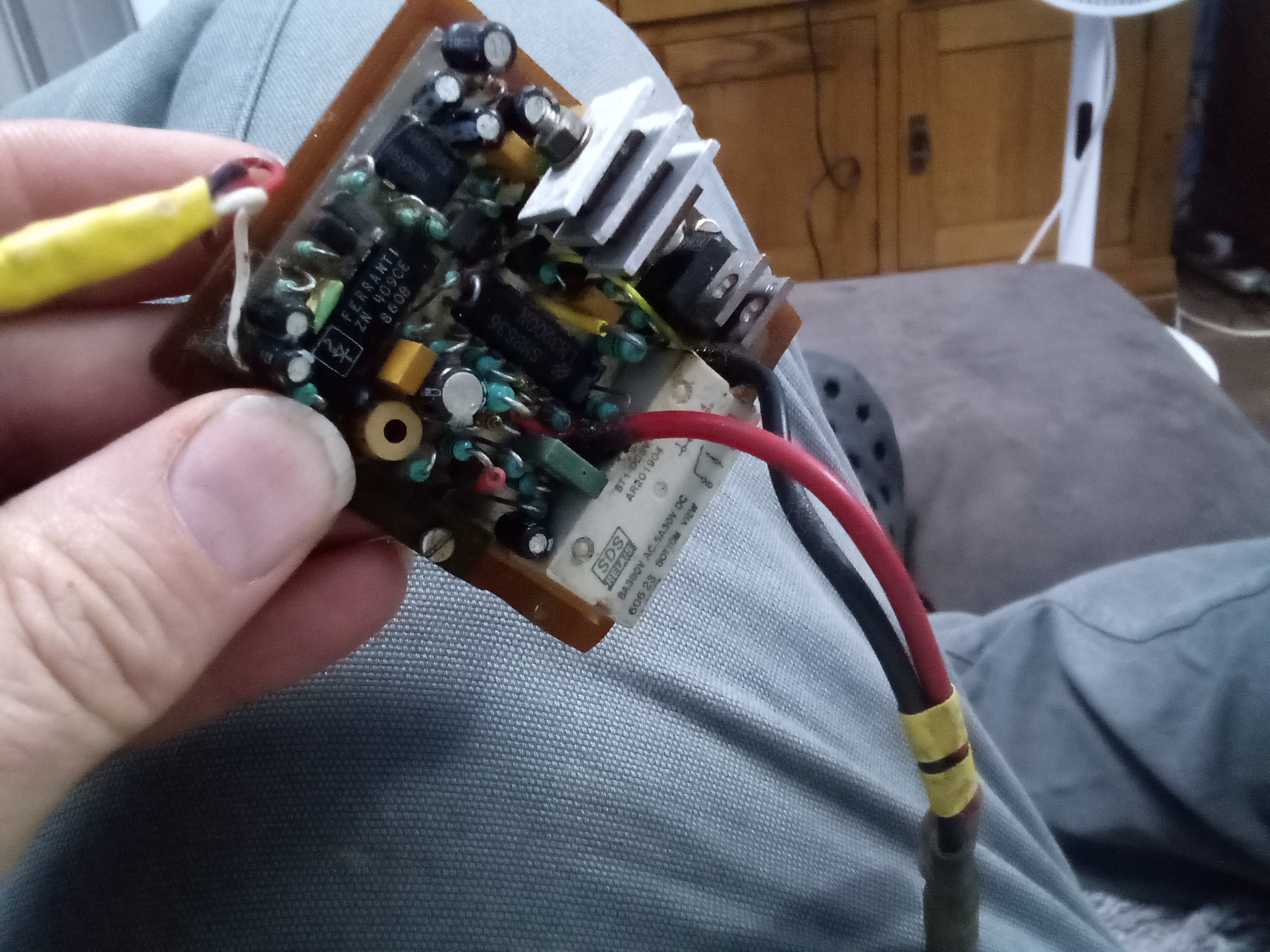

This is an interesting one, and I have been looking for one of these for quite some time... even without knowing what they actually looked like.
About a month a good friend of mine was looking to buy an Optima, and in the background of one of the eBay pictures I spotted a mystery ESC, looking very much like one of the 'heatshrink era' British offerings of the time. I offered a little advice to the guy considering the purchase and casually mentioned my interest in that ESC when it arrived. He said i was most welcome to it as he had no interest in old electronics. Cool freebie. 8)
BINGO!
This was all i had to go on in the auction pictures:-

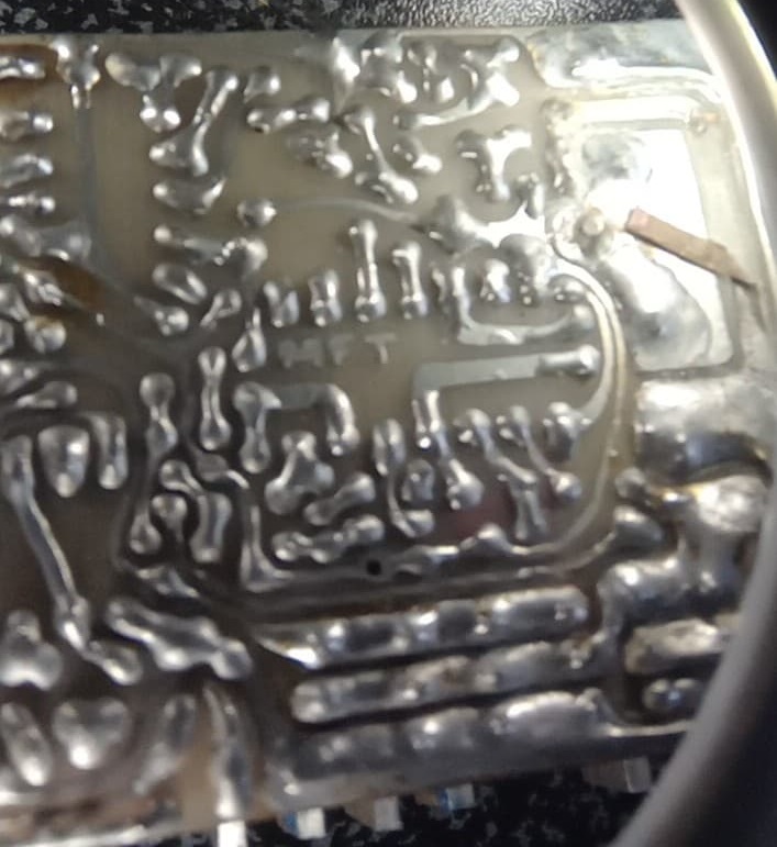

When it arrived there on the back of the PCB was the answer i was hoping to see.... the letters MFT.

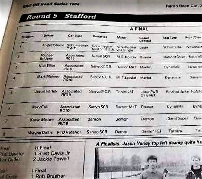

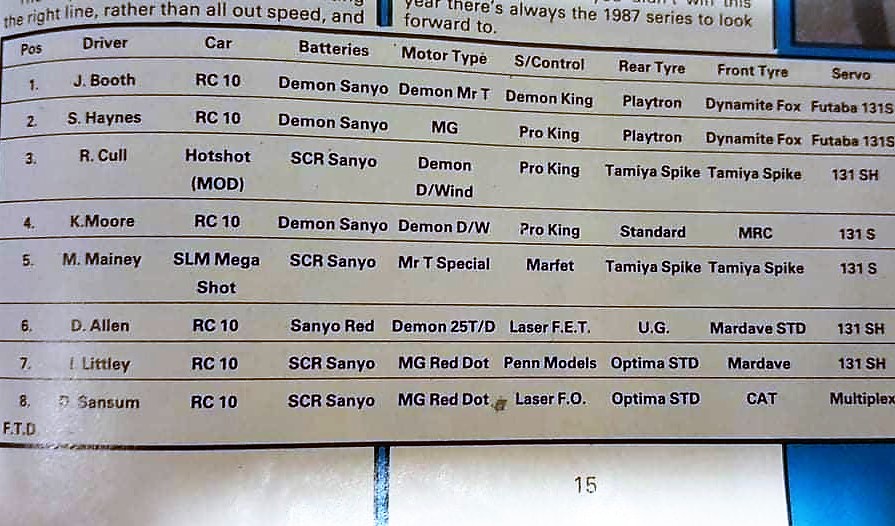

I immediately sent some photographs to Nick Marson of Nosram fame, who having had a good look over the pictures sent me one back of the same speedo he still had in his collection, confirming it as one of his. I had seen the name Marfet in some magazine tech sheets from the 1986 Radio Race Car Series so knew they were top-notch for the period, and had always wondered what they were.

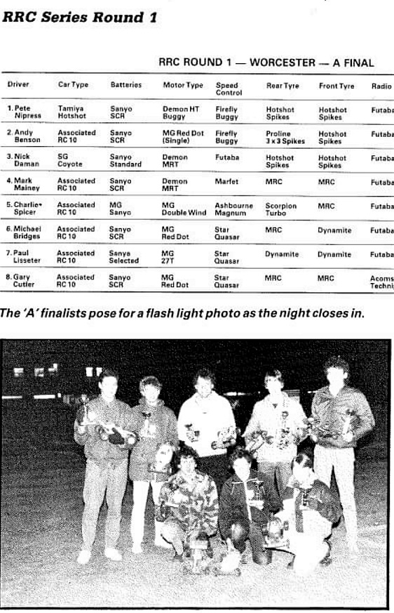

Nick got back to me and gave me plenty of details about this unit. He built 6 of them as a hobby in 1985 when he was a competitive racer himself; one for himself, which he still has, and a handful for a few other local racers. One of those was Mark Mainey whom you will notice using the Marfet in the above tech sheets. I spoke to him and this is what he said:-
'Previous to that I was using a Lazer speedo with a great big relay on it which kept blowing. Nick turned up at the Gloucester track on Friday night and said to try this, a Marfet, in my car. Well the difference was amazing. Felt like I had put a modified motor in. That weekend I raced at GEC in Stafford and for the first time managed to keep up with the big boys, even though I never had the matched cells or works motors they were using.'
I can see then why he stuck with it for the 1986 season.

Nick said that he was looking out for the flux having been removed on mine, and the MFT lettering, so that suggested this one was one of the ones he made before selling the design. He also sent me a shot of the side of his PCB which showed the exact same component layout as mine.

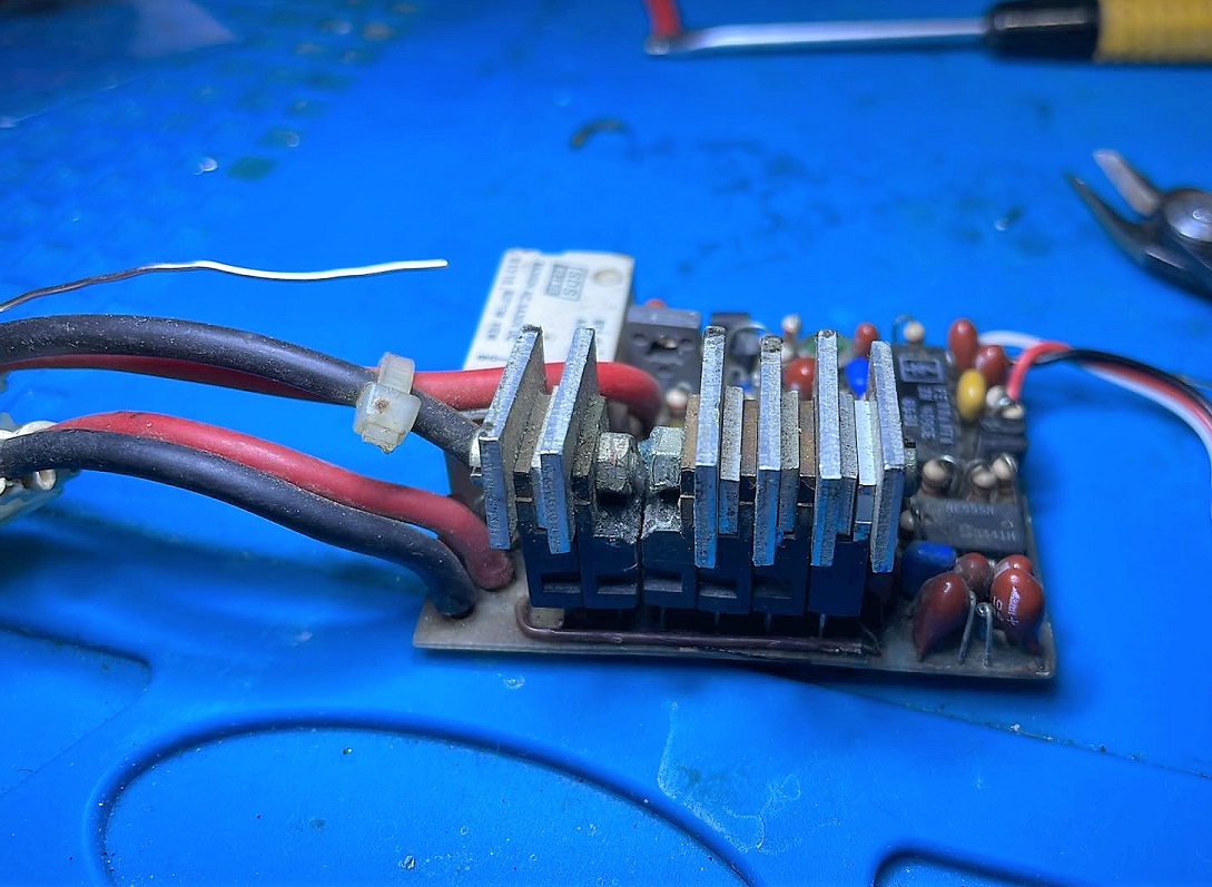

I sent mine off to electronics whizz Ian Mullaney in the UK who tested it and confirmed the reason why it was piled in a heap of spares in the sale; a blown FET. He replaced that and rewired it and it is now all up and running again. All it needs is fresh heatshrink and popping into a suitable car.

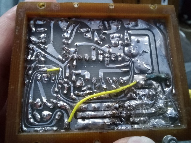

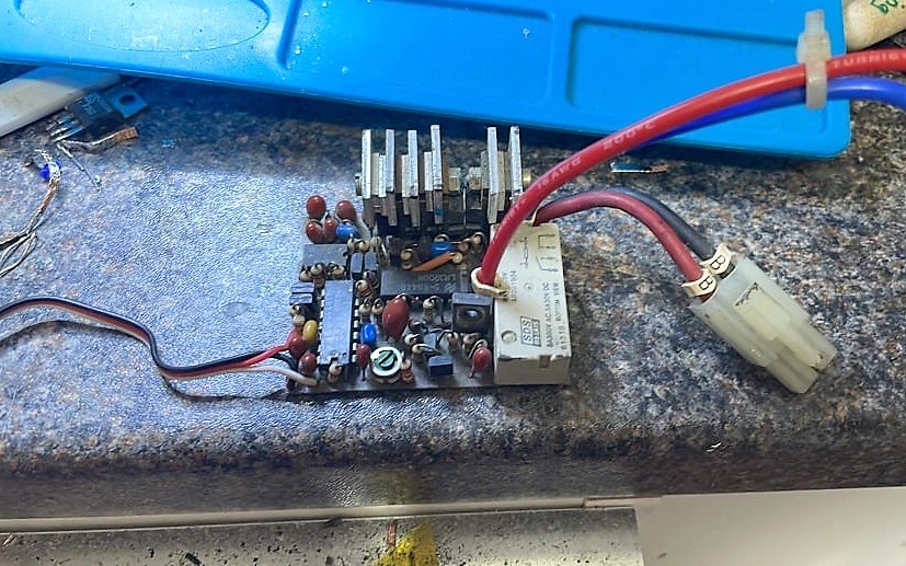

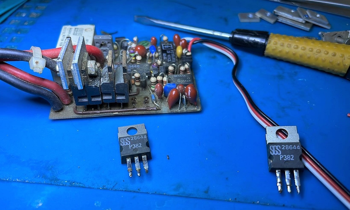

Thought that looked familiar , there's just a smudge where you have MFT but the circuit design is the same , we already talked about this one , it came with the PB Mini Mustang I have .
I've removed a burnt out FET and two of the heat sink plates were removed to do it but it looks right to me .

It's kind of a mica frame , think it was used as a means of mounting it , if this was a kit then the builder could solder pretty well . Looks messy where I removed the smoked fet , it's been sealed with resin underneath .

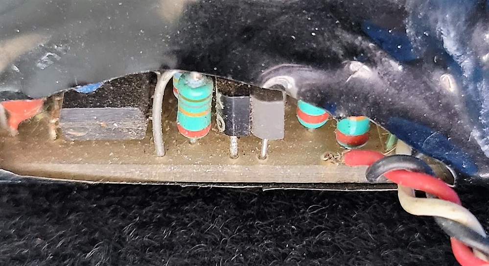

I just sent the pictures to Nick.... he replied straight away:-
'Wow, of course people were free to do what ever they wanted to... Also to cheapen it regular electrolytic caps have been used rather than tantalum.'
I guess he can see some differences in the components used compared to his.

I don't suppose you have a circuit diagram ? After replacing all the FETs it's still dead but now the relay clicks and the break FETs warm up , I found a short across the main drive FETs and assumed one of the new ones was a dud so removed them again only to find the short is on the board still . The original owner applied a waterproofing resin to both sides of the board and I can't remove it without removing the part numbers of the smaller transistors so a circuit diagram would be a good send .
