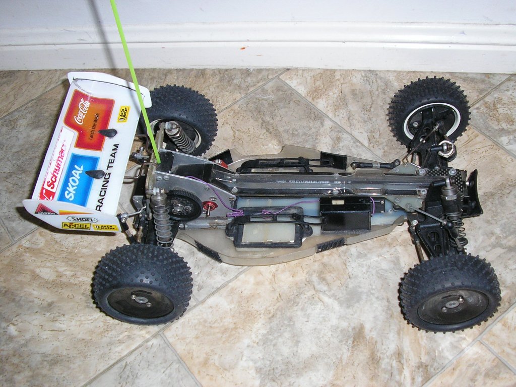

Hey guys, I thought I'd throw up some pics of my modded Shumacher Cat XLS runner. I've had this car for many years now and it has proven to be a great fun super aggressive car to run. These things corner like nothing else, even making a XX4 look slow through the twisties. :wink:
I'm planning to take it out and race it again this year. I'll probably just run rebuildable stock as I don't have a slipper clutch or a decent brushless setup as yet. That said it holds up fine to a SS5800, though it is hard to stuff it under the bodyshell.
Oh yea, I'll either run my Novak T-1 or Tekin 411P in it with the stock motor. :)
The car features:
Model Motorsport rear drum diff and layshaft.
Slotted rear belt eccentrics for infinite belt adjustment.
Procat front gear box housing with custom carbon tensioner bracket.
Procat rear suspension setup.
Carbon fibre rear camber plate, and some rear swaybar I can't remember the source of.
Carbon fibre steering rack, and front top deck brace.
Cougar saddle pack holders and straps.
Yokomo rim adaptors.
Trinity 2.2" rims which have just been given a quick coat of paint to tidy them up a bit.
All new proline tyres ready for racing.
I did have the proper narrow saddle pack chassis, but for some stupid reason I cut it up trying to fit it to a TA01 about 10 years ago. I've still got the parts and may try resurrecting it like I saw scr8p did in one of his posts with a graphite chassis. Nice work dude.
Doug.

Nice car!!!, just a note, the front one way drive shafts are on wrong! the larger part of the unit should be at the base of the transmission, not at the wheel hubs, hope it helps
Scott

Scott, yes but there is a method to my madness. :P I always ran the one-ways on the outside to make it easier to switch between part time and full time 4WD depending on conditions. Much quicker to just substitute the outer part of the driveshaft, rather than having to remove the crashback front end to get to them. :)

I ran my drive shafts like this - The fat part of the one ways used to rub on the front shocks if I built my procat with them fixed to the diff.
It didn't make any difference to the car's handling although I guess it theoretically increases the unsprung weight.
