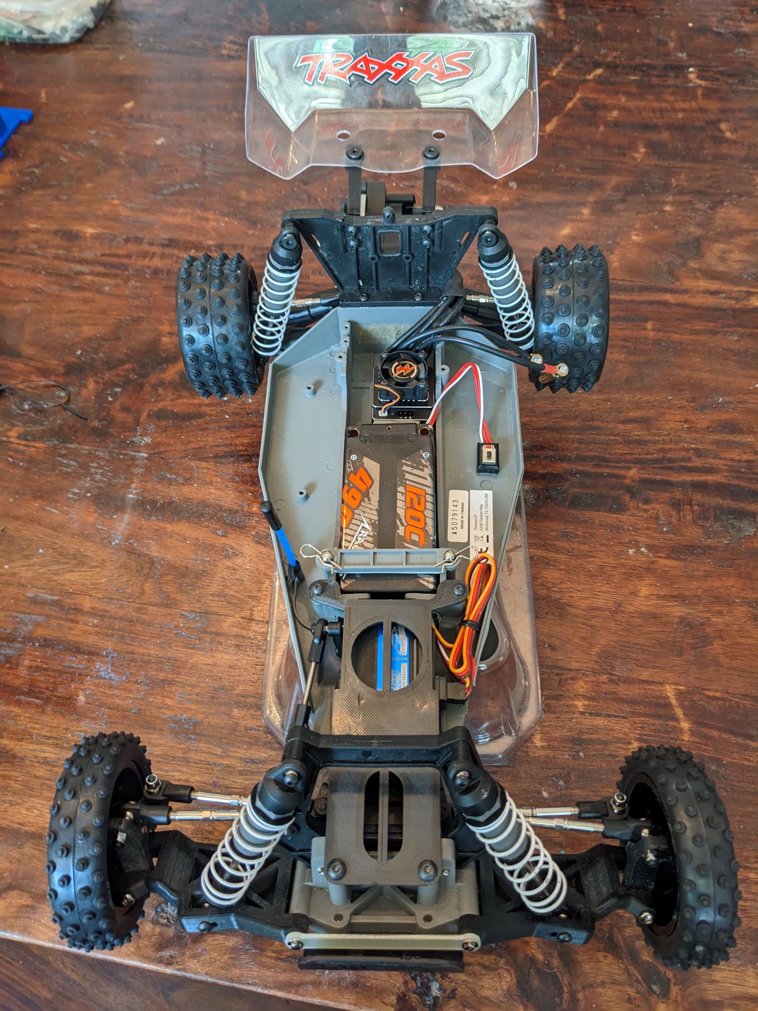

A while ago I picked up my son a Traxxas Slash kit for his birthday to introduce him to a proper hobby build. The build made me reminisce of the Traxxas Hawk 2 and Traxxas TRX-3 I had back in the day, before I stepped away from the hobby years ago.

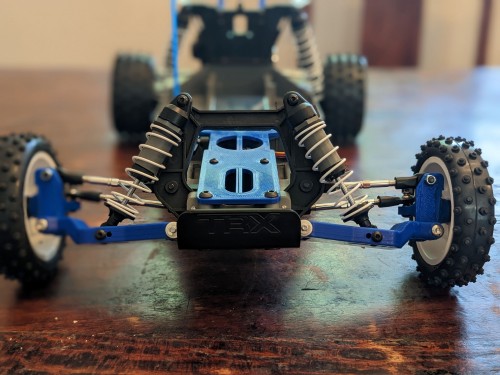

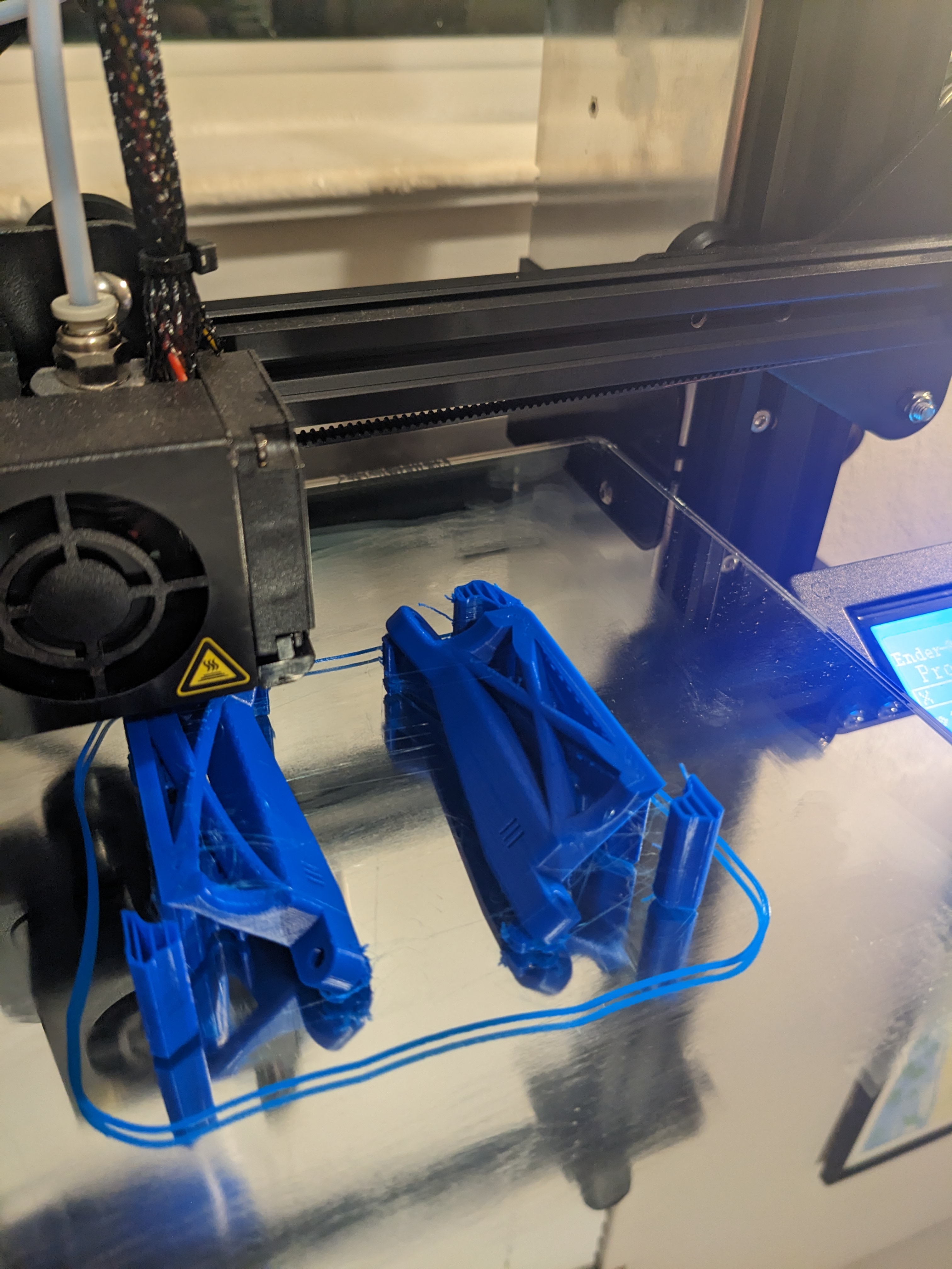

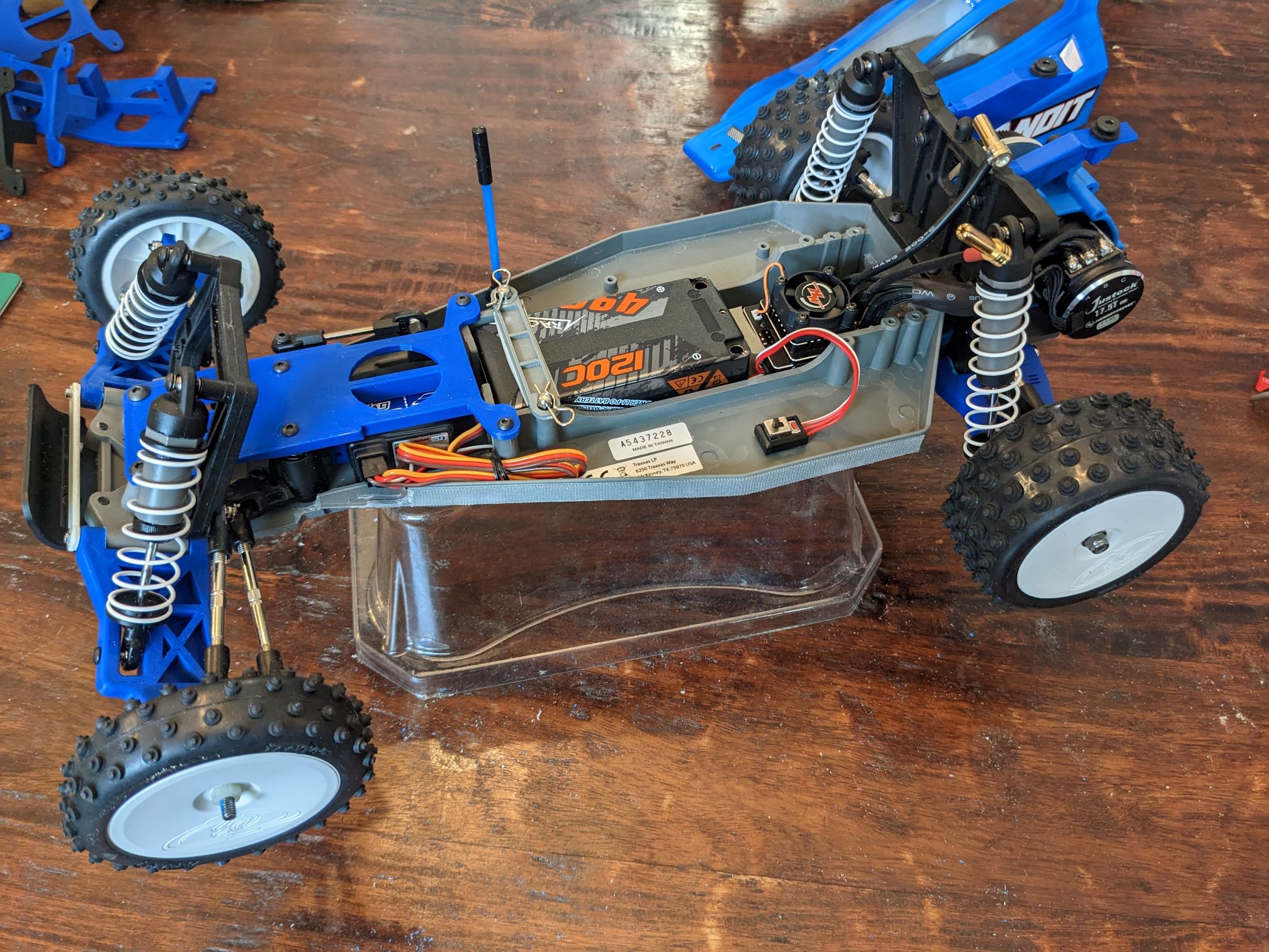

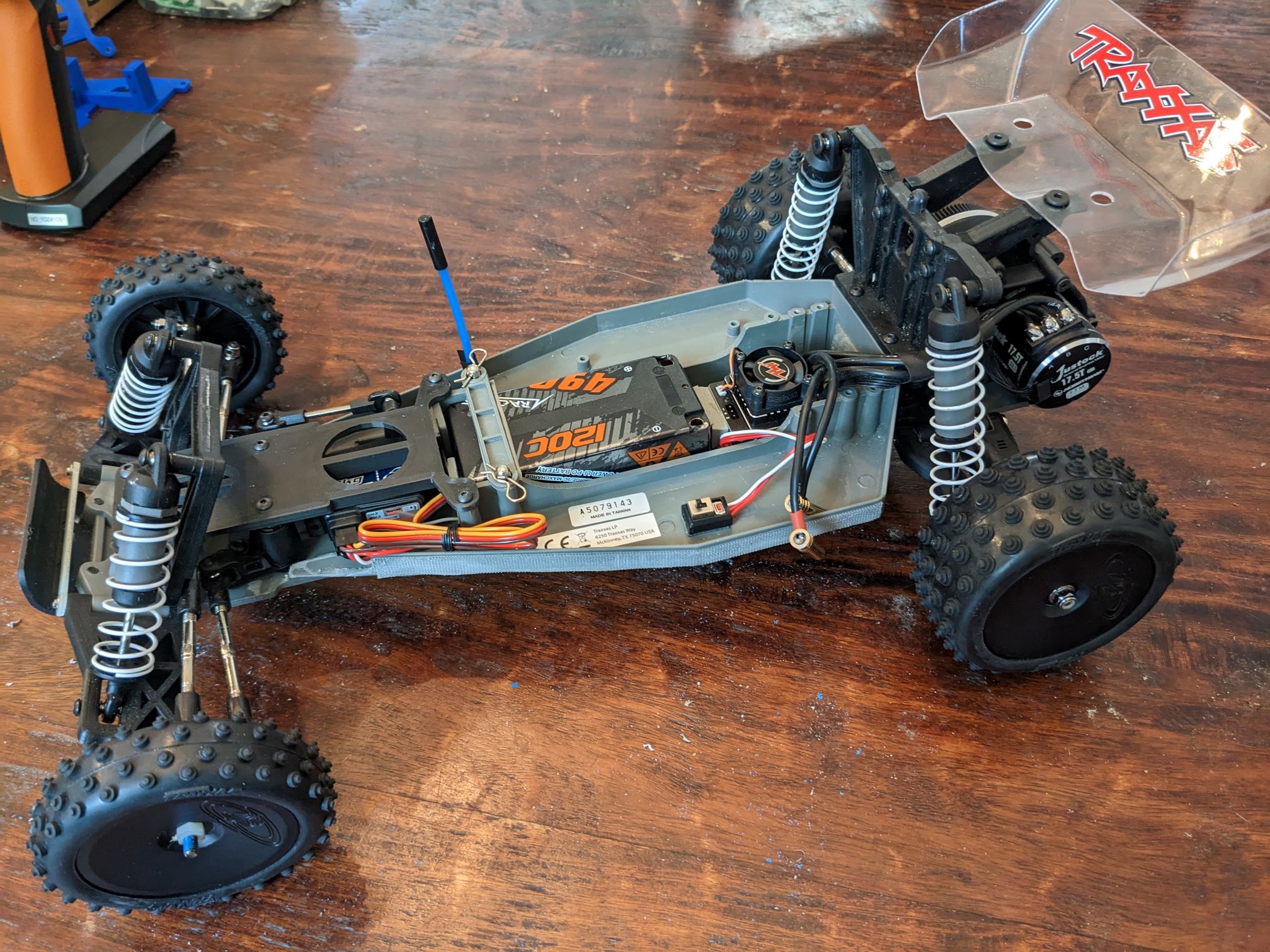

Not having a car of my own, I picked up two Traxxas rollers off eBay for us to complete and run together. Not willing to leave good enough alone and always a sucker for a project to tinker with, I went down the rabbit hole of the freely available 3D printing parts for the Traxxas 2wd platform. The result are two Bandit buggies modified with a slew of 3d printed parts with the intention of modernizing the aging platform.
Some of the upgraded parts:
Traxxas Bandit 7mm front drop arm https://www.thingiverse.com/thing:4934502
Traxxas Rustler/Stampede/Bandit/Slash 25 degree Caster Blocks https://www.thingiverse.com/thing:4585006
Traxxas Slash 2WD Modified 3736 Front Steering Blocks (L & R) https://www.thingiverse.com/thing:2392471
Traxxas Bandit 7mm rear drop arm https://www.thingiverse.com/thing:4934499
Team Associated Rear Wing Mounts B6 B6D https://www.thingiverse.com/thing:4081364

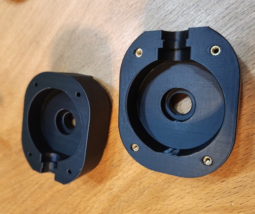

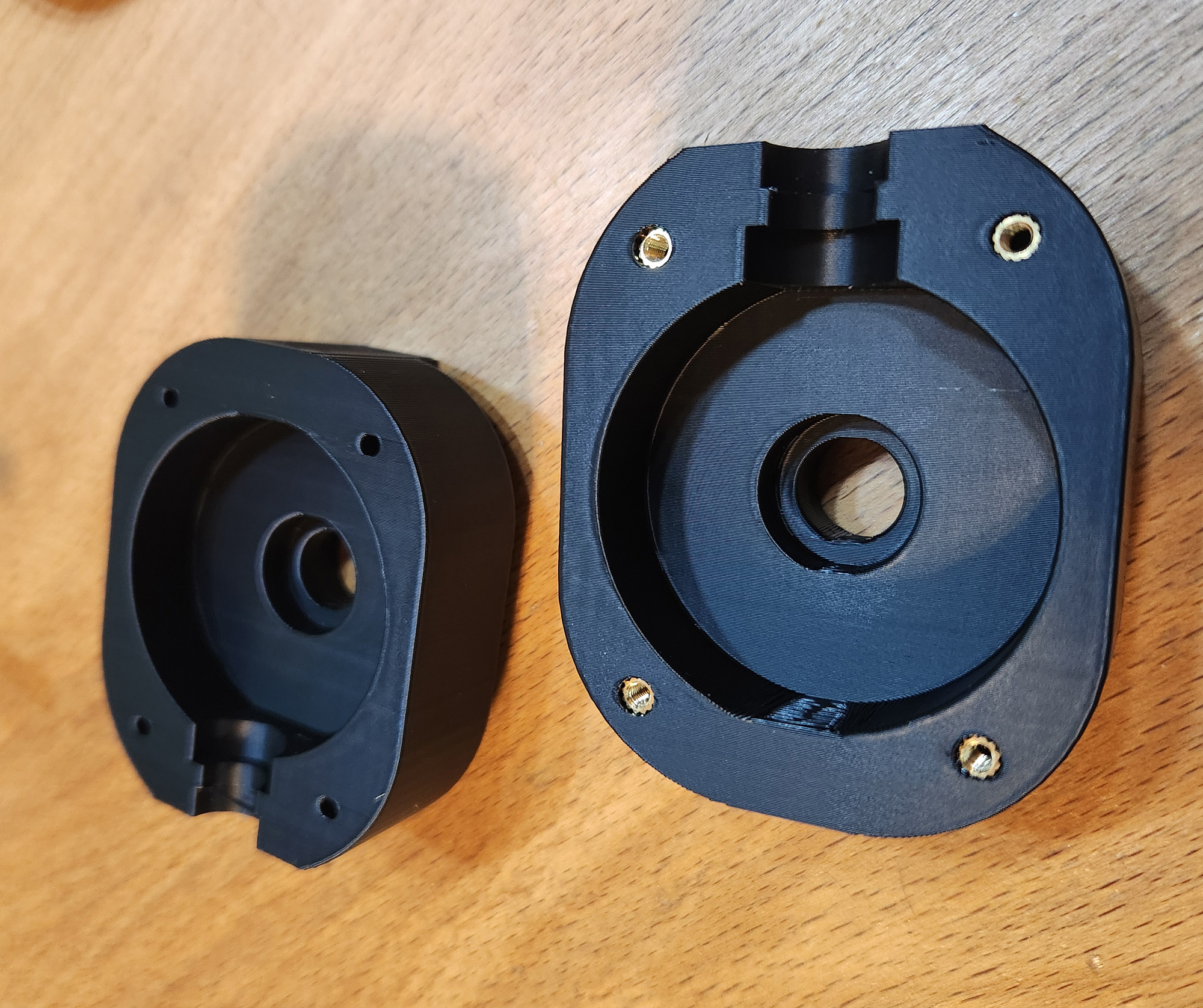

Bandit Rustler Nose Brace Servo Mount (design of my own) https://www.thingiverse.com/thing:6025831
I can’t claim any significant performance advantage because we never ran the cars in stock form and we have not had a chance to put the cars through their paces. I wanted to share for anyone who may find it interesting.

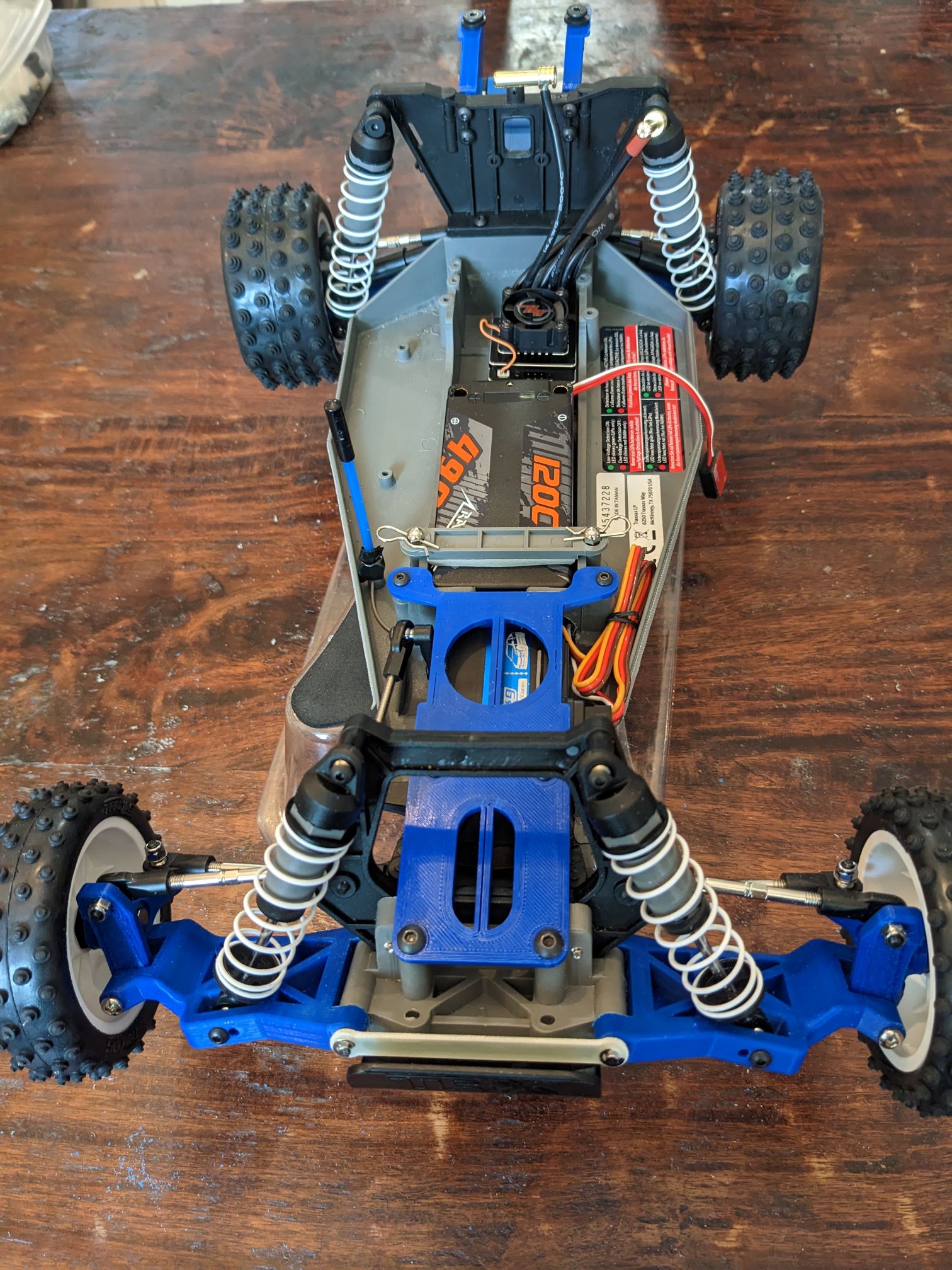

It looks like a foam block against the esc.

Yes I added foam between the ESC and battery to stop the pack from sliding back. I use the same one-sided weatherseal insulation foam on the bottom side of the battery brace so it clamps down and secures the pack better.

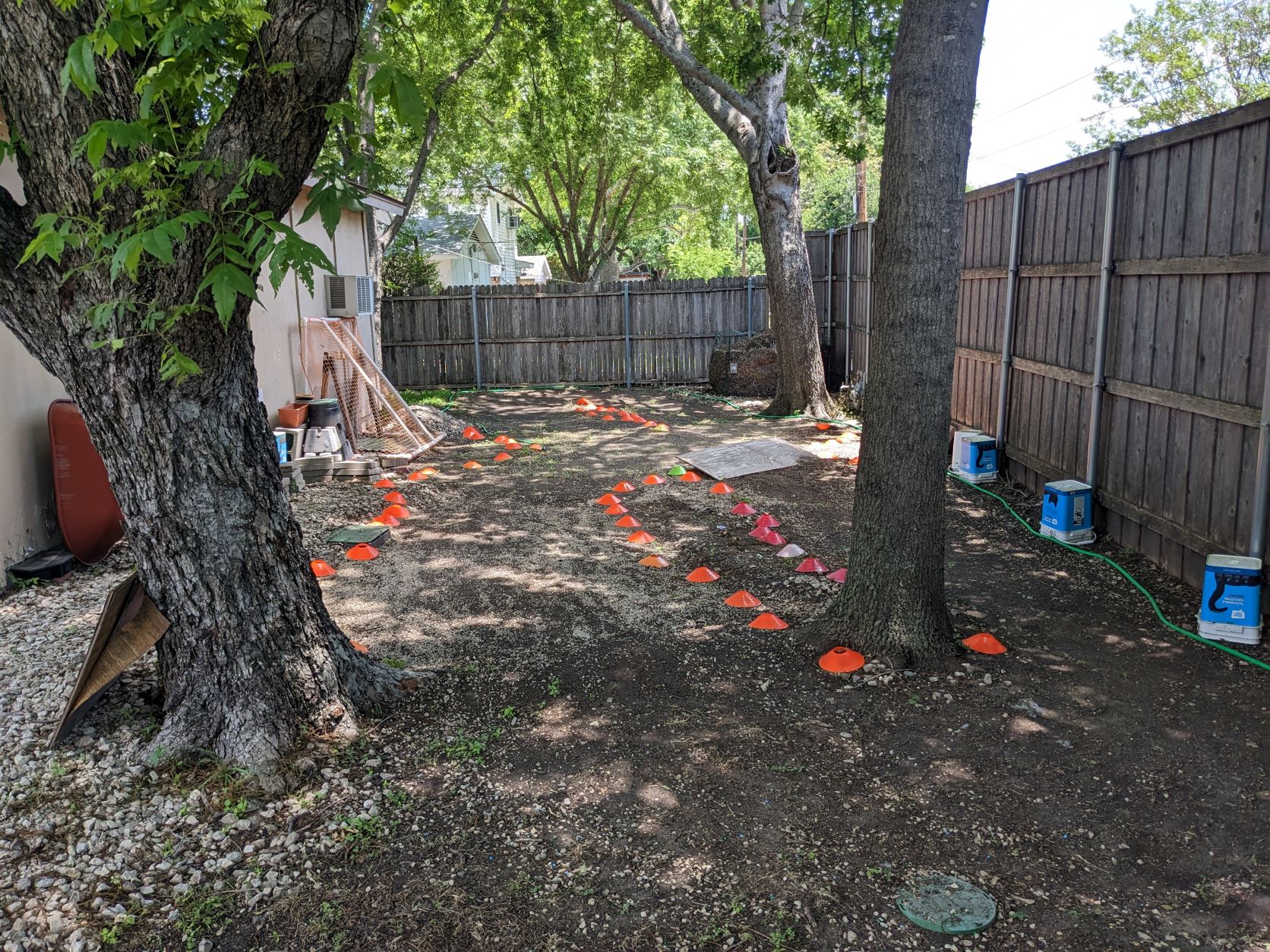

I finally got the bodies painted and we ran our Bandits through their paces on our piecemealed low traction loose dirt backyard track.

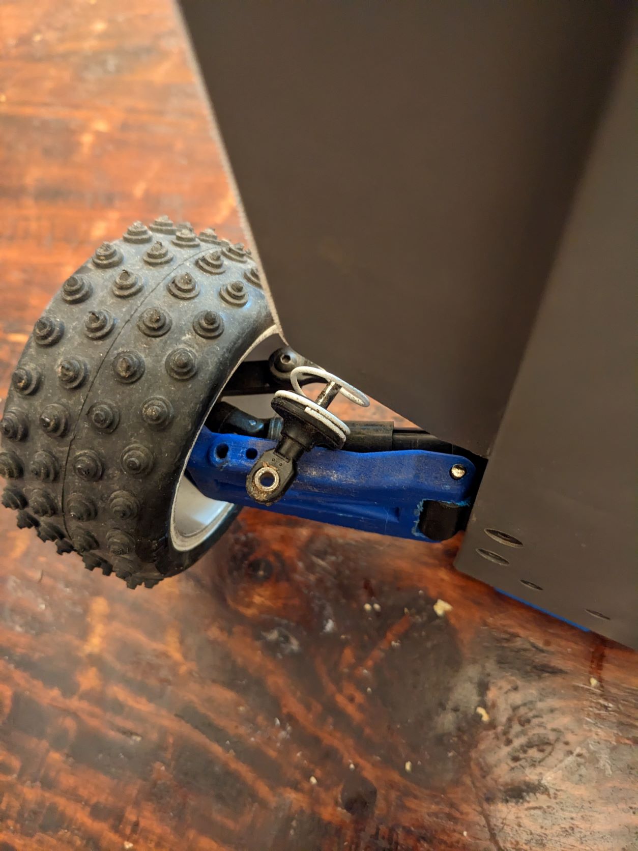

As for durability, the main casualty was the rear lower shock mounting screw tore out of the hole of the arm. I anticipated possible issues with the strength of PLA, so I was not too surprised (I printed out several spares). It gives me incentive to finally upgrade my printer to handle composite nylon filament.

I know this post is a little old, but the lower arm mounting hole probably just needs some brass inserts to handle the threads. The arm itself being made of PLA may not be an issue.nbrophy wrote: ↑Fri May 19, 2023 6:32 pm As for durability, the main casualty was the rear lower shock mounting screw tore out of the hole of the arm. I anticipated possible issues with the strength of PLA, so I was not too surprised (I printed out several spares). It gives me incentive to finally upgrade my printer to handle composite nylon filament.
