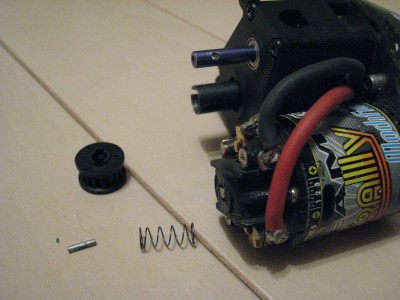

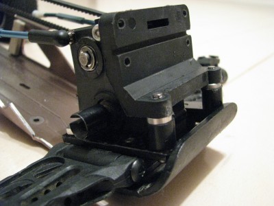

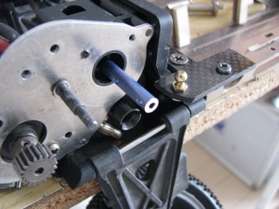

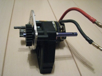

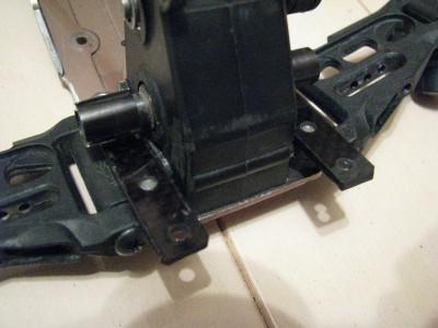

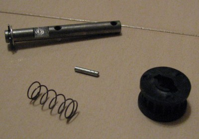

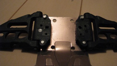

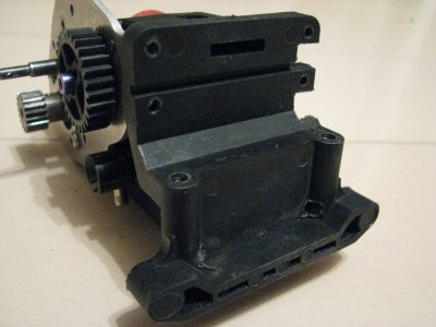

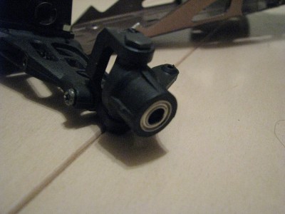

Where my first 4x4 conversion was borrowing a lot from the optima and mid, I'm trying to stay closer to the original ultima with this one.
Major reason: the belt running through the gear box was asking for a perfect sealing: which I did'nt have and costed me the internals of a complete gearbox in 2 runs.
Pictures of the unfininshed build:

Re: 4x4 ultima, for real this time! (building thread)
and now the first 9 pics

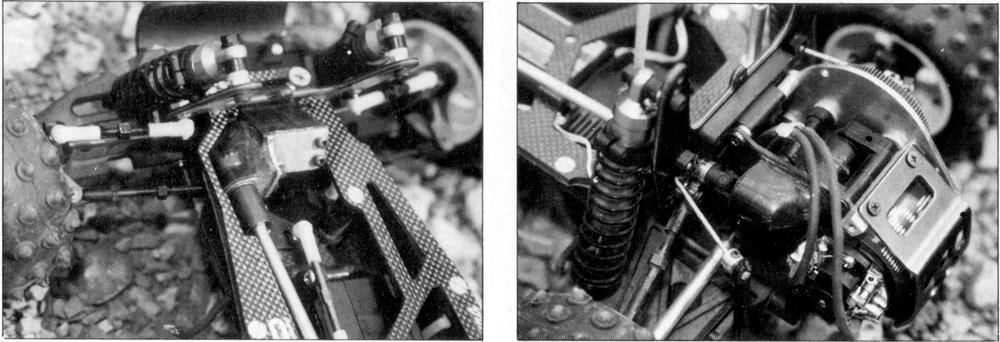

Before the Optimas went mainstream, this is what the Kyosho boys did back then. They were a bit different of course, the below is shaft driven. Something different, I personally like different. My hats off to Erik for his ingenuity.

I guess I shouldn't have posted the top one, that pretty much is an Optima. It was the maturation of the two below just before the release.

Looking good there Erik, nice idea to use the bulkhead as an extra brace for the front gearbox. It's going to turn out as a much more complete conversion this time.
That Ultima conversion was a privateer project made using helicopter parts and nothing to do with Kyosho, much the same as Eriks belt drive conversion, and was seen at the 87 worlds.
Err Jay, I'd just like to point out that the Optima preceded the Ultima by some time. The first Optima came out in September 85 and virtually all the Optima range had been released by the time the Ultima came out in July 86.mrlexan wrote:Before the Optimas went mainstream, this is what the Kyosho boys did back then.

Hey guys, thanks for the mass response!

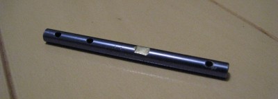

Temple, the major difference between this build and an optima is the location of the belt (or chain on most optima's).
For the optima the single belt runs straight from the front diff to the rear diff.
I used the MIP concept: where the belt is laid over external pulleys on the topshaft.
That's why the front gearbox is so high (no buggy body for this one)
Beside the advantage of closed gearboxes, the different belt location also lets me sit the battery lower than on the optima: for which the belt passes under the battery (unless you go saddlepack or split the stick in 2 as in the pics above.)
I'm not sure yet about the battery orientation; lengthwise or sideways. What do you guys think is better for a relative short wheelbased 4x4?
