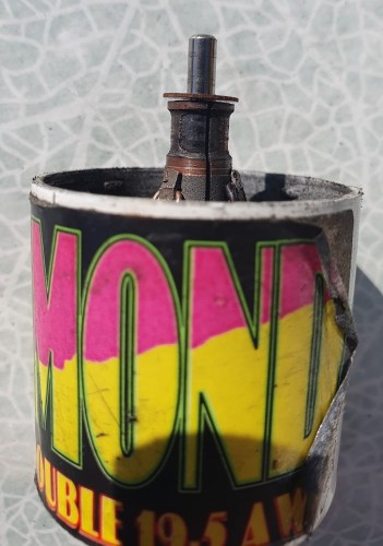

It had a Novak Racer esc, Sanwa radio gear, a Trinity Speed Gems Diamond motor and two boxes of spare screws, pinions etc.
The motor was junk! :(

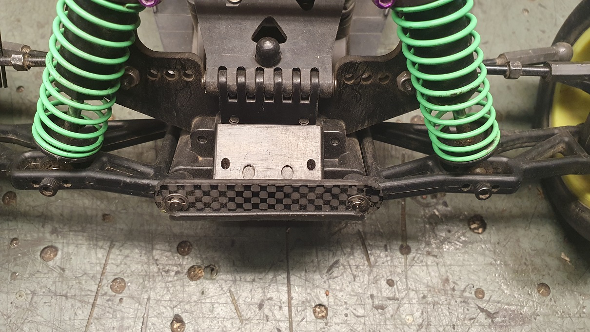

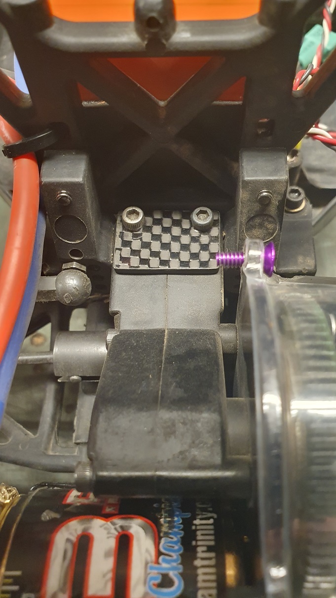

I tore the car down to pieces, inspected and cleaned everything.
Then I put it back together, made carbon braces for the gearbox and the front bulkhead.

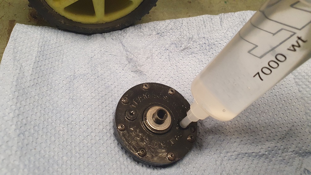

The Hydra drive was refilled using Losi 7000 WT diff oil and the filling screws was put back in using Permatex blue silicone.
I have now driven the car 25 times and no leaks from the Hydradrive!

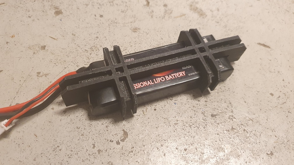

I found 2200 mAh 60C LiPo that I 3D printed a holder for it to fit in the battery tray.
