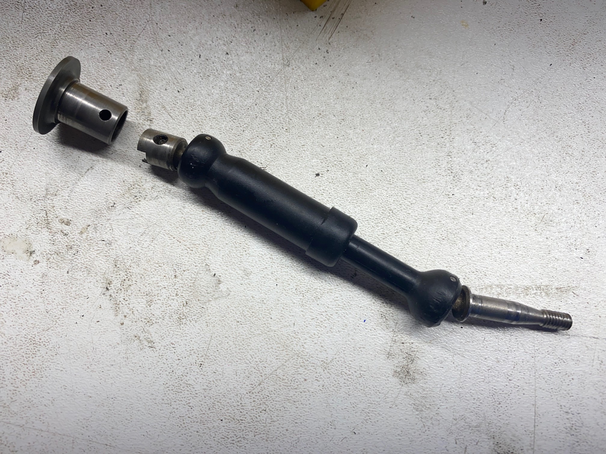

Would anyone be able to advise me of the best approach to replacing the telescoping driveshafts of the Cougar 2000? Mine are actually in OK-ish condition albeit quite bindy. But as I am building a runner for track use I just feel it would benefit from normal steel driveshafts. Muzoom in the UK have the alloy outdrives but no FIreblade type driveshafts. Are there alternatives that can be made to fit?

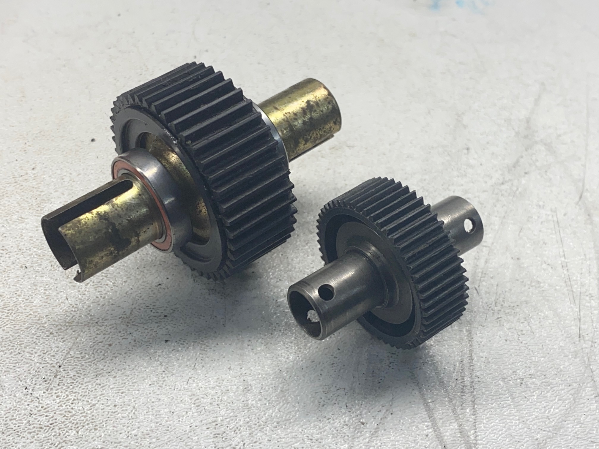

I have purchased a used Rascal ball diff with conventional outdrives. I'll report back if they fit the 50T 48DP cougar 2000 diff.

The rascal diff is way bigger. The outdrives look like they are for a 1/8th scale!.... Back to the drawing board.

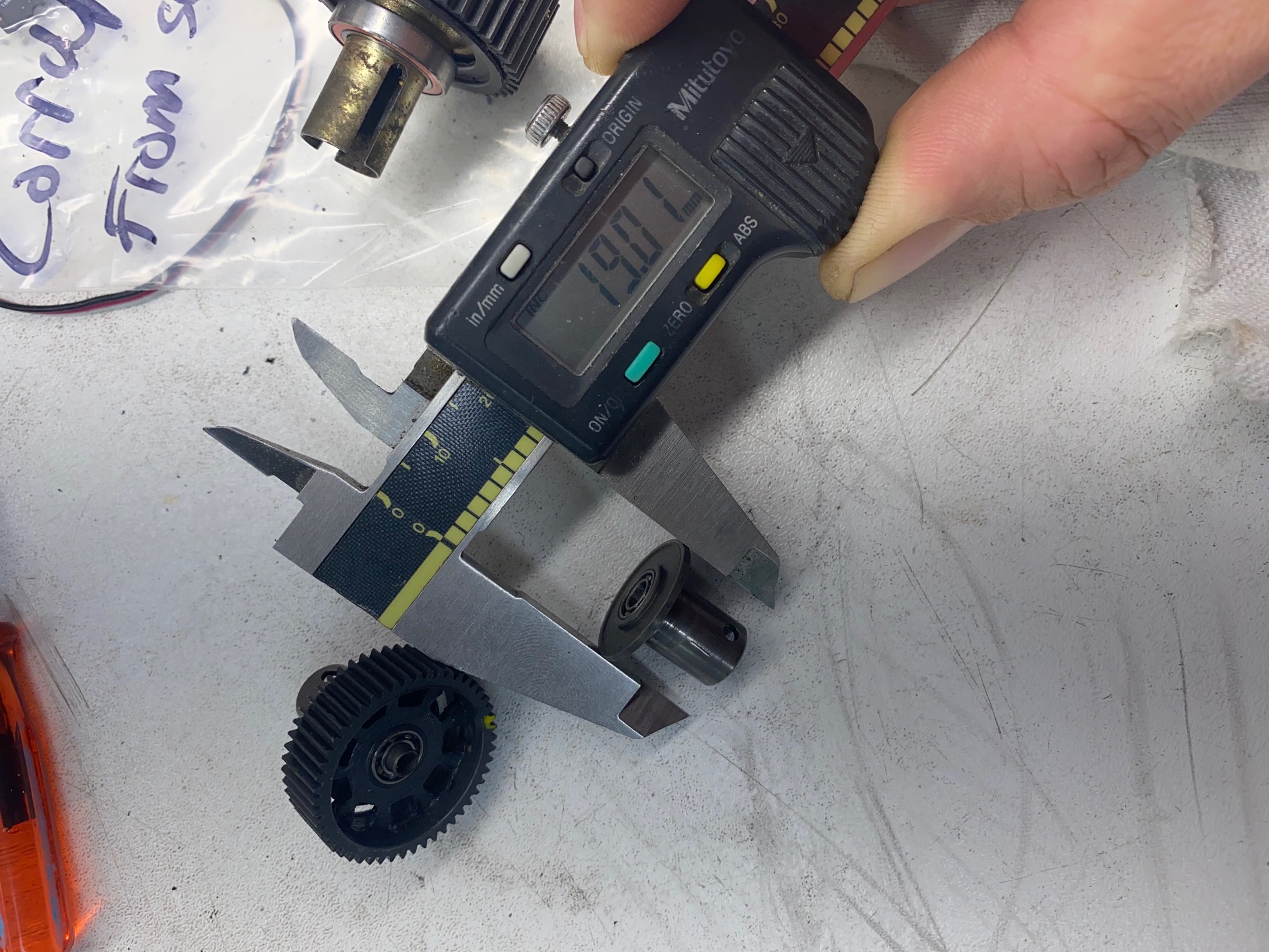

Would anyone be able to tell me if another ball diff outdrive has a diameter of 19mm? Up to 21mm may also work. The outdrive cups need to be 10mm diameter.

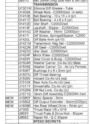

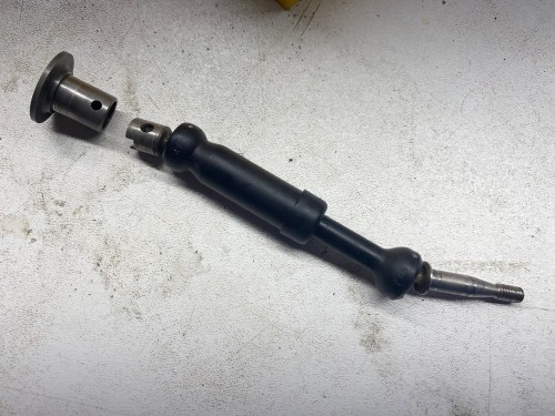

Will this same shaft fit a Storm 2000 instead of a Cougar 2000? Asking for a friend...Retro rc wrote: ↑Tue Nov 21, 2023 2:15 pm If you have out drives these are the drive shafts
https://www.racing-cars.com/1-10th-2wd-buggy/cougar-sv/driveshaft-cougar-sv-pr-u3752

No they won’t as the truck had longer arms all round, if you freind has the manual with a part number I can probably figure out a replacement for them

Thank you! I wasn't sure if they were the same. I had read that Schumacher simply used a wider chassis for the truck as a means of increasing track width. There was a 30 year gap between my ownership of a Cougar 2000 and this Storm 2000, so I can't compare them to verify

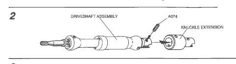

Maybe they are the same! I checked the Cougar 2000 manual. It also lists U1511Y "driveshafts, Co-Ax U/J - C2000 (pr)".

Re: Cougar 2000 drive shaft replacement?
Looks like they are the same but there is a outdrive extender listed, must be to allow for the wider arms. Also the original driveshafts are a slider setup so would take up some of the difference. I wouldn’t risk it till you’ve got a few measurements to double check
